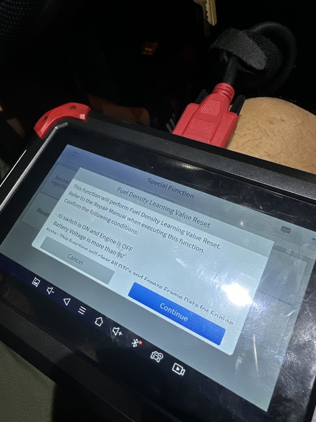

    I purchased one of the Launch tools and did the reset today. When the fuel alcohol percentage is reset ("Fuel Density Learning Value Reset" in the scan tool), that also resets the fuel trims.
    With Techstream, each is a separate step.

    Regardless if Toyota covers or not, just get the scan tool and reset it yourself. You need one anyway for doing this in the future.
    It is a Toyota design issue, but the many dealer service departments make the whole problem worse by their ignorance/incompetence/greed.

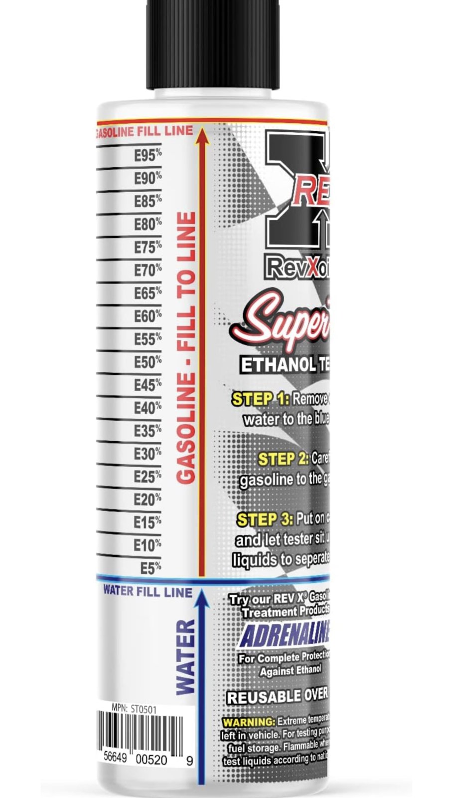

    This is a good idea.
    I bought this ethanol percent test tube.
    Ive tested my local station and it passed but it's nice to have another tool and it's cheap and doesn't take up much space.
