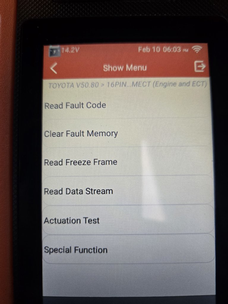

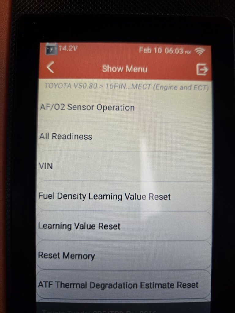

    On mine, there a special function option then select Fuel Density value reset (But just turn the key to on and not start the engine). Try that to see if it reset 20250210_180402.jpg 20250210_180420.jpg
    Hbcon20[QUOTED] likes this.
