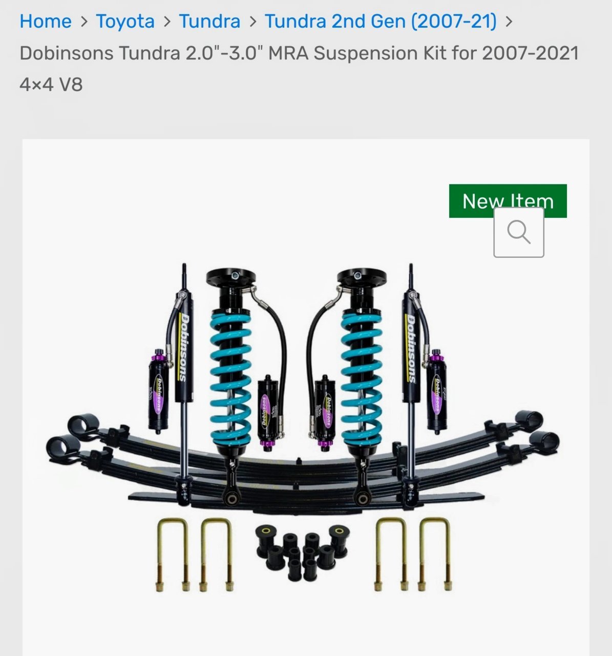

    So I was looking at the Ironman foam cell kit, could this be made to work ? Sorry again man I’m totally new to this

    I love the shocks. They had some issues with coils rubbing the shock bodies, but that has been fixed.
    I can't say for certain... but if your current geometry and alignment is good then you should have no issues if you stick with 6". The FCPros are typically set up for a 3.5" lift, so you'd add a spacer on top that adds 2.5" lift in addition (it would be more like 1.5" thick I think). I don't remember how much the rear leafs add, but you'd do the same there... some with the leafs and the rest with a block, shackle or both.
    If you'd like to take some more pictures, post up where your alignment cams are adjusted. They are on the LCA pivots. You'll see the markings. Also if it's convenient to park at a level spot, line up your front and rear tires and see if fronts are pointing straight up or visually tilted in our out vs the rears. That would be camber. Also see if the outer sides of front tires line up with the rear (a long straightedge might help); that would be toe. If the alignment is off very much you'll be able to see it.
