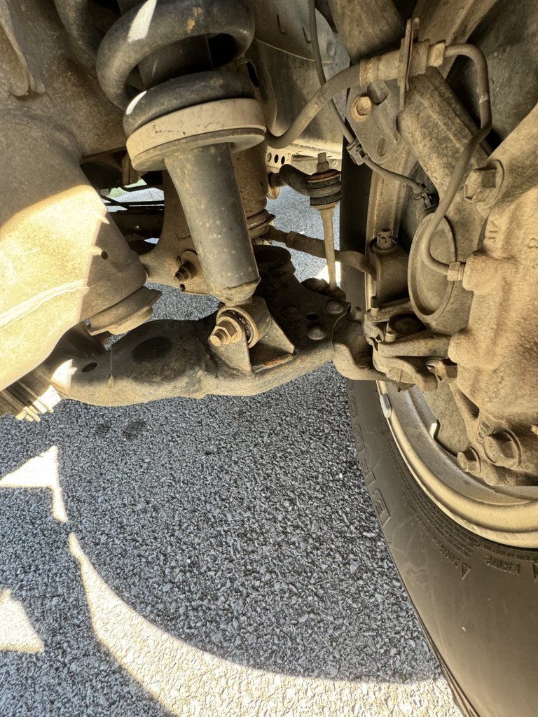

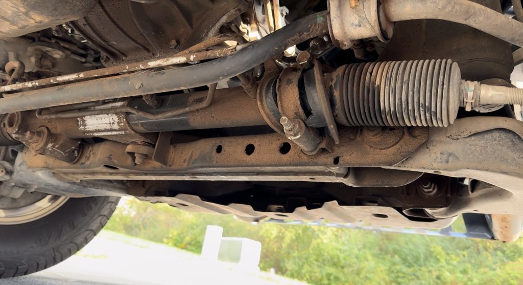

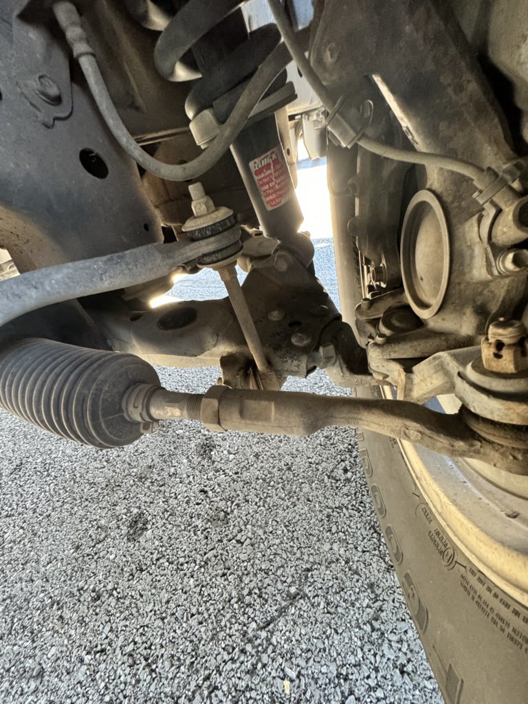

    Here are some pictures of my suspension.

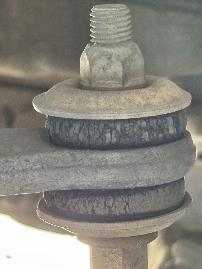

    Holy shit those swaybar links are over tightened up too.
  14. Oct 10, 2024 at 11:59 AM
    GuiltySpark
    GuiltySpark [OP] New Member
    Aug 17, 2024
    #121475
    21
    East Coast
    2003 Grey Tundra Limited Access Cab
    LED Interior lights Pioneer Touchscreen Radio w/ CarPlay LED Dashboard Lights LED 3rd brake light assembly Rack and Pinion polyurethane bushings upgrade.
    I’ve never touched those, is that something that would be changed in an alignment?
    Edit: if you’re talking about the cracking rubber, that’s just been dry rotted for a while.

    I see Quickstruts too, those are probably riding pretty harsh at this point.

    Yea those are on my list to replace (they were not my choice to put on), I was looking at putting in Bilstein, I’ve seen that those are supposed to be one of the best.

    Well that, and they’re fucking sandwiched. You’re only supposed to tighten those down to the point they are barely engaging the rubber. Once you get to this level of bulge (_) it’s already too much. Those are even more severely tightened, and it’s probably part of the reason they cracked. Whoever installed the quickstruts likely did it, didn’t know what they were doing when reinstalling. You really need to disconnect the sway at to stuff new struts in.

    Ah I see, thanks for the tightening tip, I will make sure to do that when I put new ones in.

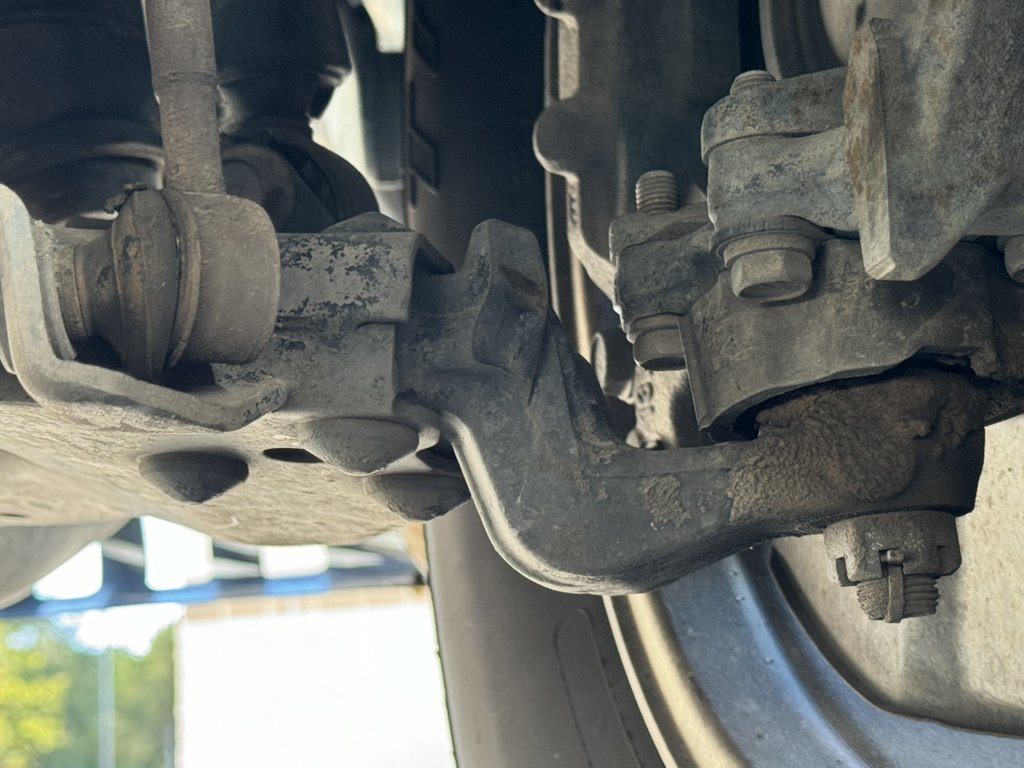

    Here is a more up close pic of the sway bars and ball joint.

    Ps - this is why we like pics. Like, A LOT.
    We can’t be there in person but we can totally advise you on what’s fucked and what’s not if we see it. Some of the members on here shock me with some of the crazy little details they pick up. But I’m also pretty old and blind. Or is it dumb and blonde? I don’t remember.

    These are a great option (LINK) but they show out of stock and I honestly think they have been for a while so I'm not sure if they exist anywhere else or not. If you run the Bilsteins you'll need new coil springs most likely as the aftermarket ones most likely won't fit, are you looking to lift or leave at stock hight?
    As stated already you could use some new sway bar links as well. I think struts, ball joints, and sway bar links would be a pretty good start. The ball joints do look like the small ones. Check this thread here (LINK) and (LINK)
    Lower ball joints need to be OEM, some of the other parts you can go cheaper on if you desire/need to. Just don't order any OEM parts from Amazon or Ebay as they could be fake. Please hop back on here when you have a parts list and tell us what you're getting and where from and we can make sure you're sitting right.

    Lower strut bushing is also toast.

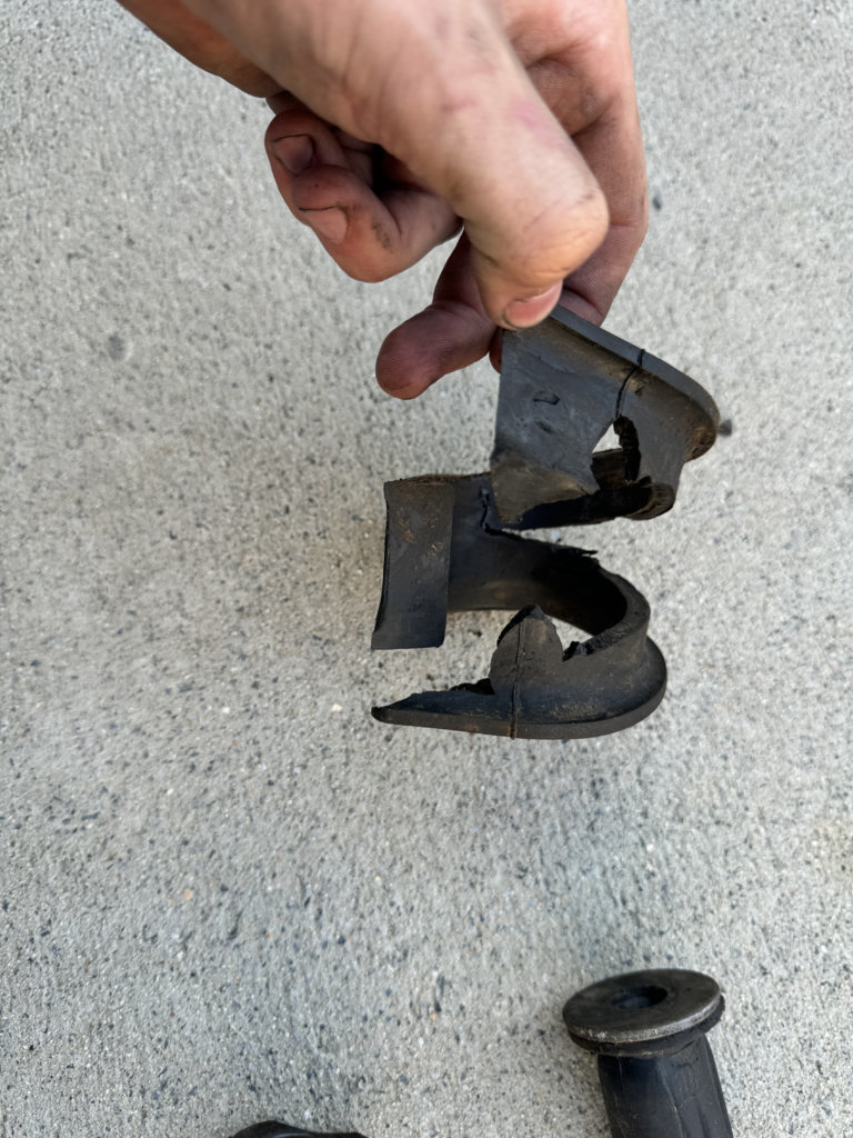

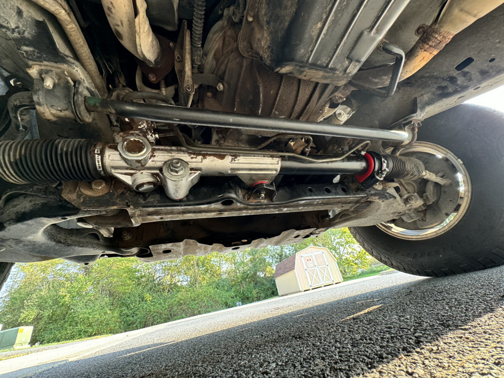

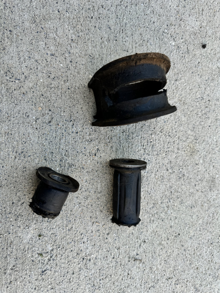

    Update: Rack and pinion bushings replaced, my steering feels 1000% better, no loose wobble feeling anymore.
    Before
    After
    First repair of many....
