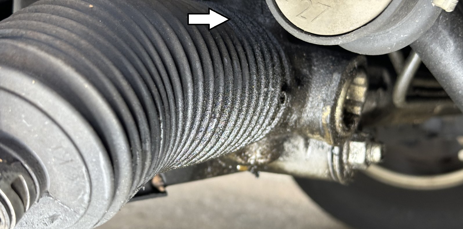

    Yes, my bellows did have 2 holes on the passenger side. Haven't checked drivers side thoroughly yet since I know I need to replace them. Too bad I already got it aligned. I replaced the driver's side outside tie rod end, should I go ahead and replace the passenger side while I am at it? Any brand recs on the bellows? I see there are quite a few to choose from
    Anything else you noticed from the pics? I need to make myself a checklist of things I need to inspect in the front end. But, overall I must say I was impressed with how everything looked on the surface regarding rust and general appearance. I probably should have checked the sway bar bushings. I wish it had a little less sway. It isn't bad at all, but after driving a very low center of gravity sports-type car for a few months while I loaned my truck to my brother, it is noticeable but probably reasonably close to the way it was from the factory. Either way, sometime down the road I hope I can improve/upgrade that part of the handling.

    Bolded part, I had same experience and just told @Averyklinnnn the same, although at just shy of 700k miles, I think he actually may need a new pan gasket. And in that thread, half-moon plugs came up, they go here and basically, when you do your valve covers, you're supposed to pop the plugs out, clean them or all sealant, then re-seal (FIPG) then into place as part of the work. It's one of two places you need to use FIPG when doing the valve covers, the other spot is the two right-angle corners where the valve cover meets the head and cam tower on each side.
    Shop towel to wipe up the grime. You're not going to get the oil saturation out of the metal. You'll know there's a new leak if you begin to see grime again in that spot. With time and age, and potentially heat, you may eventually see the soaked-in oil fade or dissipate, but ...
    For any rubber parts, I'd go OEM. Only because you'll get the same longevity. For that ... you can do it without alignment after pretty easily, assuming you're either (A) using a 100% iidentical tie rod end, (B) re-using the existing tie rod ends, or (C) a combo of both. What you'll do is, get a good hi-vis paint marker (I personally use Testors yellow). Crack loose the locking nut on the TRE and roll it back several threads. Paint the seam and 1st few exposed threads where the TRE is resting. Now there's no question about where the TRE was installed; when done with whatever work you're doing, simply spin the TRE back on so the yellow marks line up, or if replacing with an identical part, run the TRE right up to the yellow paint line. Then lock it back down again.
    For the bellows you could probably/potentially find a way to finagle the boot up over the spindle end and slide it on, but ... I think it's better form to remove the TRE after marking. You'll need to pick up replacement Oetiker clamps to re-clamp the new bellows. That means adding a tool, I recommend Lisle's tool #30800, and hit YouTube if you need instructions on how to use it. All Oetiker clamps are marked with their diameter on the body of the clamp in metric/millimeters format, like these which are 78.4mm and 38.1mm clamps, respectively. You don't need to necessarily buy OEM clamps to replace, just make sure they're the same size.
    I didn't see anything else jumping out at me, but that's why it's helpful to have more eyes than mine looking over your pics, I hope others are looking.
    On the swabar bushings, if you're talking about the two half-circle shaped bushings holding the swaybar to the frame, those do virtually nothing at all and have very little pressure on them, so I doubt you'll need to replace. If you need to reduce sway, there's a no-drill way to do that adding a rear swaybar, but it comes with a $500 price tag.

    I am ordering the bellows since mine did have a couple of holes. Not sure about the CV axle boots.

    I will be replacing the Bellows in the coming week. I just watched a video from TRQ on replacing them I remembered it being straightforward, but just wanted to be sure. However, they just simply replaced the rubber boot. I thought I recalled seeing in another video or reading in this forum where they added grease.
    Is that if you're doing more than just replacing the bellows?
    @shifty` or anyone else?
    I also ordered the Suspension Maxx extended swaybar links this morning. The more I read on that I'm satisfied that is best over the stock swaybar links I recently installed

    Are you thinking of @FirstGenVol who recently swapped his inner toe rods? There is some grease packing involved there. A lot of people may do inners at same time as bellows.

    I'll just do the Bellows, the second outer tre (replaced one when I did the LBJ's), and the sway bar links for now.
    I'll research the other on down the road. there's no apparent problems at present. I'm always up for preventative maintenance but I've already got a lot to do to it over the next three weeks
