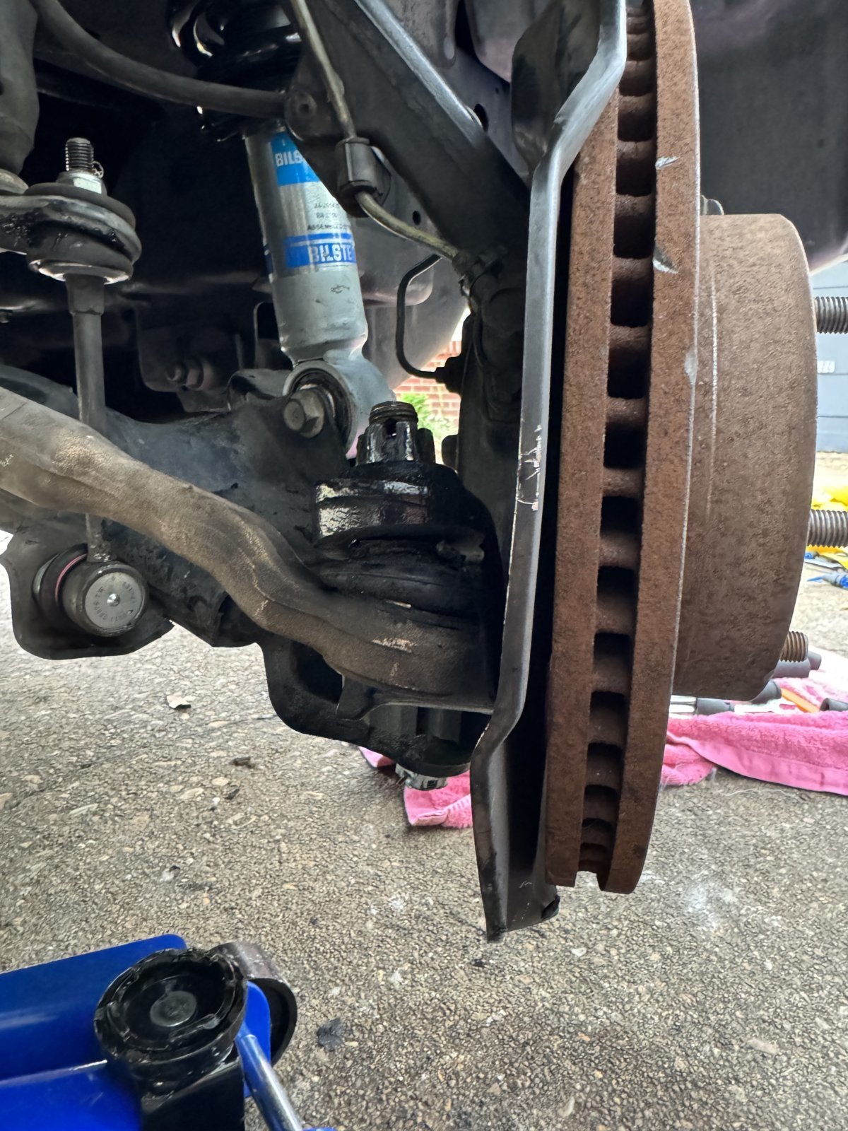

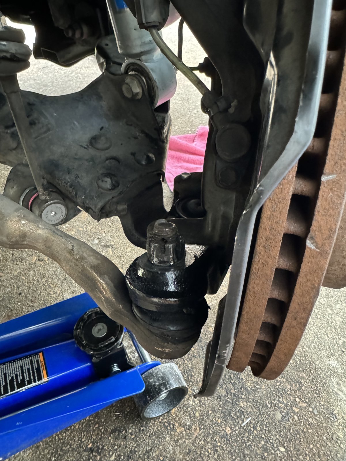

    But something doesn’t look right @shifty`
    When I taught down that castle nut, the hole seems to be very high on the stud
    I don’t believe there was a washer or anything there
    edited to add that one I was waiting I was putting the top nut of the swaybar connector and it appears to be stripped. I can’t even get it off.
    but the old top shock nuts are the same size so I’m just gonna snug it down to make it a lock nut
    i’m thinking at this point the best thing to do is let the shop replace those swaybar connectors tomorrow when they do the alignment

    That's not abnormal. As long as the cotter engages between two posts on the crown with 3-4mm of inteference/grab, it serves its purpose. It's not expected that the cotter is going to nestle in perfectly to the valley. The sole purpose of the cotter is to prevent the castle nut from spinning, do you feel it will stop the bolt from spinning with the level of engagement it has as-is?

    @shifty`
    I may just pick up those swaybar links, and at least replace this bad one on the passenger side today.
    it appears on that cheap replacement that was used before. It has one of those self locking nuts and I believe they’re only supposed to be used once. Even trying to lock it with the old nut from the top of the shocks, it seemed to just slide down and never really locked like it should. it should’ve locked within a quarter, turn or so once they bumped up against each other,

    If you were closer, I'd give you my take-off OEM links to swap em out. I'm not sure which brands are worth a damn for aftermarket swaybar links. @Jack McCarthy says the Moog links are good in this thread, But something looks very, very wrong to me about how that top washer sits on the bushing with your Moog links. @Jack McCarthy do your Moog links look similar on top?
    What's the story on your tie rod ends (TRE)? Are those new, old, sticking with them? They look perfectly fine to my eyes.
    Weagle[OP] likes this.

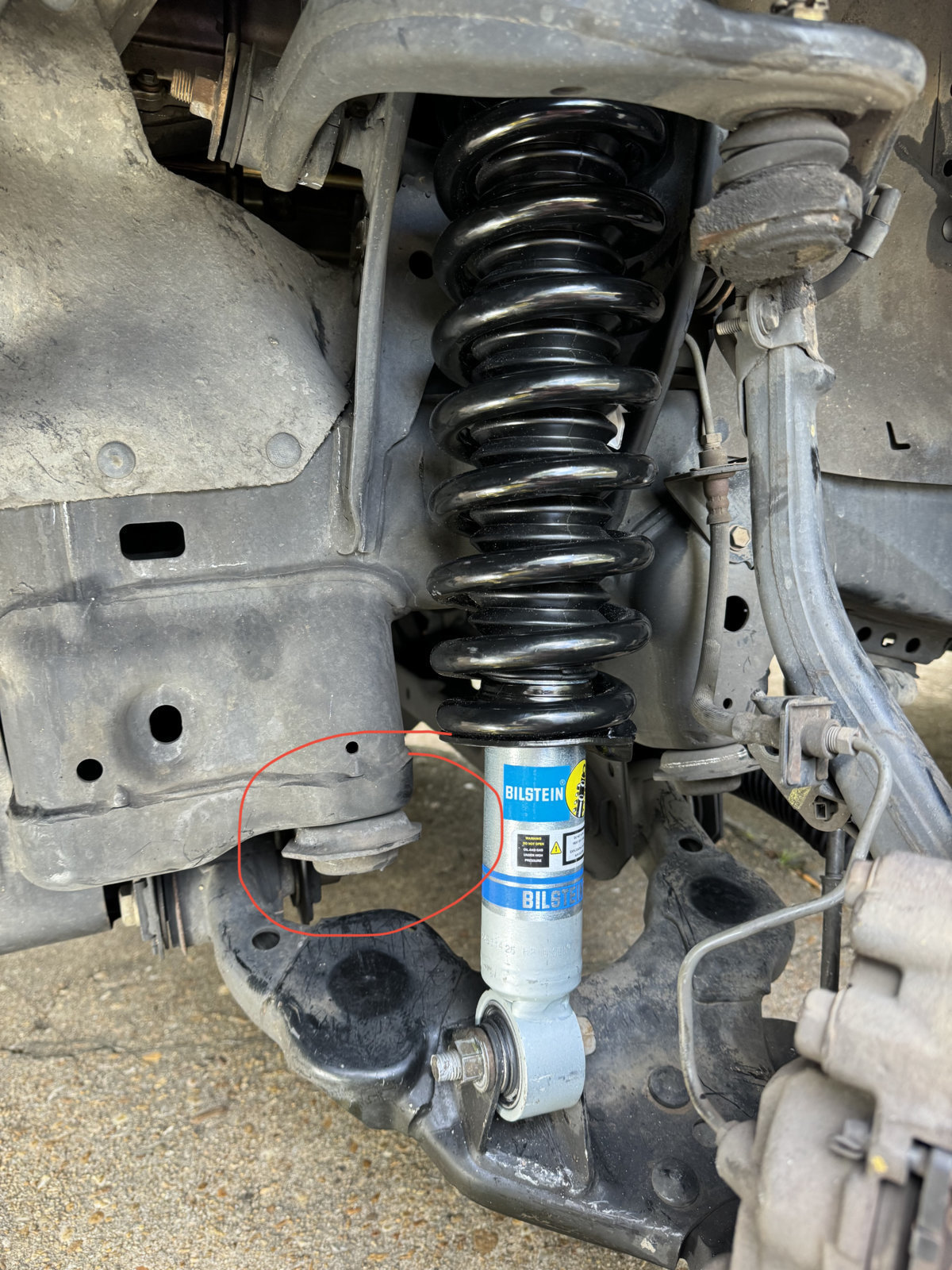

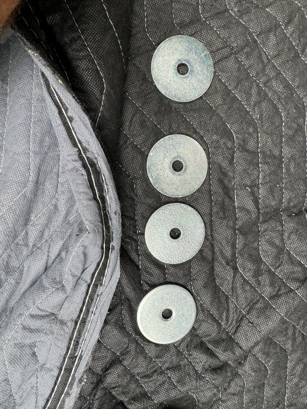

    Doesn’t look like anyone answered, so here goes.
    these
    Are washers that act as spacers for these
    unscrew them, add two washers and screw them back in. Keep you from over extending the shock and blowing out the seals. Like my first set.
    NickB_01TRD, Weagle[OP] and shifty` like this.

    Thanks. Absolutely nothing at all came with the kit to explain.
    I will add them but I don’t do off-road so hopefully that won’t be an issue anyway

    Speaking of which, I never did buy my new stops.
    How much thread do the OEM have up in there? Are we talking half inch extra? Full inch? More than an inch? I’ve never had mine off, but they’re in great shape. Wondering if I could get away with a 1.5” spacer or if someone sells a male-female riser kit.

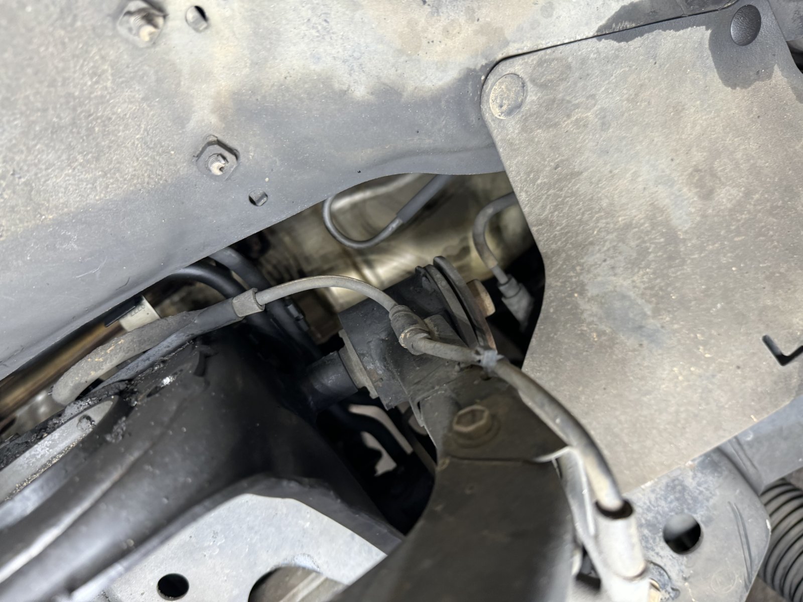

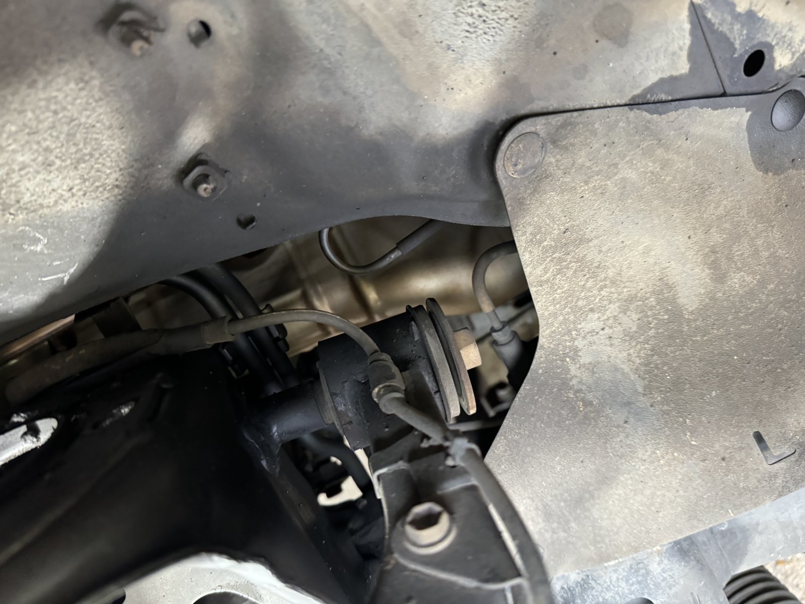

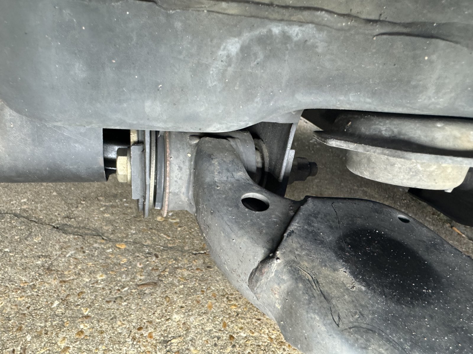

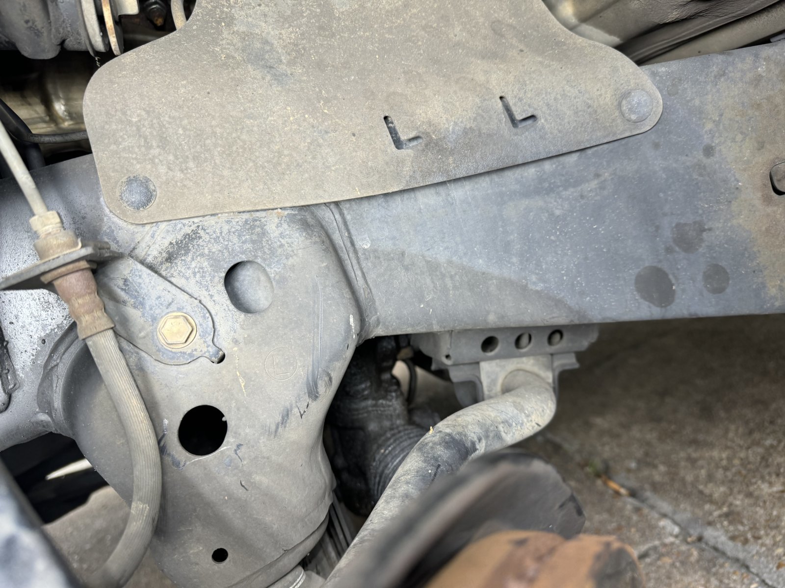

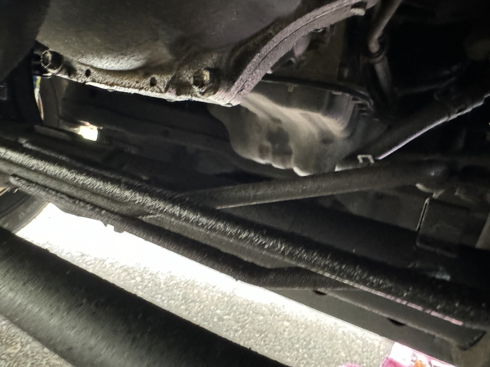

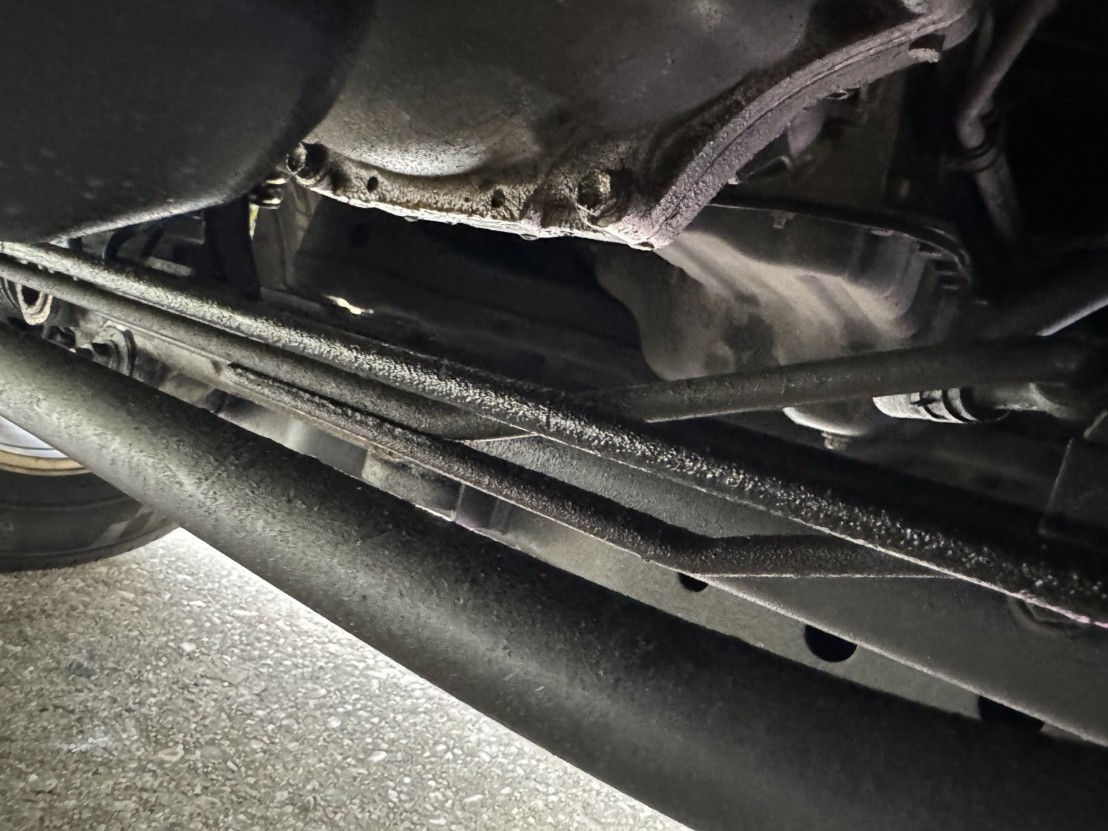

    IMG_3623.jpg IMG_3622.jpg IMG_3621.jpg IMG_3620.jpg IMG_3595.jpg IMG_3594.jpg IMG_3590.jpg IMG_3588.jpg @shifty`

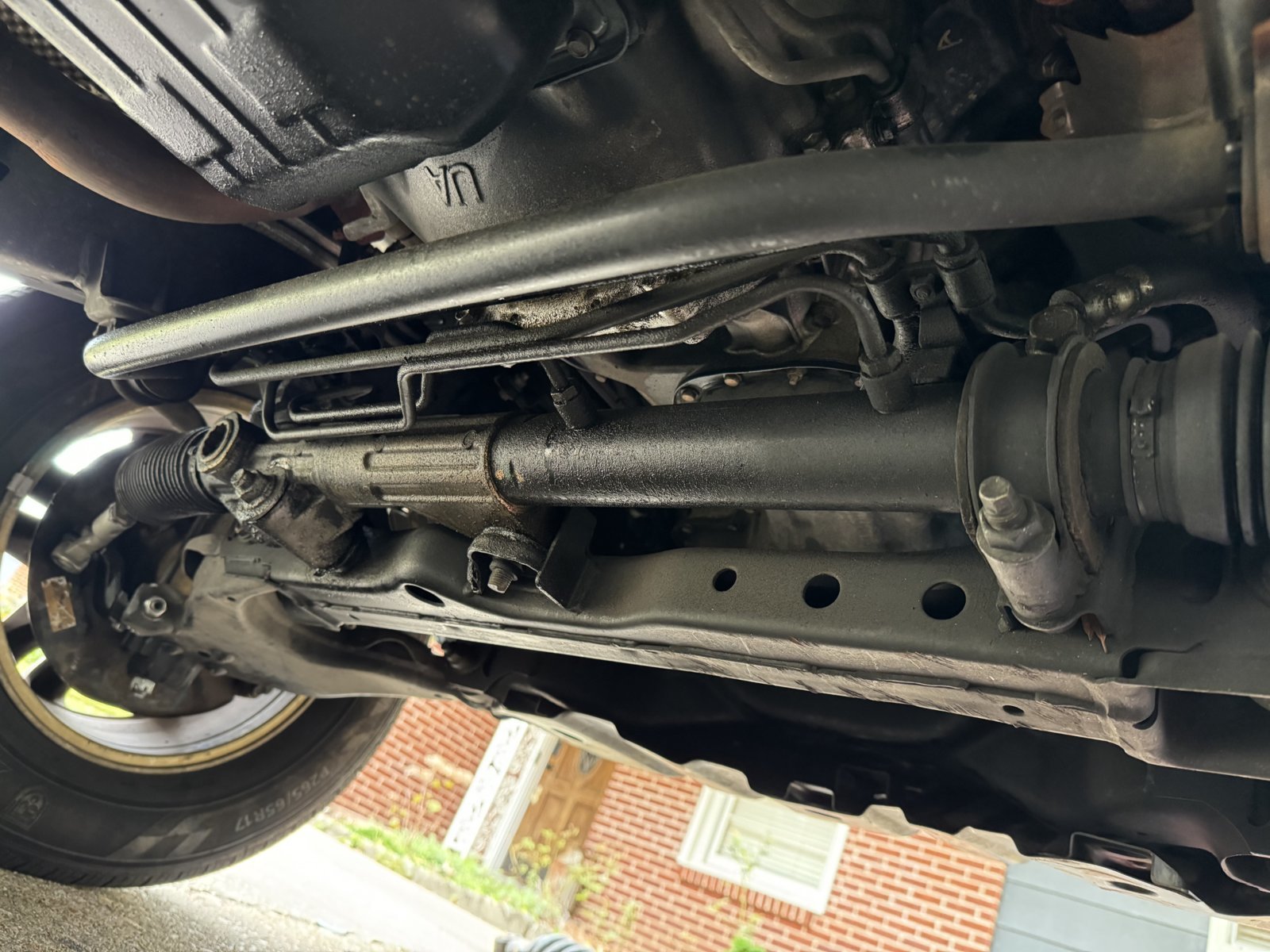

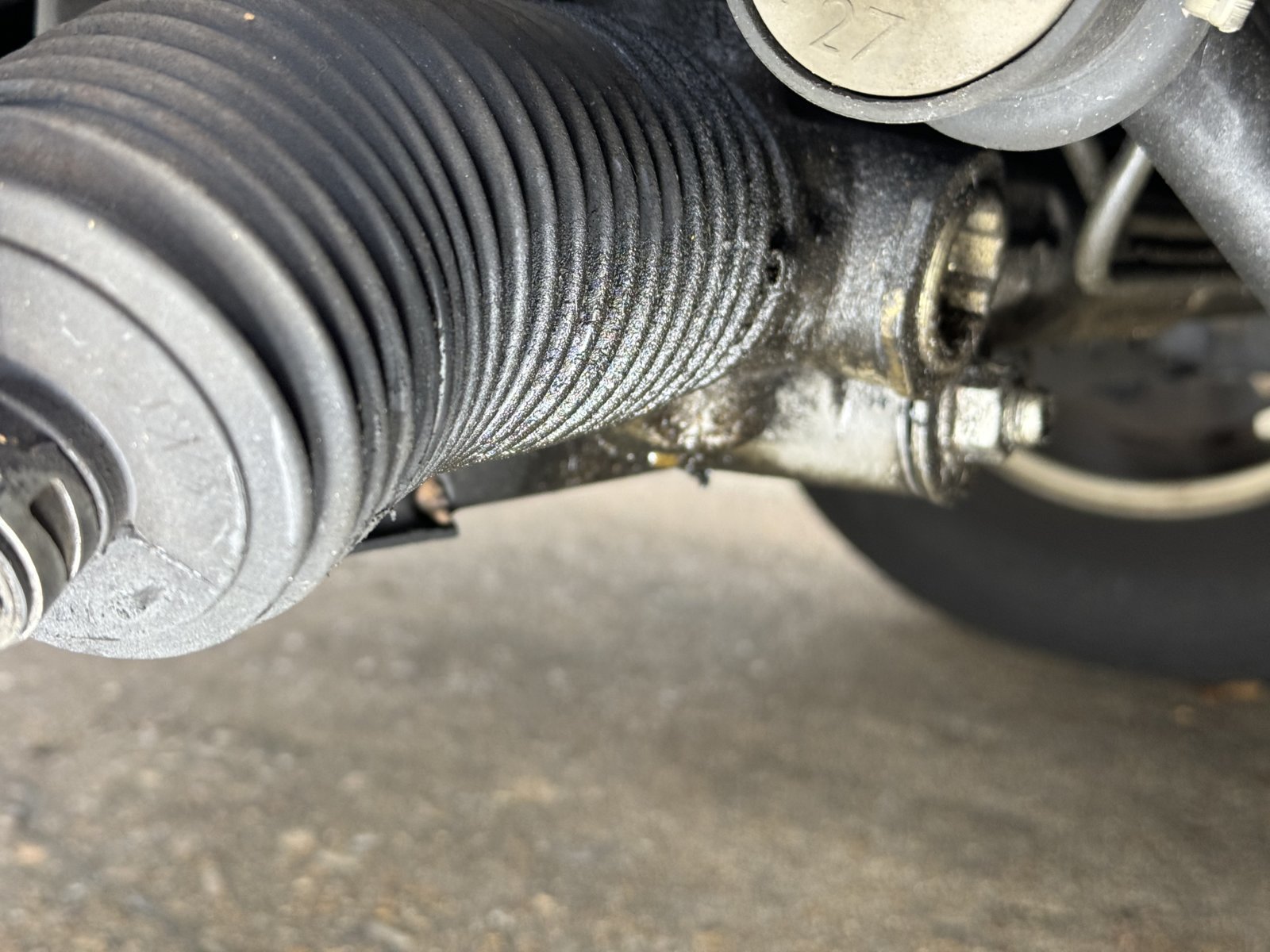

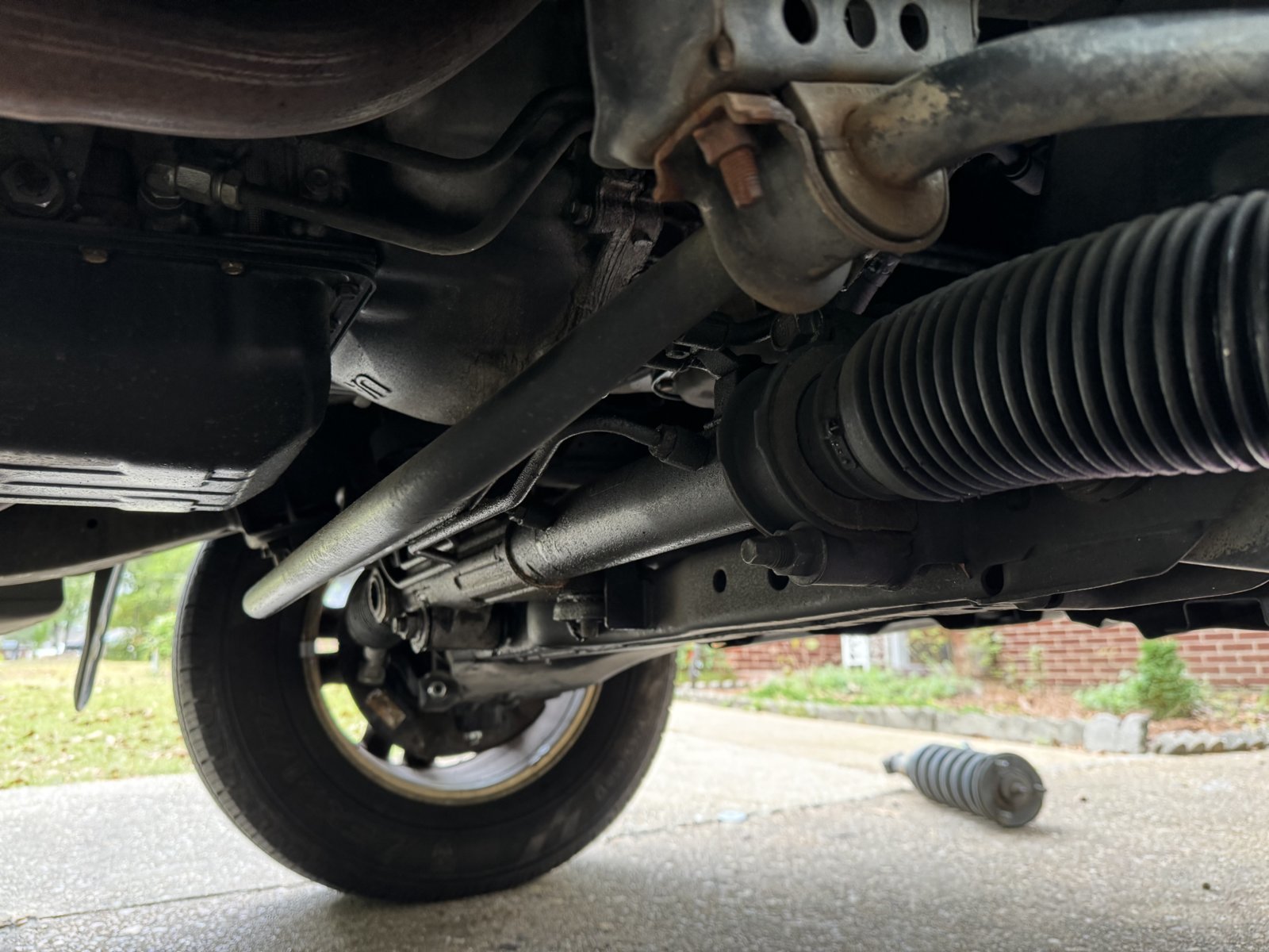

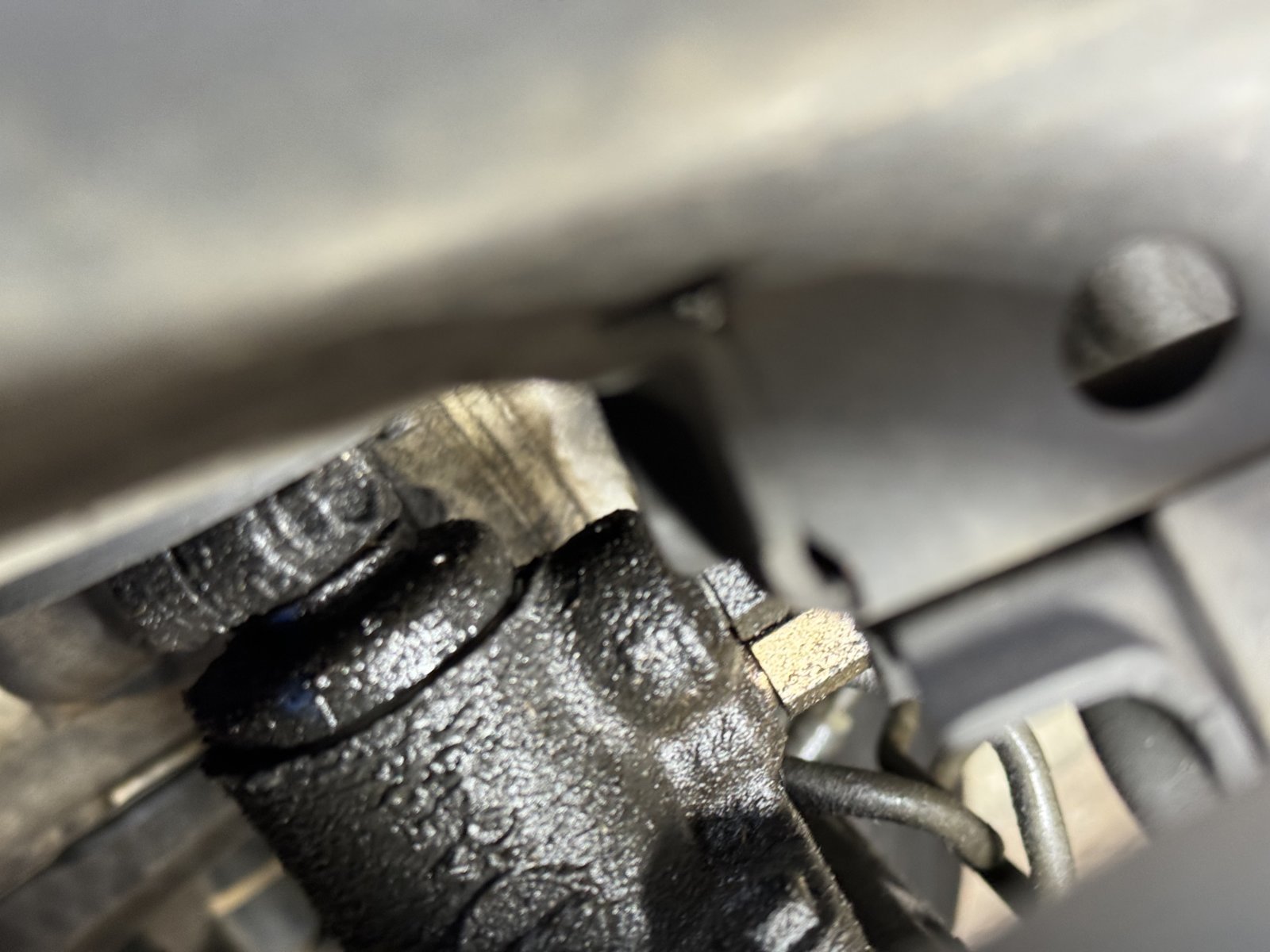

    I didn’t want to start a new thread on this, but I tried to catch a few pictures when I was working to see if anything obvious needs attention.
    There is nothing dripping on the ground when I park, but there is a very slow power steering leak. From the pictures, I saw some seepage in a few places, but some of that could also be old
    the shop told me whatever (dont recall exactly) needed replacing re: power steering, were not easy to get to but that I could put it off for a while
    also, you mentioned doing a quick visual on my timing belt before I went on my trip. I cannot find your post, and I searched for it several ways. I know you said it wouldn’t take but a few minutes and just one socket if I’m not mistaken,

    I’ll need to get to a bigger screen tomorrow.
    Timing belt: 10 mm socket. Loosen fasteners for whichever timing cover is easiest to get to for you. Pull it back enough to inspect the belt for cracks and defects. Absence of cracks is no guarantee it won’t snap.

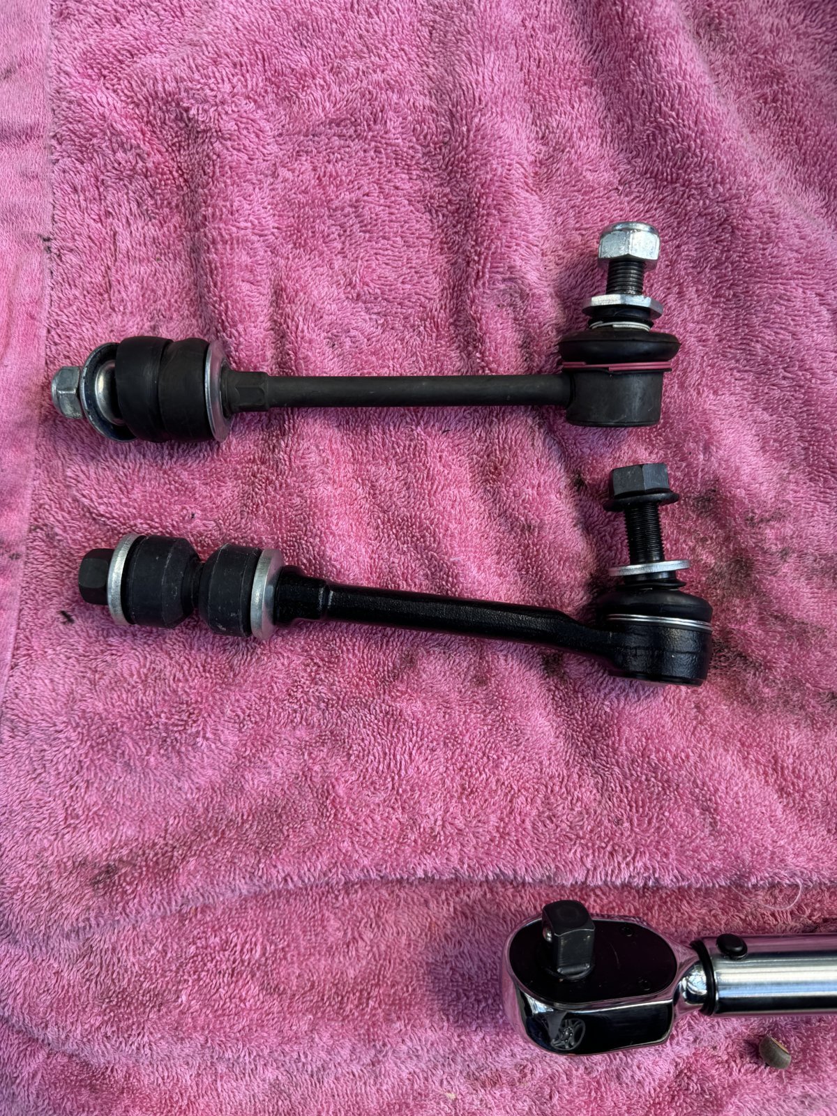

    Replacing the swaybar links now. The bottom one with the black nuts is the new one. May not be quite OEM, but leaps and bounds above the cheap toys that were on it.
    The shaft, the caps, the nuts, the bushings, all definitely more heavy duty. $30 each so 60 for both isn’t bad, since I had to have them in a rush

    Don't crank the new ones down 'til they mushroom. Same as your rear shocks.
    Looking back at the pics, I don't think you have a rack leak. I think you have valve cover leaks, and/or possibly a leak at the half-moon plugs, and it's dribbling down the back of the block onto mid-rack (maybe covers or half-moon plugs), and the driver side bellows (likely driver valve cover).
    If you opt to wipe up the mess on your rack, inspect the bellows (rubber accordion things) on your rack for any rips or tears, I don't think you'll find any, but those and your CV axle boots are a 'regular check' item to inspect for tears (preventative maint'ce).
    Why do I say the oil is coming from above? If it was coming from the rack, you likely wouldn't see oil slick on top:

    Thanks but now I’m coming down to the wire I have a problem with just one of those swaybar links. It is spinning, and no matter what I do it keeps spinning it the bottom one
  28. Oct 16, 2023 at 1:41 PM
    #88
    KNABORES
    KNABORES Sarcasm incoming
    Jan 1, 2020
    #40572
    15,138
    Arkansas
    Doesn't take an Allen key in the shaft to hold it?

    Thank you! I called myself examining them before I started, but I did not have this problem on the other side,

    Bilstein 5100's with 2883's - close to 2" Replacing the 2883's and going back to the bottom perch ASAP -mobile/apple play stereo with sub and backup cam -Power stop HD front calipers and rotors for towing -20" wheels with 32" tires (305/50's) Toyo AT 3's with no rubbing -Westin nerf bars -Detroit axle new (not rebuilt) steering rack with poly bushings, inner and outer TRE's -Suspension Maxx extended front sway bar links -Overland tuning - medium level -Power front leather seats and steering wheel from 06 Sequoia -fully de-chromed/blacked out trim -all light housings incl 3rd brake light and tag lights replaced with smoked lenses, LED where appropriate -mini projector headlights -fully rebuilt trans and new torque converter -new complete drive shaft with spicer u-joints and carrier bearing -all LED interior lights including backlighting -new lower window seals for all 4 doors -all new hardware and clips for tailgate Next: Dirty Deeds racing exhaust with LT headers, yellow box, 12 hole DD fuel injectors, redo or replace door panels
    i’m just now reading this, but I did notice that the passenger side had two holes where it look like it been rubbing on the inside.
