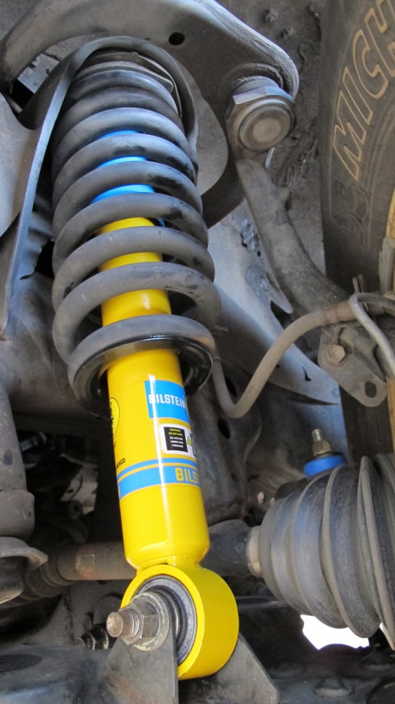

    Bilstein 4600, front and rear are as close to stock as you're going to get, and are as close as you can get to the factory shocks that came on the TRD packaged trucks.
    While you can re-use the OEM springs/isolators/tophats if you don't live in rust belt and they're in good shape, I would opt to pick up the [likely sagging by this age] nose a bit, in a way that won't cause substantial geometry change, and also improve handling, by buying Old Man Emu 2883 springs, and the appropriate isolator and tophat to pair them into the Bilstein 4600 strut. If you do make the wise decision to go with OME 2883 springs, that'll be these isolators (here's why), and just to refresh everything all at once, buy these tophats.
    Doing this, you shouldn't need to update again for another 100k miles.

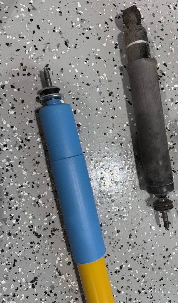

    Just put all 4 new Bilstein 4600s on mine. I'd recommend those and to reuse the front spring/strut housing assembly. The rubber bump pad on my front top hat was a little dry but still in good shape. I wiped it down with silicone spray on a rag.
    Feels OEM-like to me. At 250k miles, my original Toyota KYBs had hydraulic oil oozed out and dust buildup from the oil but still had tension while compressing the rod, but remained completely compressed and didn't retract so they were shot.
    The ride quality surprisingly didn't change much so I would consider it a critical fix, but I do notice less suspension rebound when driving over slightly bumpy roads going 40-60mph-ish. My tire wear was still normal with the old ones. The truck feels like it sits about an inch higher too now which is nice.
