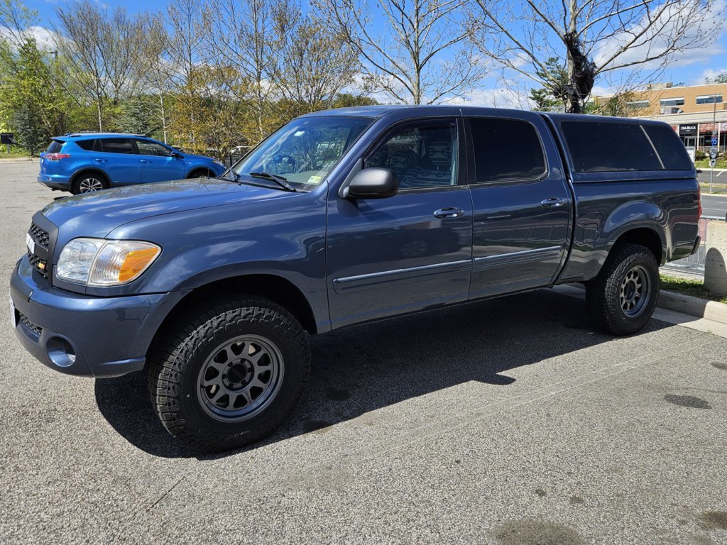

    Just discovered when I removed the plastic bedliner to spray on a liner, that i have some serious rust issues toward the front bulkhead of the bed. Frame is in good shape for now, but now I need to either replace the bed, or attempt to fix this with the limited time I have. Without an infant and a toddler, this would be a fun welding project, but I just don't see how it's possible.
    My question: Found a replacement double cab bed (I have the one without fender flares), but it is listed as a 2WD version. Is there a difference between 2WD and 4WD beds? Both are for a double cab. Thanks in advance

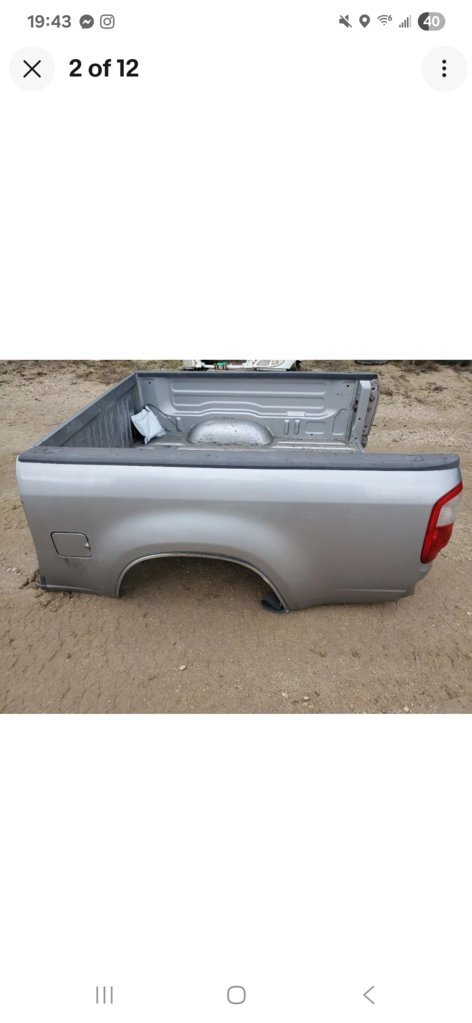

    Oh it is totally different. Silver vs my blue steel metallic. But since I have the model without flares, I'll have to take what I can find

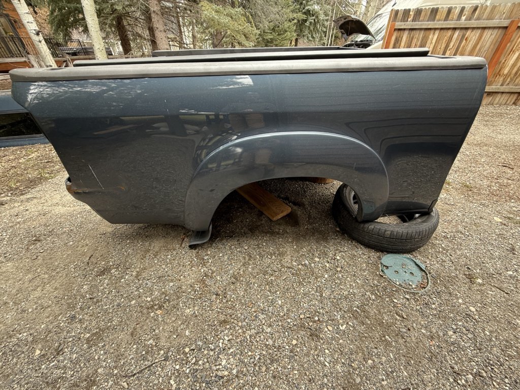

    It's too bad you're so far away. I literally just swapped my bed for a new one and am trying to sell my old one, which is blue steel metallic. But there shouldn't be any difference between 2WD and 4WD beds. 4WD stuff is all up front.

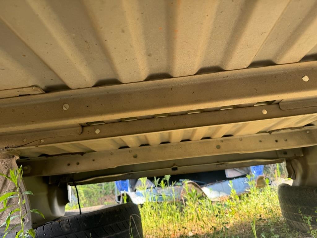

    Yes, I'm fully aware of the differences between the bed for access, double, etc. Here are some photos. The tail lights should be indication enough that it is double cab. My only concern is if there is some weird thing that makes a 2WD bed different. I have the vin number of the bed I'll have to run it through my dealership to double check.
    Also, looks super clean underneath and only surface rust on top

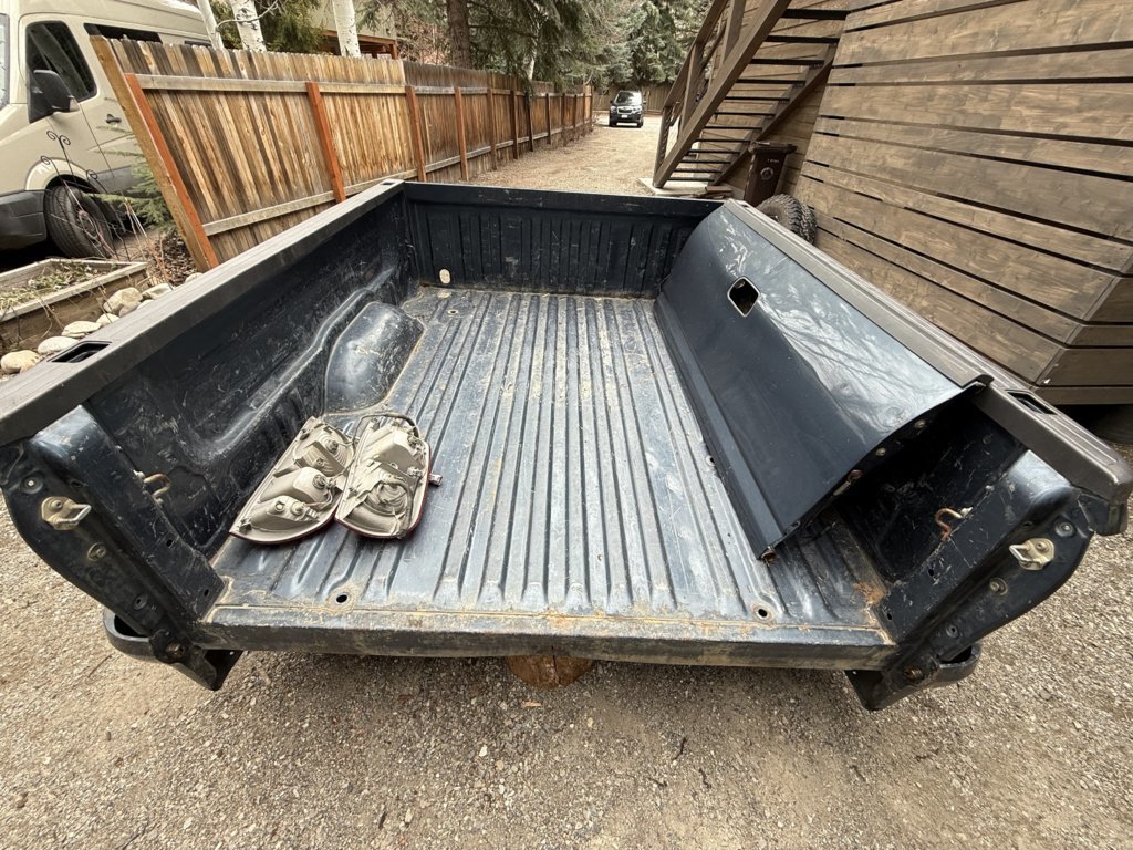

    This one isn’t in quite as good of condition but it’s the same color… just located in Idaho.

    Only issue is that it has the fender flares, which most double cab have. Mine does not, which makes matching the body much more tedious. If it were the same body style, I'd probably inquire about freight shipping. Thanks anyway

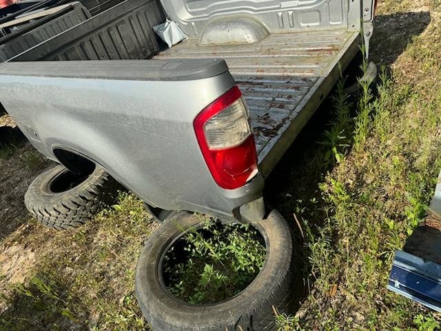

    Found it at an online salvage yard. Had them send me a bunch of pics. Almost decided to wait, but it was a good del and figured i might not ever find another without flares. Good luck. I initially found it on ebay

    Same issue @jpink had, IIRC. He eventually found a bed w/o though. It's tough to find, I was keeping eyes out in my area when @FirstGenVol mentioned he needed one, ideally in black. I setup SearchTempest to look and hit www.car-part.com once or twice a week for 3 weeks with no luck.

    Freight shipment arrived early today. Luckily I had two other guys in hand to lift it off the flat bed trailer.
    Going in for painting, but the under side of this thing is clean as he'll. Almost zero rust. The plan is to coat the bottom it with Eastwood encapsulator and lather with 5th wheel grease before I recount.
