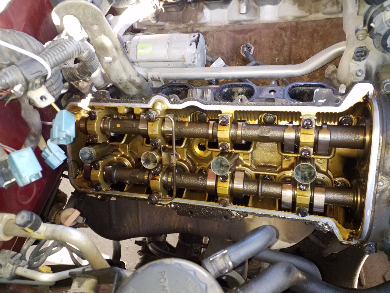

    2006 Toyota tundra double cab 4x4 4.7 liter

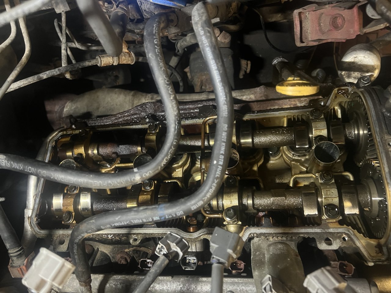

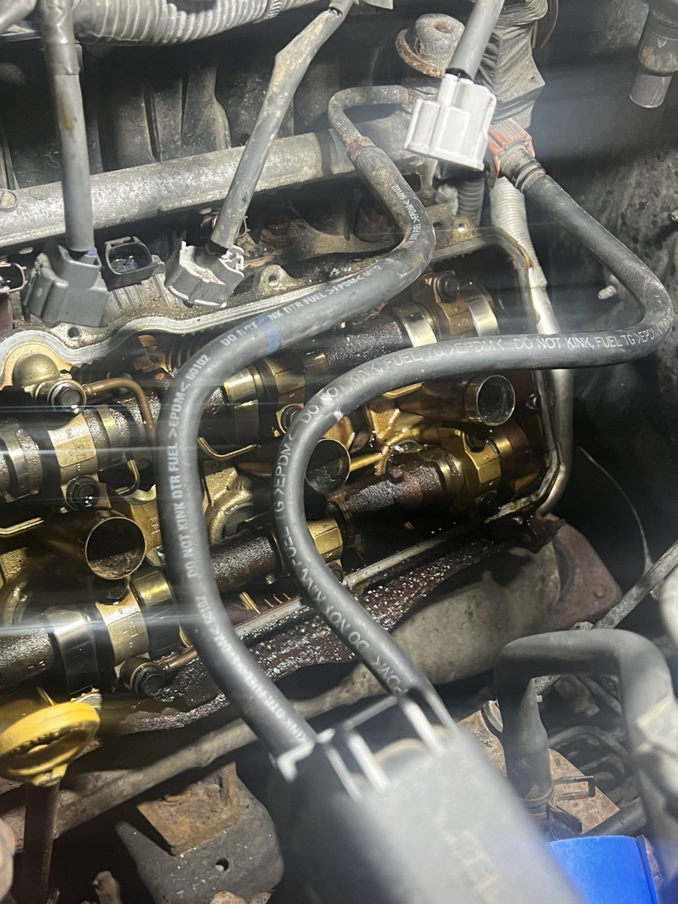

    Any idea why the passenger side looks clean but drivers side looks like it has been getting hot!

    My driver's side rear most cylinder (#7??) looked a little hot as well. The rest looked shiny silver and brand new at 214k miles.

    I have yet to see a 2UZ-FE on here where the driver's side head isn't more cooked than the passenger side.
    I'm sure there's a reason. Maybe it's because of the oil fill tube holding steam, which causes more varnish in the driver side head when that steam drops and cools the top of the head? Or something with the PCV valve being on the driver valve cover only?

    It was my initial suspicion, but I've seen quite afew guys on here with froth built up in their oil fill tube, mostly from the short-trip driving crowd. A lot of moisture makes it up into that oil fill tube if you don't get the engine hot enough, long enough to bust that all steam the way out. Steam cools pretty fast and clings to whatever's in the vicinity.
    It may very well be a combo of both, though.

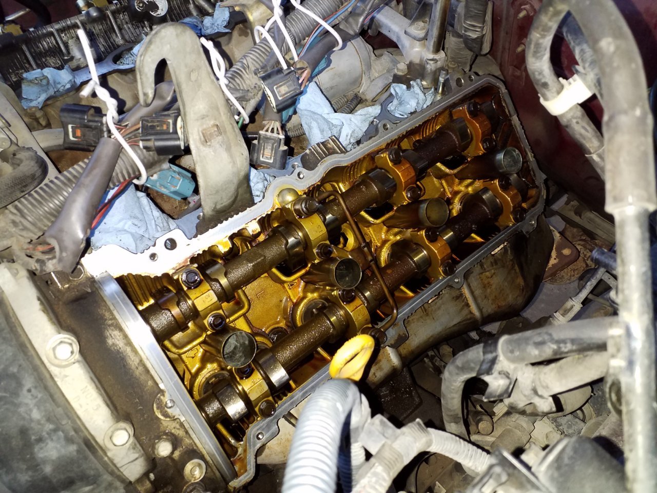

    Now I'm curious. I'm going to be doing my valve cover gaskets soon. I'll post pictures!

    That's weird, mine looked about the same.

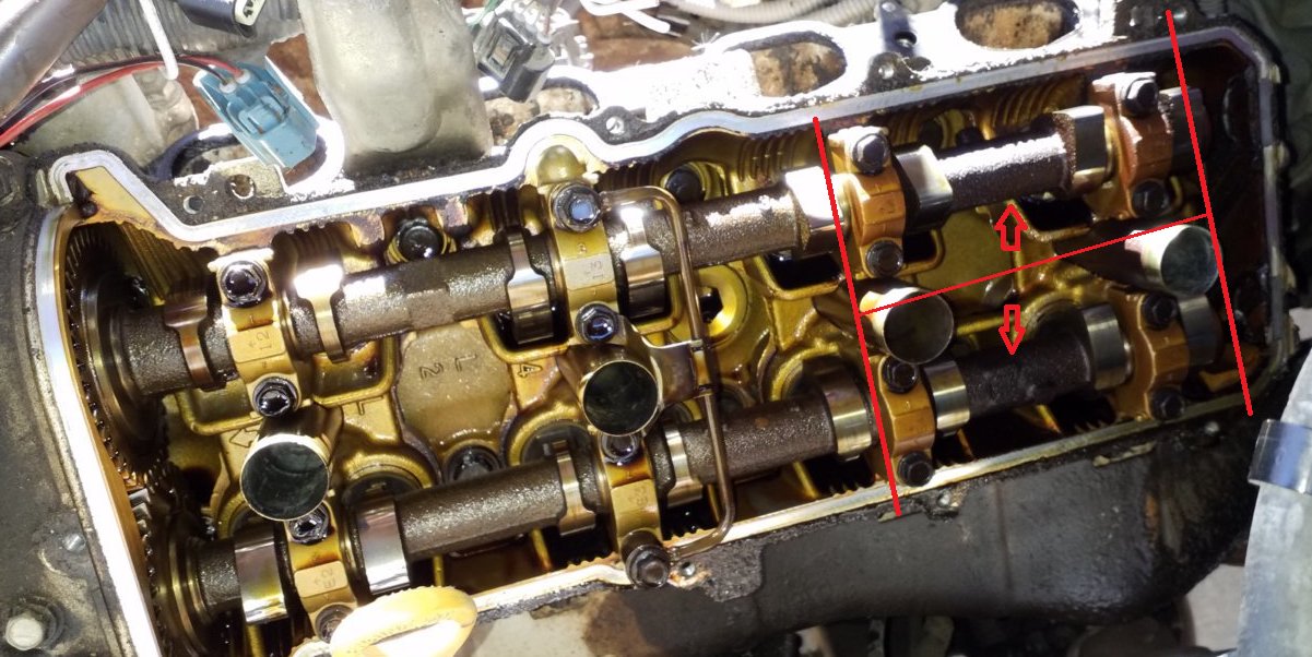

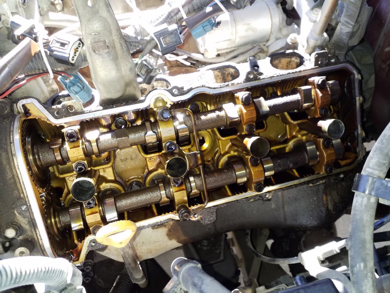

    Look at both cam shafts between cylidners 5 and 7. Significantly more crusty. Passenger side, cyl 2-8, totally uniform all the way across. Totally weird, but it's consistent: Drive side almost always has more buildup, and the only time I haven't seen it are on high-mile trucks where most of the miles are hwy.
    EDIT: Specifically, compare between 1/3 compared to here between 5/7, way more varnish. Hell, even the cam caps are darker.

    Yeah, now that you mention it I see it.

    Good thoughts. The PCV is forward and the filler neck is aft/rearward where most of the folks seem to have that varnish/discoloration. Need to follow @FirstGenVol ‘s PCV replacement post!

    I will say though, Ironman looking damn awesome for his mileage. That looks like a 100k mile engine to me. Good job.

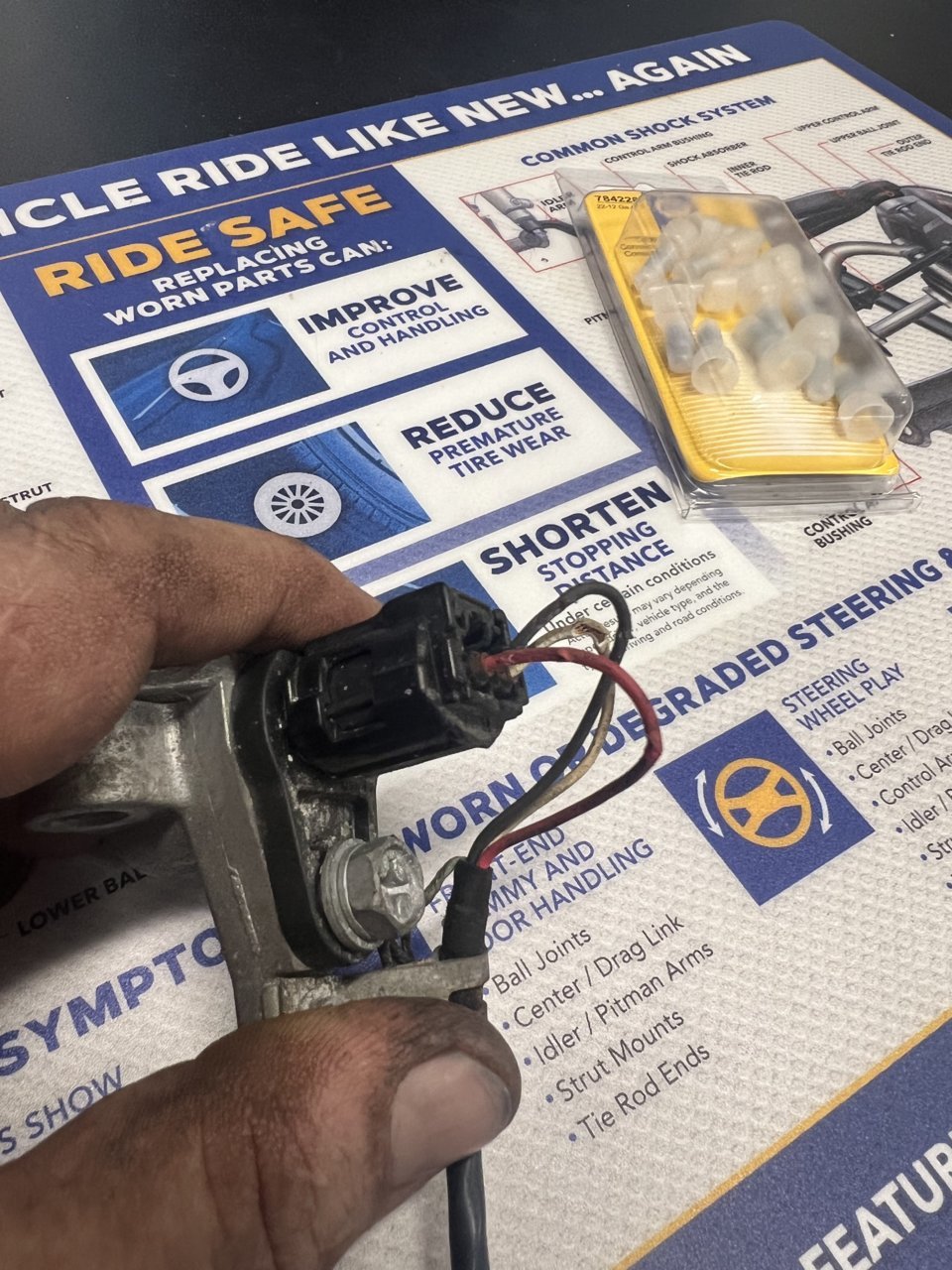

    Good and bad news. I retapped the valve cover bolts and got that all installed. I verified TDC putting a stiff wire in the number 1 cylinder and it was on. I found a nick in the wire on the cam sensor so I cut and spliced the wires. I borrowed a 6000 dollar code reader and was getting the code p0340 and 345. After splicing and putting it back in the code went away so I put it all back together. Tried to start it and nothing and the code came back. So I’m thinking it might have fried the sensor or something else. Does anyone know if the sensor is bad if it will not let it turn over whatsoever or would that point toward something else? The sensor is 140 dollars so I hate to just throw a part at it. I’m going to read up on testing a hall sensor. Any other ideas?

    Cam position sensor or crankshaft position sensor? Was it inside the cam cover, or outside? Sorry I keep asking, but people get these bass-ackwards a lot.
    A lot of sensors use shielded wiring, the crankshaft position sensor is one, IIRC. They don't tolerate splicing and will almost assuredly throw codes if you make the mistake of cutting and re-splicing one. I've seen people splice the cam sensors and have it work on earlier-model 1GT, but it was still throwing codes.
    I do remember this one post though, where one guy found his was spliced though it worked semi-OK - dunno what year your truck is because you don't have info in your profile like most other users, but I guess if it's an earlier model, it maybe has the old cam pos sensor without the wire restraint?

    The one that comes out of the driver side timing belt cover that is right next to the water pump. It is an 06 crew cab. 4.7 liter.

    Bummer. And yep, that's clearly cam position sensor. And you're saying it won't even turn over? Not even if you jumper the starter relay?
    And you're positive both coolant temp sensor wires are plugged, not cut, all other connectors on stuff are firmly plugged in, like, you pulled on each one to test it, and you checked the batt cables, and fuses in engine bay?
