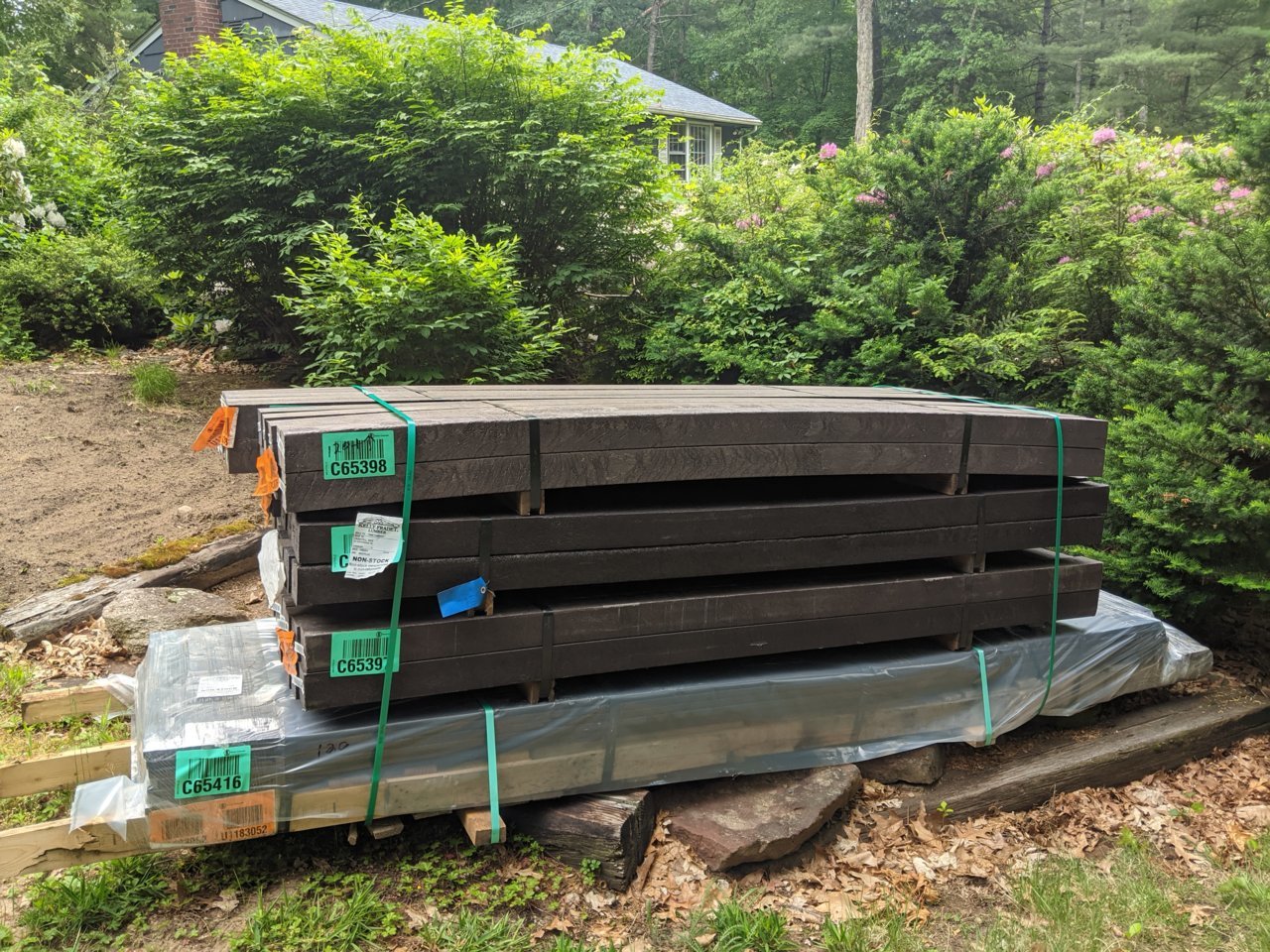

    What type of posts are you using?

    2000 Tundra SR5
    They're solid plastic, made of melted milk bottles and then dyed to look like wood. Heavy as hell but won't ever rot.PXL_20210604_132418318.jpg

    2000 Tundra AC SR5 4WD, 4.7 Automatic
    Interesting. I've never seen that product before. Are the posts solid or hollow? Is the material similar to Trex synthetic decking?
    I'm finishing up installing 400' of t-post fencing around my uncle's garden. I've never installed fencing before so it's been a learning experience... but it's gone pretty smoothly. The biggest thing I've learned is that it's all about bracing the corner posts.

    2000 Tundra SR5
    Solid and similar to Trex but probably twice as dense. Definitely right on the corners, I'll be concreting those in and another in the middle of each run since they're 100ft+ each.
    https://www.bestpl.us/4x4
