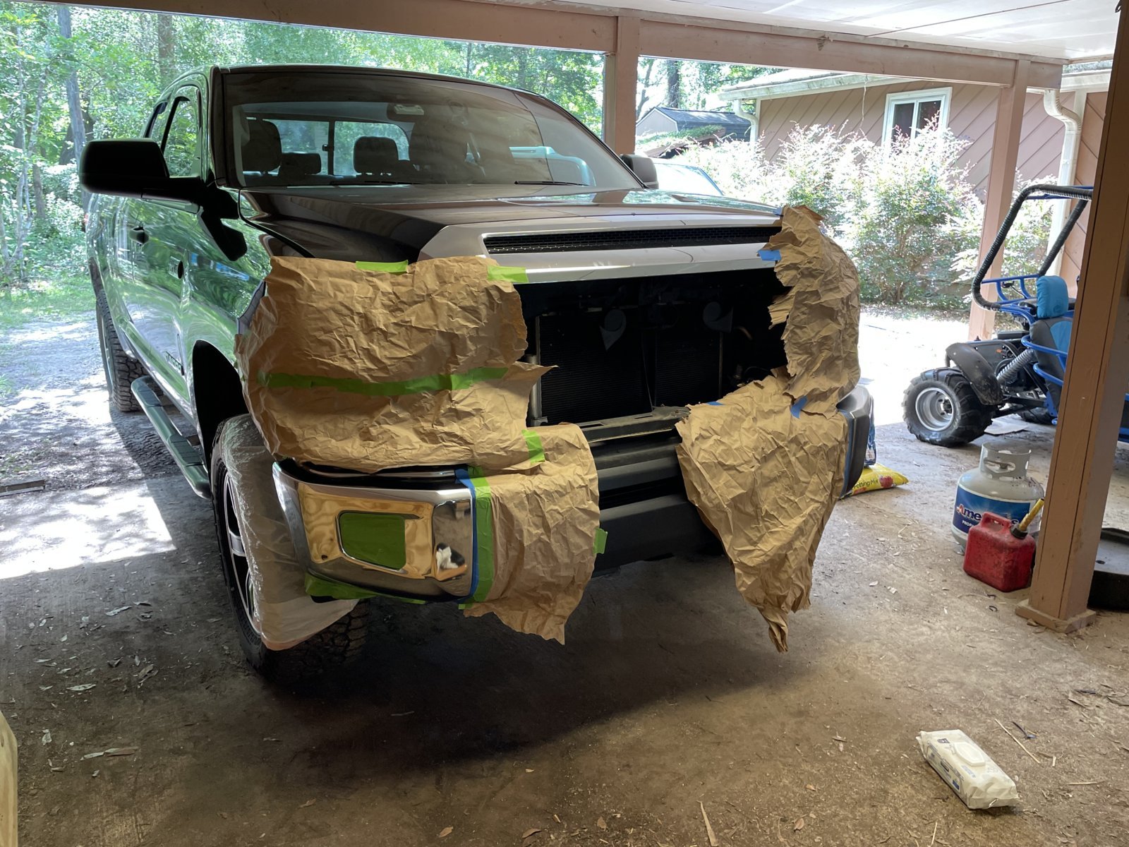

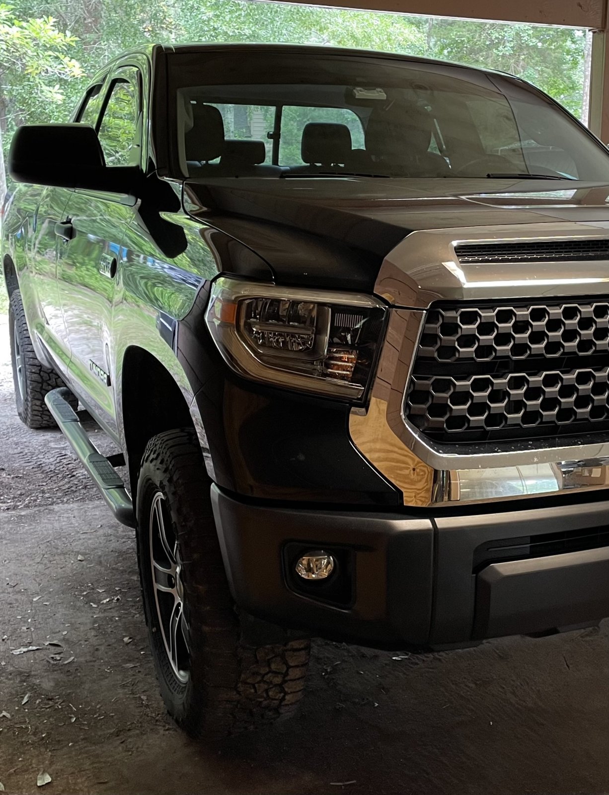

    I just did the LED headlight swap and was a little aprehesive about removing the grill, etc. Turns out, it really isn't a big deal at all and the improved performance and appearance are well worth the small effort. Also took the opportunity to plastidip/spray can the chrome bumper ends as a trial before spending $$ on bumpershellz.
