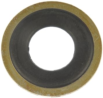

    its a good idea to replace it, I personally use the metal and rubber style and replace if it looks damaged[​IMG]

    Is that a dealer part or a parts store part? Mine didn't appear to be damaged and it's not leaking at all but it seemed like something that should be replaced.

    It's from a parts store, they all have them. They seal better don't have to worry about leaking
