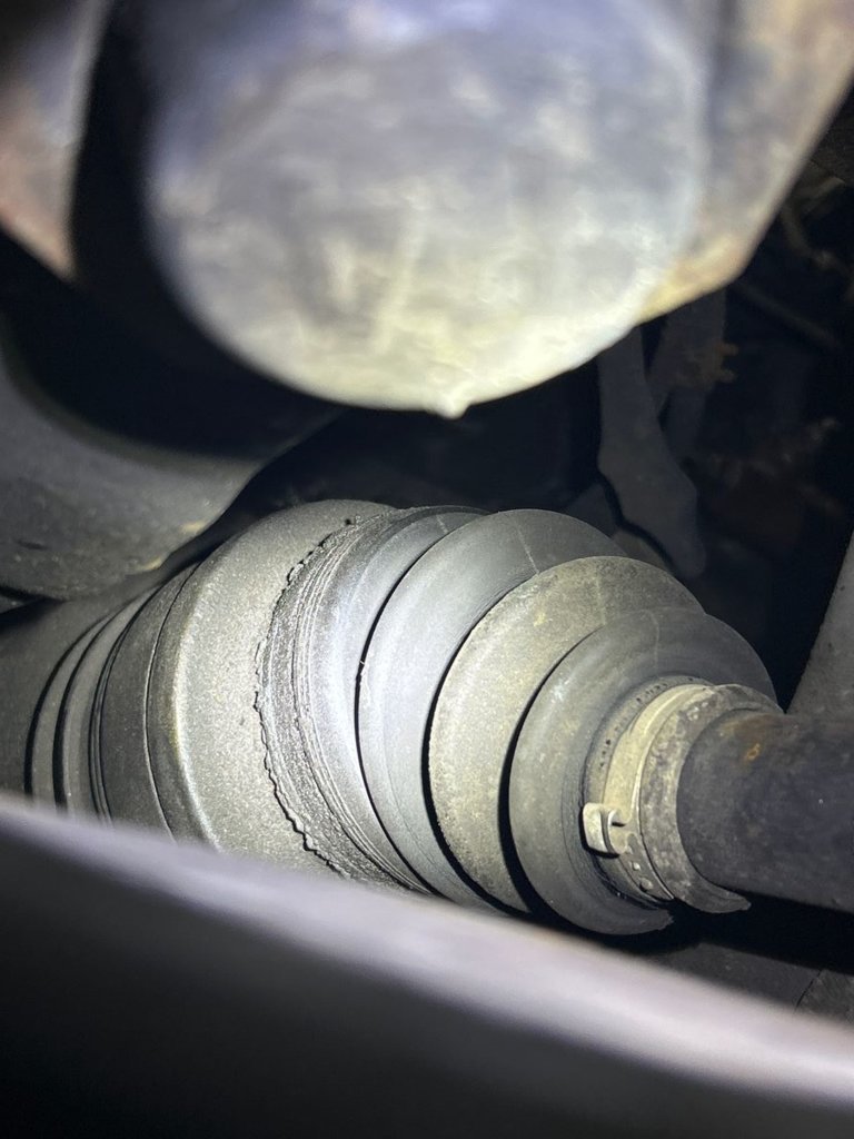

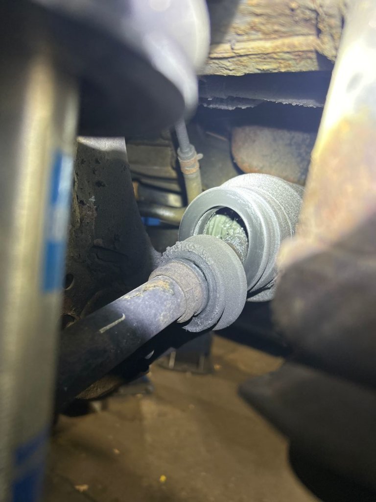

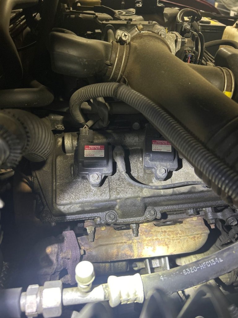

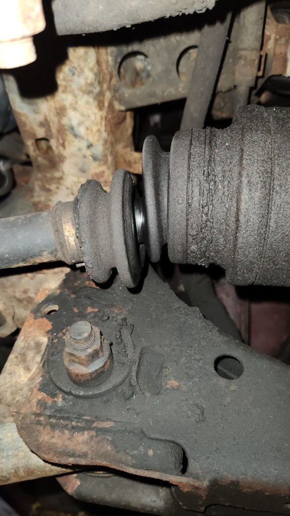

    Wow wee, that eagle titties high. It looks like they got you twice on a few of those things with valve covers and front axles. Usually you can just snug down the bolts on the valve covers and stop the leaks for a bit, but replacing the gaskets and spark plugs is cake. We'd need pics to see. I'm betting your CV boots are slit and slinging grease. They could be shot though. We'd need pics to see. same thing on the steering rack. Could just be loose bellows and/or bad tie rod ends. We'd need pics to see.
    Get us some pics of these areas and we can give you a better run down. How are you mechanically? Got some tools? Not a lot of space though living at a high rise. What area do you live in and can you find a good independent Toyota/Lexus tech? I'd take it there to get a second opinion.

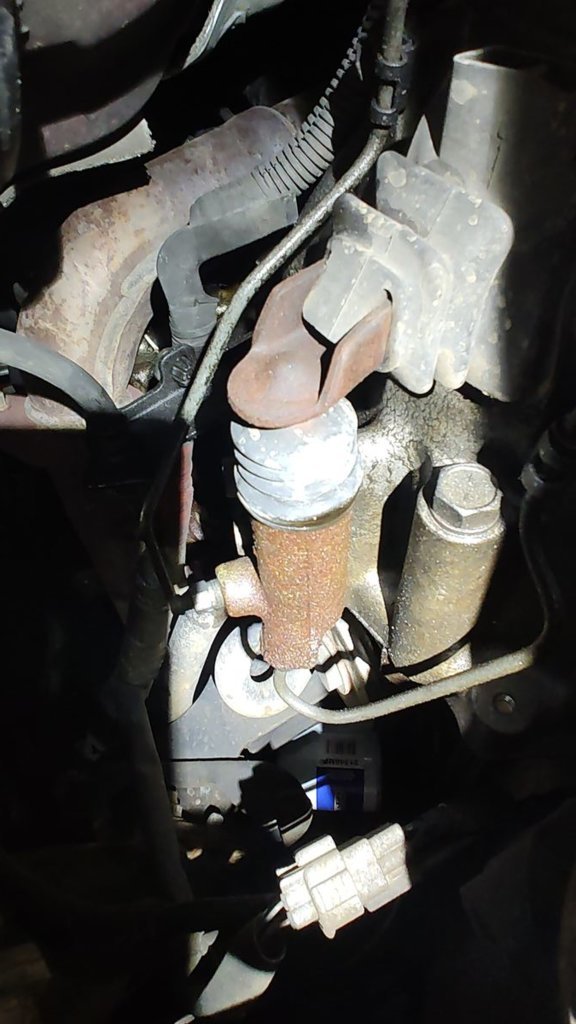

    My slave cylinder is also leaking. I have some tools and a friend with more (and more mechanically inclined). I can follow youtube videos well enough. Like KNABORES said once the weather improves we can tackle a lot of the repairs

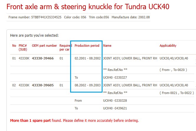

    My truck was manufactured 03/03 according to the sticker on my door. I am looking at LBJs and saw this post: https://www.tundras.com/threads/lbj-question.154344/#post-3839655 and this post https://www.tundras.com/threads/lower-ball-joints-part-numbers.97100/.
    According to autoparts.toyota.com both of these part fit, although I am not sure what the difference is. From the first post these wouldn't fit.
    According to the second post this is the LBJ I need, but ourismantoyota won't tell me if it fits or not:
    Anyone have any ideas?
    Does anyone have specific recommendations for CV axle? This post used napa but there are clearly strong opinions on OEM for LBJs so wondering if there are similar opinions for CV axle?

    Please see this informative reply from @BubbaW, the tool he suggests here in reply #5 should help you narrow it down: https://www.tundras.com/threads/lbj-question.154344/#post-3839655
    I DO NOT recommend using the Toyota Parts system to look up your parts. Please, use the EPC tool suggested in the sticky thread section.
    It's very common in the parts system to have multiple parts. For example, here's one I found recently, where the person had a 2003 truck, but his driver door sticker showed it was manufactured in August 2002. Unfortunately, as you'll see in the EPC, that was the EXACT month Toyota changed production on the LBJ, one part was for trucks built up to August 2002, the other starts with trucks built in August 2002. This is why tools like the one Bubba linked are so vital to figuring out the right part.
