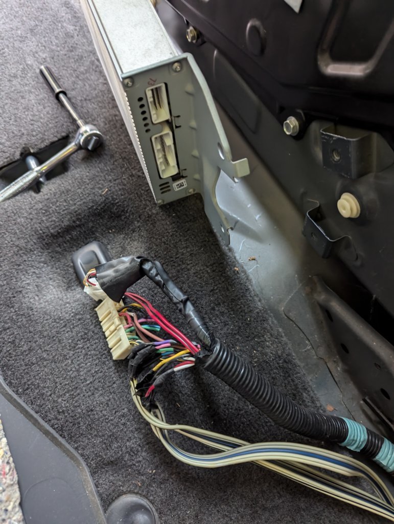

    I am in the exact situation since buying my '05 DC JBL tundra in May. Some jack wad cut the wires at the Amp and behind the headunit. I had the metra harness all ready to go but then looked at a hack fest of wires and electrical tape......dayum! I've had other maintenance to knock out first so I've been listening to my phone or the wind whistle as I drive lol

    Did they at least leave the plug inside the amp with some wire tails? That way you could just get a crimp kit, re-terminate all the wire ends, then deipin/re-pin one wire at a time into the connector, matching each color as you go.
    I don't remember what end terminators you'd need but I bet @daveeasa does.

    Fortunately I do have the terminal connections and I'm planning to do it this weekend. It does appear fairly straightforward by the amp although I have minimal experience with car audio. Like you said, just pair and solder accordingly to color. I'm more concerned about the mess behind the radio. It had a 16pin connection that was spliced in which I removed and tried reconnecting to a 20pin connection without putting the wiring back to factory. It didn't work and then I set aside to do other maintenance. I might be checking back in with you here for advice PXL_20240902_221201239 (1).jpg
