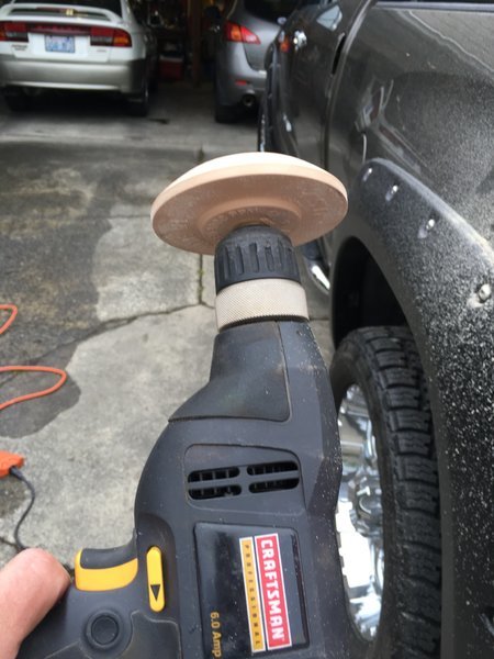

    I searched for and found this thread because I wanted to remove the TRD stickers from my 2008 Pyrite Mica Tundra. In my view, they are ugly beyond the definition of the word. I tried the fingernail and Goo Gone method, but wore myself out after 2 hours with not much result. So I found out about the paint stripe removal wheel made by 3M. (3M 03614 Adhesive Eraser Wheel). I bought a cheaper model at my local auto parts made by Astro Pneumatic Tool Co. "400F" model.
    It ripped off that sticker in about 20 minutes per side to get the sticker off, followed up by using 3M Adhesive Remover on a micro fiber cloth. The wheel did NOT burn through the clear coat or mess up my paint. I also used it to remove the residual glue after I removed the Limited badge off the rear doors.
    If you use this wheel, I highly recommend wearing safety glasses and a particulate dust mask.
    I followed up with a good wax and I love the look!
    As you can see, it makes a huge mess.
    The finished product...
