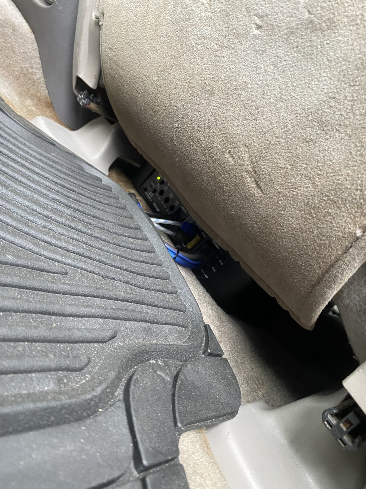

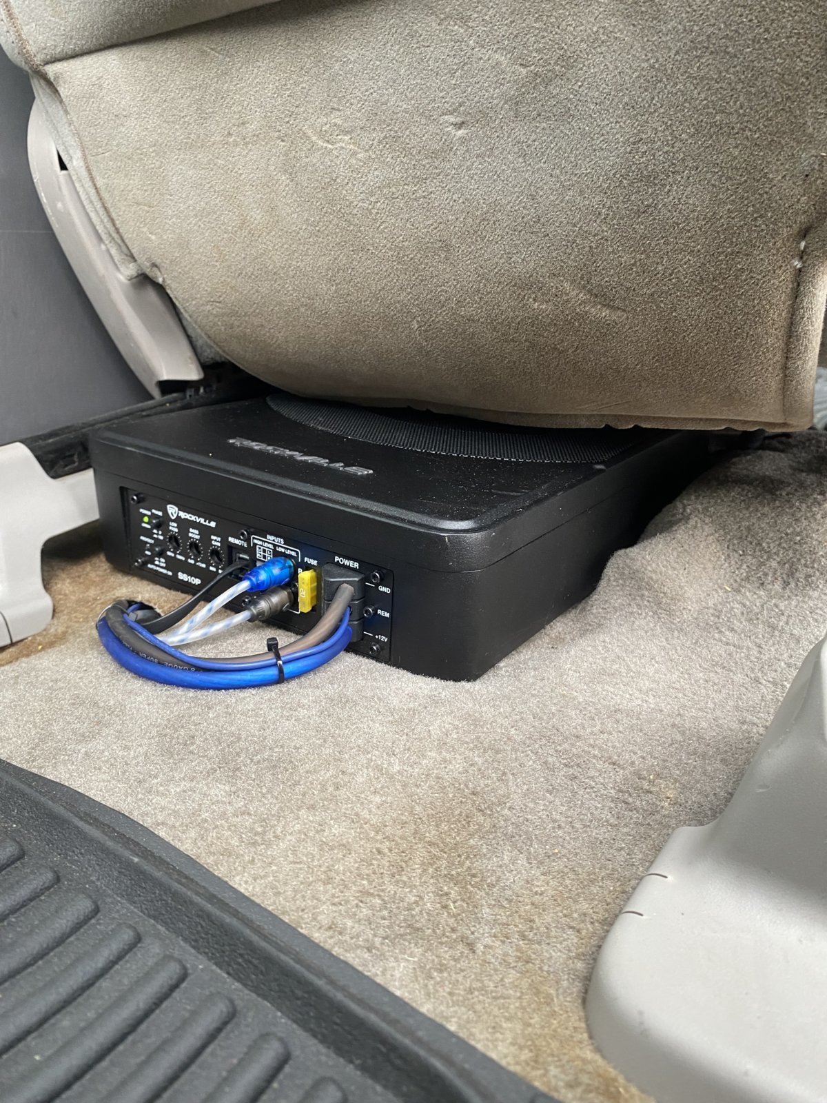

    I’ll add to this. This is a Rockville 10” underseat sub. It took some modification to the seat (removing the rear bar on the under side of the seat) and removal of the vent in order for it to fit perfectly w/o losing any adjustability to the seat. IMG_4106.jpg
    if you keep the rear bar under the passenger seat you’ll lose most of your seat foward/backward adjustability

    AAAaarrrrgghhh ferrule those power/ground wires bro! :annoyed:

    All of these ferrule kits you'll find on scAmazon are basically the same product resold under different names:
    https://www.amazon.com/dp/B0B23V7ZQJ/
    It's work picking one up. Looks like you're running 8awg? I prefer using red and black, but I believe that kit should have 8awg ferrules, maybe only in red and yellow, but w/e. You won't use the crimpers on power/ground, only remote and speaker.
