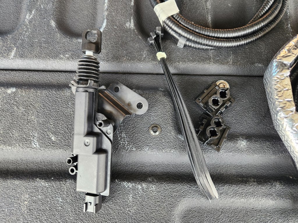

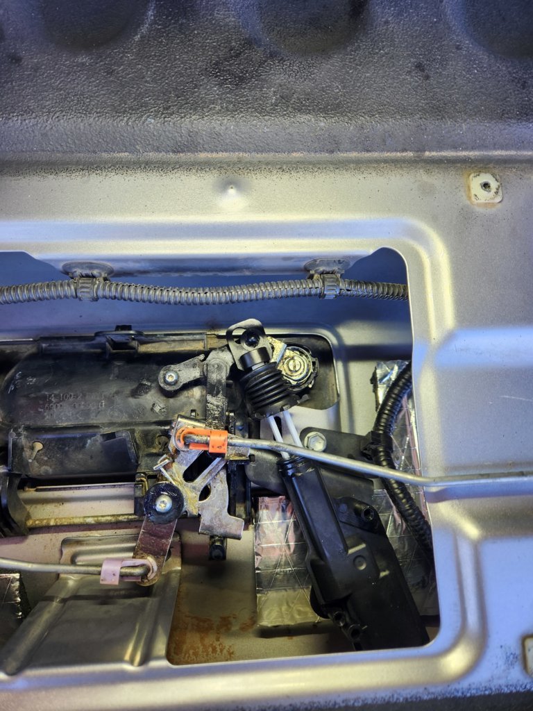

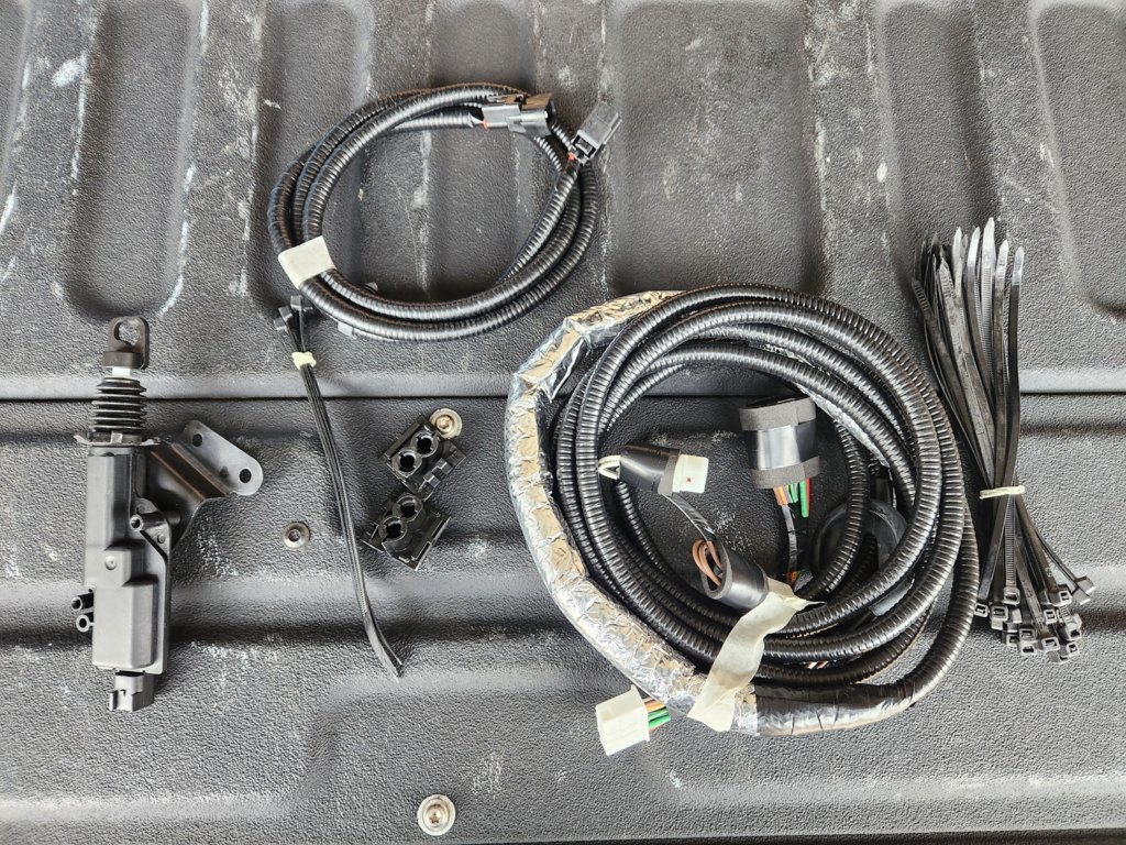

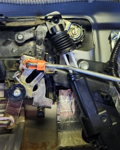

    Update - installed the "OEM style" aftermarket kit and everything works so far. There was a hiccup with the functionality. The short wire pins on the actuator that connects to the longer wire were reversed, so it was doing the opposite when I locked or unlocked it. I just de-pinned and switched the two pins in the harness and now everything works as is. I'll post another update if there's any issues with it.

    Glad it worked out for you..
    Funny when I replaced my old Pop and Lock actuator with the new one, same color wires, it did the same thing.
    Lock/unlock was backwards from the truck, I just cut wires and resoldered.
    Looks like your kit actually connects to the lock mechanism with no slack.
    The P&L just pushes it one way and then the other leaving slack in between them..
    I like yours..:thumbsup:

    Thanks. Yes, just a very little slack on the mechanism. It's not too loud either.
