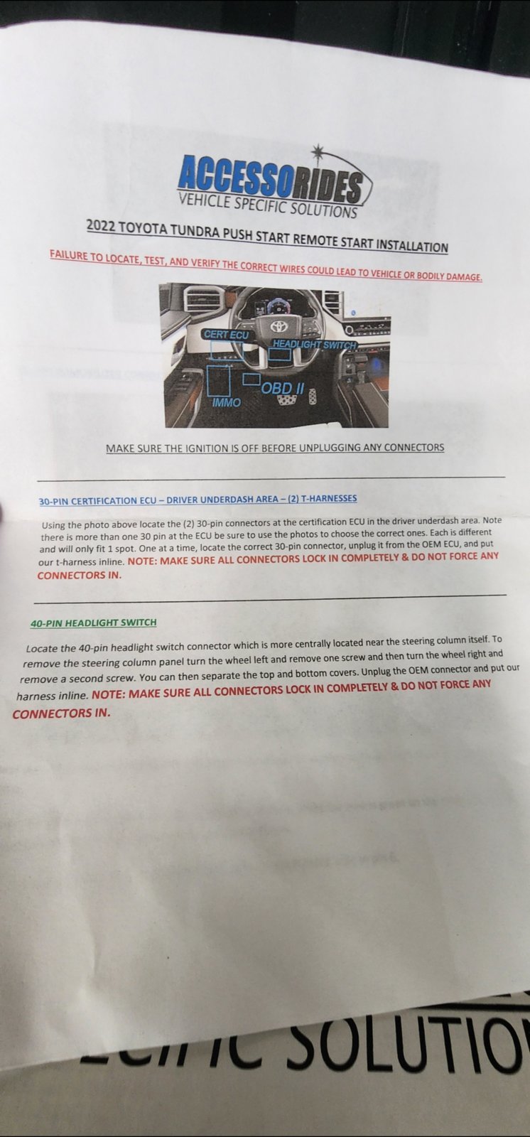

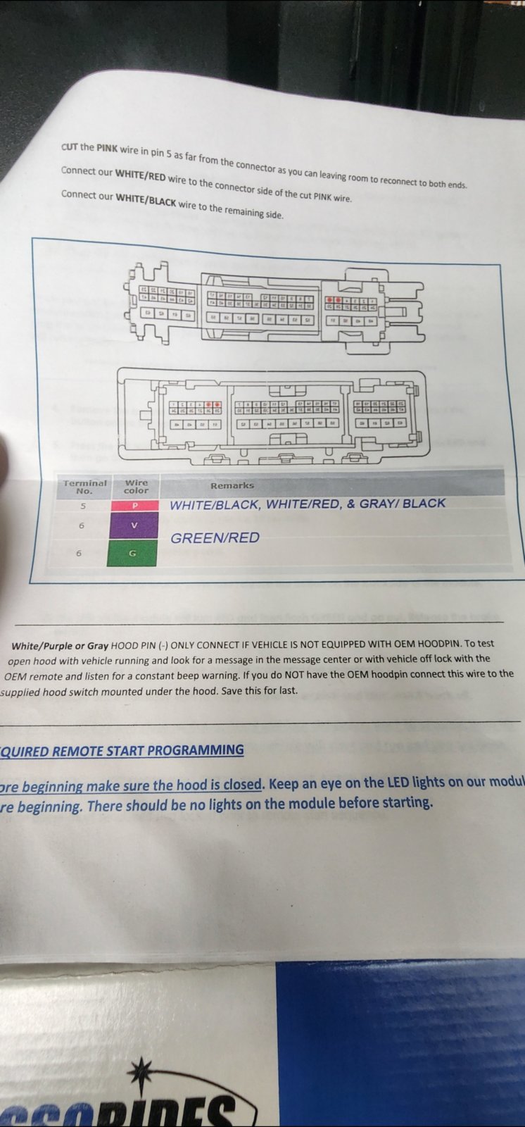

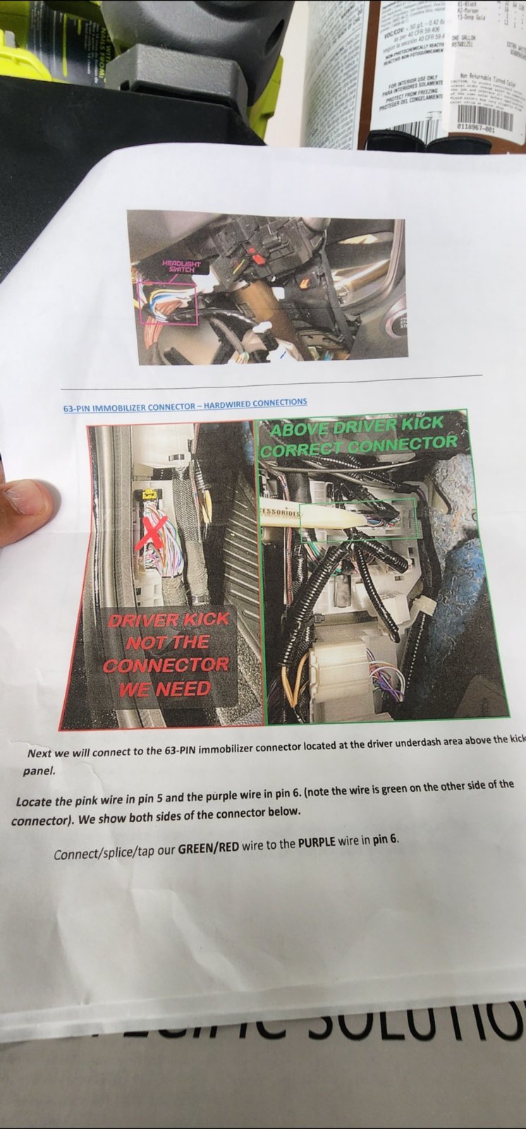

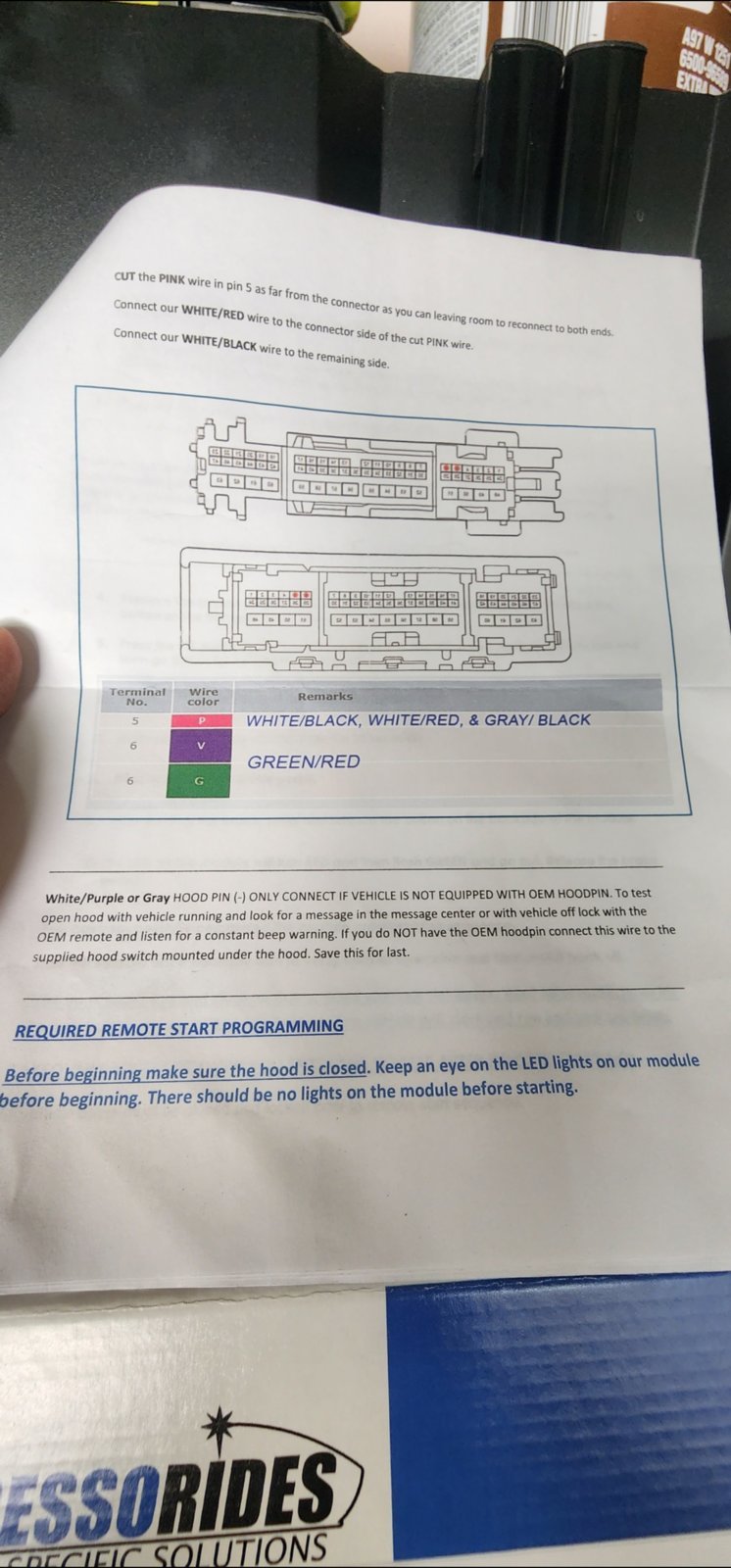

    You have to remove the kick panel, panel where obd2 port is at and the steering column panel as well. Nothing crazy and their instructions are crystal clear. I don't have a pdf of the instructions, sorry.
  19. Jan 11, 2024 at 3:13 PM
    #79
    eddiefromcali
    eddiefromcali New Member
    Mar 14, 2022
    #75818
    2,977
    Eddie
    2022 Tundra Platinum
    100% Stock
    Pics of instructions. I've previously posted pics here of the harnesses you tap and splice into.

    Thanks, man! When it warms up, I'll pull those panels and see how tight these harnesses are. Hopefully the tape can be opened up enough to get at that pink wire to do the cut and connections. Those are some really fine and delicate wires... at least they were on my Tacoma.
    Where did you mount the box? And I assume there is plenty of room in there to semi-neatly tuck away the t-harness.
    I just looked at your other pic and that doesn't look too bad.

    Wires aren't fragile and very easily accessible...plenty of room down there.

    Hey Eddie, this does look really simple compared to past installs. Only thing I need to really check is the hood pin situation. One would think we have one of those already, but I haven't looked. If not, easy enough to install one.
