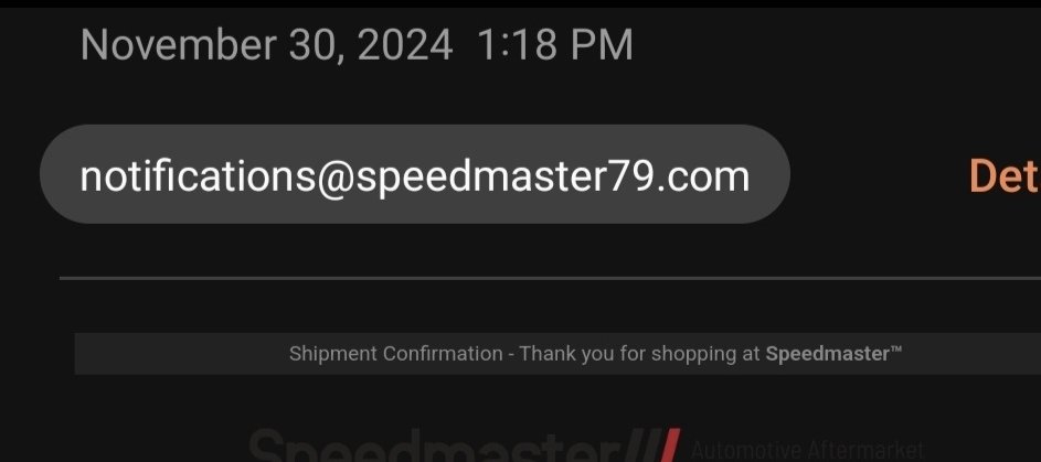

  21. Nov 30, 2024 at 4:19 PM
    #51
    Mdl
    Mdl Hey there...
    Jun 14, 2023
    #98638
    3,660
    PNW, WA
    2007 TRD SC'd
    JBA Longtubes, Snivs 2.0 SC pulley, ASP crank overdrive pulley 6.71 in, DD Full 3inch dual exhaust, IPT valve body, Airbox mod, 4.5inch intake, Denso 750, 450 Walbro, W/M injection, GM 95mm TB, SABM, Camburg UCA, Icon shocks, Speedmaster LSD, Motive 5.29 Gears, Mickey Thompson Baja Legend EXP 35's, Solid Offroad engine and transmission mounts, DIY Traction Bars, Tuning by Snivspeedshop.com
    reywcms and Lemuel1[OP] like this.

  23. Nov 30, 2024 at 4:38 PM
    #53
    Mdl
    Mdl Hey there...
    Jun 14, 2023
    #98638
    3,660
    PNW, WA
    2007 TRD SC'd
    With several threads going I mixed them up. Thought I posted in the 5.29 thread!
    Sorry @Lemuel1 for hijacking your thread...
