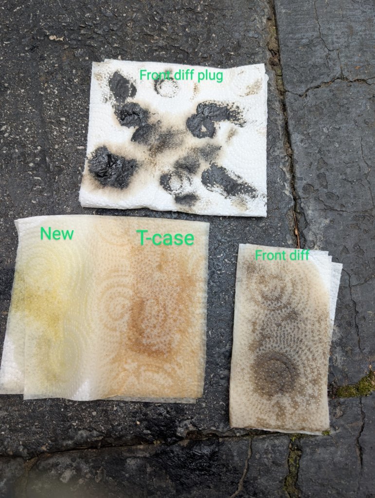

    Changed fluids in the T-Case and front diff a few weeks back. Glad I did it finally after 7 years and 100K miles of ownership. The best deal on fluid is the Wally world Supertech full syn 75W-90 at ~$10/quart. I also used the Supertech 80W90 GL5 oil for the LSD rear diff and the stuff works perfectly with 0 LSD chatter and no need for additives. I have used Motul 90PA and Lucas 80W90 in the past and this is just as good at $5/quart.
    Pic speaks for itself.
    assassin10000 likes this.

    Where's the towel for the rear diff and it's schmear? Damn, no wonder you're not hearing any chatter. You done left it out of the picture. :rofl:

    I didn't bother with rear because that fluid only had 25K on it. I'm responsible dealing with the rear fluid for some reason. That front diff is a pain to refill so I had been putting it off for far too long.

    I'm just ribbin' you. My front diff looked like utter ass too. Almost like water had gotten into it on the bottom half of the fluid, some glitter, pile of slurry on the magnet. Here were my pics for comparison. I did this within my first 10k-15k miles of ownership, and quickly realize I should've done the front way sooner, and rear somewhat sooner. https://www.tundras.com/threads/wha...-gen-tundra-today.2558/page-1549#post-3084622

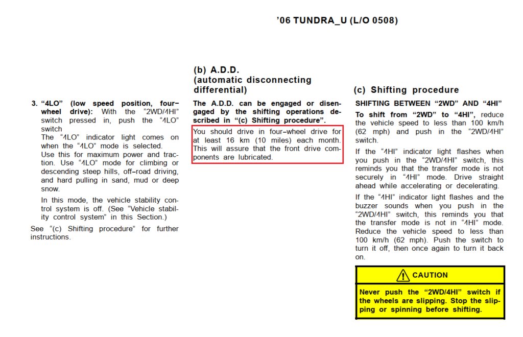

    FYI, if you want the 4WD to continue operating as normal, you NEED to engage it semi-regularly. And you need decent, not-old fluid in there to avoid anything from sticking, seizing, or corroding in place.
    I know, I know, nobody can be bothered to read the damn manual, but ... Toyota warns you about this. If you don't need 4WD, go buy a 2WD. :rofl:
