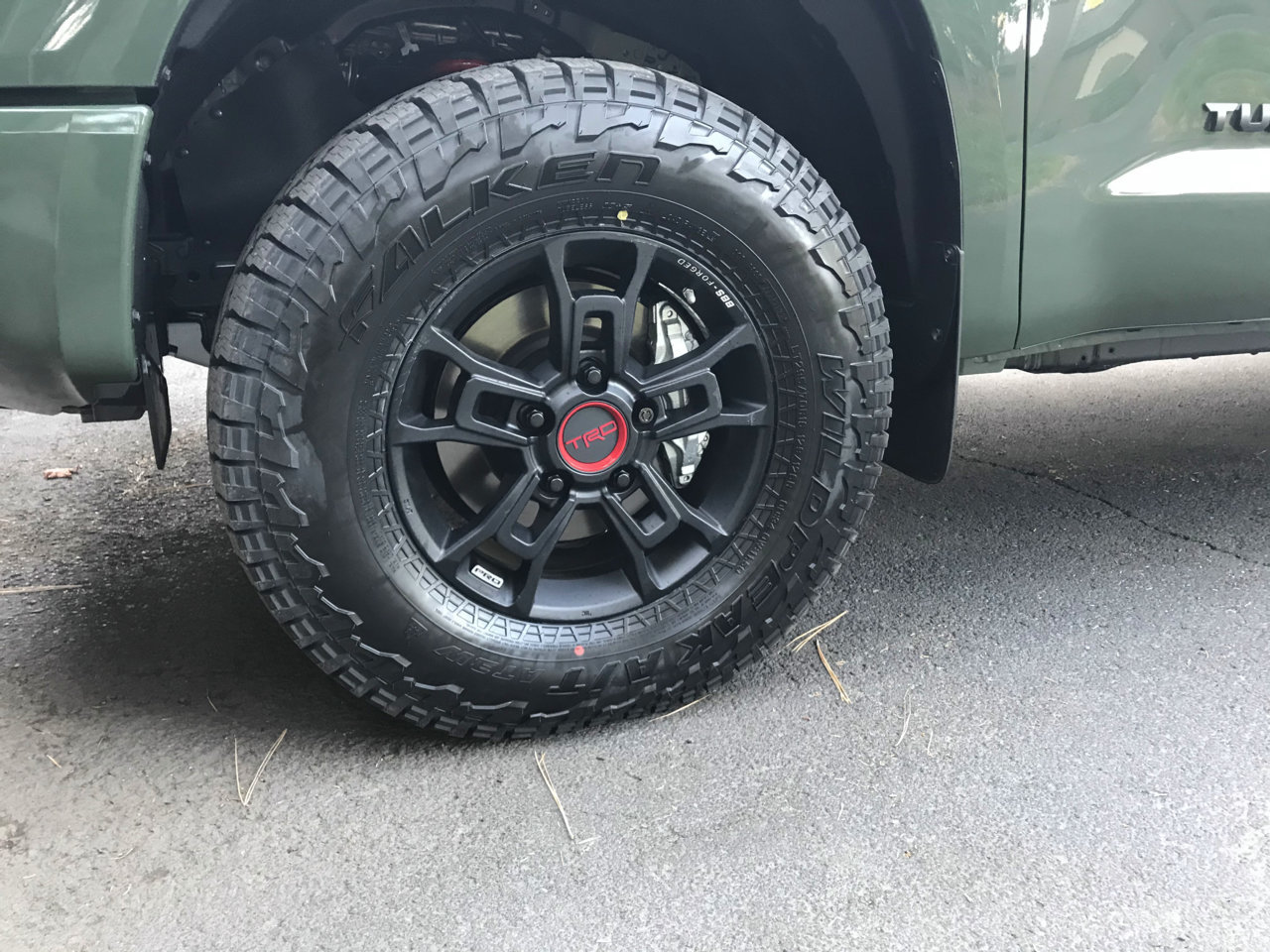

    Here you go Ben.

    Looks AWESOME! Love the Army green!

    Thanks Derf. With the spacers, you may have to push out the front wheel well liners. Some have done that with a heat gun just to bend the plastics. Without the spacers, you will likely have to trim the back corners of the Off Road skid plate. I did that on my previous truck and it was a 2 hr. job on the skid plate including painting.
    I can't really comment on the mud performance. We really only have a few weeks of mud here during snow melt in April and I just put mine on. However, I've heard they are not the best, but clear easily with wheel spin. I don't expect them to be nearly as good as an M/T tire. I found a bunch of reviews on YouTube when I was shopping around and narrowed my choices to the Nitto Grapplers, DuraTracs, KO2's and Toyo ATIII's. Honestly, I don't think you can go wrong with any of them.
    Keep us posted on your progress.

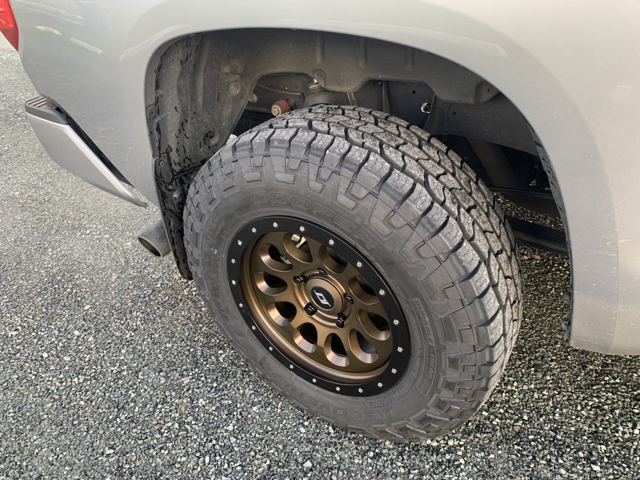

    851AF575-0EC2-4E0C-A677-BFD186A159F5.jpg Cooper discoverer at3xlt You will be happy

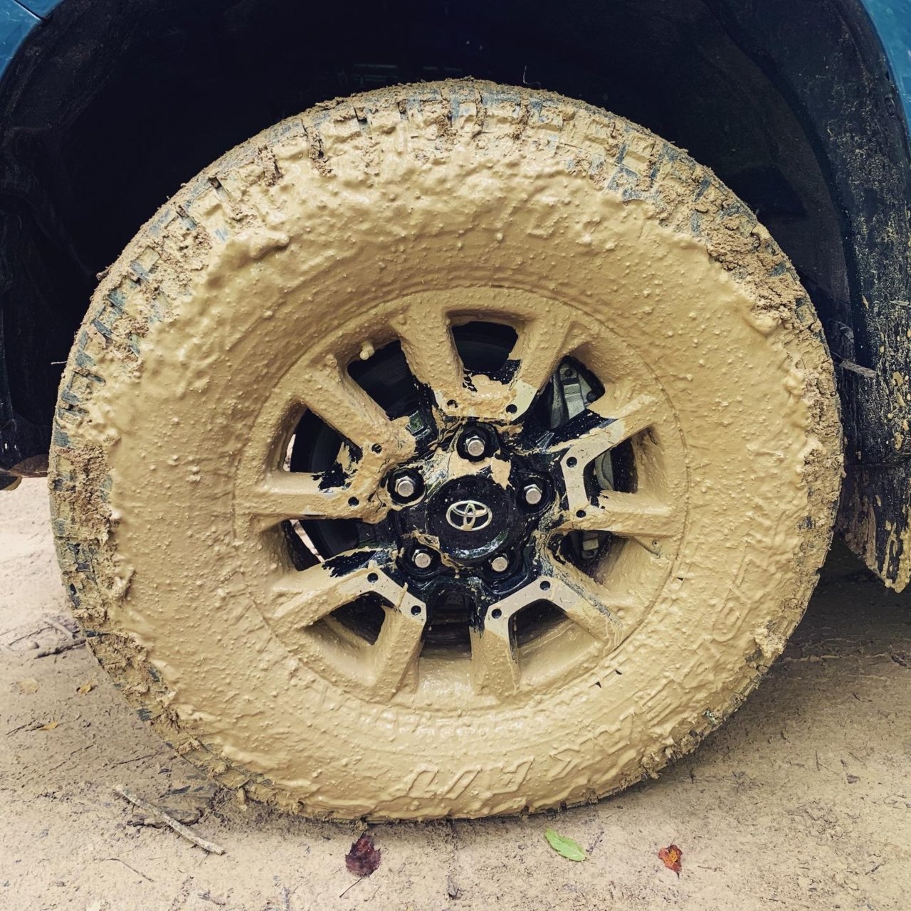

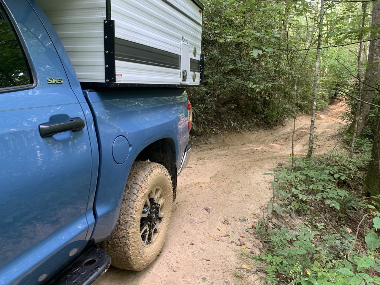

    A2EB568F-BE2D-47F9-B88B-34CD625D65F2.jpg Falken. They’ve done well in mud for me. I’m not a “mudder” but when it’s there I want to have good traction. Aired down to 20 here.24F28370-B48A-42A8-B6D0-04FF80D9FBEB.jpg

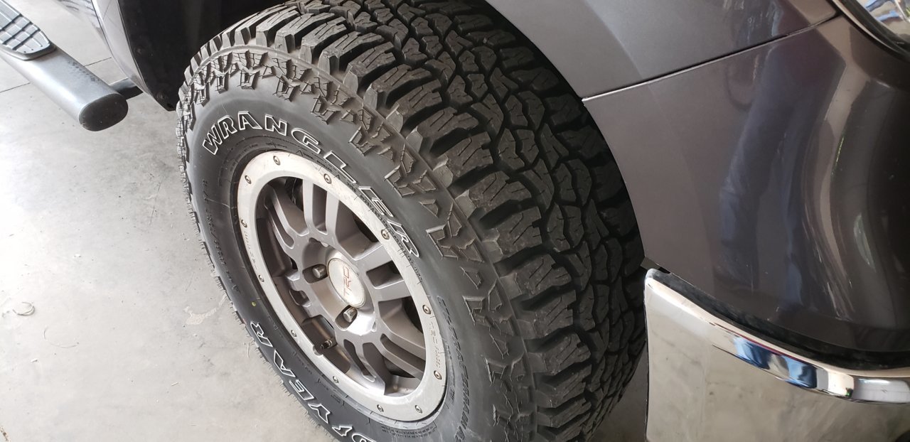

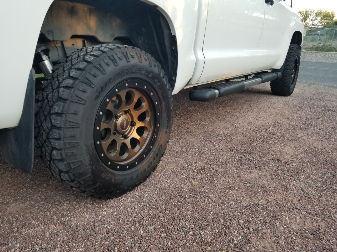

    I currently have the Good year Ultraterrains. They are pretty good in the snow. My previous tire was the Cooper AT3 XL. Same as the xlt just with less aggressive sidewall. They were ok. After 15k miles they got louder and would flat spot after sitting overnight. My next tire will probably be Firestone AT2 in a P rated 285/70r17. This truck doesn't need E rated tires in my opinion. My current tires are 58lbs and the Firestones are 41. That is a noticeable difference in mpgs and acceleration. I dropped 1.5 going from KO 1's to the Goodyears. 20201008_122448.jpg
