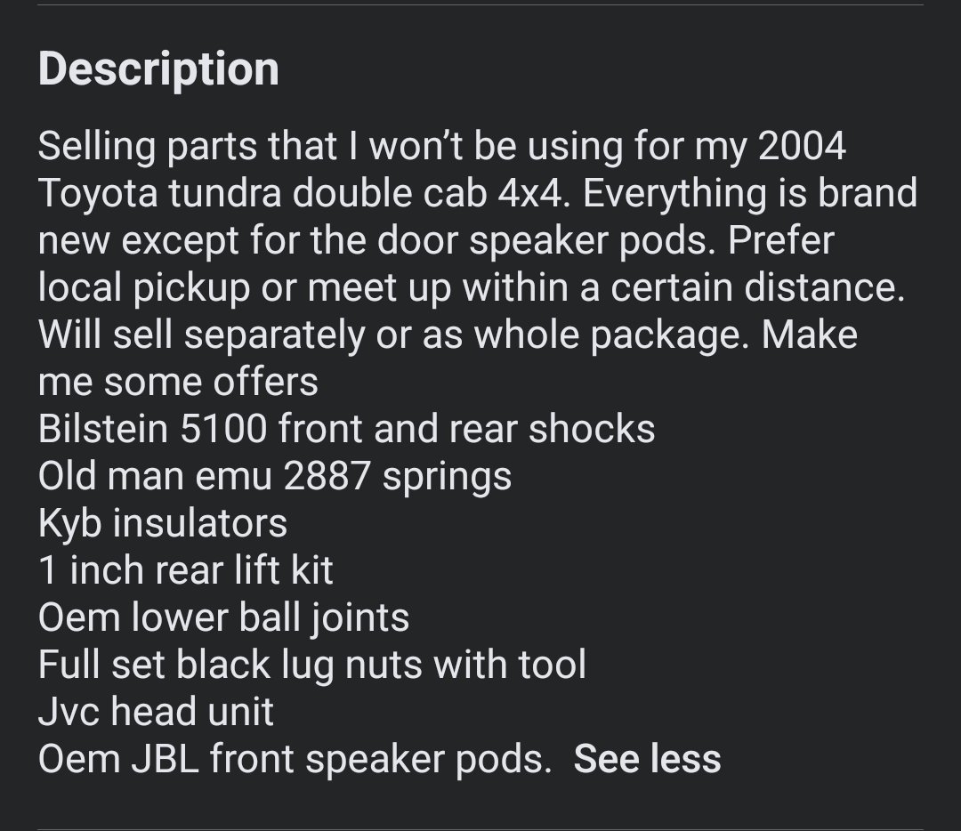

    Would any of this stuff work on my 05 access cab? Everything listed is $750 but he is willing to separate. I don't need any of the radio stuff or lug nuts but if I can save some money and get stuff at a decent price it might be worth it. Just not sure of compatibility between AC and DC. Apologies if I missed a compatability post.

    Speakers: No, the sail panel won't mount and speakers are probably 2ohm
    2887 springs: No, you'll get waaay too much lift on your AC
    5100s: Yes, front and rear, just with a diff't spring
    KYB insulators: Yes, you'll need for any spring
    1" rear lift: Probably, yes
    OEM LBJ: Possibly, need part number
    JVC head unit: Almost certainly yes
    Lug nuts: Maybe? Need more details

    Oh, and $750 is pretty fair. You'd pay that just for the 5100s, front and rear.

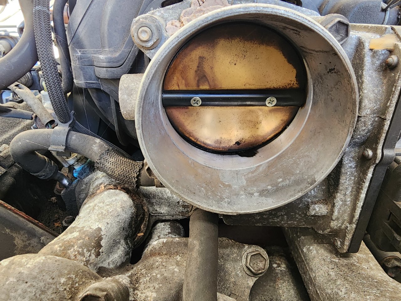

    Starting the break down process and taking my time with each step. Going to tackle the timing belt and valve covers first since they were the most neglected. First up is a really dirty throttle plate...

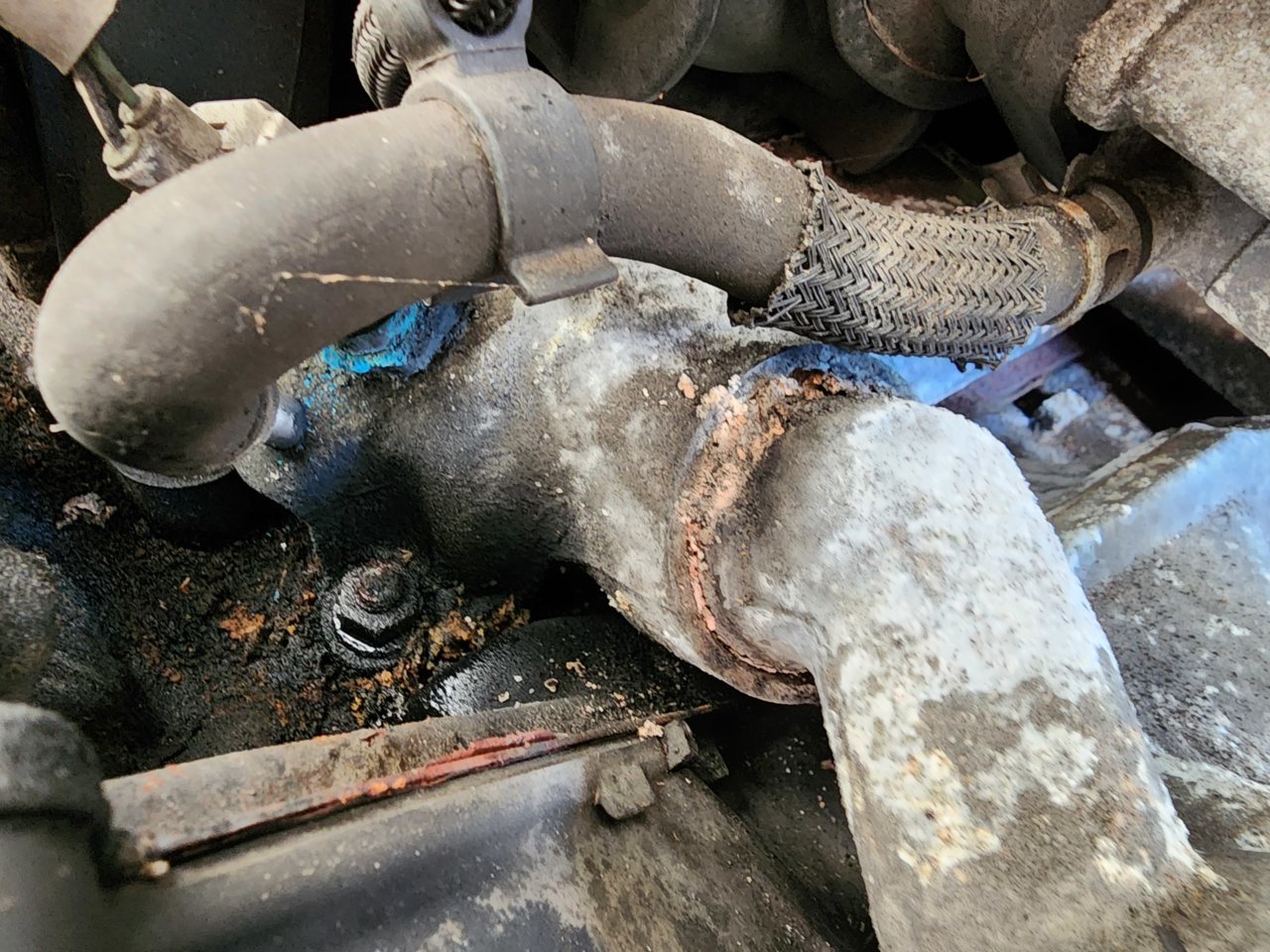

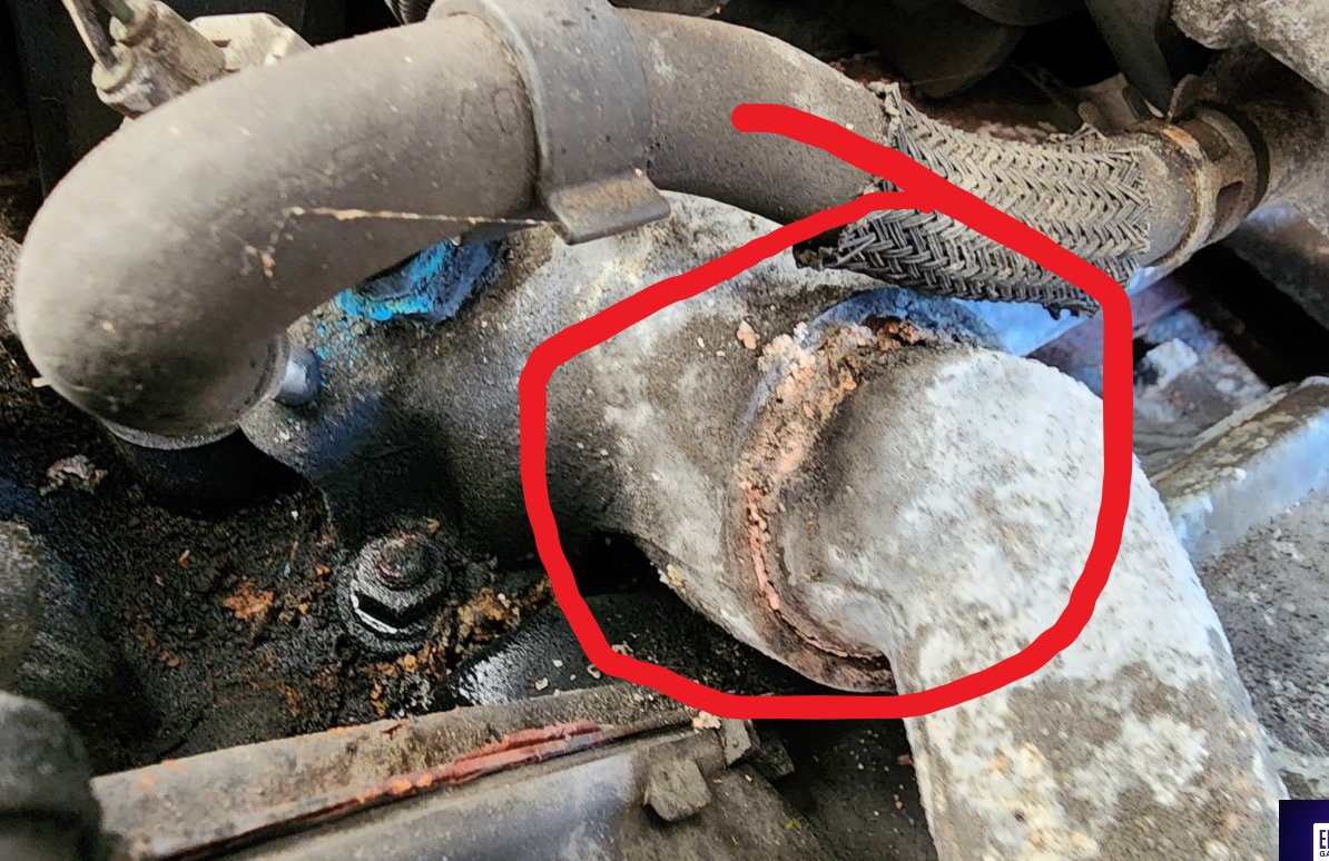

    And finally, is this a leaking thermostat?

    Mud daubers love Tundras at least here in SC. I would cover that TB and clean the engine first. After that use TB cleaner and a rag to clean the TB. Often they throw codes when they are that dirty. You need to replace the o-ring where the coolant is leaking.

    And expect it to run like shit after - if I were you I'd remove the negative battery cable for 10 minutes before firing it back up, just to force the ECU to reset.
    Meanwhile, that leak, I think there's a gasket for that spot and I think it's posted in the 'so you wanna buy' thread. But I've never had to deal with it. It doesn't look like it's severely leaking; what's down in the valley below looks like oil to me.

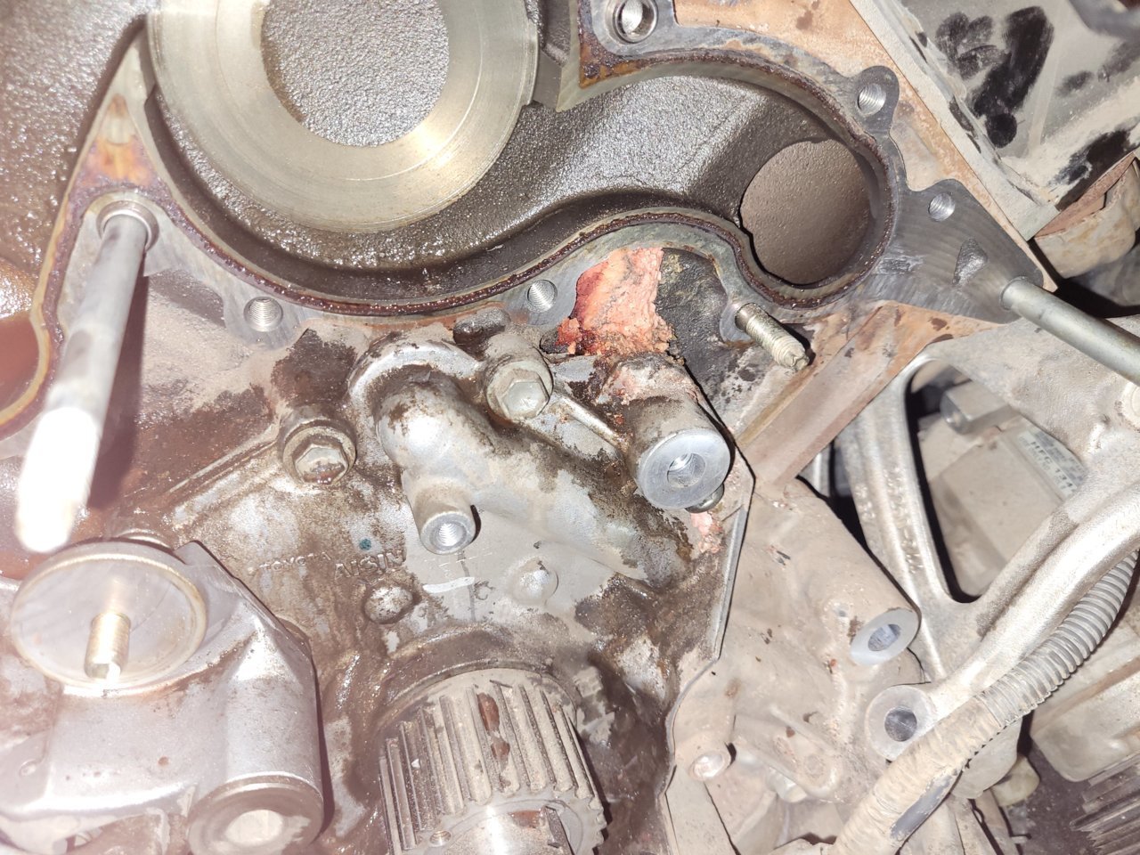

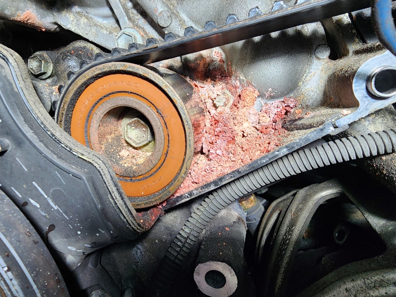

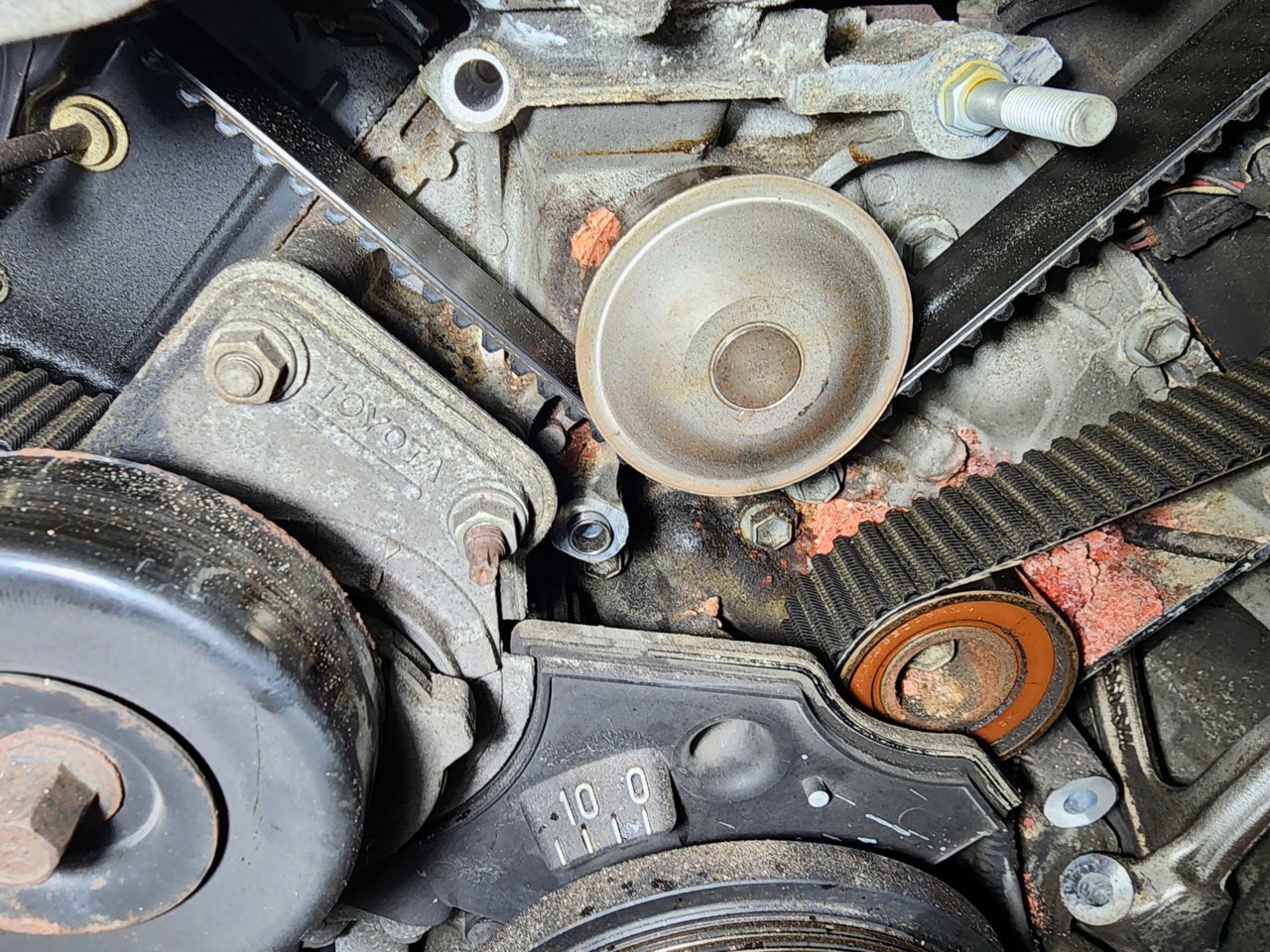

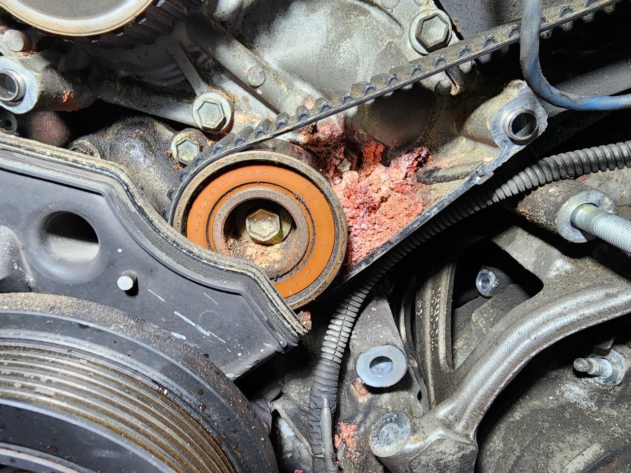

    Wtf is going on in here?!?!?. Please tell me it's not a head gasket leak.
    For reference there is a leak above this to the left a bit

    Tonto cover
    Likely from the weep hole on the water pump. Unless you actively noticed coolant leaking from the area from this area, you're good to go. It's likely your new water pump will leak a small amount from there when it breaks in.
    Clean the old gasket off of the engine block with a razor edge as good as you can when you take the old water pump off.
    This is what mine looked like at TB/WP replacement, no active leak.

    Tonto cover
    Just saw your edit. That's leaking at an o-ring from behind the thermostat housing you should be replacing anyways with your thermostat.
    Think this is what I used. https://www.rockauto.com/en/moreinfo.php?pk=7588444&cc=1426935&pt=2136&jsn=873
    Can leak over time or due to poor installation.
    O-ring sits in here. I put a dab of coolant around the o-ring with my finger.

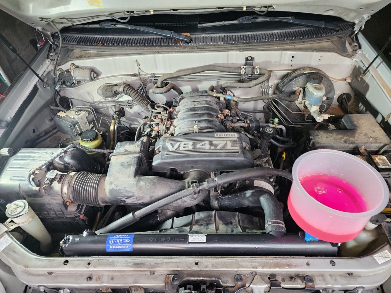

    Ok so buttoned everything up and started the truck.... it's alive!!!!
    Now here is where I'm stumped a bit. I was following the coolant refill procedures as follows
    • Using one of those funnels that clamps onto the radiator I filled the radiator until it was full.
    • Started the truck and turned the heat on to high inside
    • Let the truck run and watched the radiator burp a bit
    As it was running for about 10 minutes I kept checking the heat coming out of the vents. It didn't really get that warm. The level in the funnel stayed the same for a while, then all of a sudden it started filling up and bubbled over. I turned the truck off, let it cool for a few minutes, then turned it on again and ran it. No overflow this time but the heat still isn't that warm. I am using the Toyota 50/50 premix. I have also replaced everything in the cooling system (radiator, hoses, thermostat, waterpump, etc...) and I definitely replaced the thermostat gasket and put it in the right way with the little dingle at the top. Any thoughts here? I shut it all down for the night but I'm worried I possibly missed something? Is that overflow normal behavior when refilling?
  17. Sep 22, 2023 at 4:21 PM
    #47
    Bmktw2
    Bmktw2 Yard Dog
    May 16, 2023
    #97109
    473
    Nic
    AC 2001 5spd 4x4 V6
    I leave the radiator cap off and let the engine reach operating temperature then top it off and cap it
    kayaklabguy[OP] and shifty` like this.
  18. Sep 22, 2023 at 5:45 PM
    #48
    bfunke
    bfunke Tundra Curmudgeon
    Oct 13, 2019
    #37321
    2,721
    South Carolina
    2018 SR-5 CM 5.7, 2000 SR-5 AC 4.7L
    And squeeze your radiator hoses
  19. Sep 22, 2023 at 10:43 PM
    #49
    NickB_01TRD
    Jun 16, 2021
    #64346
    2,777
    Nick
    KY
    01 Tundra V8 4X4 AC SR5 TRD
    I've had that on a couple of my vehicles some very lightly overflowed and others a geyser. Unsure of the cause but I've seen it a few times.
    Jack the truck way up so that your funnel is the highest point, this may help with your bleed procedure.
