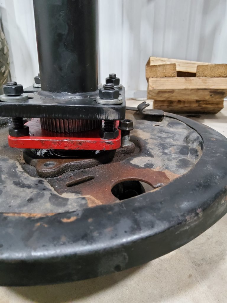

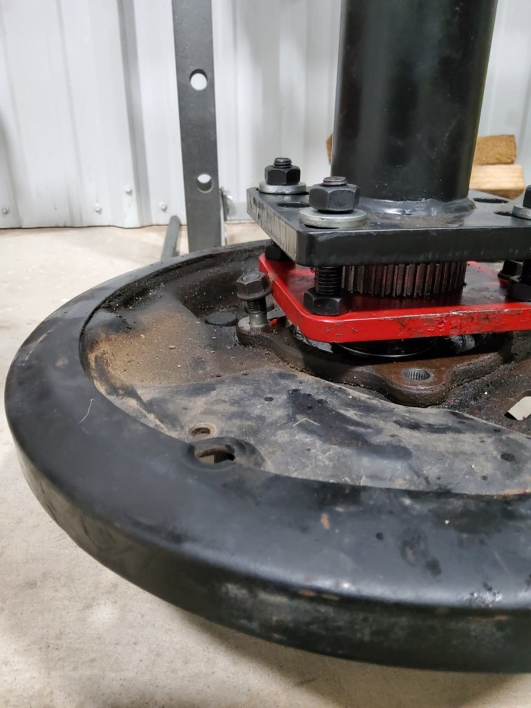

    Having the press there will help. Me and Casey took the axles to my buddy's shop and pressed them, then drove back, so we didn't get to test them. But yes, we followed that video to a T. Be sure and pay good attention when lining the red peice of the tool up. Don't catch a stud. Or just take the nuts off and keep them safe.

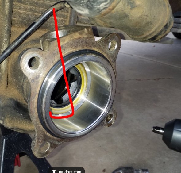

    One thing you can do is snake a pipe cleaner down the ABS magnet hole to act as a dip stick. I did this to check my seals for the first 10k after the install. If it comes out coated in oil take a pic and head to your mechanic before the brake shoes get coated again. Remember, gear oil not only degrades your braking performance, but if you use the brakes too long the oil can catch fire inside the drum.
    Sorry I can't be more help. This Toyota design is tricky and seems to only have a 2-3mm of room for error.

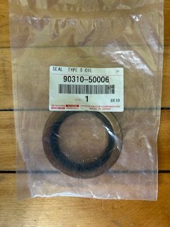

    Can anyone confirm the part number for a 2000 SR5 V8 AC for the rear axel seal?
    I am coming up with part number #90310-50006. I just want to double check because I know the 2004-2006 have different part numbers than the 2000-2003.

    That's the correct number. When I replaced the bearing & seal on one side of my axle, I figured if one side has failed the other may not be far behind... so I bought two bearings & seals. This is a pic of the seal sitting in my parts bin waiting for the other side.
