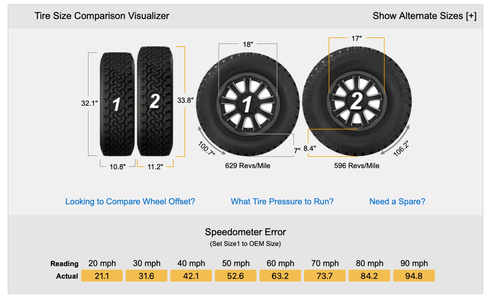

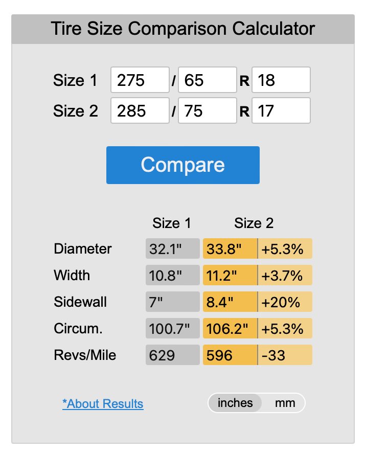

    Is it worth the $ or are many doing the recalibration for their tire size? I think rough country has one. Or is there an app out there I don’t know about?
    Appreciate the help!!!

    Alot of them
    Depends on the readings and tire size.

    @Tundra234 im just putting a small level kit with 285/75R17

    Function before sparkle.
    Personally I would say no.

    Just out of curiosity, if the difference was bigger and bothered one's OCD, what are the options, and approximate cost of those options to recalibrate?
    I've got 35x12.5x20 tires and mine is obviously quite a bit further off than OPs example

    The Hypertec module was about $140.

    I just installed the Rough Country In-Line Speedometer Calibrator over the weekend and have been very happy with it. Easy install. A little pricey but it as worth it to me to know my true speed. Good luck.
