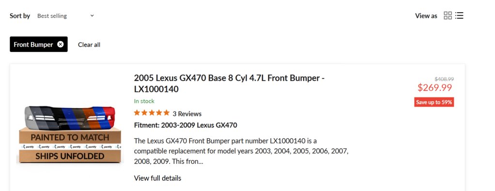

    Still can't wrap my brain around how they shipped that front bumper.....

    Ya I wish they were upfront about what to expect when it arrives. Instead of having to research it after or find out in the return process. The rear was folded also, but it unfolded nicely. Didn't have any small fins like the front

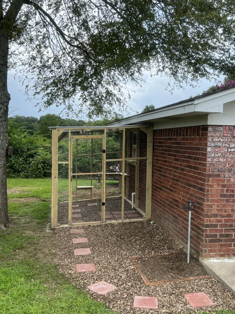

    We built a Catio on the side of the shopartment that my son and his wife live in on my property. Has a little kitty door in the window so they can move in and out as they please. Old pic
    Edt: about $550 in materials.

    Flooding issue if it rains hard?
    e30cabrio likes this.

    Where, in the catio? Hasn't done that. Decent slope to the yard in this area.

    Ah, OK. From the picture wasn't sure it would be an issue.

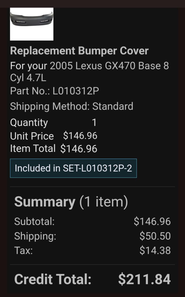

    Got refunded for the front bumper. Not even required to return it. So that's pretty nice.

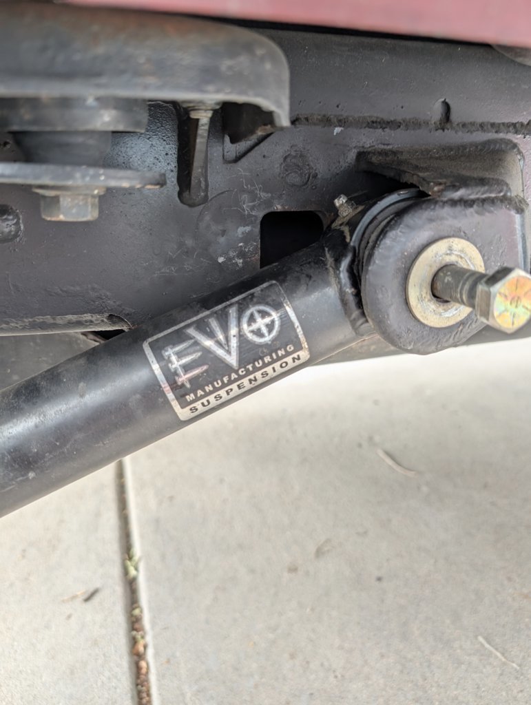

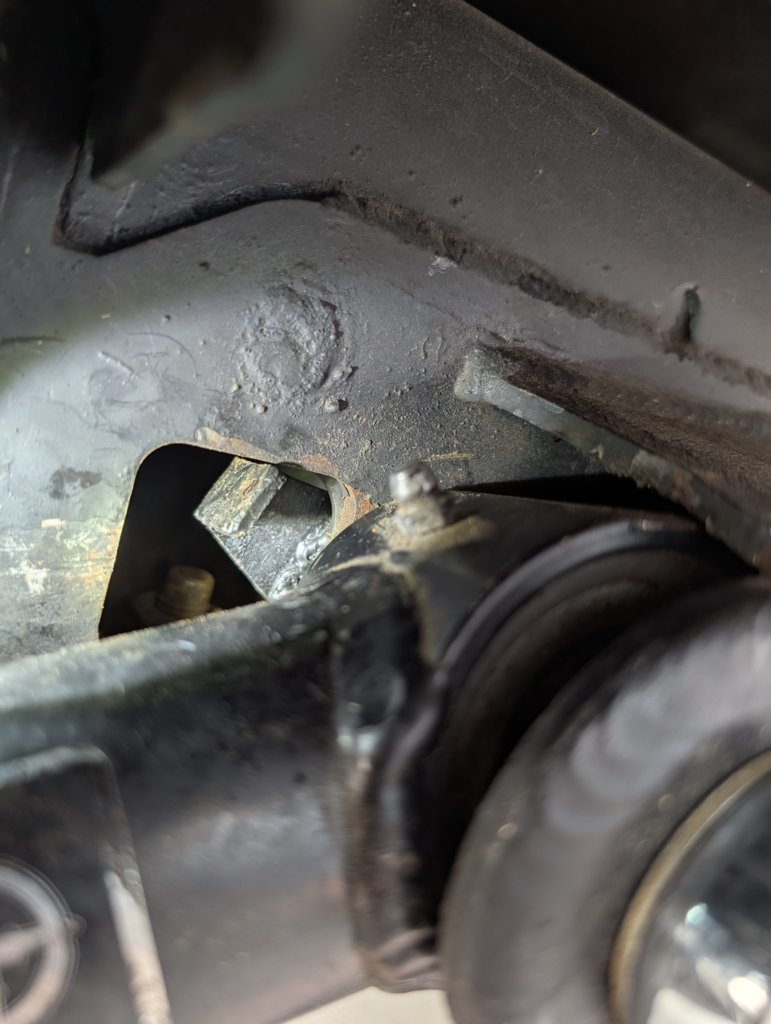

    Finally got the jeep all back together. It was still missing these two frame side lower control arm bolt nuts. Needed to jack the rear frame up so that the control arms themselves articulate down enough to get access to the hole for the nut. Even then it was a small chore. But I went and finally bought a Badlands 3 Ton jack from Harbor freight. Sooo much safer than how I was achieving that height before, stacking spacers on the low profile 2 ton jack. Also got the sliders back on, can't get to those bolts unless they're off. Can finally got hits some trails!

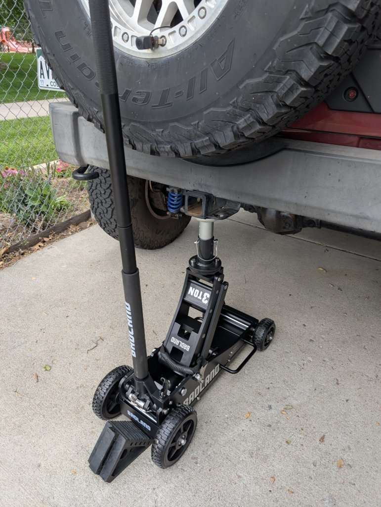

    Finally (hopefully) no clicks, scrapes, or noises from the rear brakes! Forgot to take side by side pictures but there was a very slight difference between the two, where the inside lip was for the drum brakes.

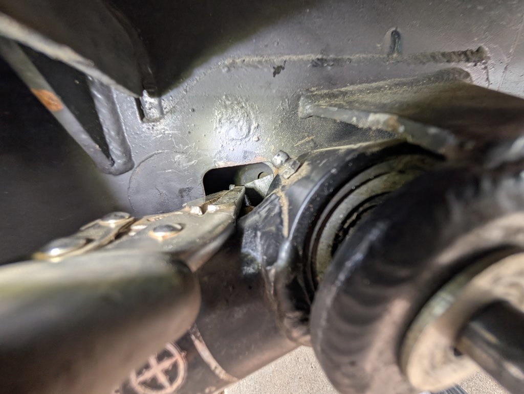

    But...while under there I noticed the rear gas tank strap had rusted through and broke. It's a pretty thin strap so not surprised. It's still snuggly in place by the skid plate. No rush on it but just another thing to replace.

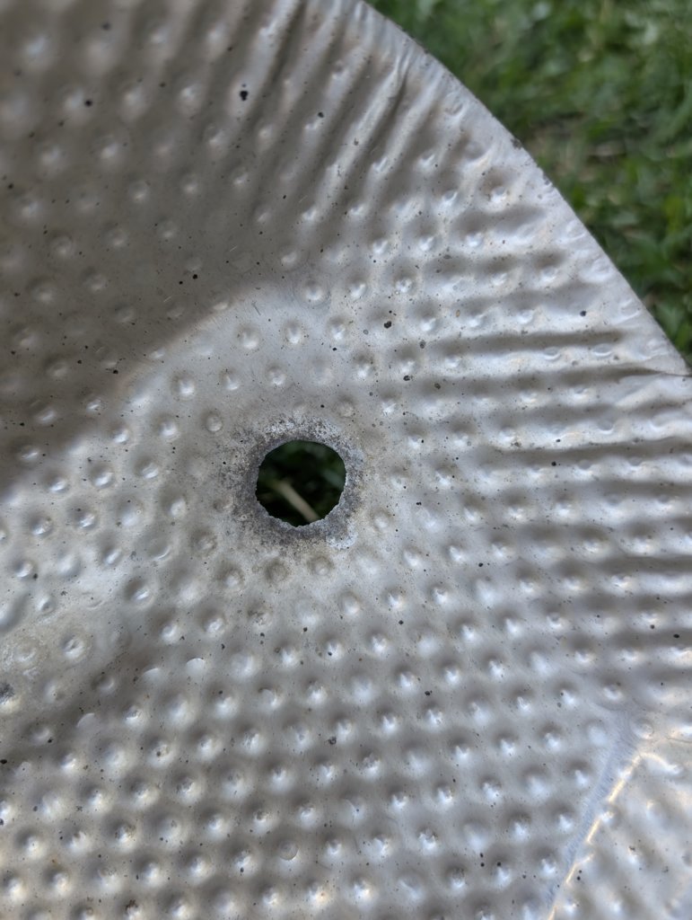

    Need to put a washer on the exhaust heat shield under the middle passenger seat area. It wore through and rattling some.
    And it does have a pretty bad exhaust manifold leak. Not looking forward to that job. Sure to brake a few studs.
    Also need to go through the front and retorque all the suspension parts I replaced towards the beginning of the project. Getting some clacking from something down there, though everything feels firmly in place. Suspect it's the Lower Control Arms

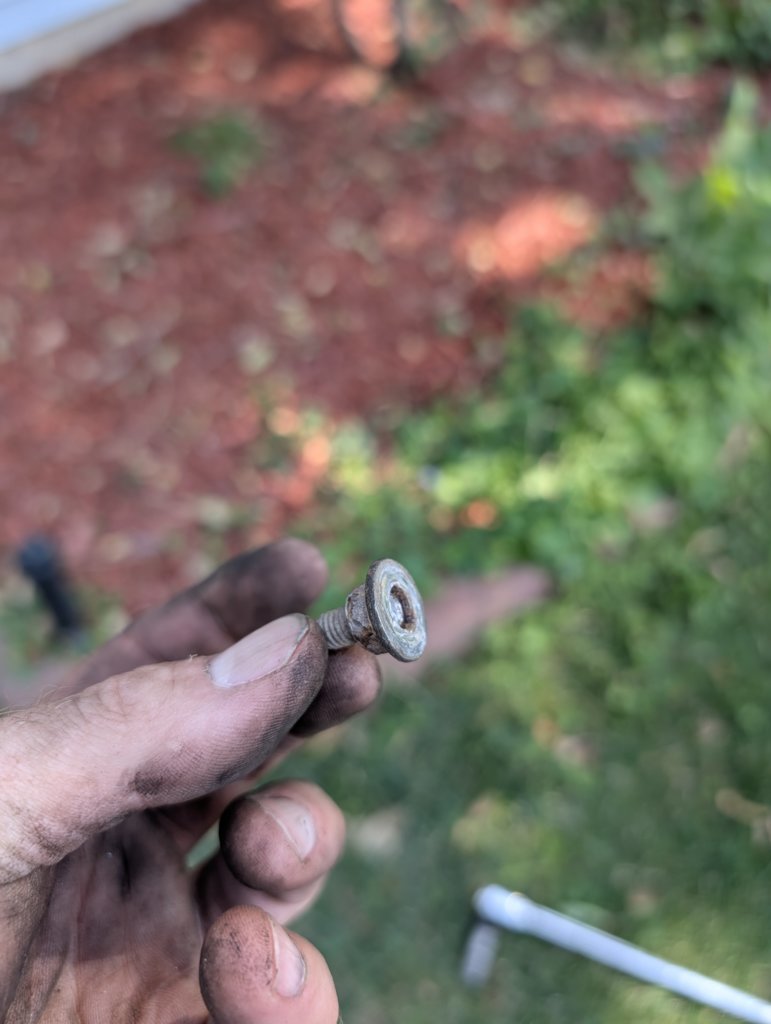

    Ya that heat shield was super rattley. And SOB, of course one of the studs broke off. Pretty sure I'm going to have to pull the carpet to install a new one. Probably just cover the exhaust with hear shield wrap until I get around to that. You can see how rounded out the holes were in the original shield.

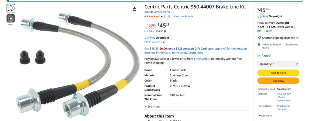

    Ordered some Centric (stoptech) stainless steel front brake lines off Amazon
    + $46

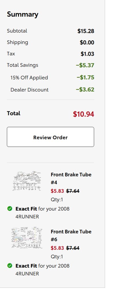

    And some OEM front brake hardlines to replace the bit between the caliper and the hose, sense it was slightly bent and a little rusty. Actually cheaper from the dealership than knock-off Amazon lines
    + $11
