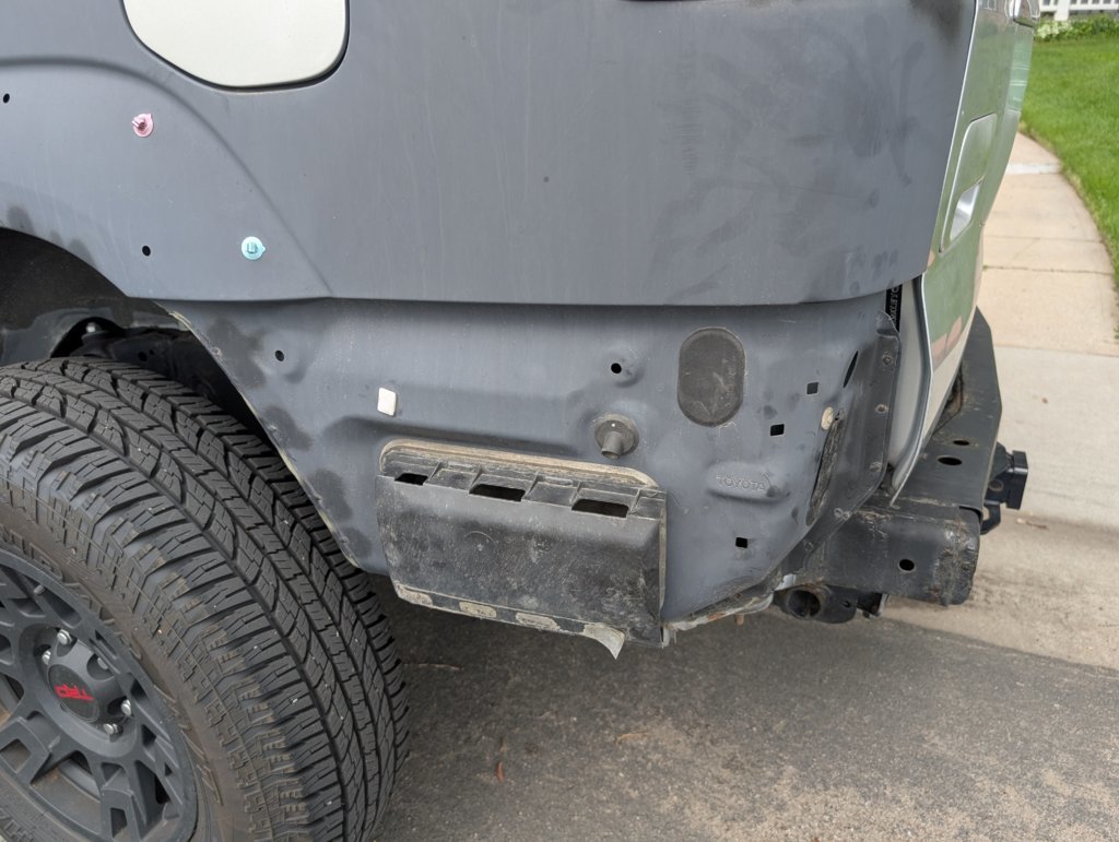

    A lot more GX470's in Denver being parted out. Going to look at a few tomorrow to grab some bits

    Got the rear quarter panel vent, a cap and another plastic piece for the qp. $20 at a junk yard

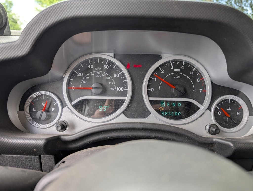

    Lol light came back on at 3/4 tank

    Is it a lose or bad gascap?

    No, I've replaced the gas cap multiple times, even with genuine Mopar. And a new evap canister seal. I didn't know at first, but it's coming from one of the lines that connects from the gas tank into the engine bay, to another evap part (forget the name). But when I installed the dual battery tray, that part lost it's mounting point and was just kinda floating there. It dipped down enough to melt a hole in the line on the exhaust manifold. I tried cutting and hacking it back together, but still leaks.
    Been putting off the fix cause....gotta drop the gas tank to replace the line.

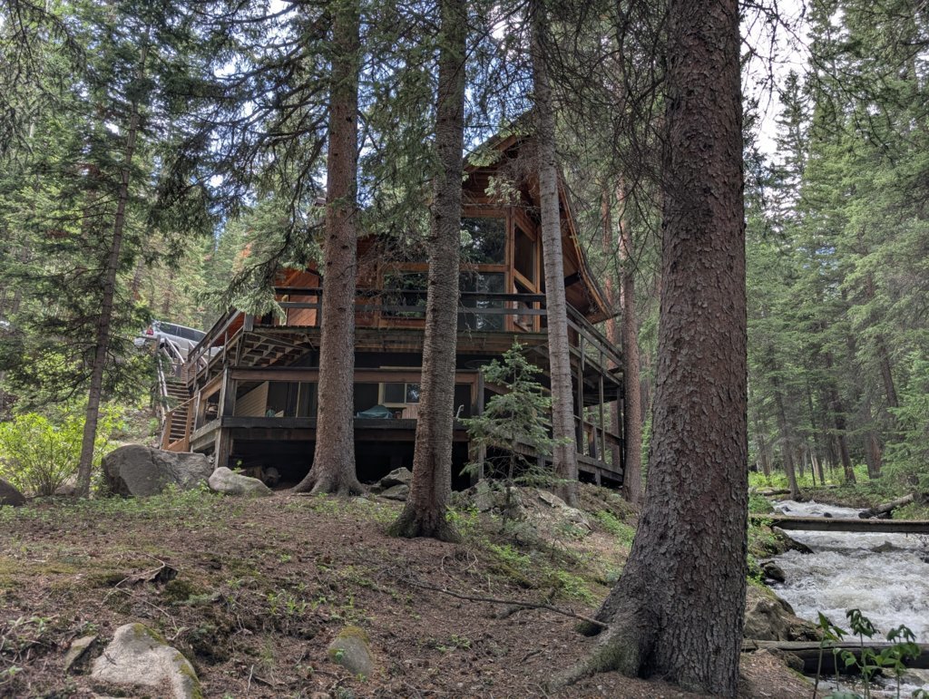

    Good to be back in the mountains! First trip to the "cabin" in the GX. Dumont, CO
