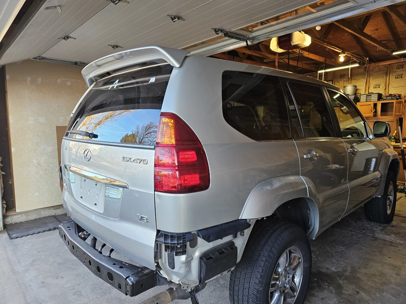

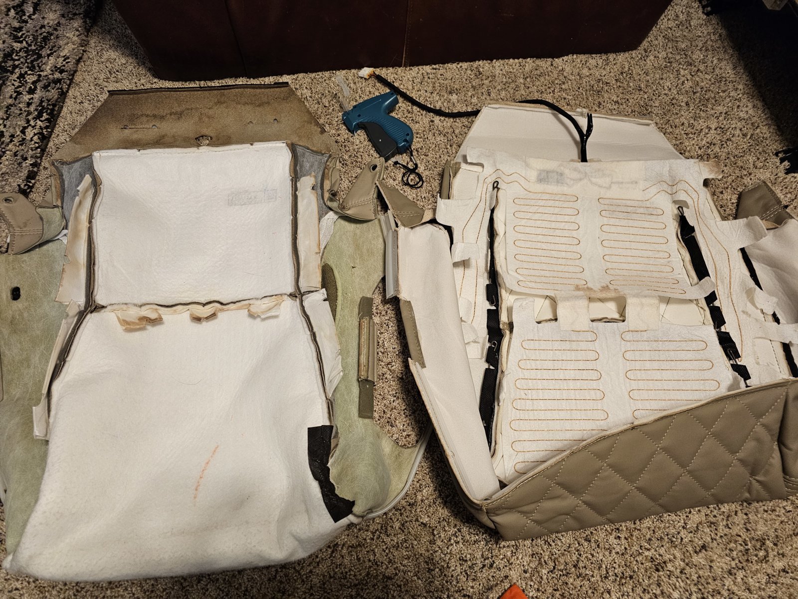

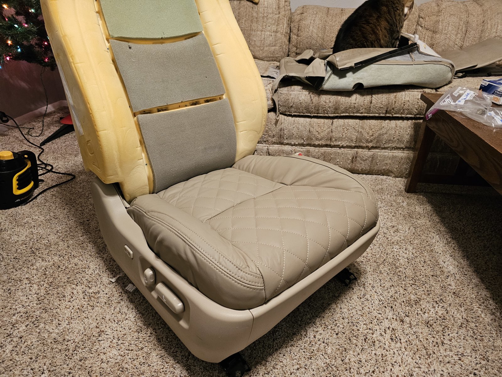

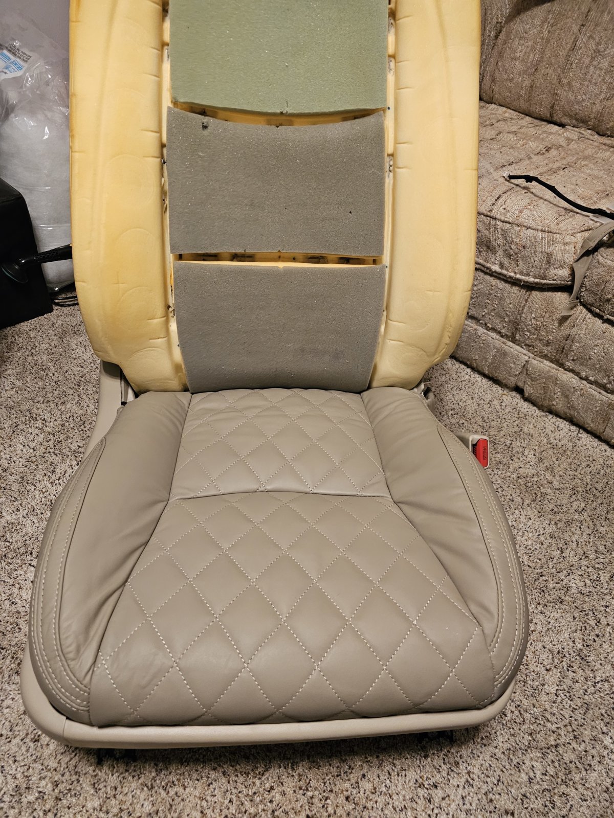

    Had to order a tag gun so I could connect the OEM seat heater to the bottom of the new leathers for the front seats.
    + $16

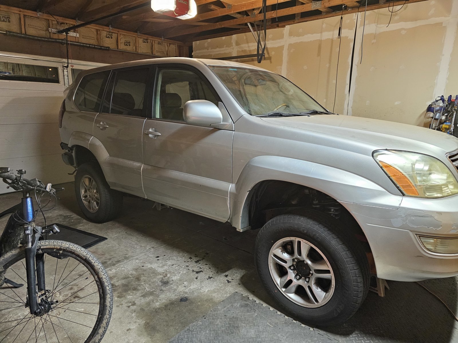

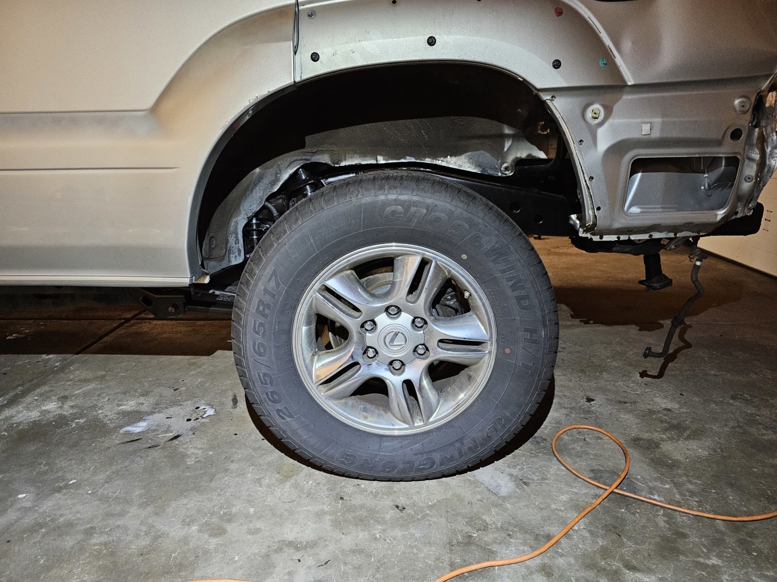

    Also got the GX sitting on wheels again. But still pending shipment of rear sway bar that's on backorder. It sits a little lower in the rear, and that's without the weight of the tailgate. Which is perfect. Because I thought the front was sitting a little high. So now I can lower the front. I was thinking about 275/70/17 which is 32.2" tires. I may even go one size lower, which is still bigger than stock.

    Researching a little last night and I think I'll be going with 265/70/17 tires, which equals 31.6". Stock tires are currently 265/65/17 or 30.6" Should fill out the wheel well nicely, especially after the suspension settles in.
    The 265/70's SL rated (46lbs) weight 10lbs less per tire than the 275/70s in Load C (57lbs) I was looking at. Quite the difference

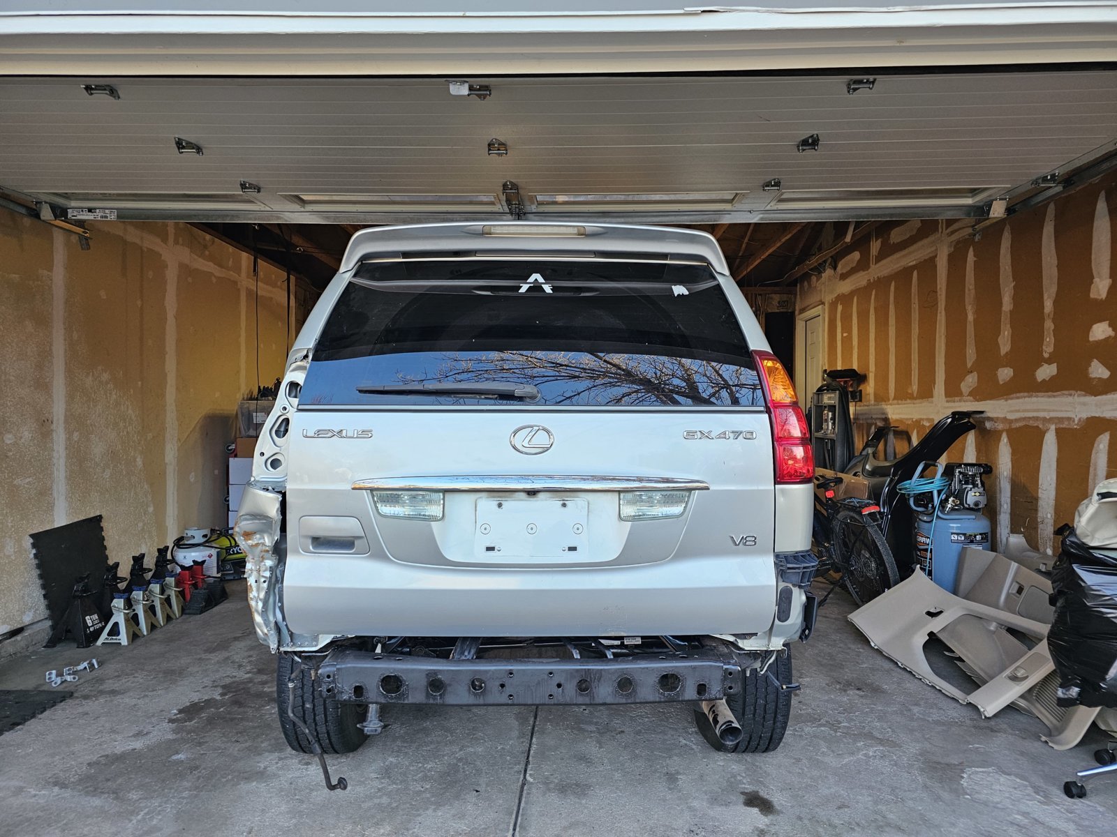

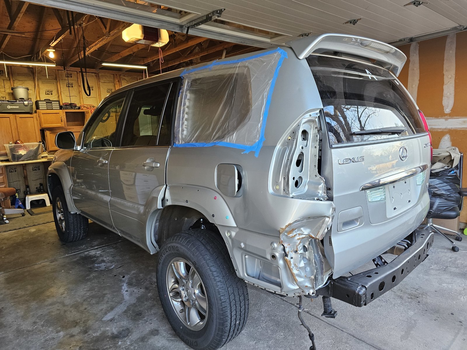

    Another "milestone". A friend came by and helped get the tailgate back on. Huge relief that it closes correctly, flush with the body! I was a little worried because the damaged tailgate I removed was bowed out at the top left, so there was a considerable gap between the tailgate and roof. I wasn't sure if that was just the tailgate or also the body. Luckily it was just the tailgate! And the color is super close to mine, even though there two different color codes.

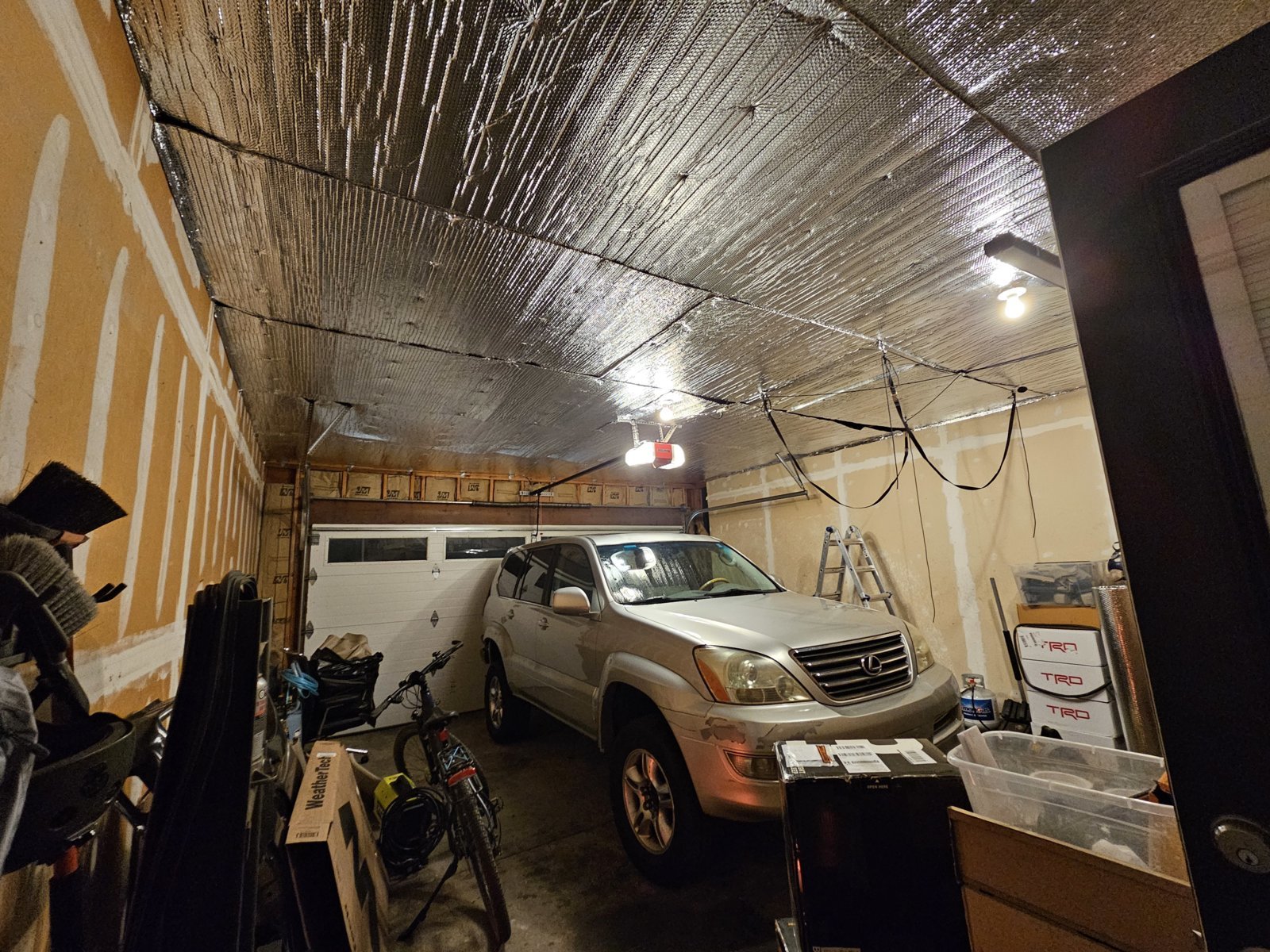

    Working nights now, so I spent a day last week insulating the garage a bit. Instantly made a difference of almost 10 degrees warmer. And now my garage heater actually feels like it's working, instead of all the heat escaping upward.
    5 rolls at $50 each
    + $250

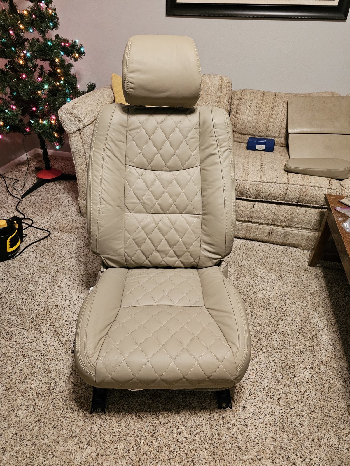

    2005 GX470

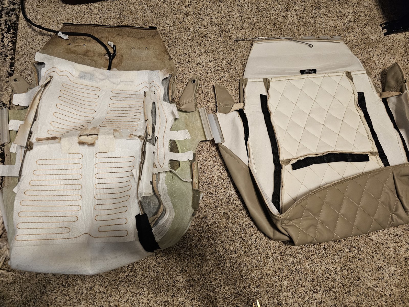

    Working on the front seats. Got one of the four seat heaters swapped over. Hoping to have the front seats done over the weekend.

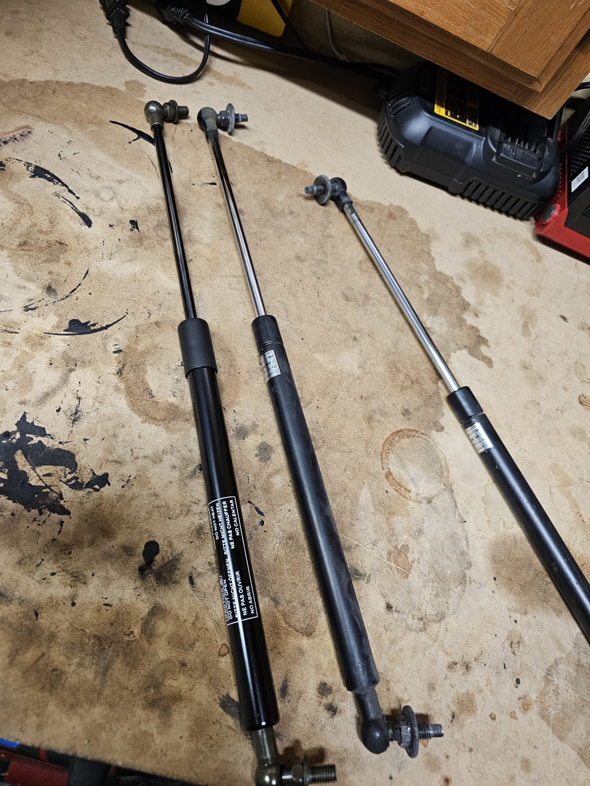

    Replaced the hood struts due to risk of being decapitated...
    + $30

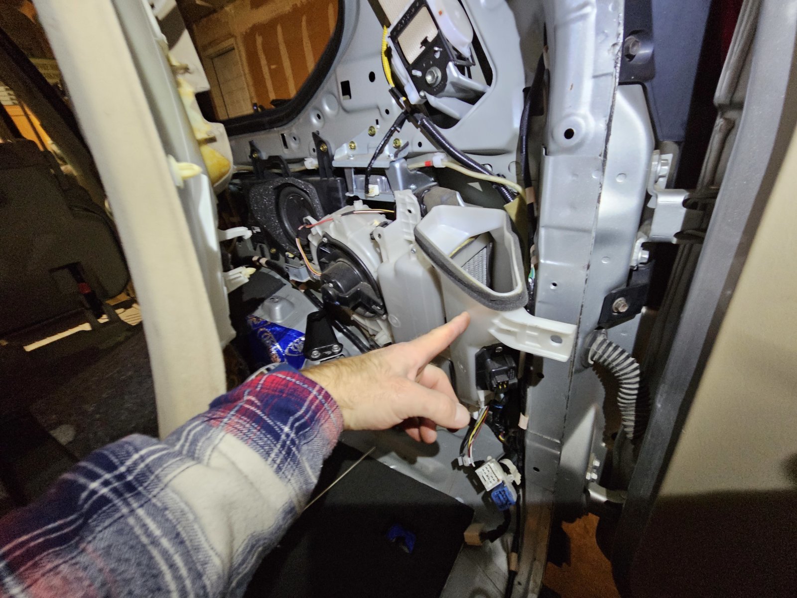

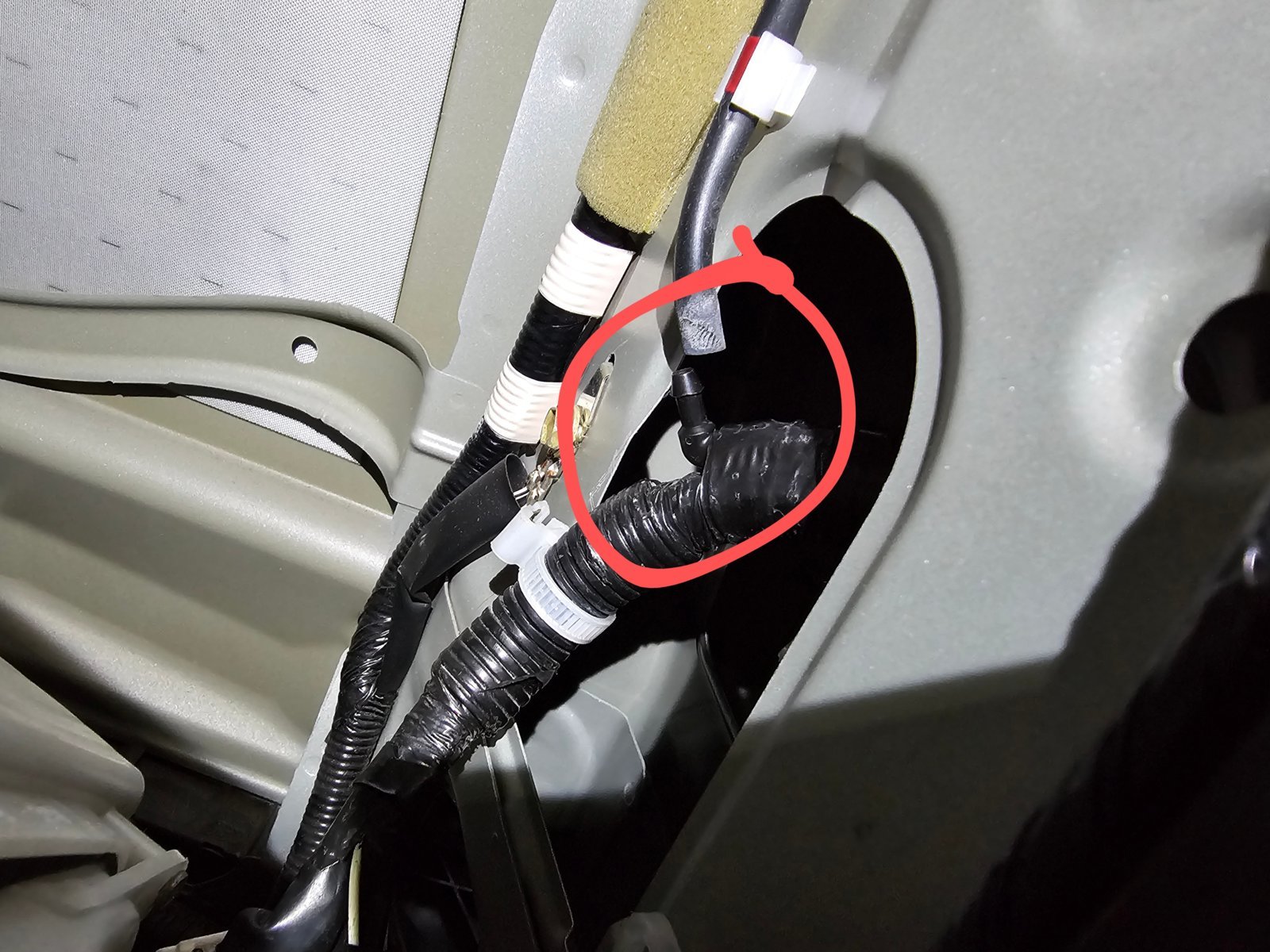

    Had to remove some interior parts in order to reconnect the rear wiper fluid line being disconnected. Found that out when I did a test spray and it went all over the cargo floor lol
