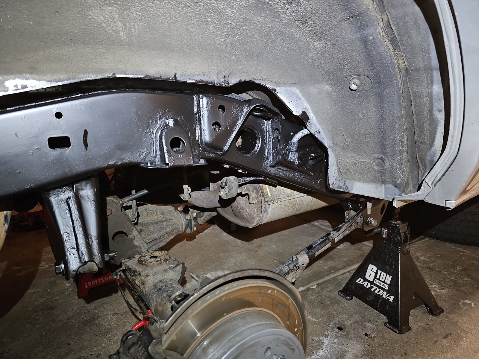

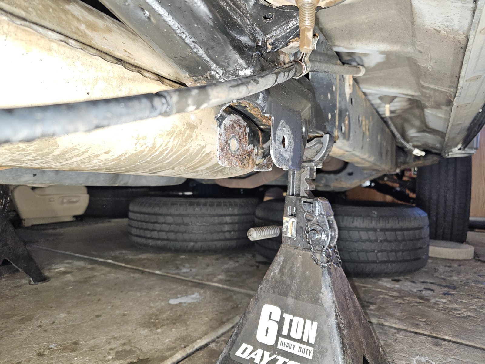

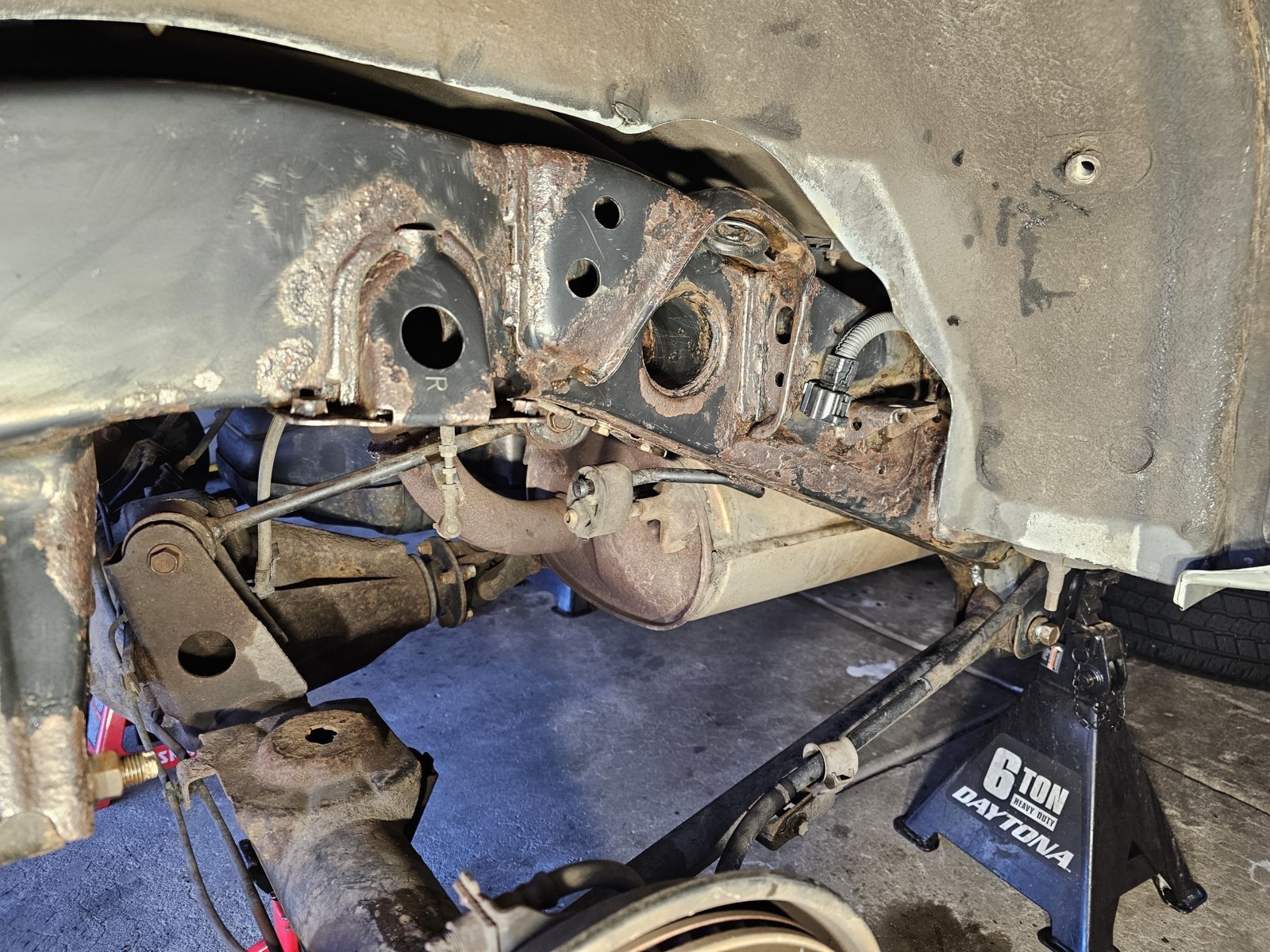

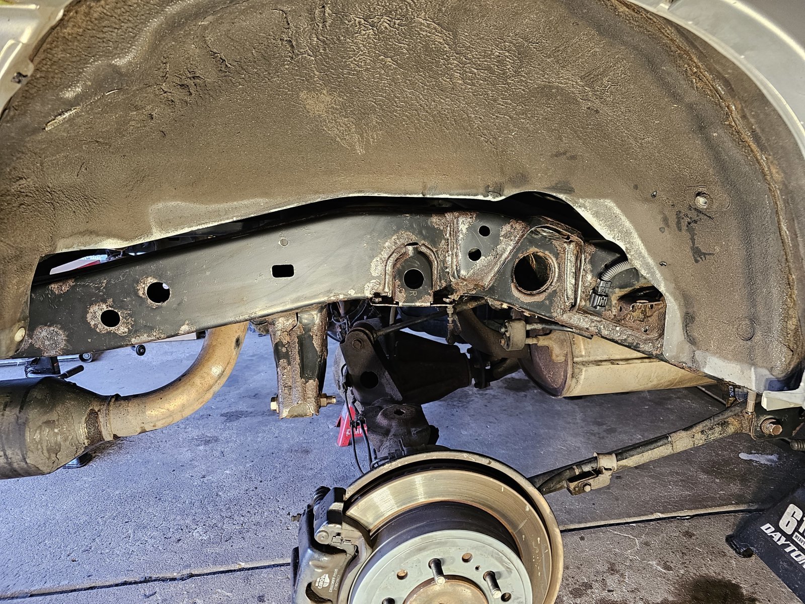

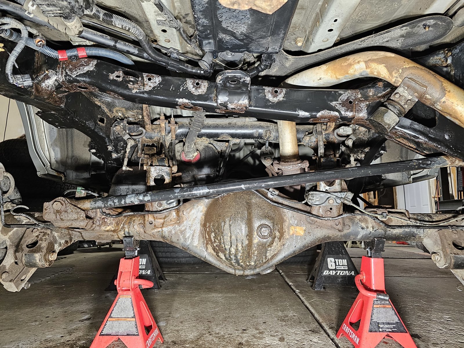

    After wire wheeling and degrease cleaning. About to do.the metal prep and then paint

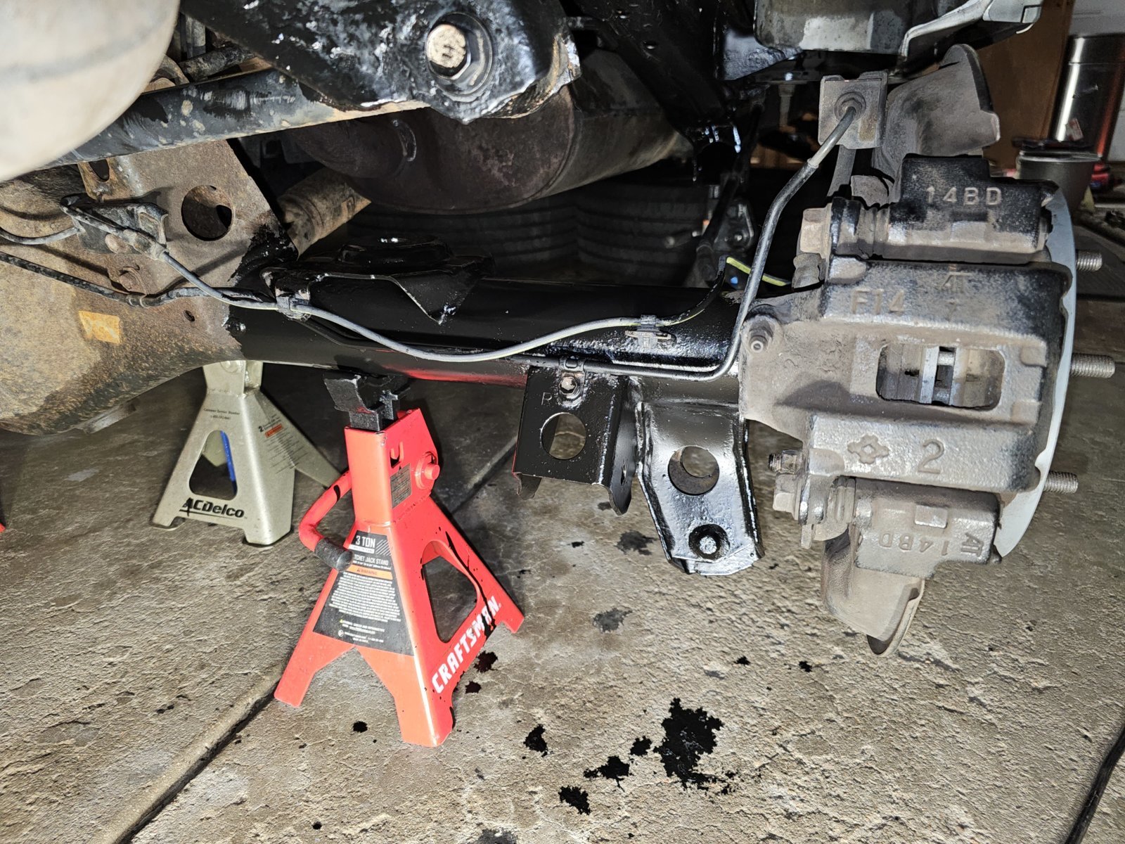

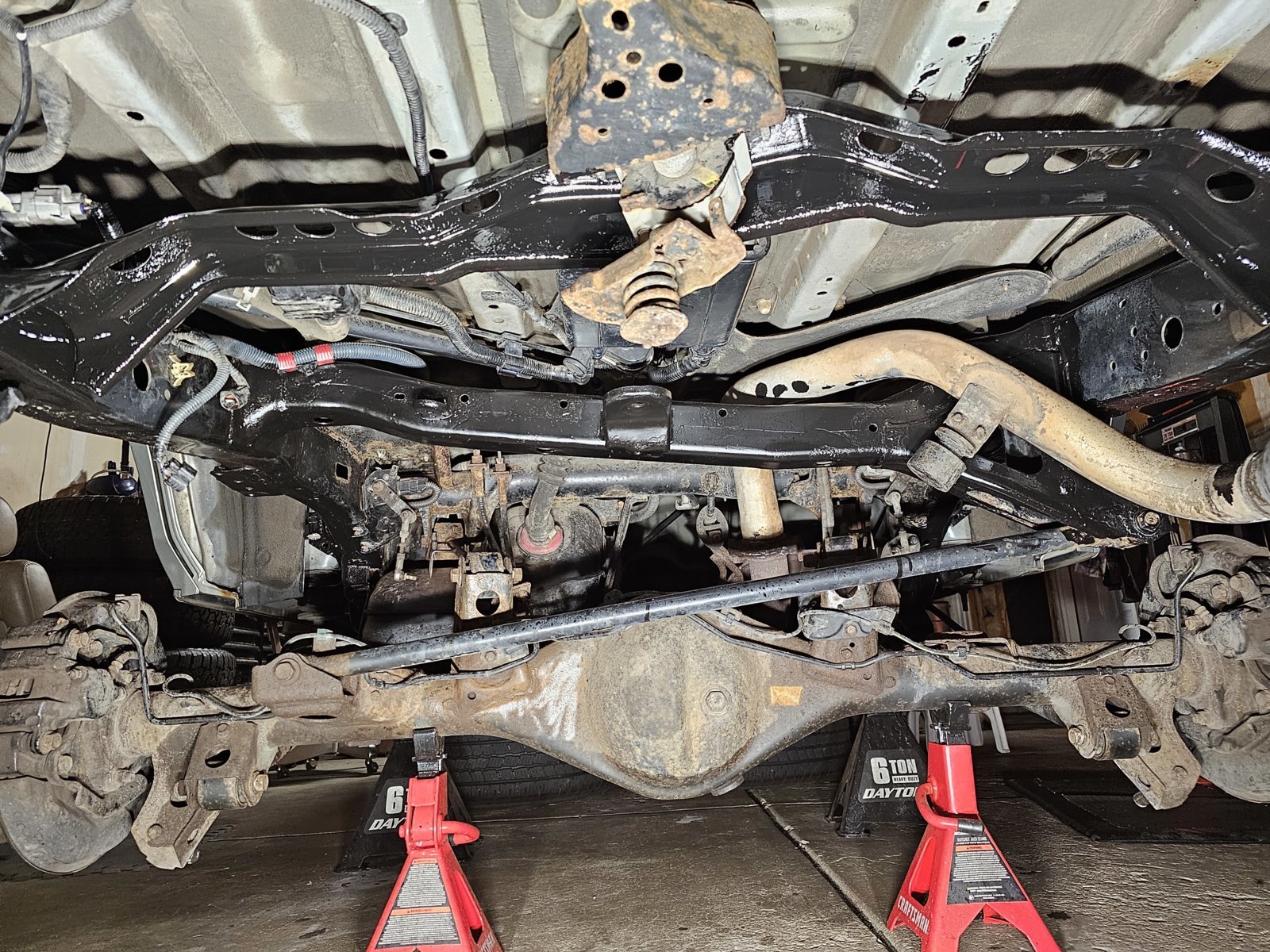

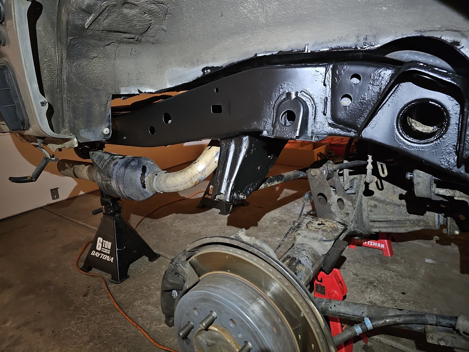

    After POR15

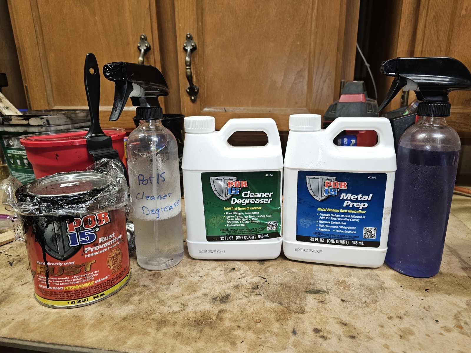

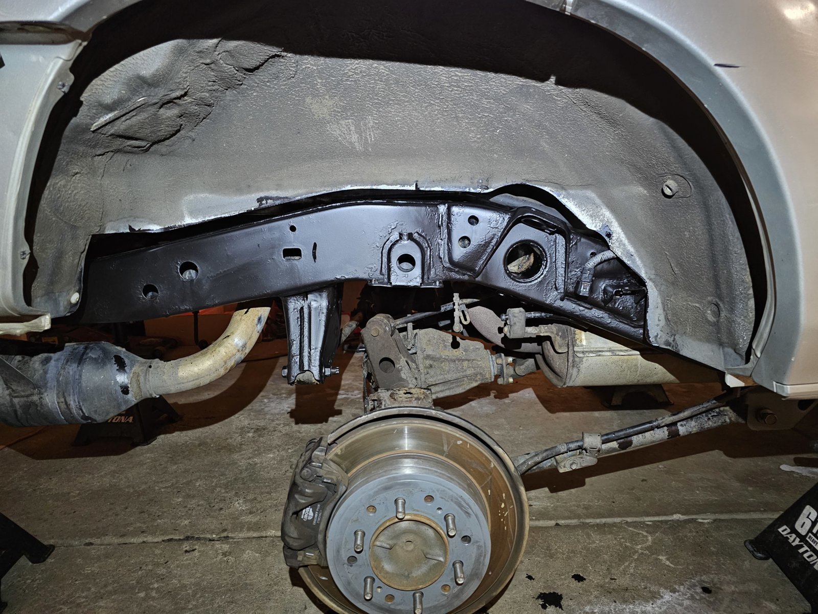

    POR15 kit I've been using

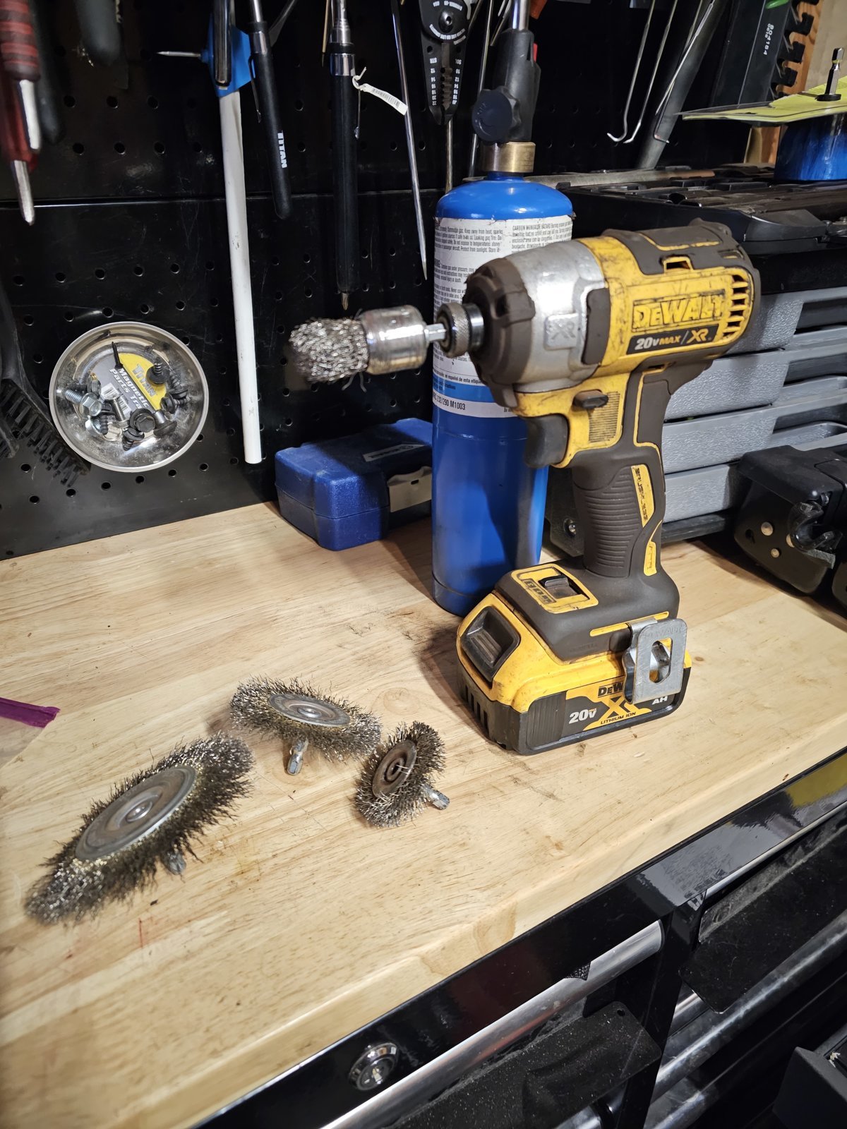

    And basic wire wheels on an impact drill

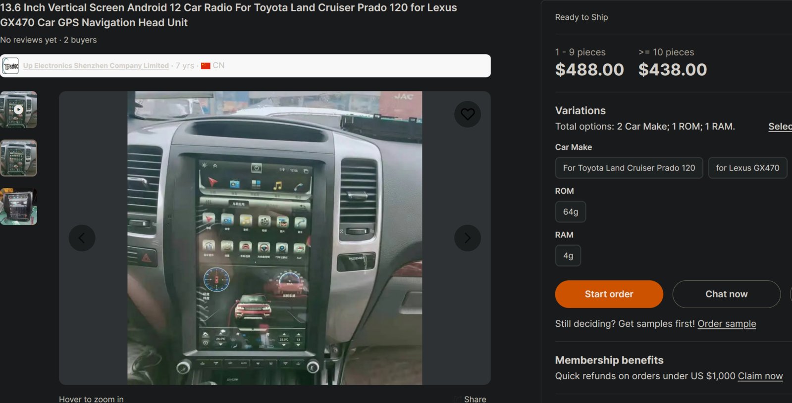

    Highly considering an Alibaba Tesla style Head Unit. I know there's Aurcar and Pheonix that sell them, but they're twice the price. And tbh, don't look as good as this one. I'd rather do the Joying Android HU, but you have to convert from NAV to Non-NAV HVAC controls and extend the wiring. That ends up costing more than the Aucar/Pheonix prices because you have to source your own factory HVAC control unit used.

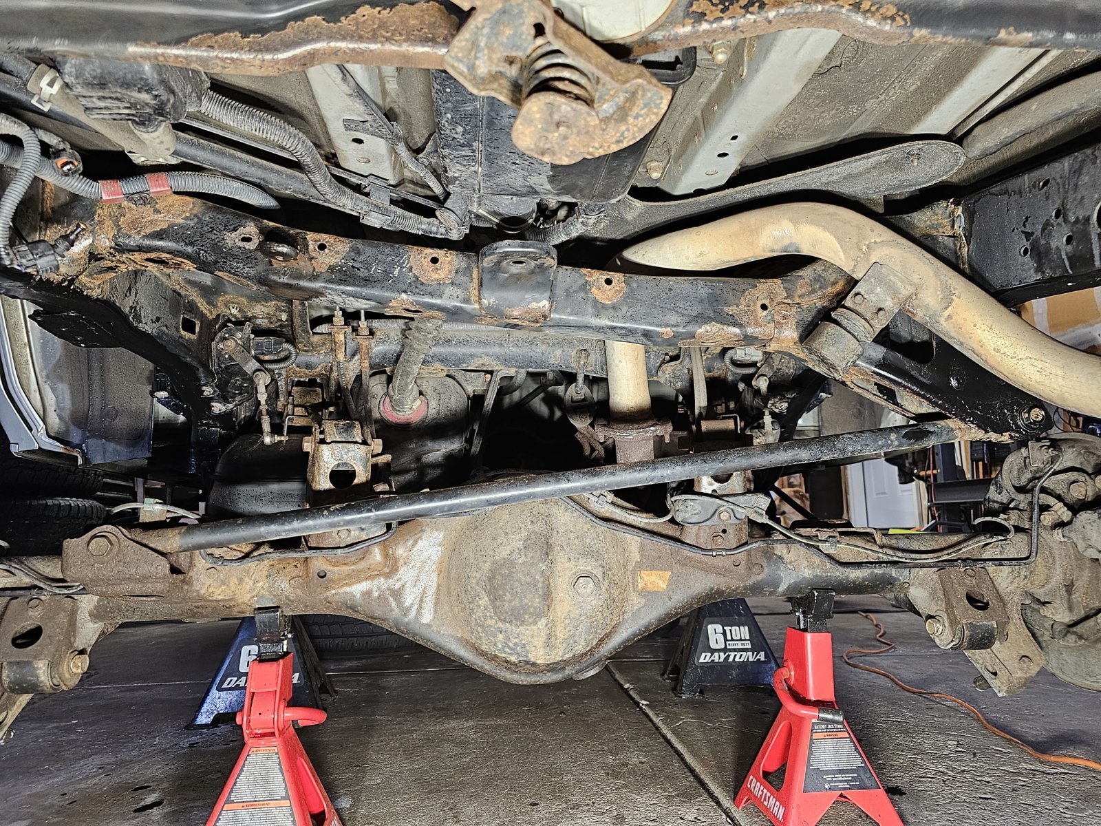

  16. Nov 24, 2023 at 5:28 PM
    #226
    M3Tundra-JK
    M3Tundra-JK [OP] New Member
    May 3, 2022
    #77930
    2,725
    Scott
    2005 GX470

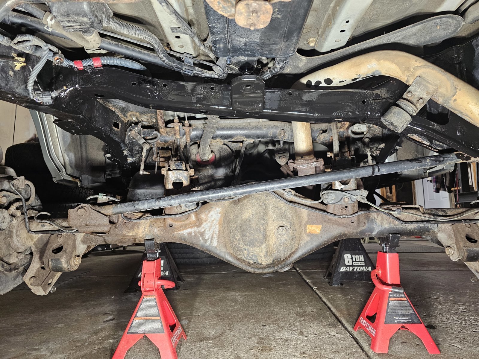

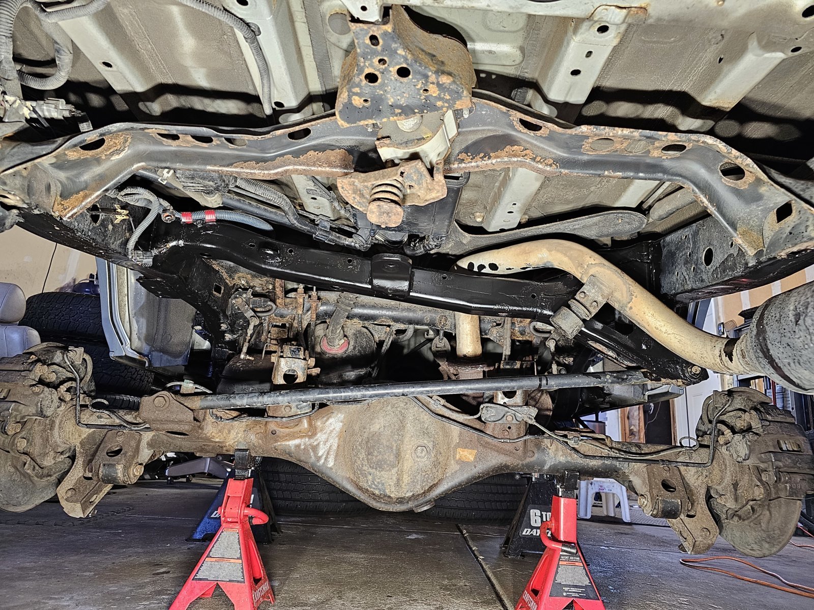

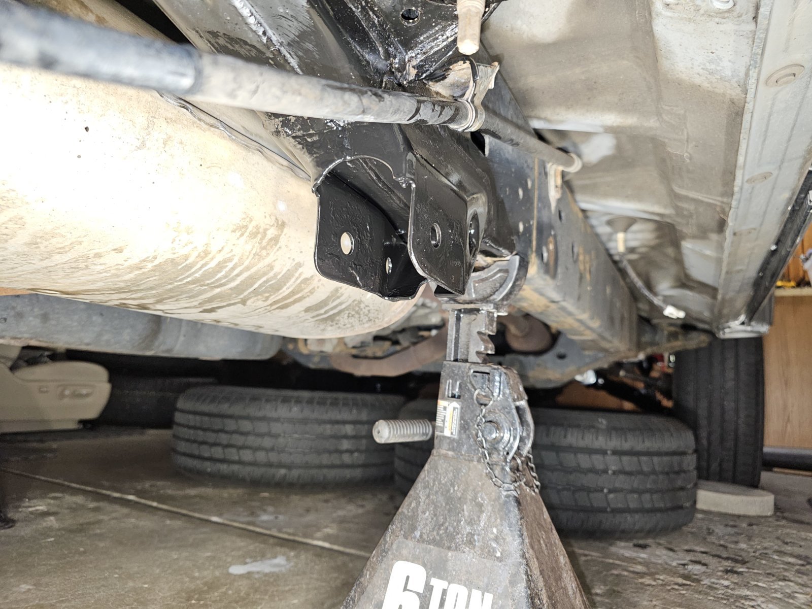

    1, 2, 3 on the rear crossmember

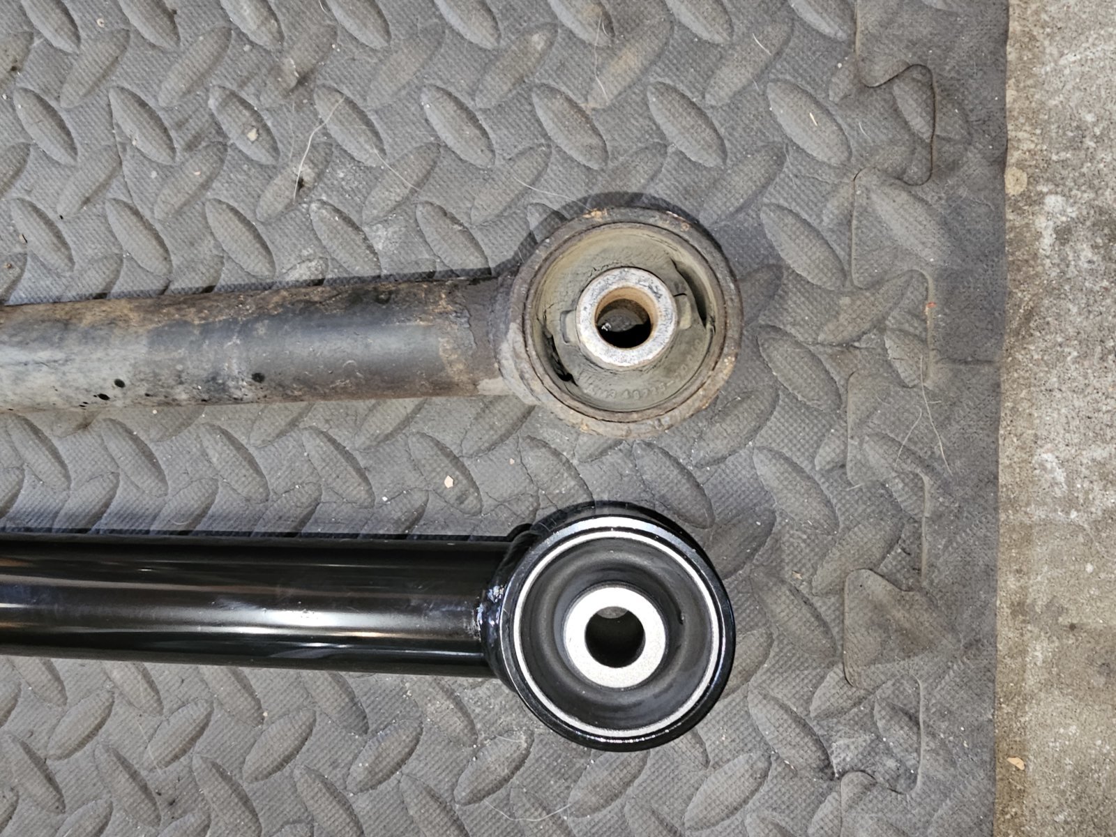

  19. Nov 26, 2023 at 11:08 AM
    #229
    M3Tundra-JK
    May 3, 2022
    #77930
    2,725
    Scott
    2005 GX470

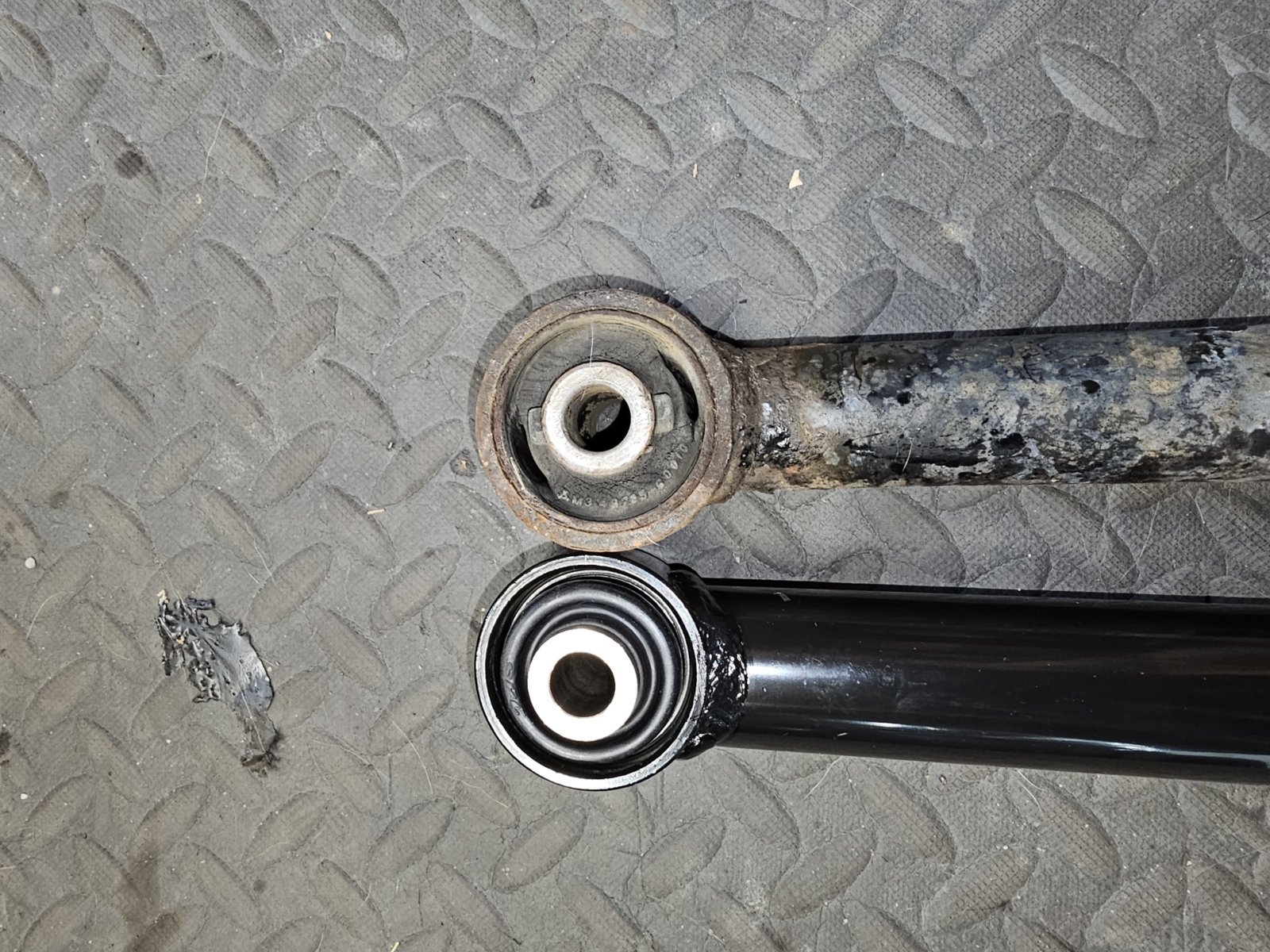

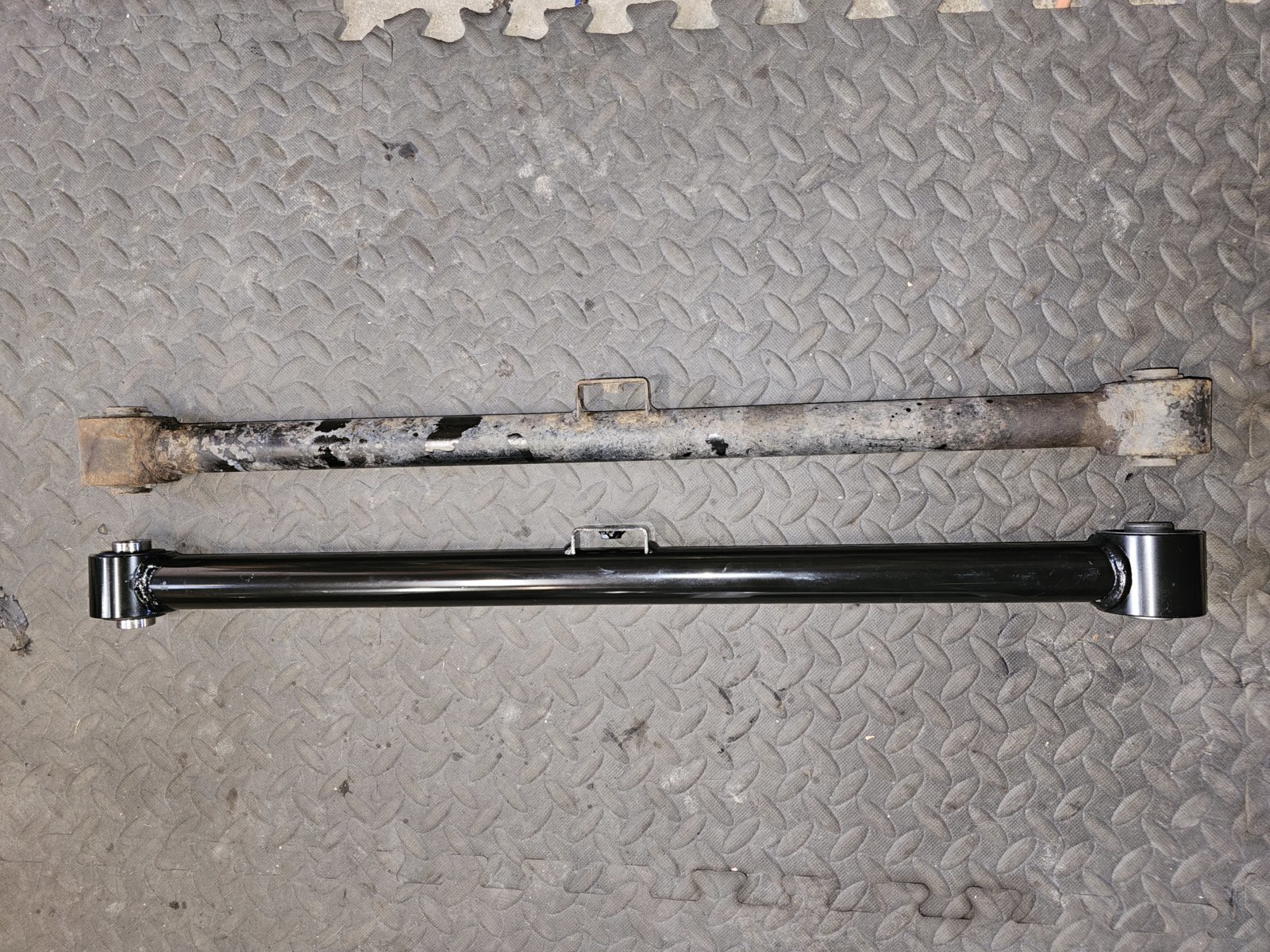

    Old OEM Rear Lower Control Arm vs New SPC Performance Control Arm w/xAxis Sealed Flex Joint

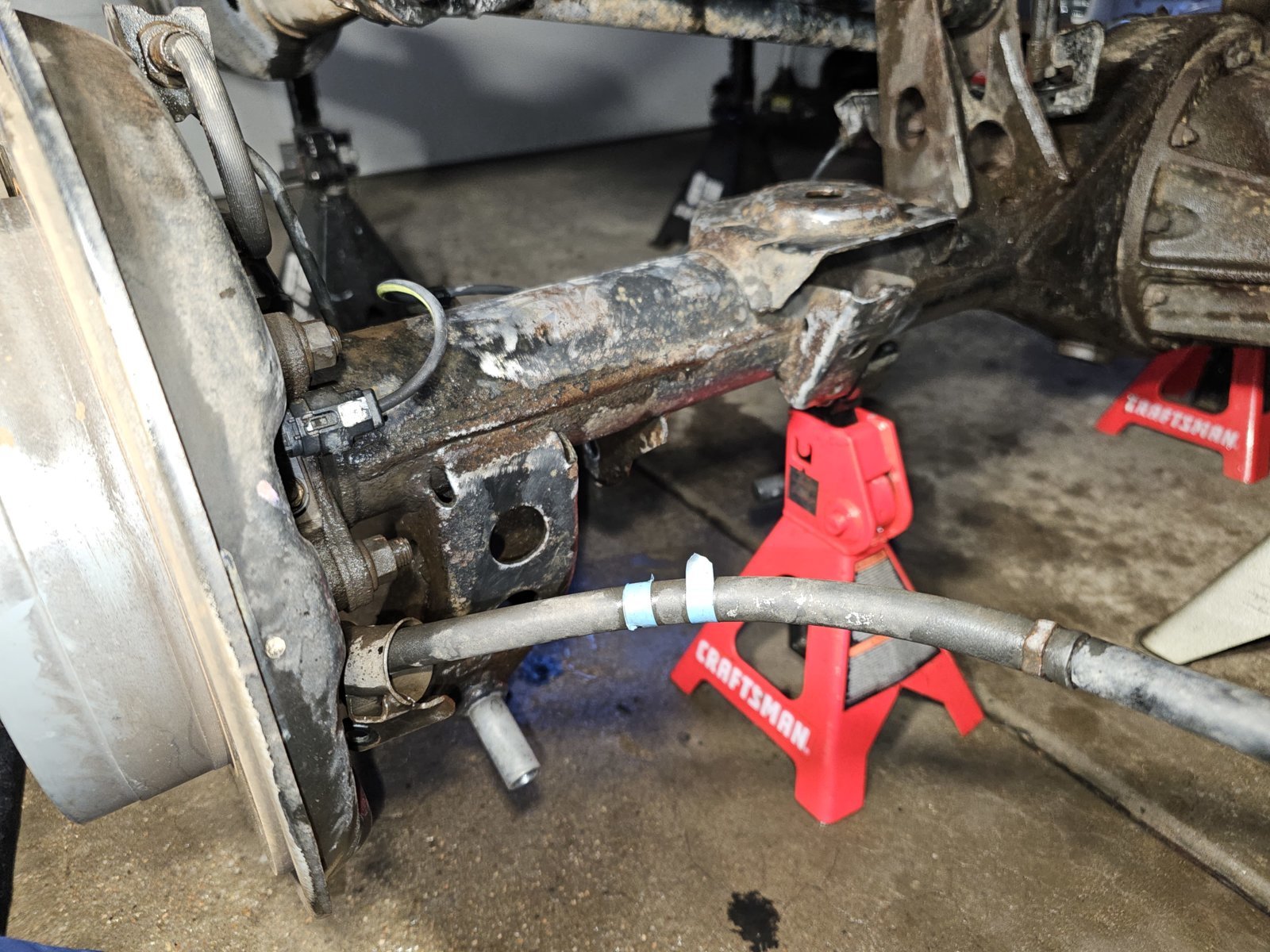

  20. Nov 26, 2023 at 1:34 PM
    #230
    M3Tundra-JK
    May 3, 2022
    #77930
    2,725
    Scott
    2005 GX470

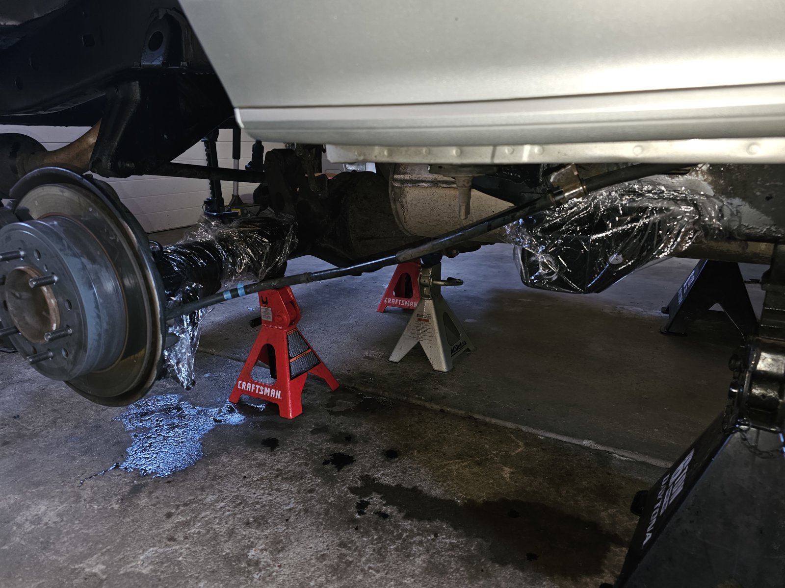

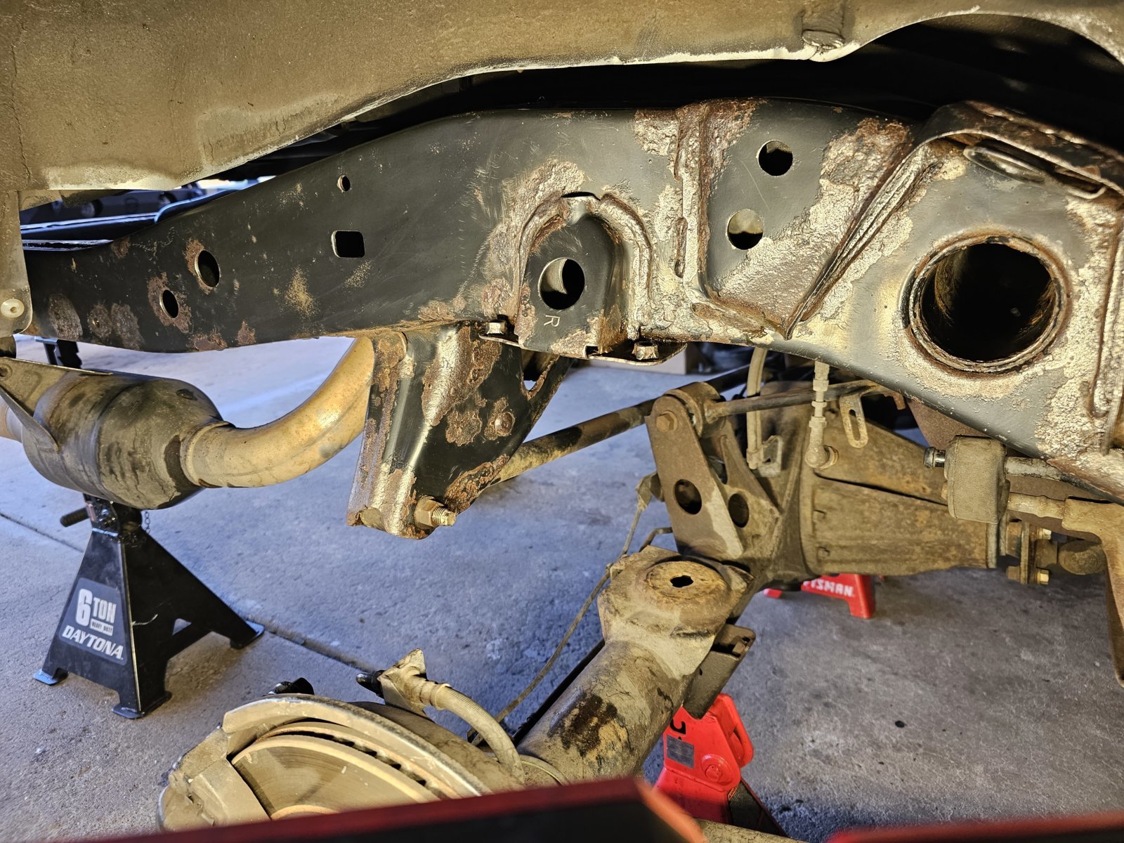

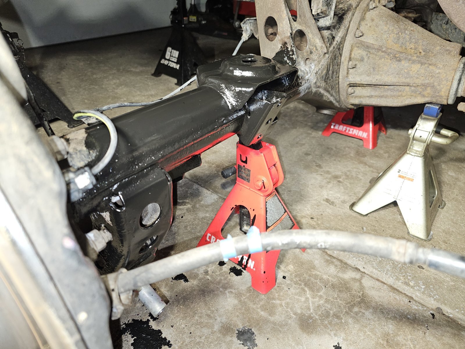

    Ran out of foil, but cling wrap seems to work even better! Well, unless the metal prep spray melts it lol. We'll see!
    Doing POR15 to rear passenger side Lower Control Arm, shock, and spring perch mounts
  21. Nov 26, 2023 at 2:10 PM
    #231
    M3Tundra-JK
    May 3, 2022
    #77930
    2,725
    Scott
    2005 GX470

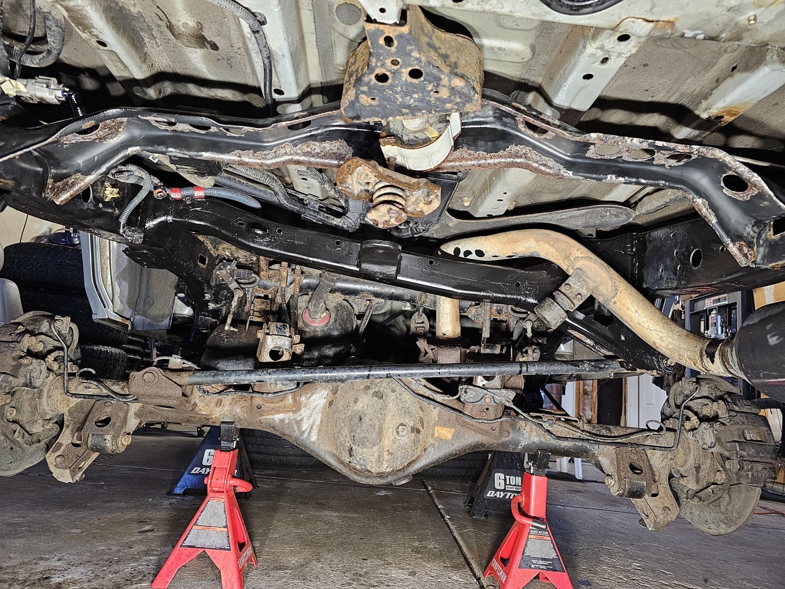

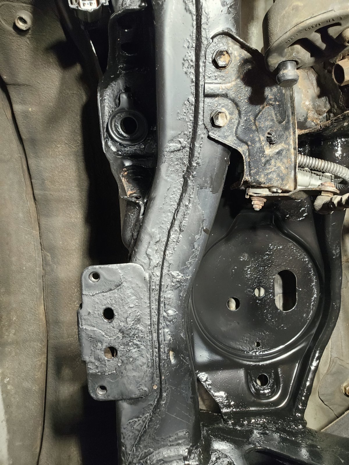

    Kinda hard to get in all the tight places, but this is after the metal prep. Drying before the POR15 paint

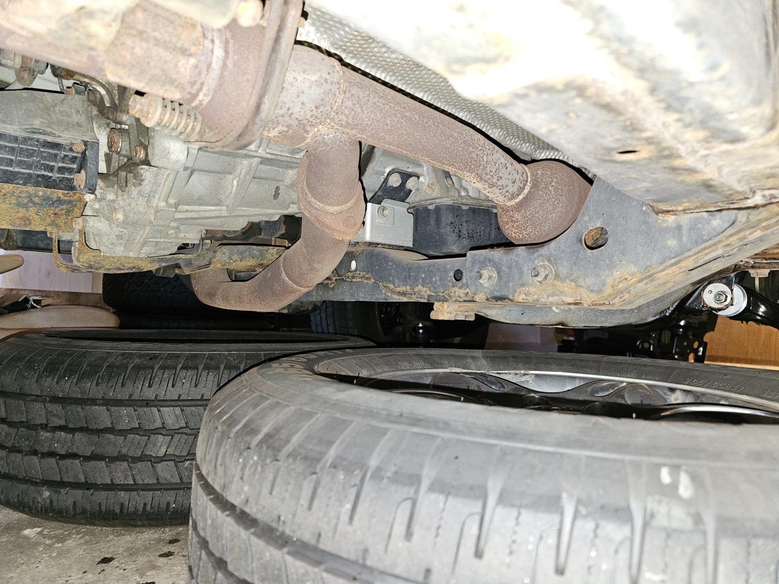

  25. Nov 27, 2023 at 11:13 AM
    #235
    M3Tundra-JK
    May 3, 2022
    #77930
    2,725
    Scott
    2005 GX470

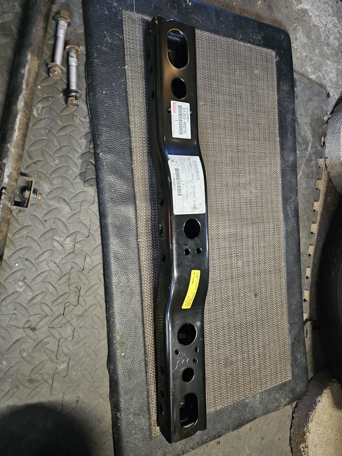

    While my transmission crossmember really isn't bad, I couldn't pass up this FB deal.
    + $60 for brand new crossmember. Cheapest blackfriday dealership deal I could find was $140
    May 3, 2022
    #77930
    2,725
    Scott
    2005 GX470

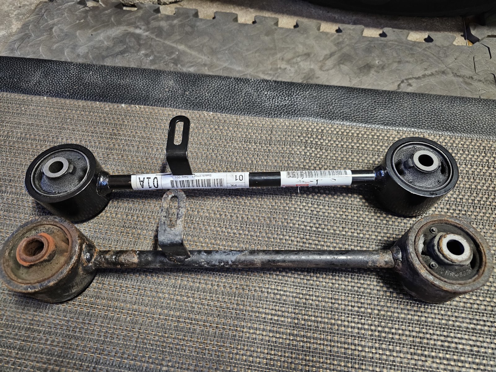

    Old vs New Rear Upper Control Arm.
