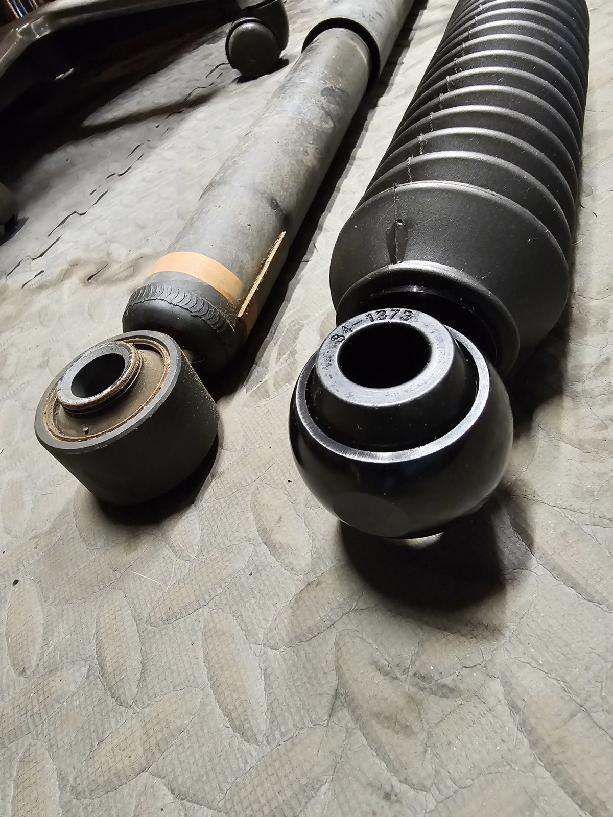

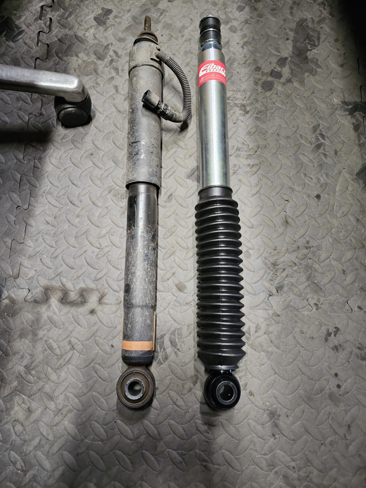

    Old vs New rear shocks
    FirstGenVol, T-Rex266 and KNABORES like this.

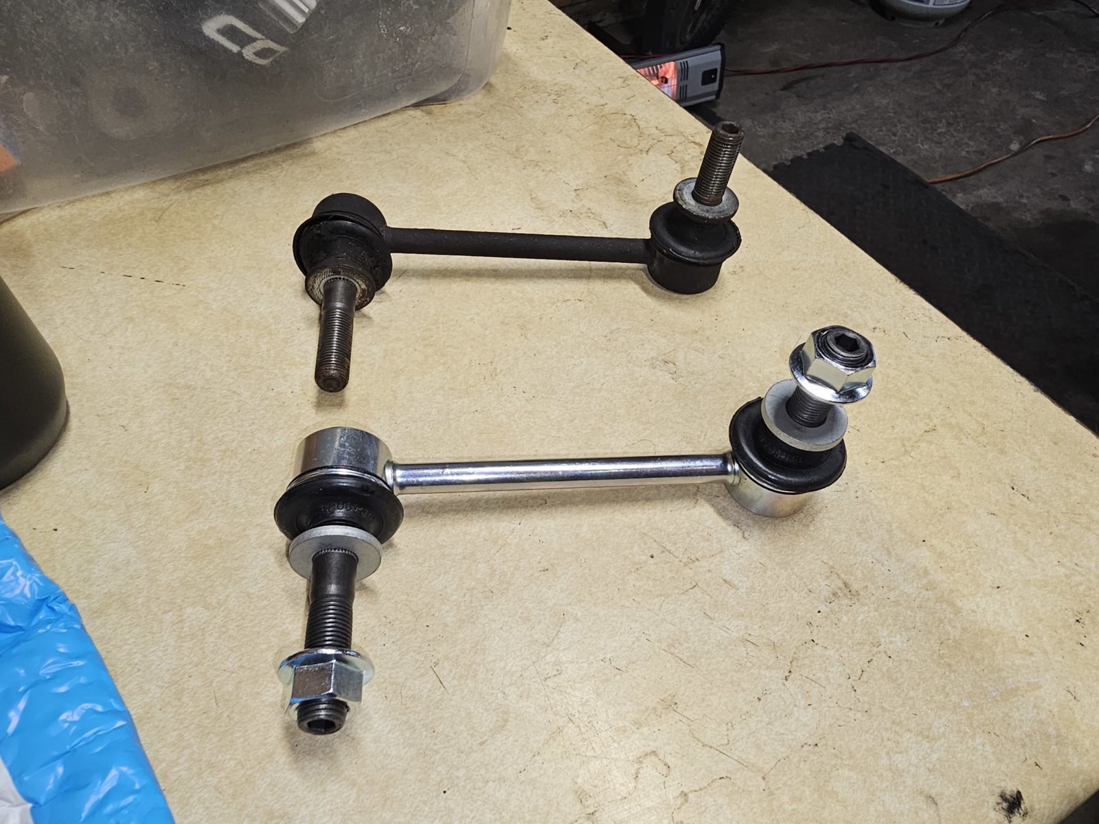

    Got some sway bar end links off Amazon
    Old vs New
    + $35

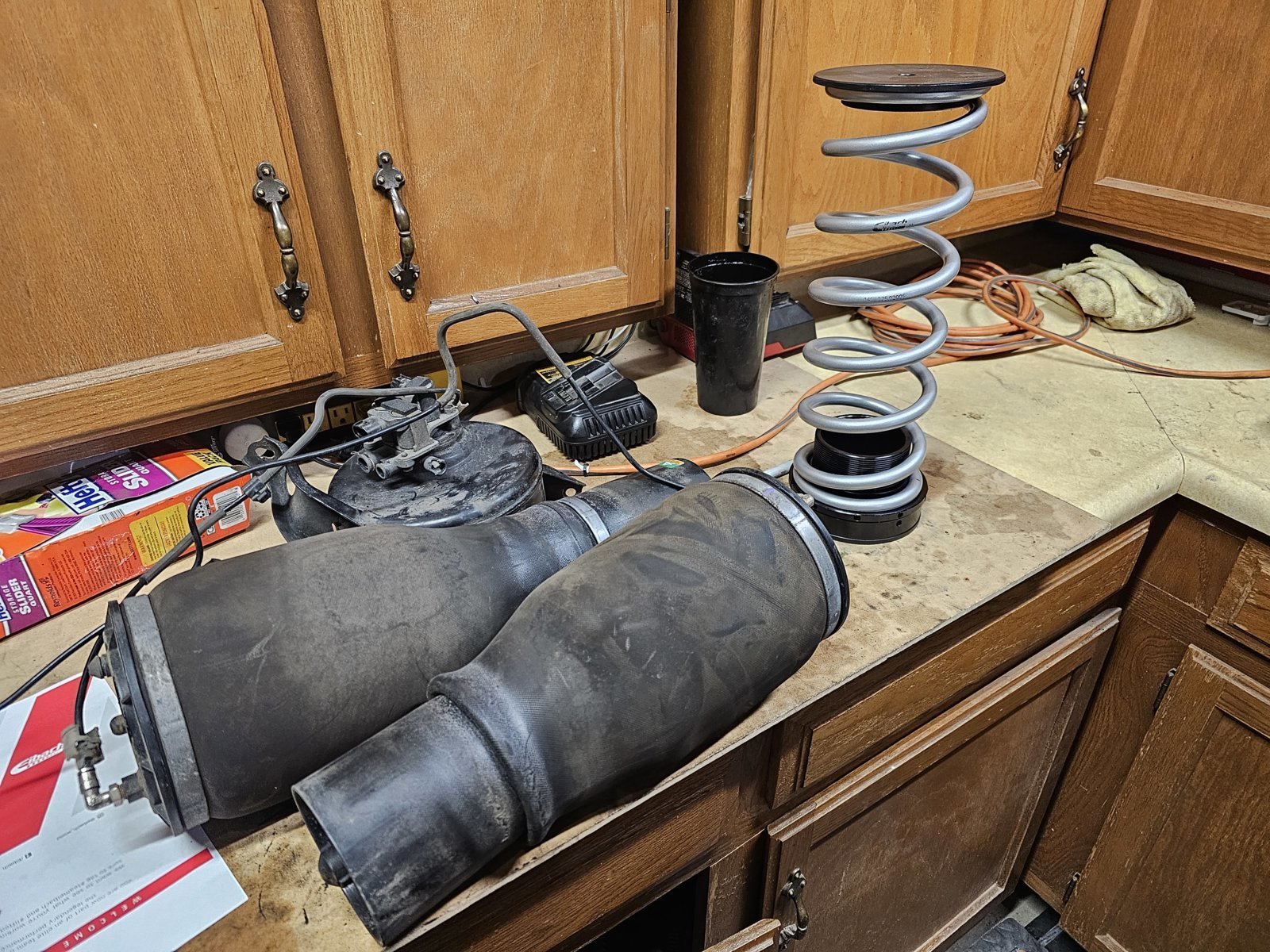

    Old Rear Air Bags vs New Eibach Load Leveling Spring System
    You can tell the Airbags were replaced at some point because of the "Made in Amerca" sticker. And one of them was leaking.
    Removed the OEM compressor also, one of the two bolts snapped...

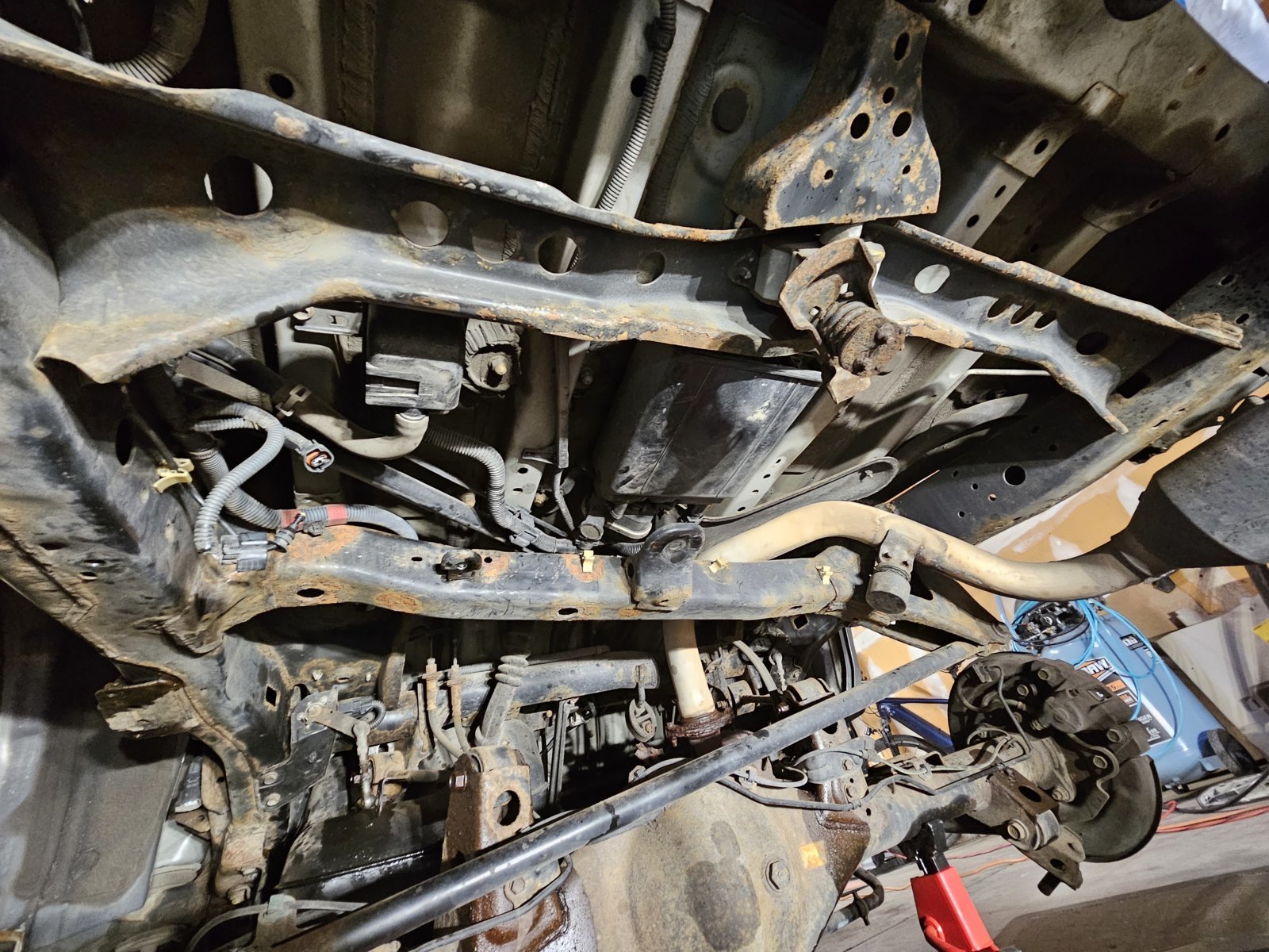

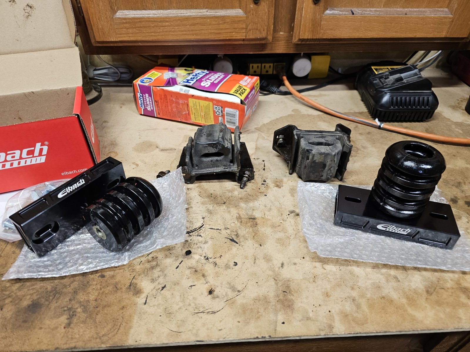

    Old vs New rear bump stops
  23. Nov 20, 2023 at 3:22 PM
    #203
    M3Tundra-JK
    M3Tundra-JK [OP] New Member
    May 3, 2022
    #77930
    2,725
    Scott
    2005 GX470
    After poking around with a screwdriver, pretty much same as the front rust wise. Not good, not terrible.

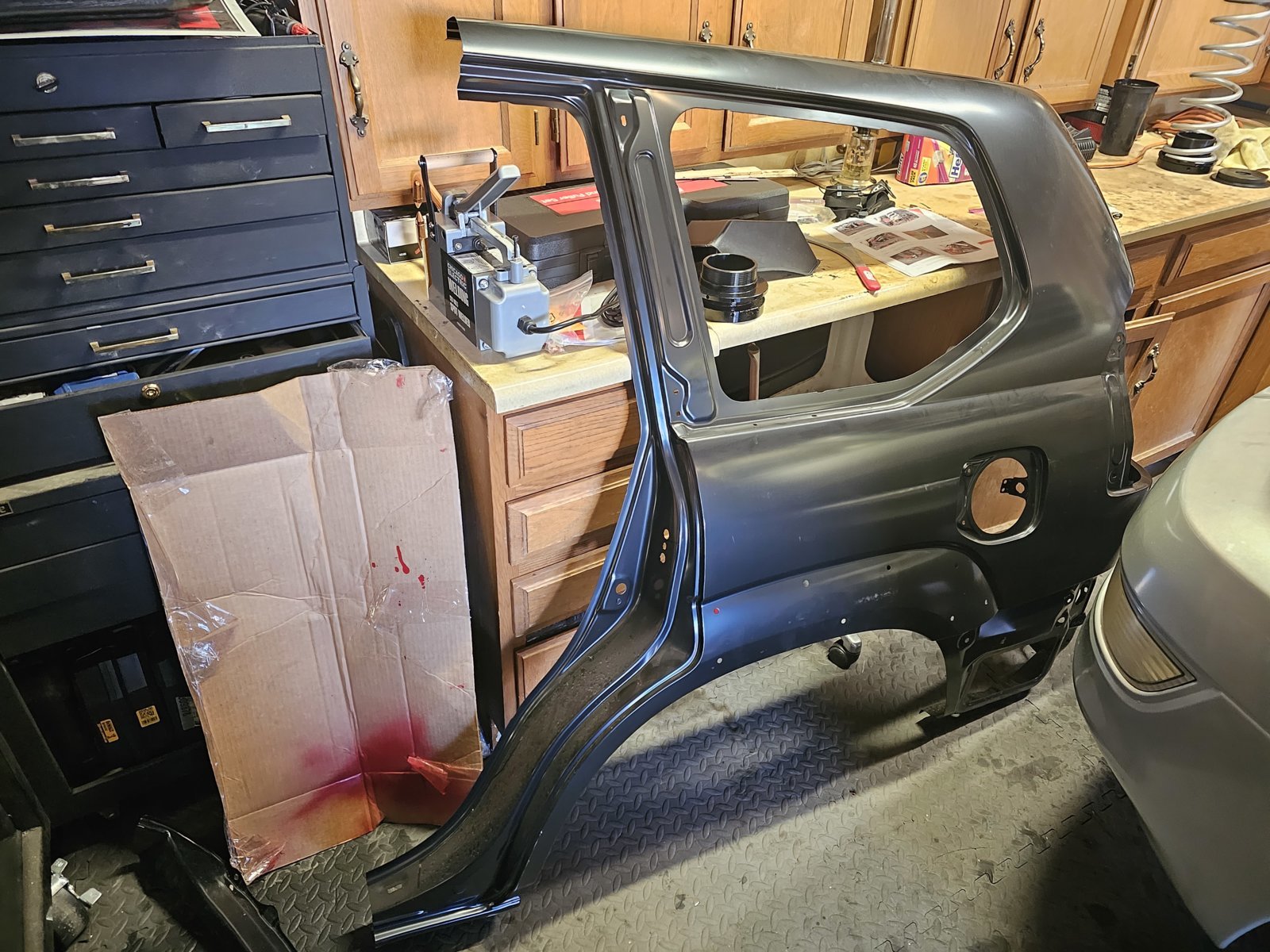

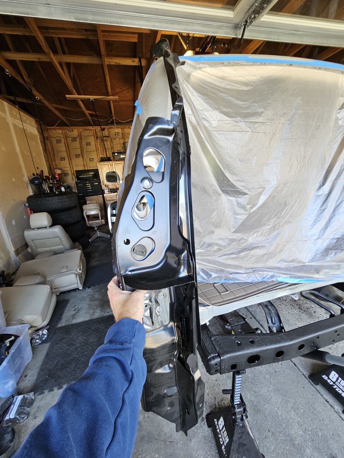

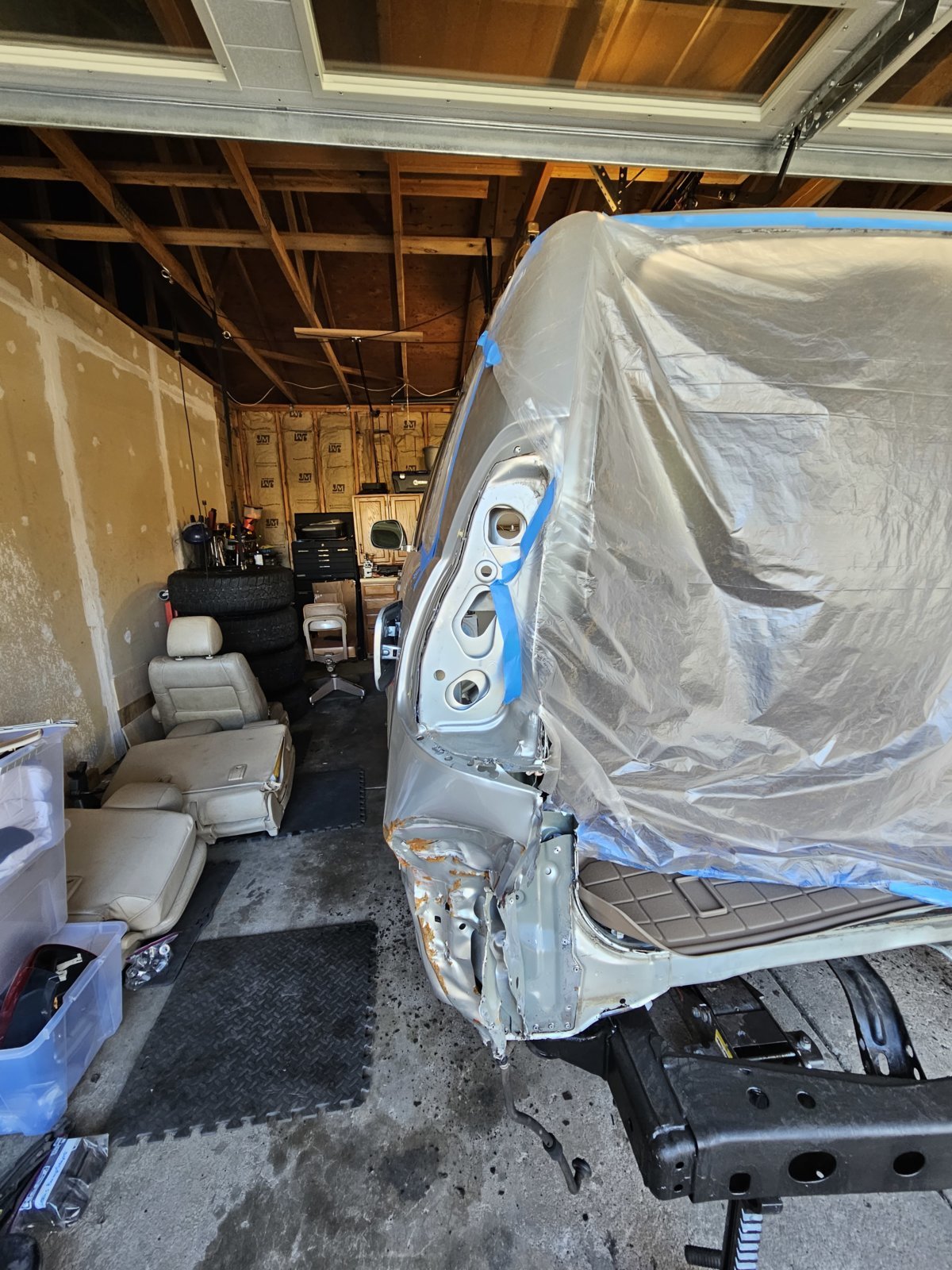

    Body parts are here!
    Old vs New Quarter Extension
  26. Nov 21, 2023 at 12:09 PM
    #206
    M3Tundra-JK
    May 3, 2022
    #77930
    2,725
    Scott
    2005 GX470
    Old vs New Quarter Panel
  27. Nov 21, 2023 at 12:15 PM
    #207
    M3Tundra-JK
    May 3, 2022
    #77930
    2,725
    Scott
    2005 GX470

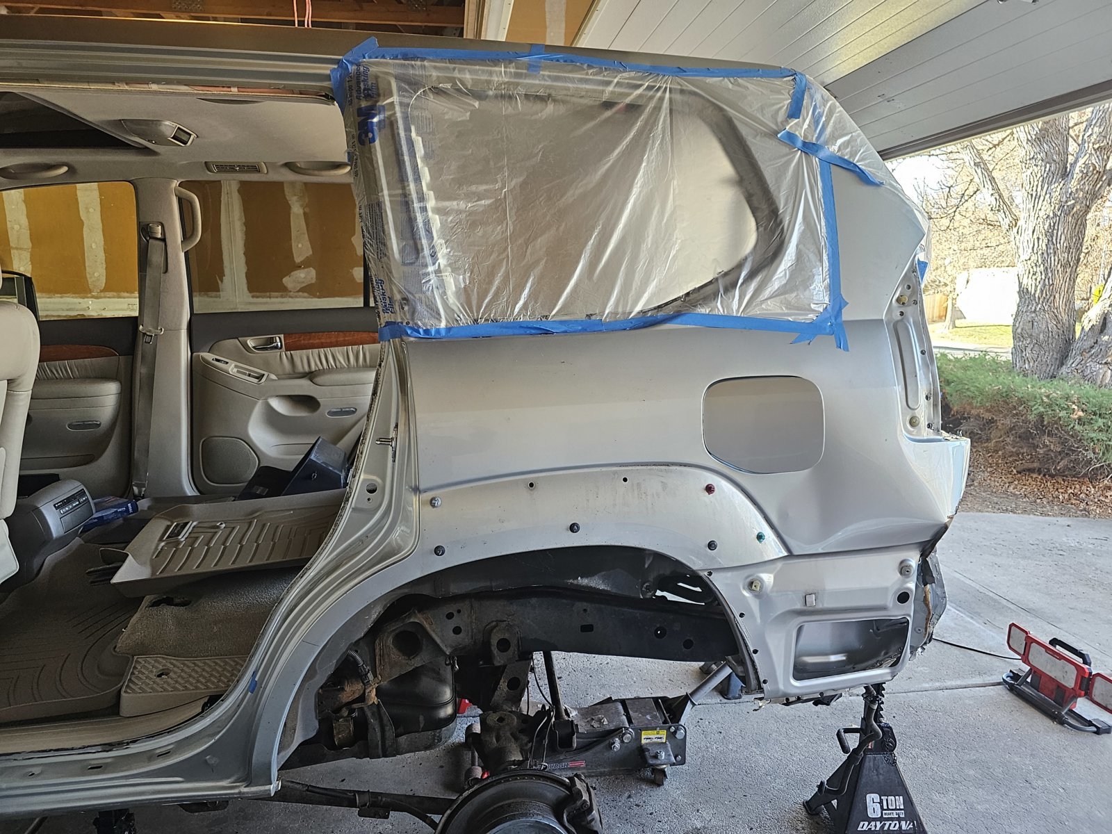

    Plan is:
    Address rear rust and POR15 it
    Install new rear suspension
    Remove quarter panel
    Straighten what needs to be straight underneath
    Install new body panels
    I've never done body work before let alone weld anything, so this will all be a learning process for me

    My fear with welding and body work is twofold:
    Messing up electronic bits in the vehicle being welded on
    Warping the metal from excessive heat
    Oh I lied, one more
  29. Nov 21, 2023 at 12:20 PM
    #209
    M3Tundra-JK
    May 3, 2022
    #77930
    2,725
    Scott
    2005 GX470
    Lol fire is the main concern! Luckily there's not any electronics near where I'll be cutting and welding. The Spot welder is heavy! So I have to rig up a counter weight pulley system from the garage rafters. But there will be a few areas that require rosette welds. Those are gonna be the main test of new found abilities
