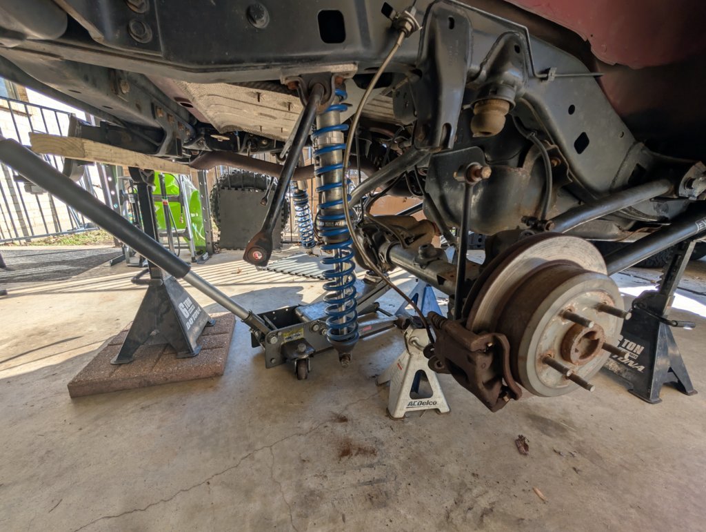

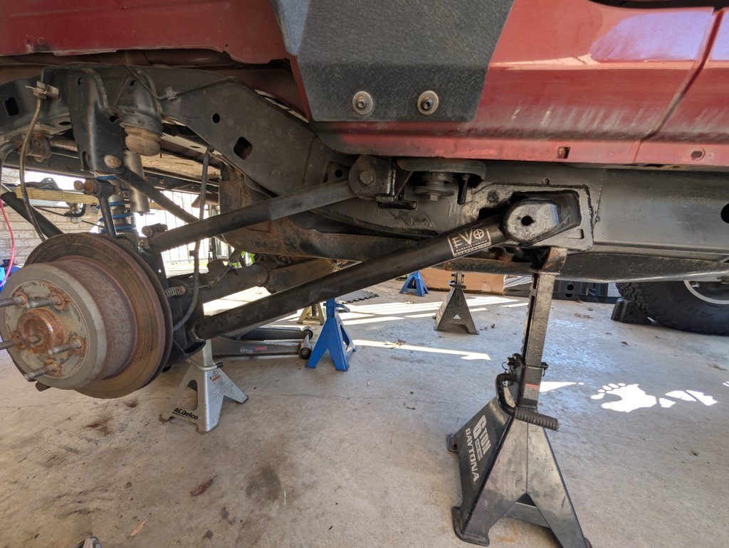

    Back to the JK. I've always known that the rear pinion angle was off. Because of the whole instructions debacle...I'm gonna try one more time to get it a little better without having to cut off the lower control arm mounts and welding in the new ones that I had to weld together, then weld that to the axle. I don't have high hopes lol. I'll be happy if I can get it just a little better.
    e30cabrio, Black@Blue19 and koditten like this.

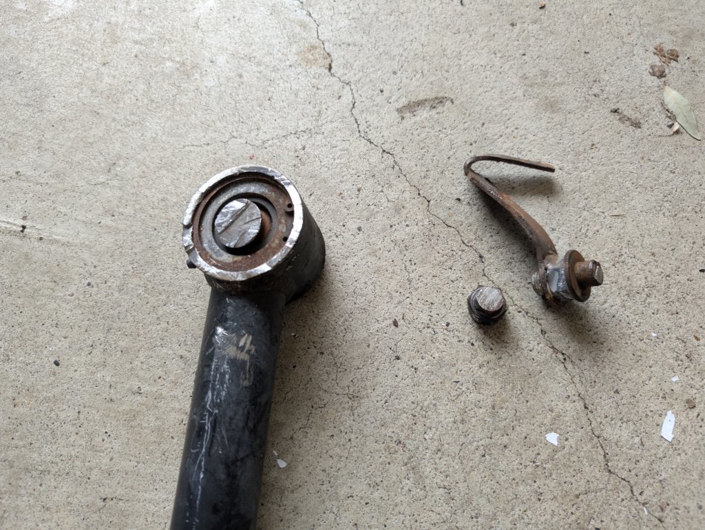

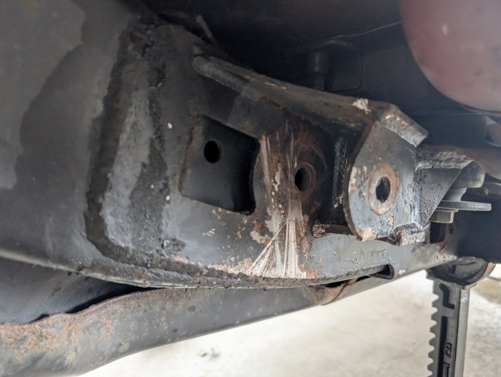

    Yup, more seized bolts. Same upper control arm bolt as the driver side that was seized. Plus one of the lower control arm bolts. So two I'm gonna have to cut out. And order new Johnny joint rebuild kits

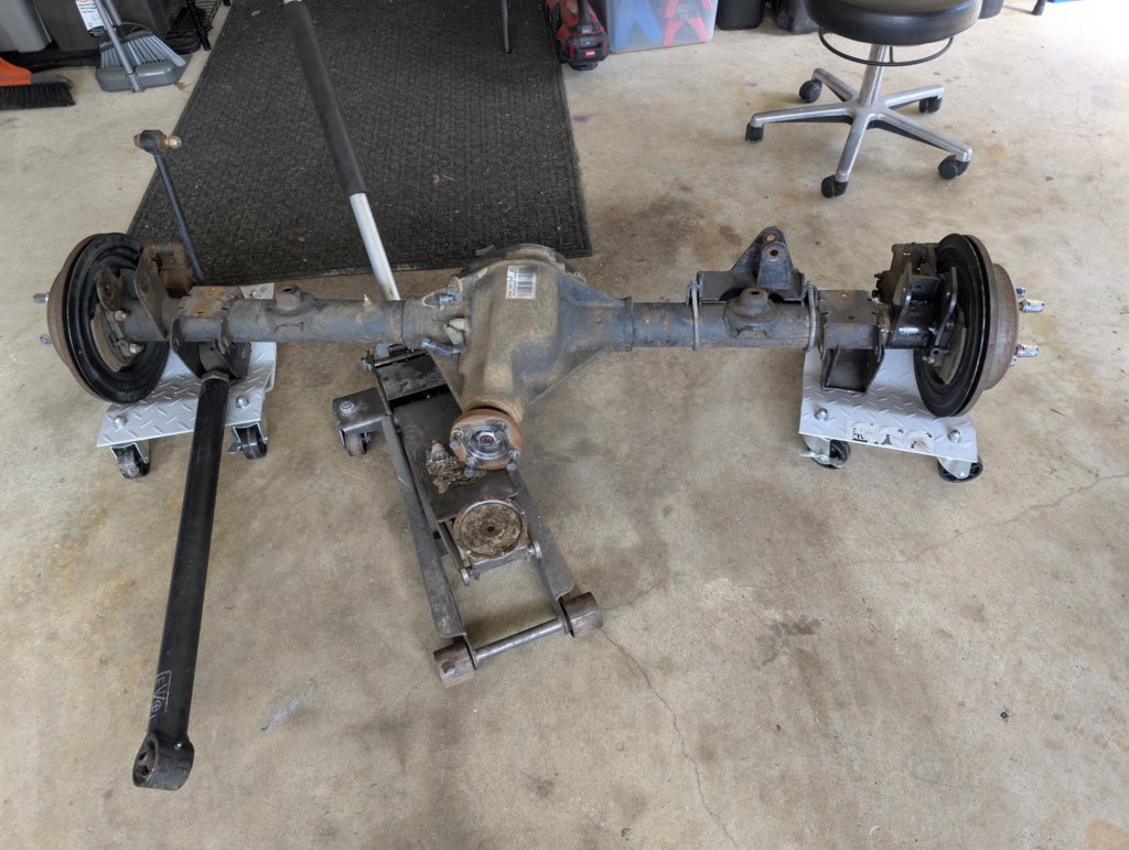

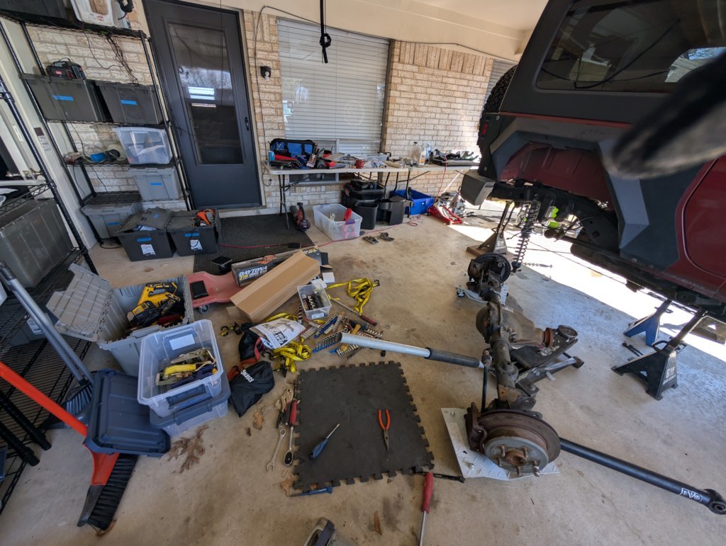

    F it. Removing the entire rear axle. Done for today. Time for a soak in the bath, then hanging with some friends this evening. Will return to this tomorrow. Need to disconnect the driveshaft so I can wiggle the one stuck lower control out out. Then cut two bolts before the axle is free. Everything else is disconnected

    Improvised axle mover. None of the stores around had an axle adapter for the floor jack so I made due with some car wheel movers.

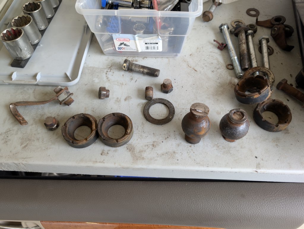

    Finally got the seized control arm bolts out. Note to self: just buy the $$ blades to begin with. Went through 4 others I had laying around before buying the bigger one which cut right through.

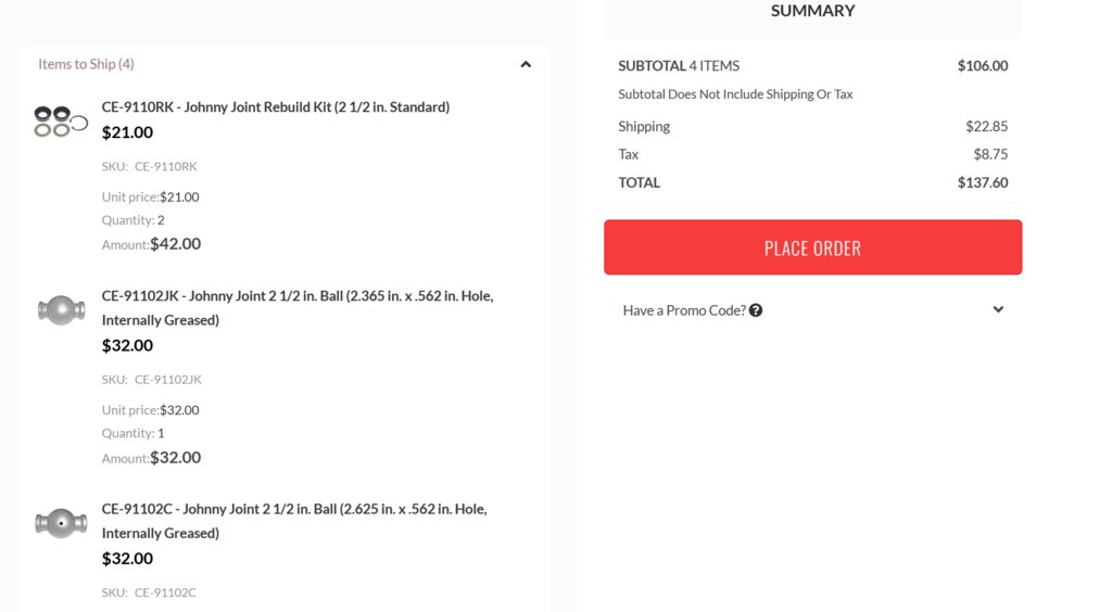

    Getting ready to place an order for replacement JK parts. Thinking about adding greasable bolts, for a few places I could service them at least. Wouldn't be able to on the Frame side upper control arms, the ones I had to cut out.
    https://www.rockjock4x4.com/CE-91107
    Edit: on second look, yes I would be able to use them on the frame side UCA

    ^^^^^ Yup,,,, that'll do! Holy Moly those can turn into a real PITA! You have put your time in, that is a definite. :)
    Get er Done!!!

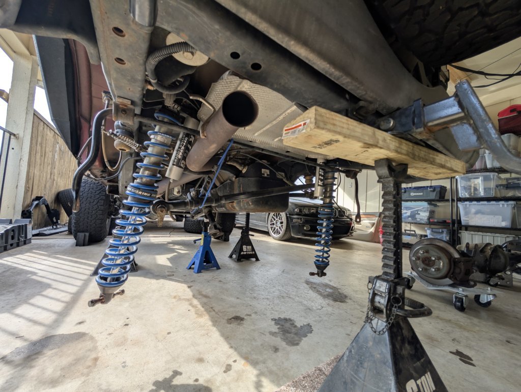

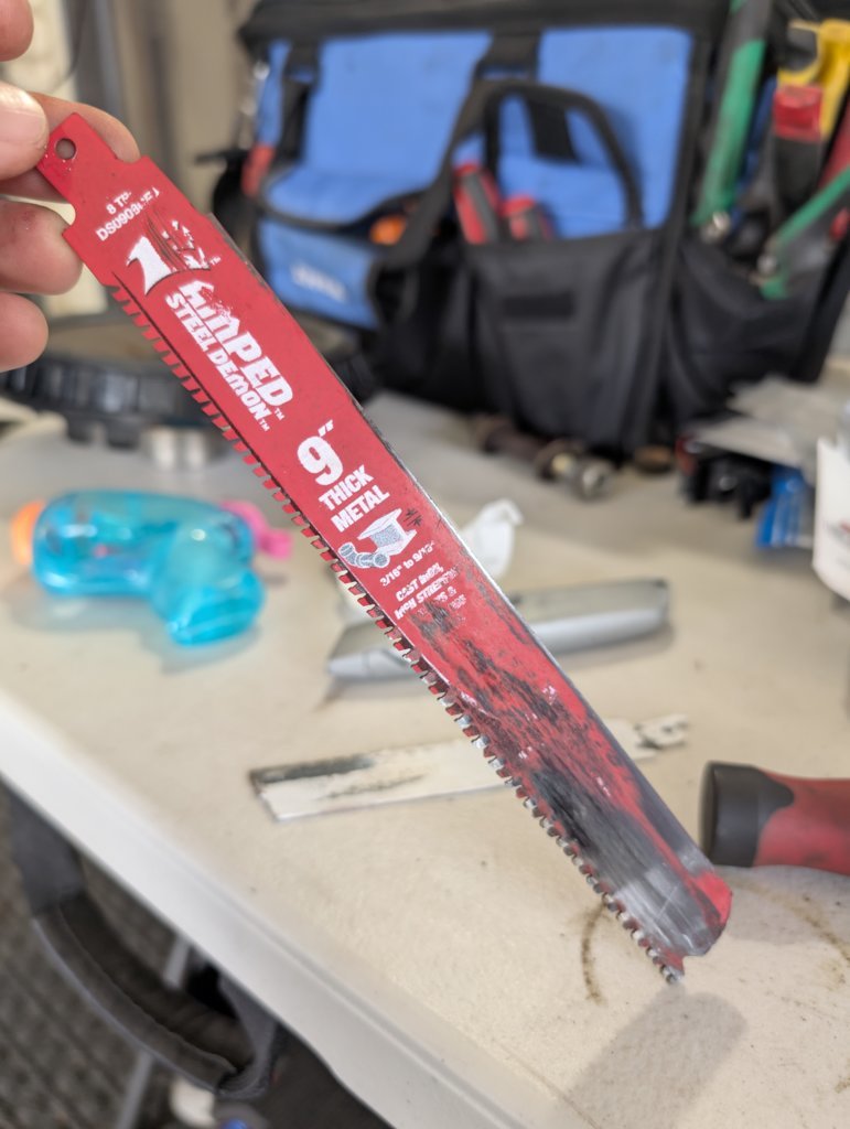

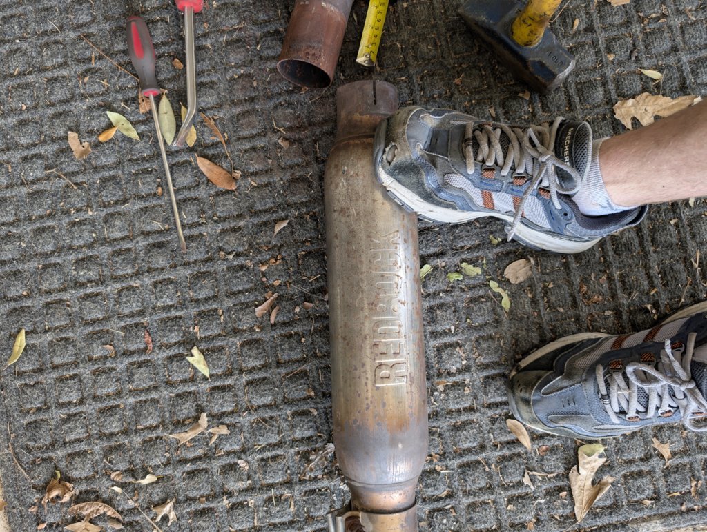

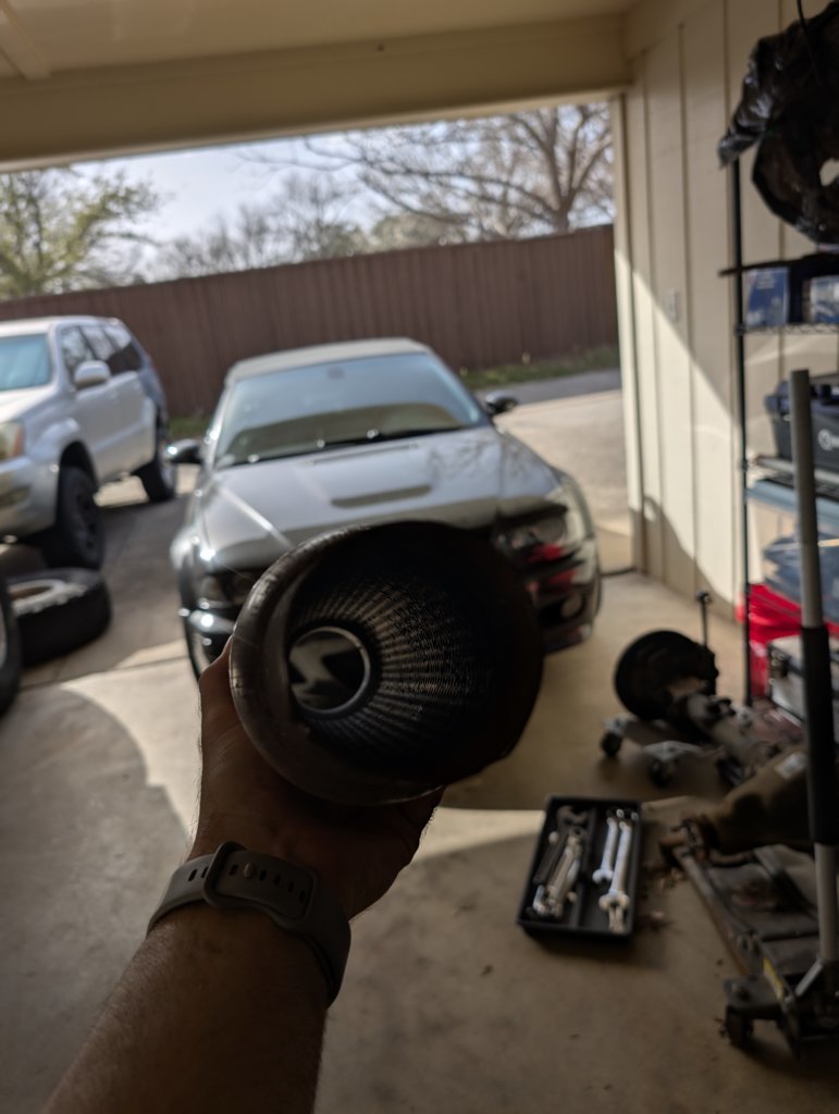

    Another PIA. Took a bit of torching the bolts and sledge hammering on the exhaust but I got it off and apart. Probably just dump it and leave the tailpipe off. At least for now. Sad it wore a good bit of the Coilover reservoir off.
