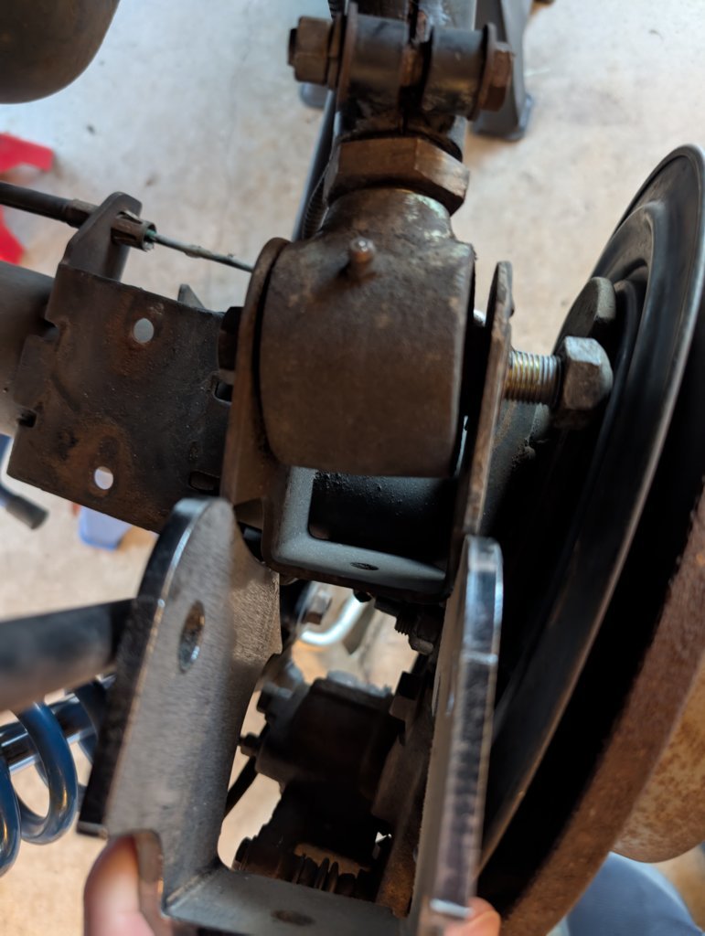

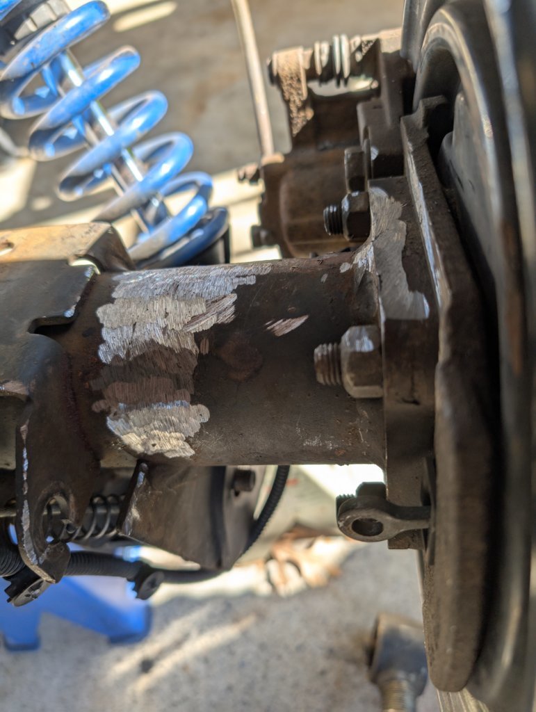

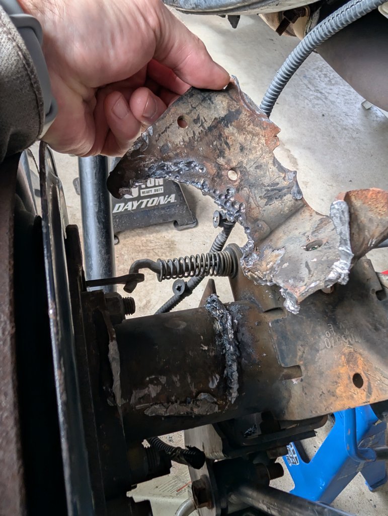

    Back to the JK. Got most must of the rear upper control arm bracket removed from the axle. Used a mix of air hammer and plasma cutter. Need to go back and grind the old welds down. And then order the new bracket, cost about $85 after shipping.

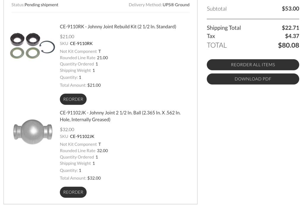

    For the JK, also ordered new johnny joint ball and bushing kit

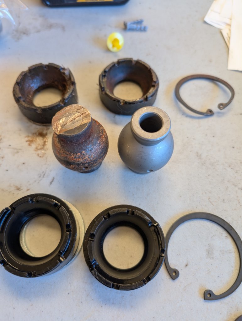

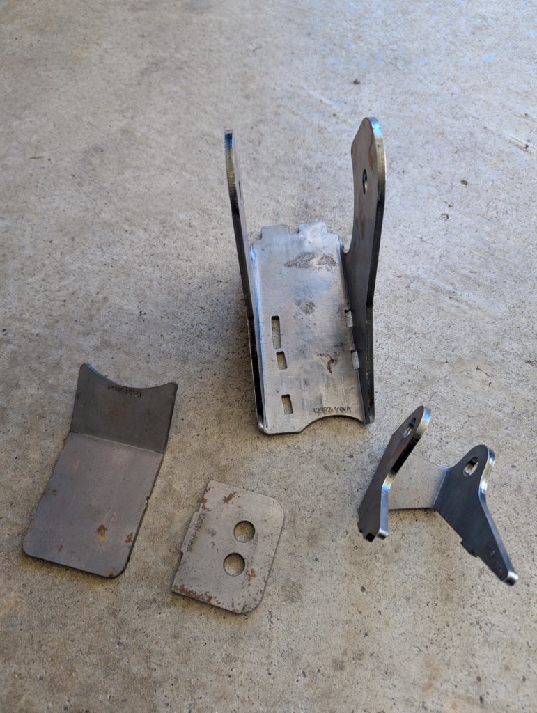

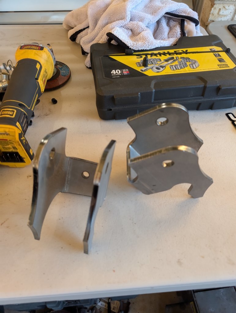

    Jeep JK
    Old vs New Johnny Joint ball and bushings
    Old vs New Artec Rear Upper Control Arm Axle Mounts

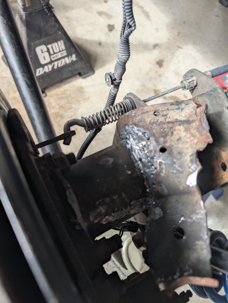

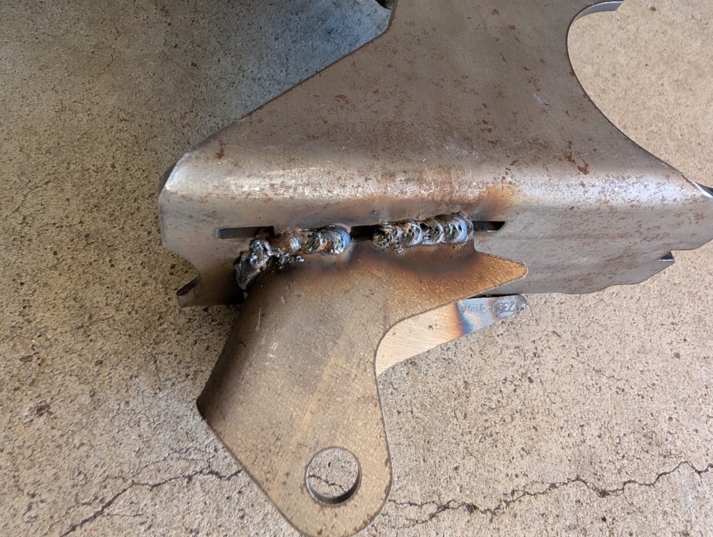

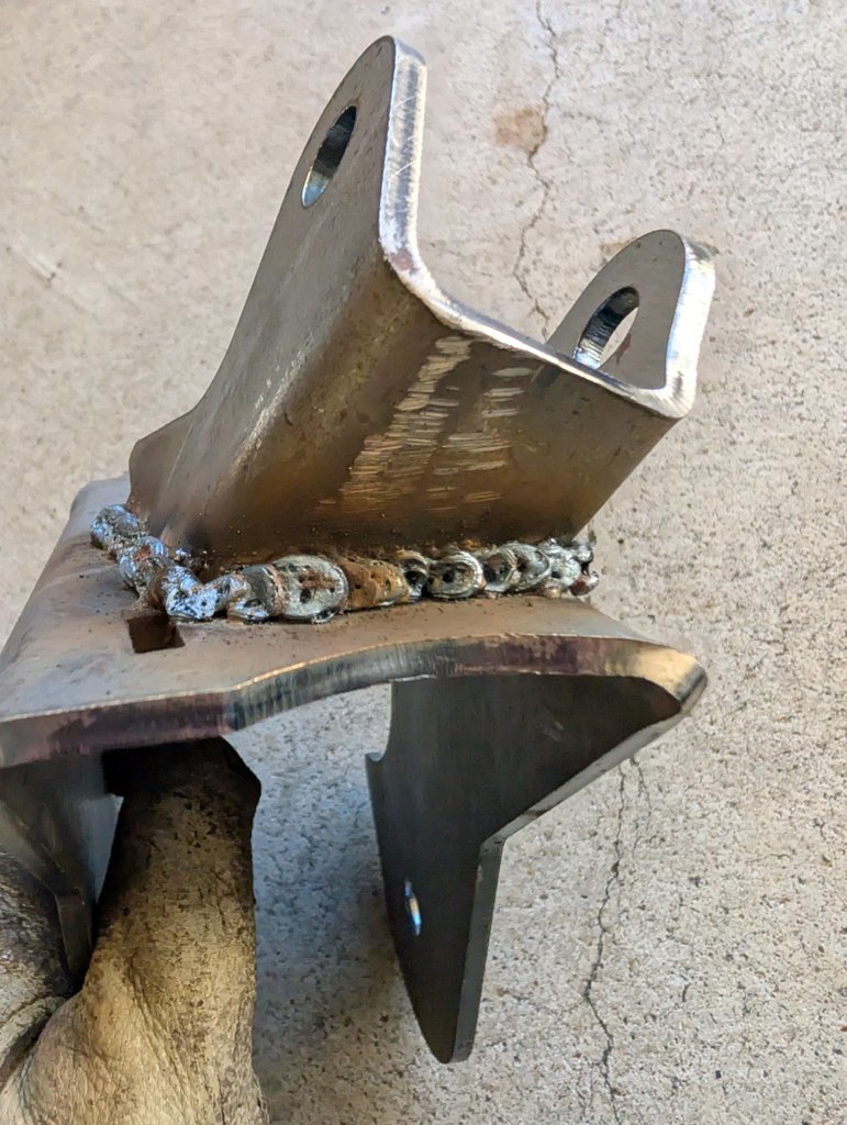

    Axle mount all ground down and ready for new part. Gonna practice weld on some of these other parts that came with the Evo lift originally. I never installed them because the EVO instructions are absolutely shit! It has me cut off parts of the original lower control arm mounts, then bolt on extra parts to those points for the coilovers conversion. Then pages later says, cut off all of the lower control arm mounts and weld on these other mounts, that you also have to weld together first. So fucking frustrating!
    It's because they sell this kit as a Bolt on Coilover conversion, long arm kit. They sell it as one kit. They market it as bolt on, welding optional. Bullshit!! Welding required! But in reality it's multiple different product kits they sell. They don't give you one set of instructions. They give you 4 different sets of instructions, one for each kit. They do not tell you what order to follow. And each set of instructions contradicts the other. I will never give EVO a good review, ever!
    e30cabrio and Black@Blue19 like this.

    Practicing....gonna keep at it today and tomorrow, probably weld axle brackets in next weekend. Welds aren't pretty. Will smack it with the 5 lbs sledge a few times to make sure it's staying together. I had to grind down the tabs on the shock mount part because of course they didn't line up with the slots like they were supposed to.

    Just realized I didn't turn on the shielding gas...

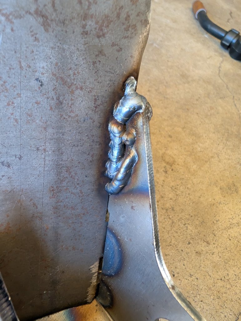

    Turned the welder down from 20 amp to 18, and the shielding gas on. Looks much better. But I gotta figure out the welding helmet settings lol. Got a little off track at the beginning

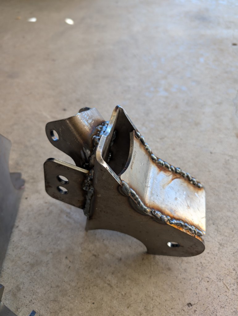

    One lower control arm/Coilover/sway bar mount assembled

    Weld looks too cold and maybe turn down the wire speed. Does not look like good penetration (TWSS).

    Watching a vid on wire speed basics right now
