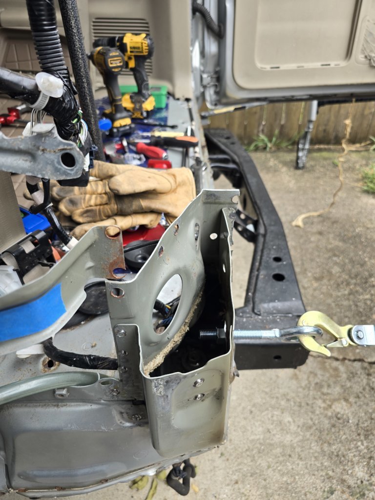

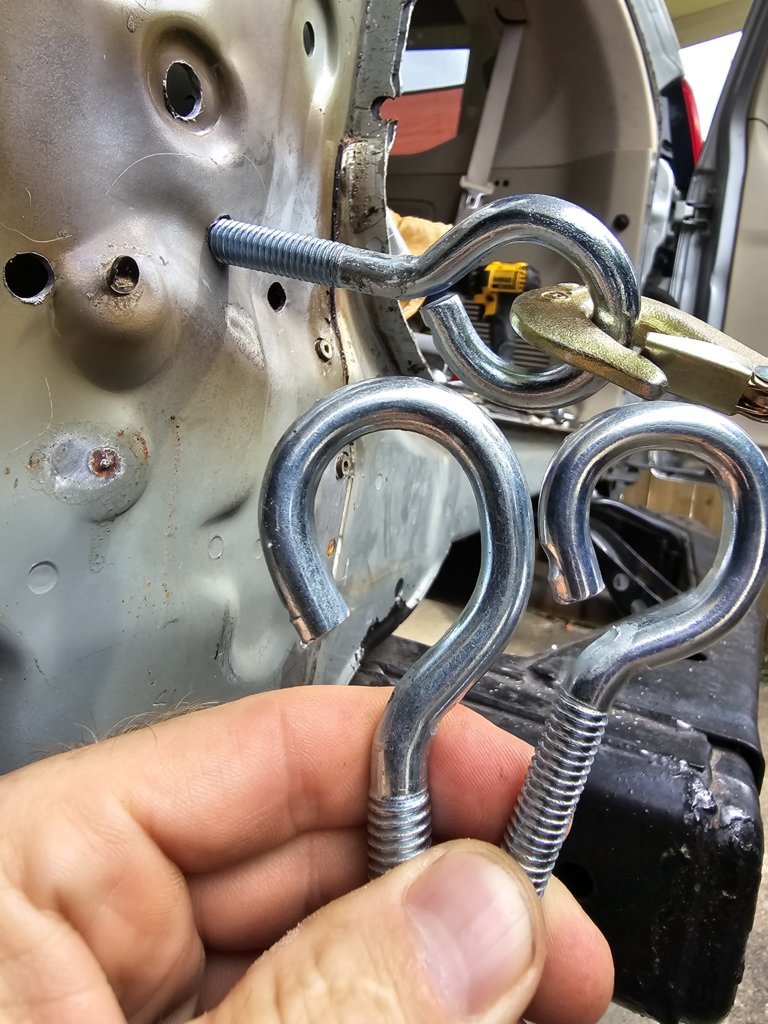

    Went back and got bigger eye bolts to pull with.

    The last picture shows it the best. (For me)? DANG! You are gettin er done!:)

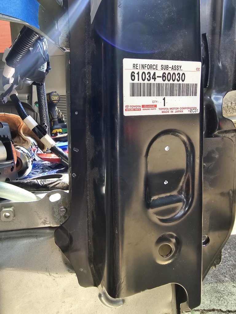

    Getting there slowly. Went and marked all the oem spit welds onto the new qp support. Most of it will line up correctly with little more needed to straighten out the tub.

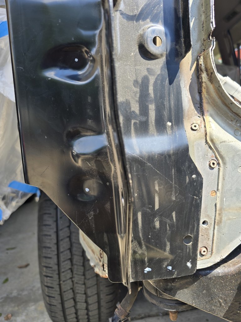

    Considerably straighter! Not perfect but it looks like I'll be able to do all of the spot welds I need so that the qp support is welded on straight enough, and the qp itself can be welded in straight, and the door shuts with no leaking...we'll see...

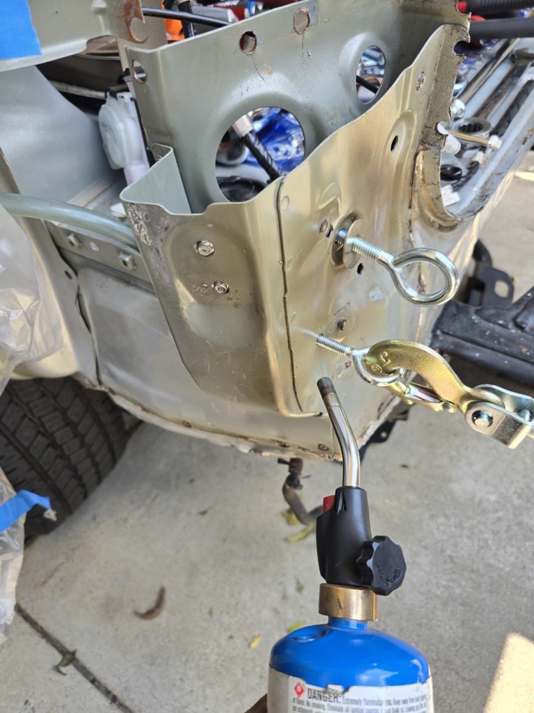

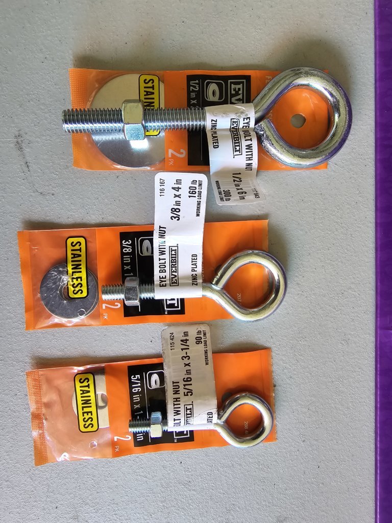

    I started with the
    I started with the 5/16, then 3/8 in different holes to pull but they both started to stretch. Didn't want to drill too many large holes so only used the 1/2" eye bolt in a couple or places but it's noticeably stronger than the others

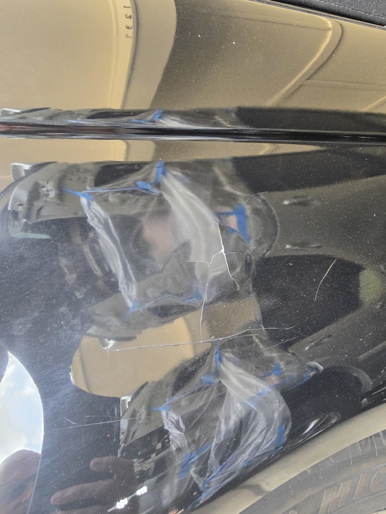

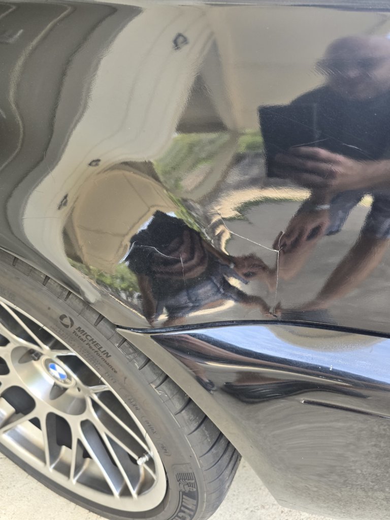

    This is even worse....on the M3, I finally confirmed hidden damage under bondo...had the vehicle over 9 years, and this is damage prior to that. For a long time now I've seen these two cracks on the rear quarter panels. They really just looked like a scratch. But it's gotten worse over time. And I finally checked. It's obvious now it's bondo but wasn't before. I confirmed with a weak magnet and it doesn't stick as well to the bondo areas. The entire car needs a respray anyways. So all that work will start after I practice painting on the GX.

    Sorry about the M, is there an accident on the carfax?
