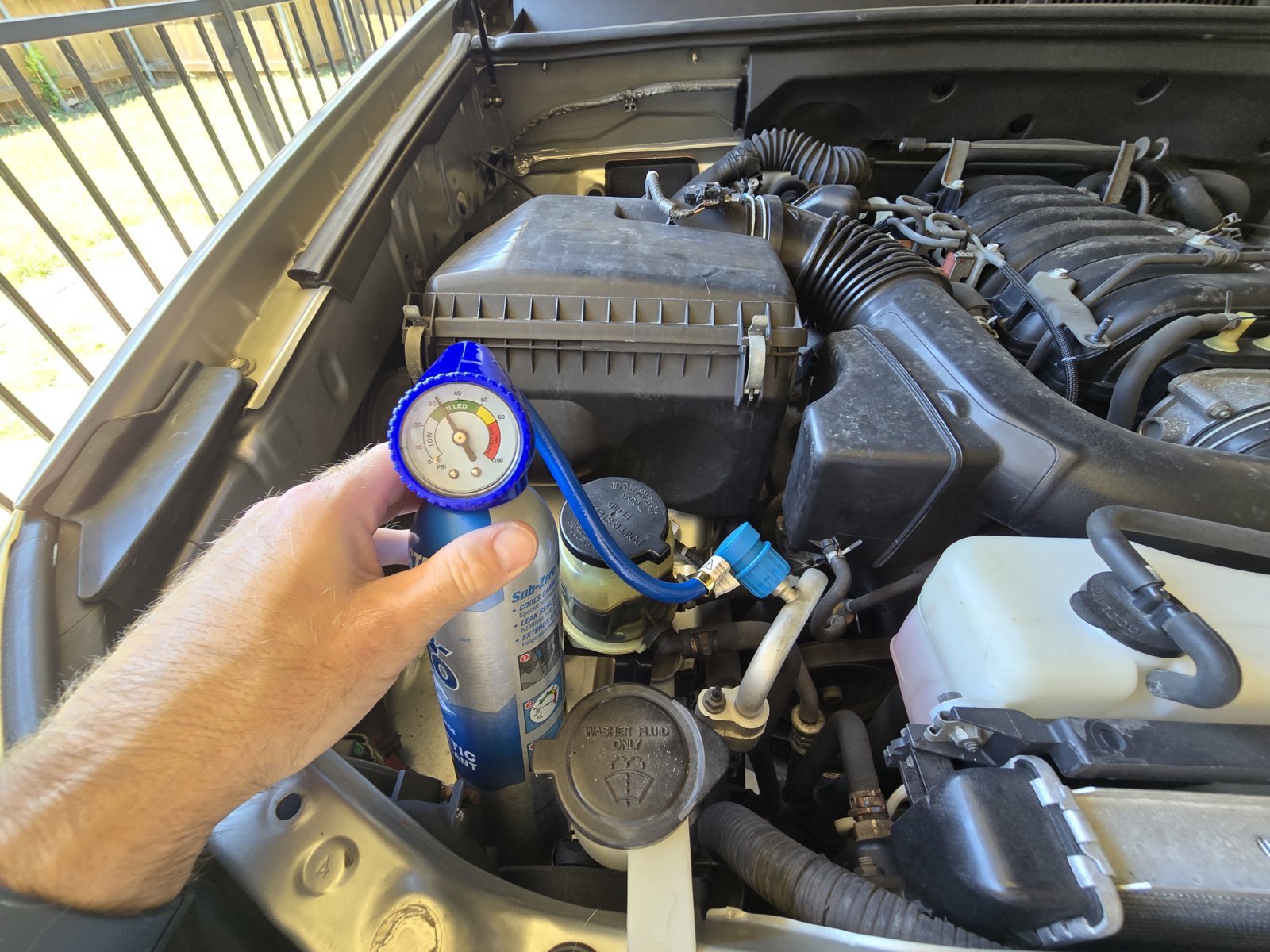

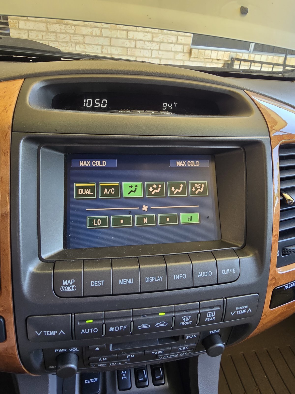

    Noticed it didn't have a/c when I moved it over to the new place. Just emptied a bottle of refrigerant into it and it's cold again. Probably go and get another bottle to get it up to 40, then top the Jeep off.

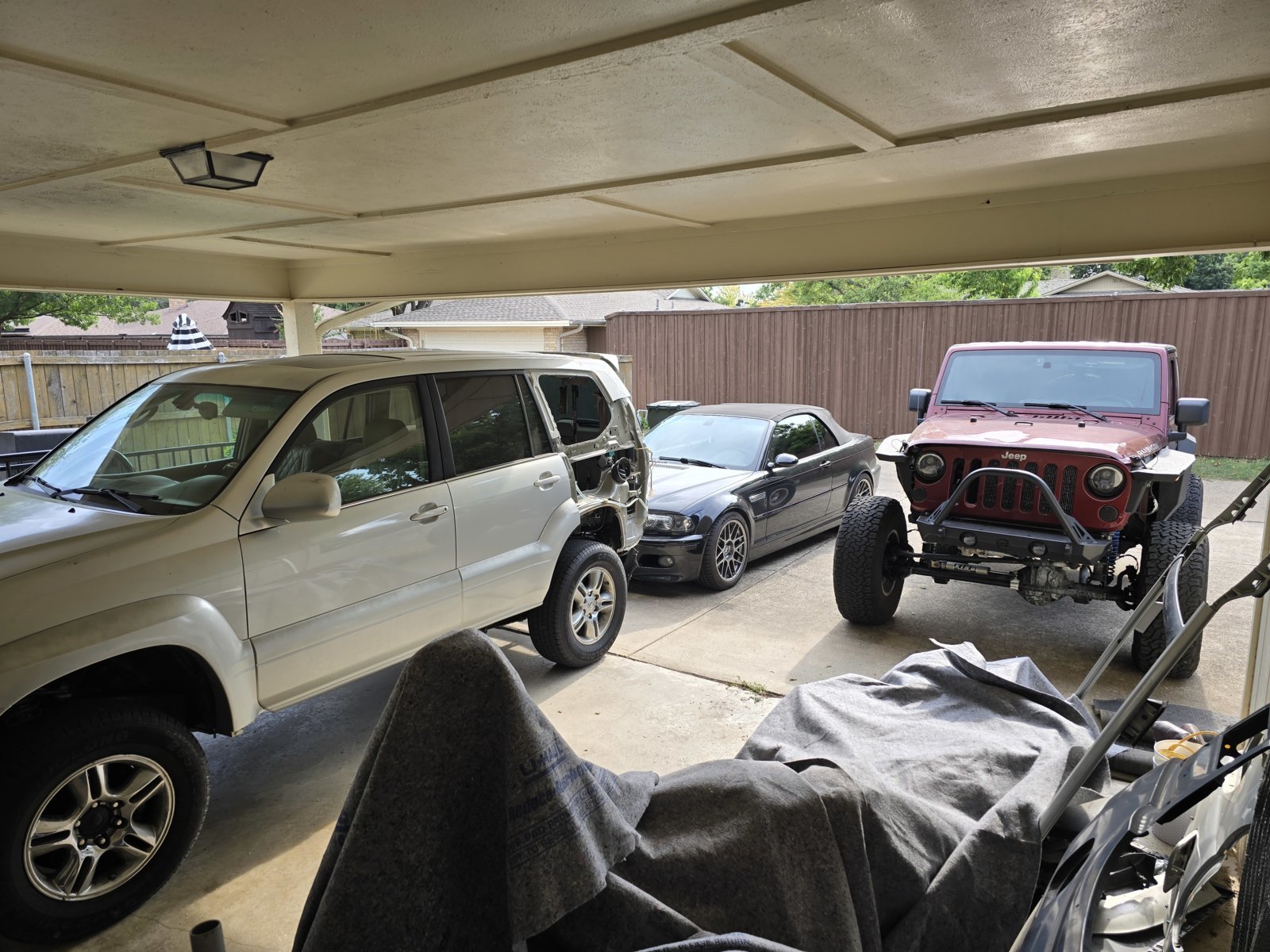

    The gang is all here, finally!

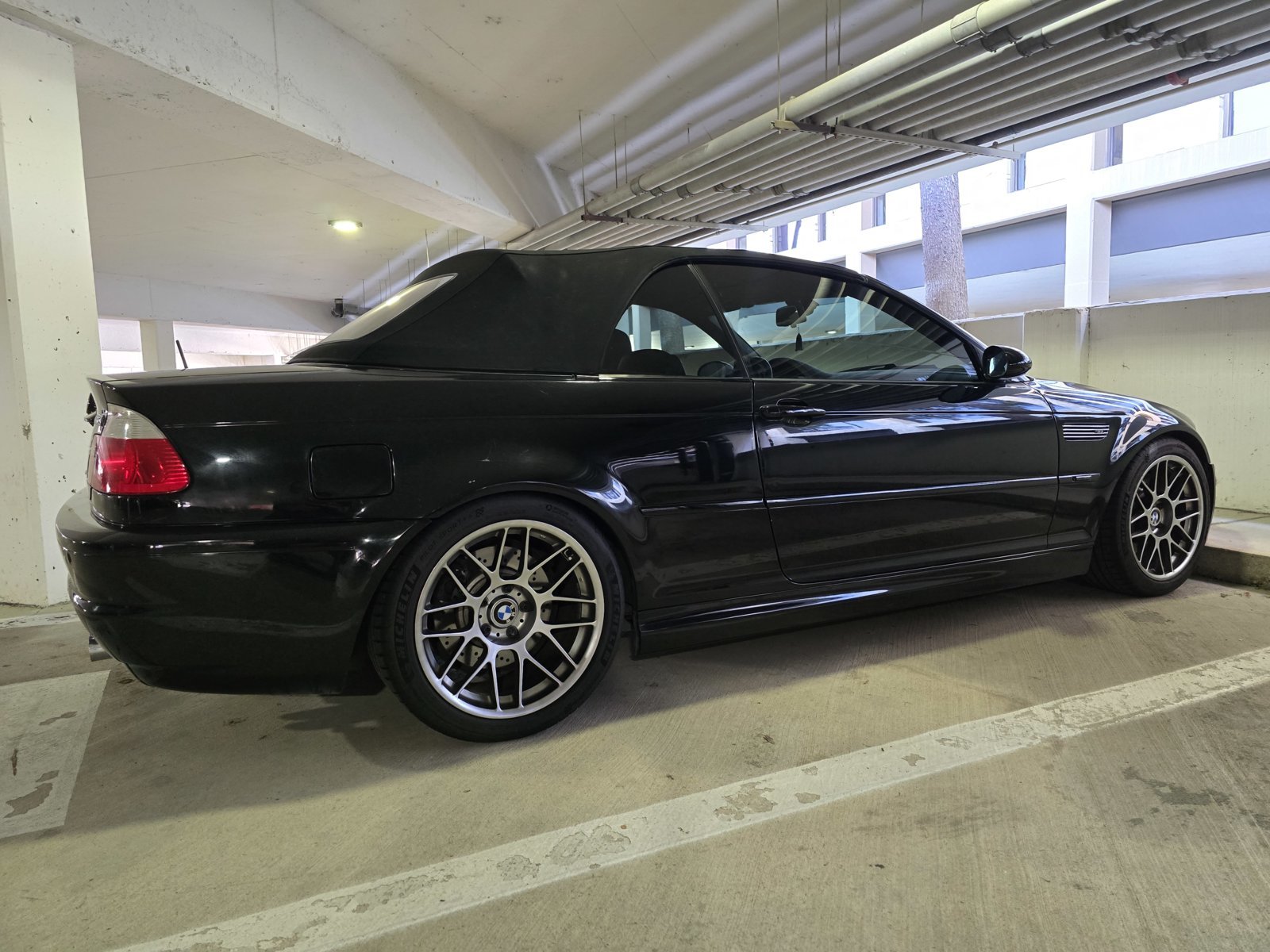

  6. Aug 21, 2024 at 9:55 AM
    #486
    M3Tundra-JK
    M3Tundra-JK [OP] New Member
    May 3, 2022
    #77930
    2,725
    Scott
    2005 GX470

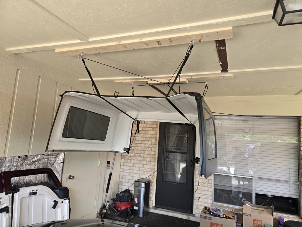

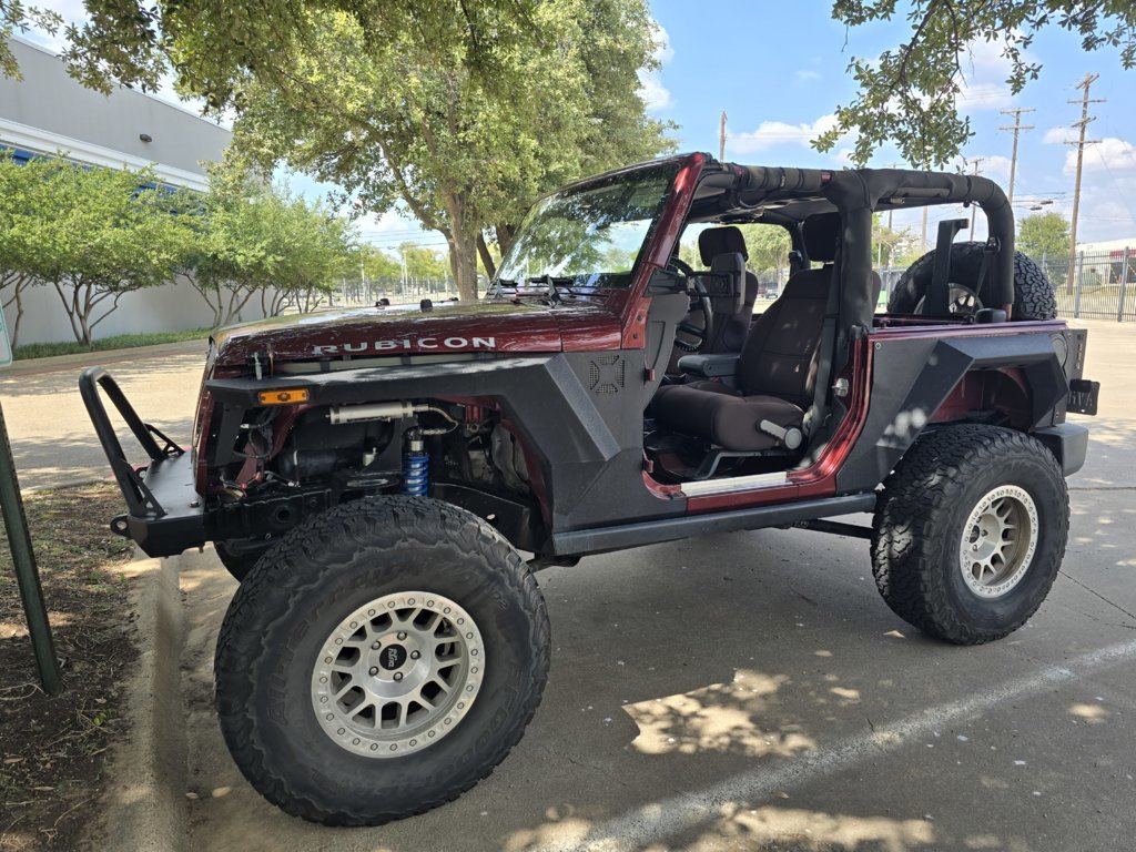

    Weekend project was to get the jeeps hardtop hoist installed at the new place now that the end of summer approaches and the weather starts to get nicer.
    My storage closest is absolutely filled with garage stuff now. Might see if they have any good discounts on a larger one this holiday weekend.

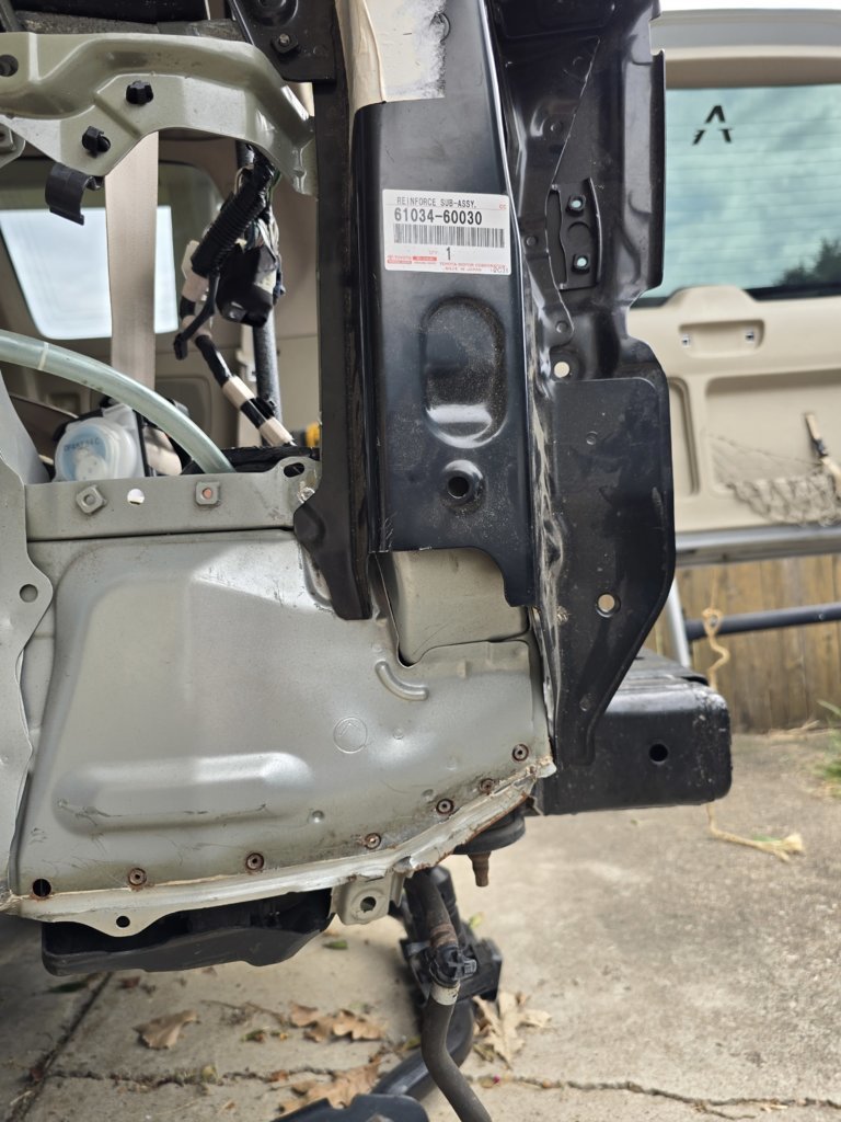

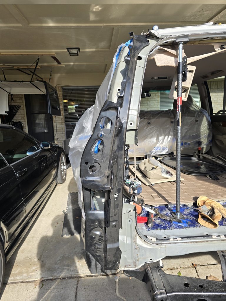

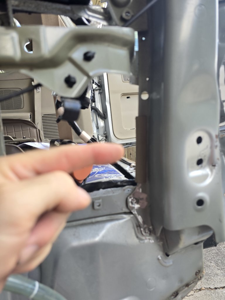

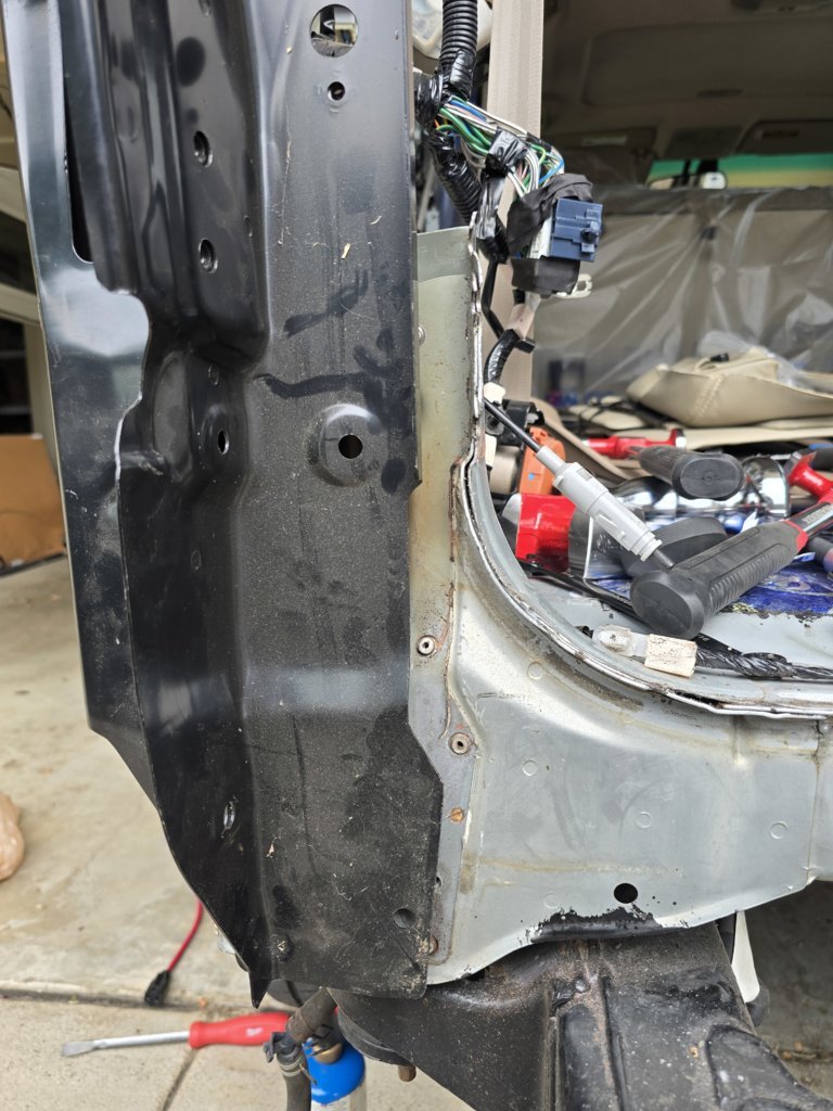

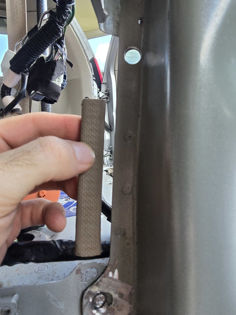

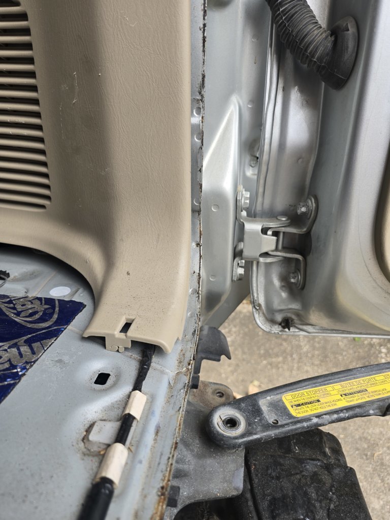

    For future reference. This thingie covers three spot welds

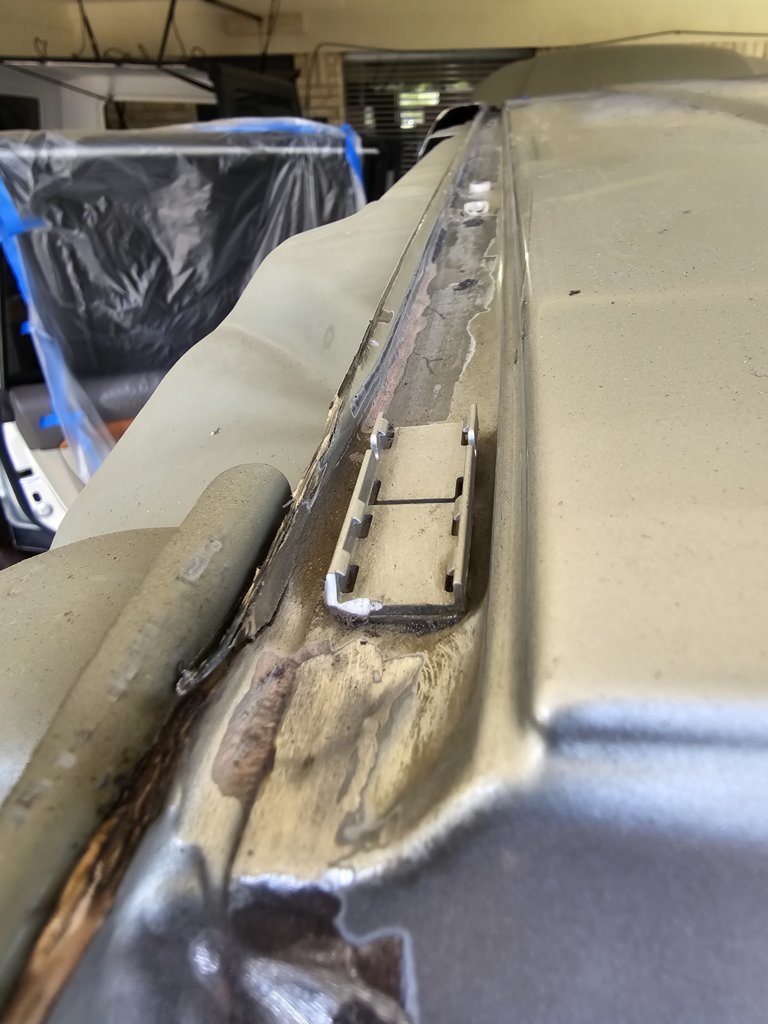

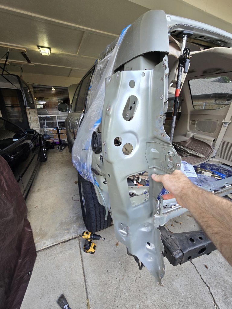

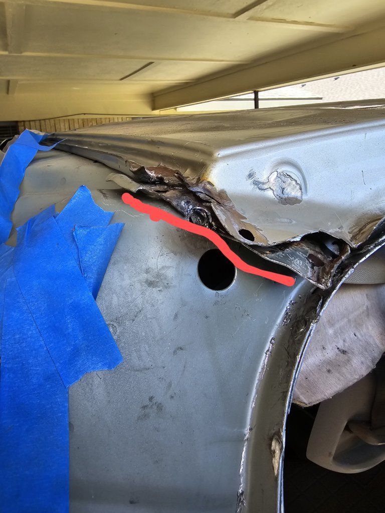

    And another part of the qp support out

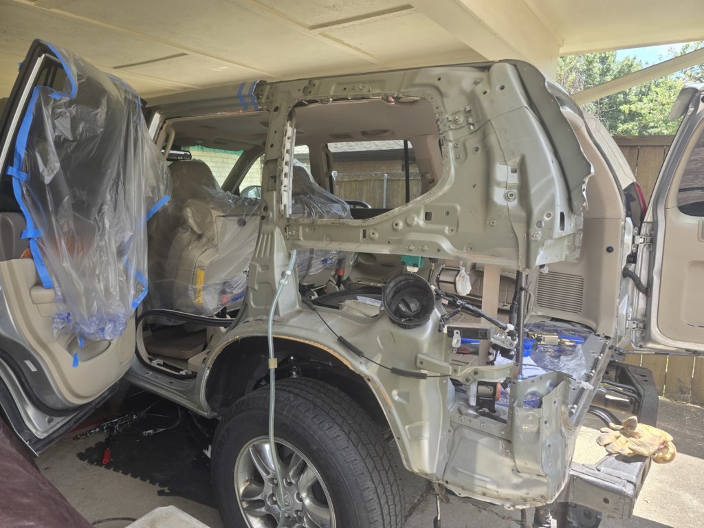

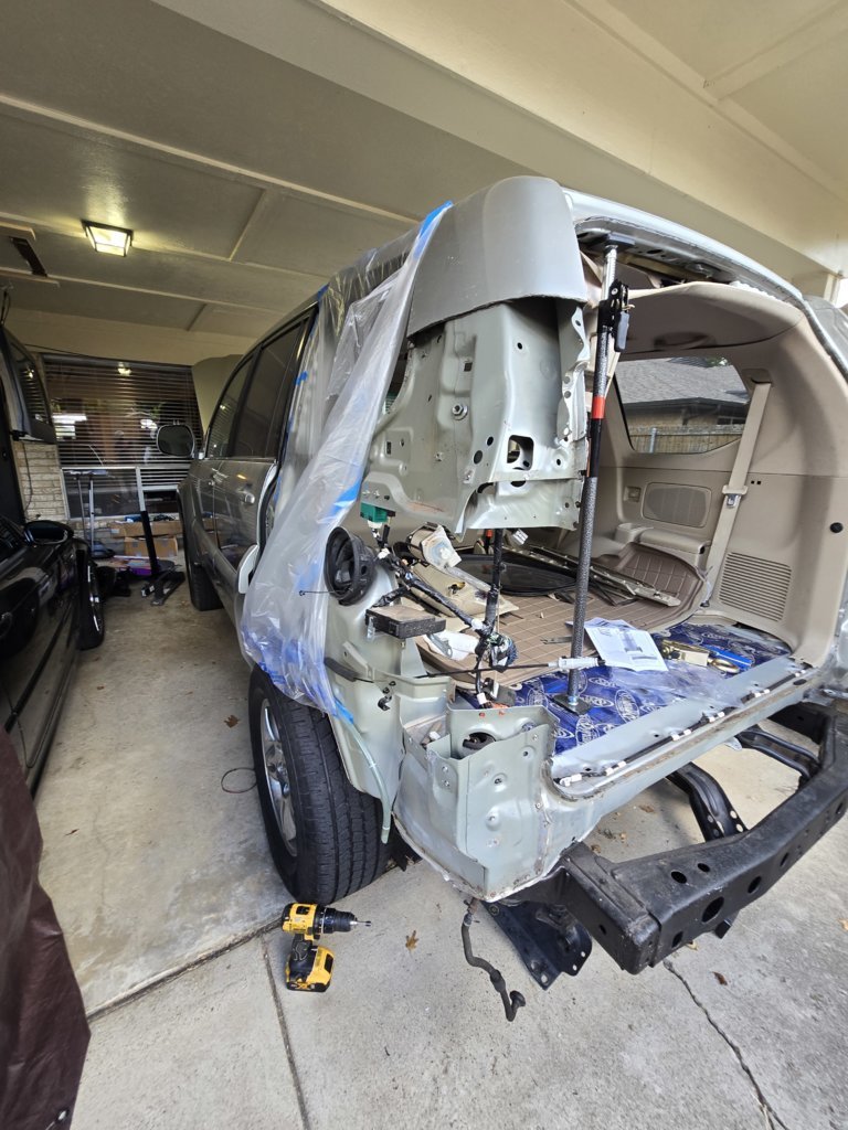

    QP 90% removed. Have 100% decided on the roof portion yet. The QP sheet metal sandwiches between the upper roof sheet metal and a lower inner sheet metal. So it's either pry those apart and pull it out or cut the new QP along the roof line. Either way will work fine. I made the cut to remove old QP in a spit no one is going to see

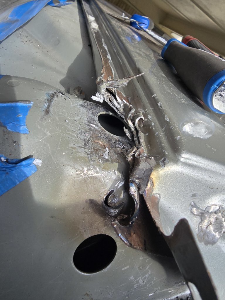

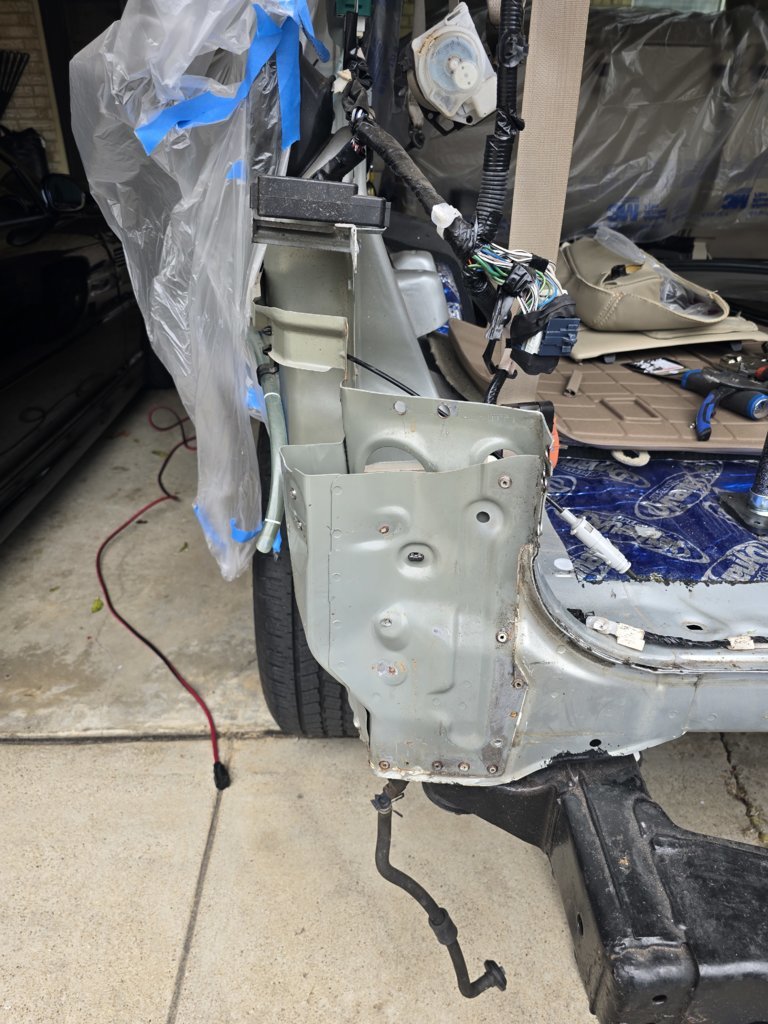

    This last little piece of the qp support is being a PIA yo remove. It's sandwiched between layers with a hidden spot weld

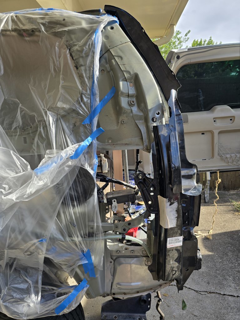

    Finally!! Bet my neighbors are just as happy as I am lol. Been banging with hammers and thin putty knives and spot weld drilling forever just for this top corner piece.

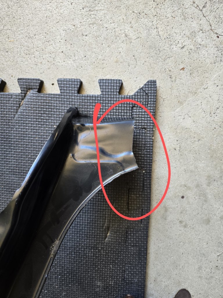

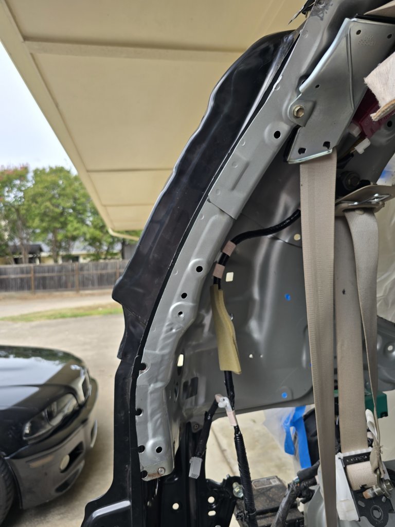

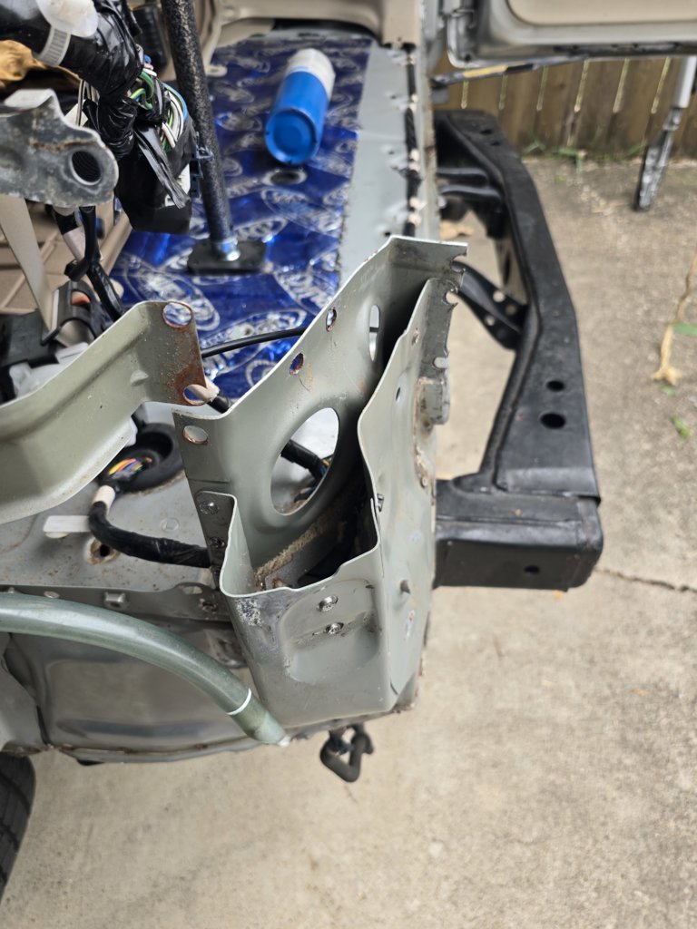

    I'm done for the day! But wanted to get a pic of the new qp corner support mocked up. Will have to massage it into place tomorrow. See what more of the bottom tub I'll have to pull out still

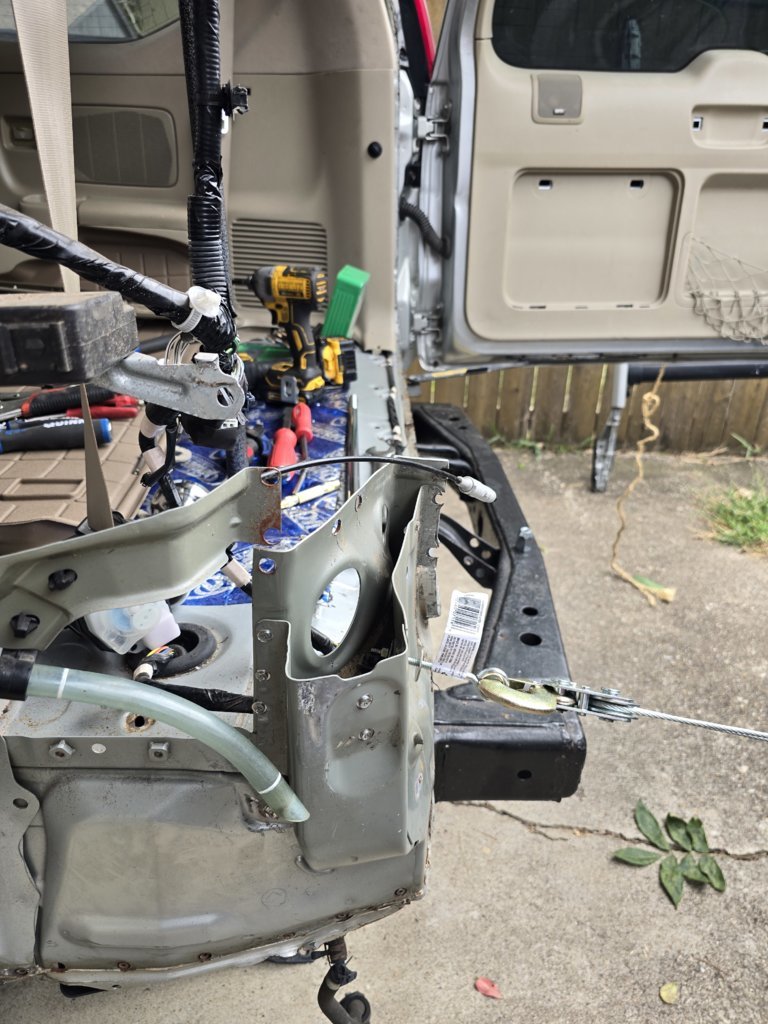

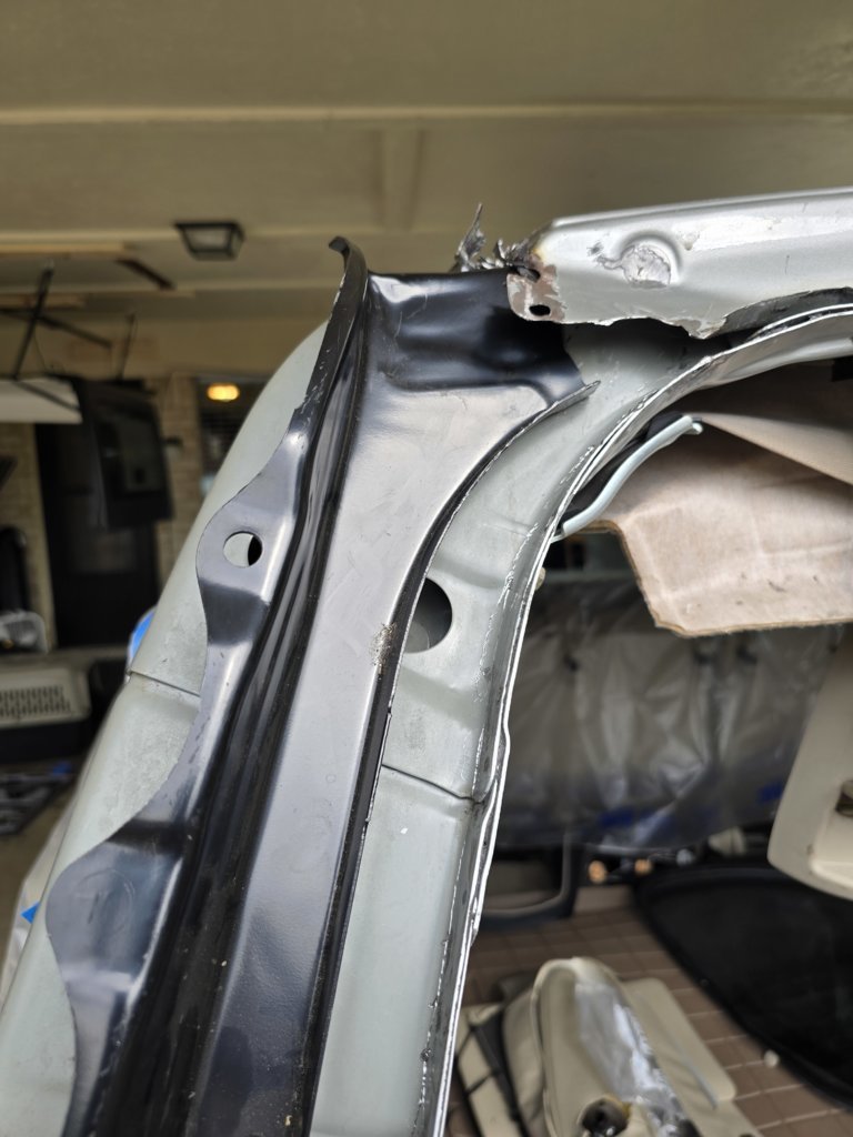

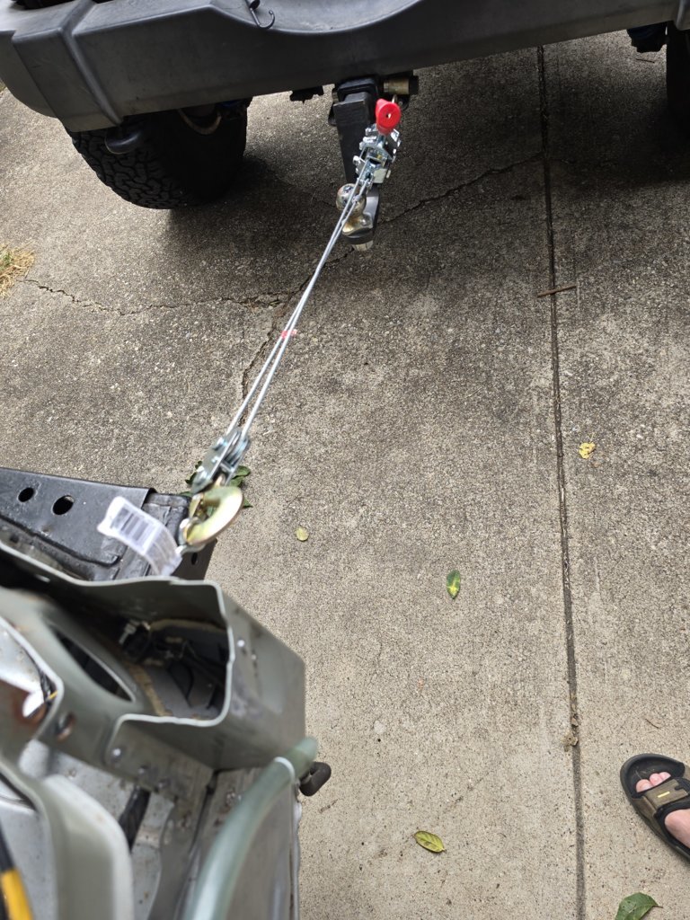

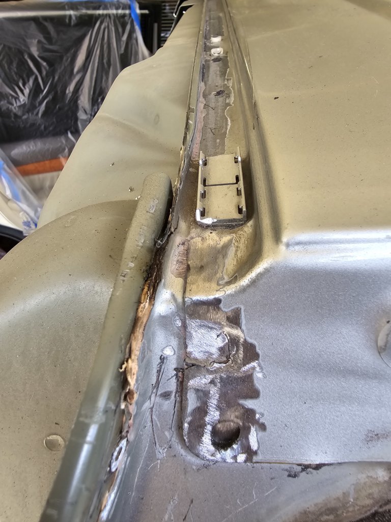

    So I still need to straighted out the bottom corner tub enough to get some good spot welds on the qp support. Looks easy enough but still trying to figure out what i need to do.
    Maybe drill a hole in the middle so I can thread a bolt/washer through then pull with winch?

    Made some progress. Used a eye hook and some washers with the puller. Need to go back and get a thicker hook though, the eyelet on the 1/4" was starting to stretch. Don't need that snapping on me. Was applying heat with the butane torch, not sure if enough heat though. Will continue working on the corner over the week.
