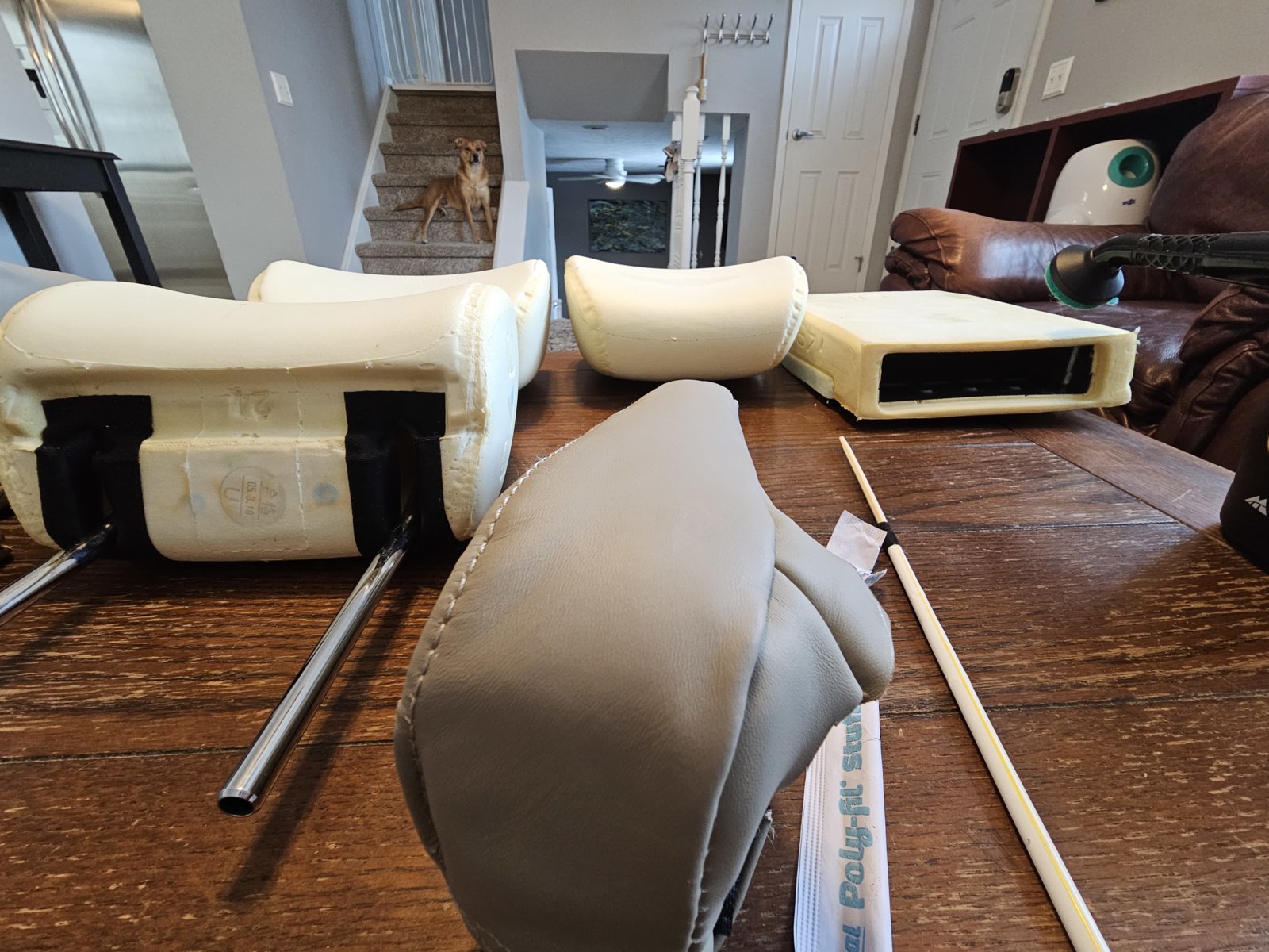

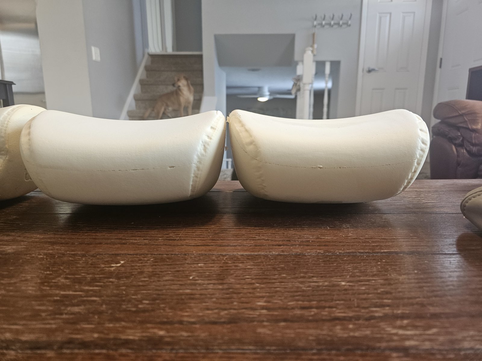

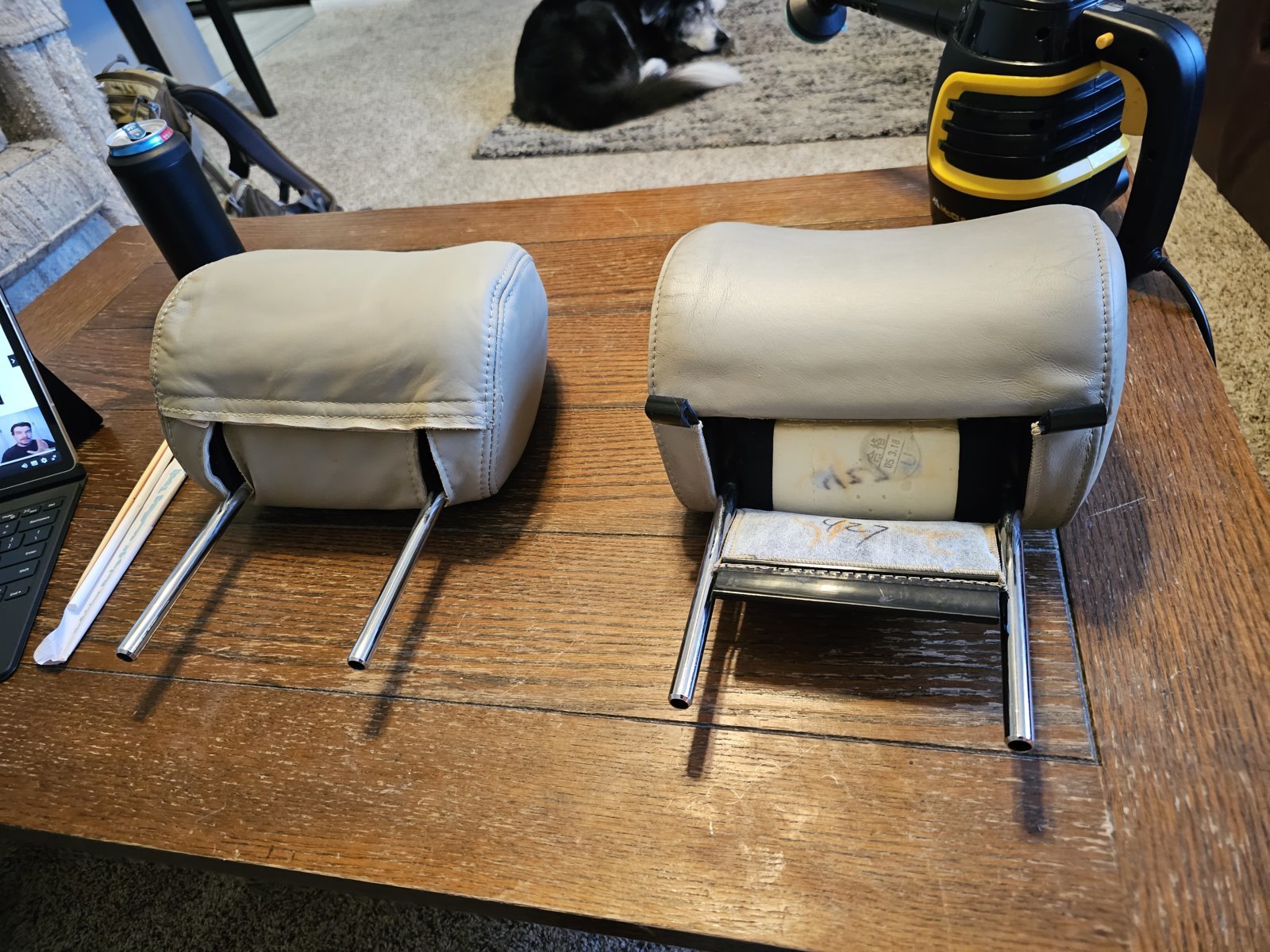

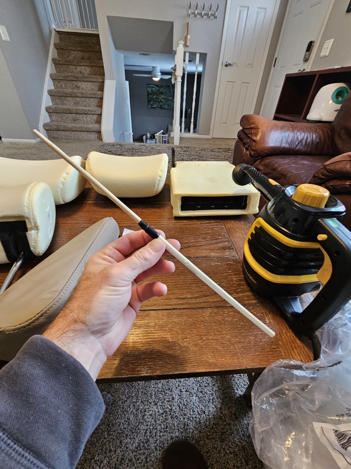

    Going to try and get some of the covers on this weekend. Trying out the steamer trick to plump the foam back up. It's definitely making it softer, for now. You can barely see a difference in the before/after pictures. The steamed one is on the right in second picture.

    It went really well. It's a little lower pay than I was making, but has a lot more career opportunities to advance than where I was.
    The armrest foam plumpt up a lot more than the headrest. I could actually see it happening while steaming. I guess it's a lot more effective on foam that's been matted down over the years.

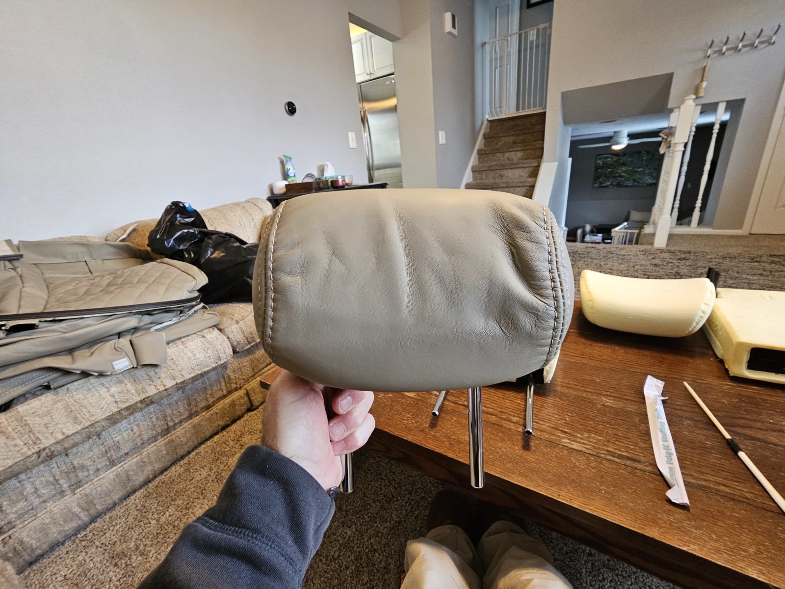

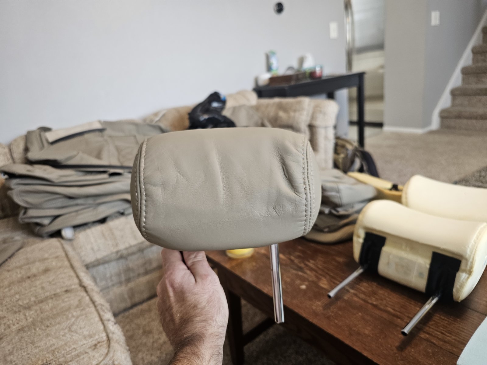

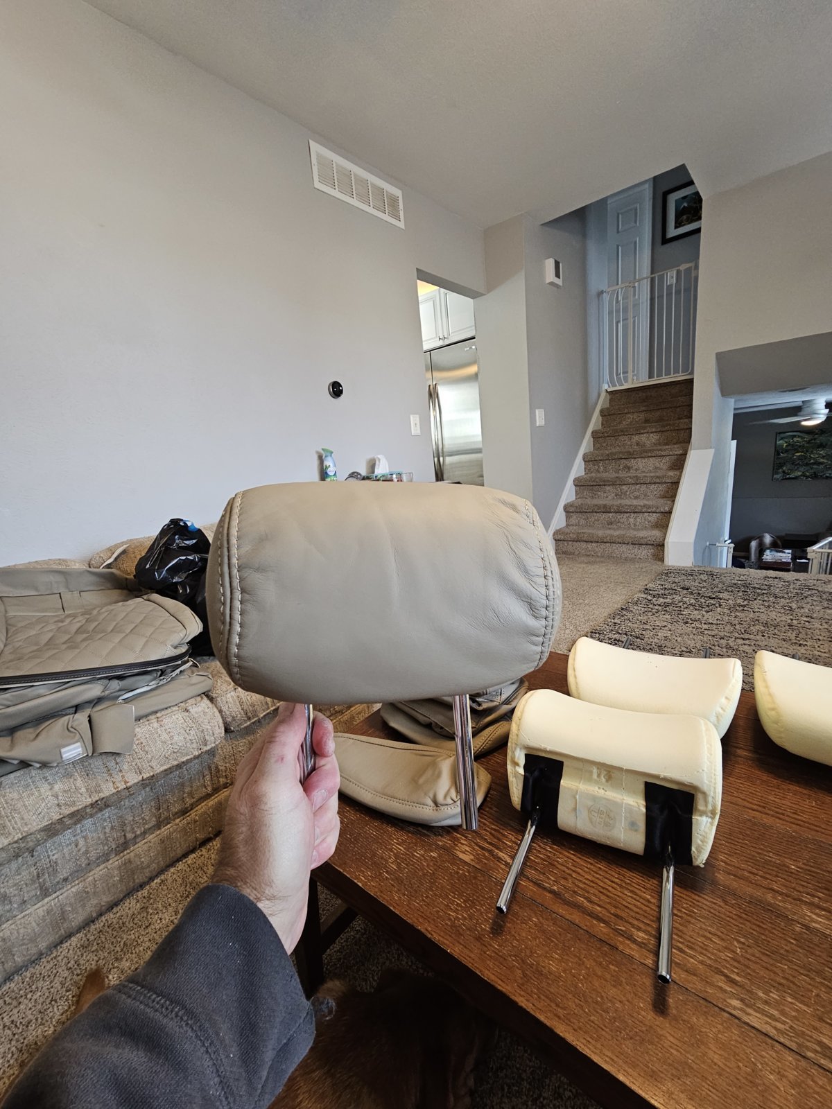

    One headrest done, and my first ever reupholstered item! I'll see if I can't tighten up the leather or steam the wrinkle out somehow, later.

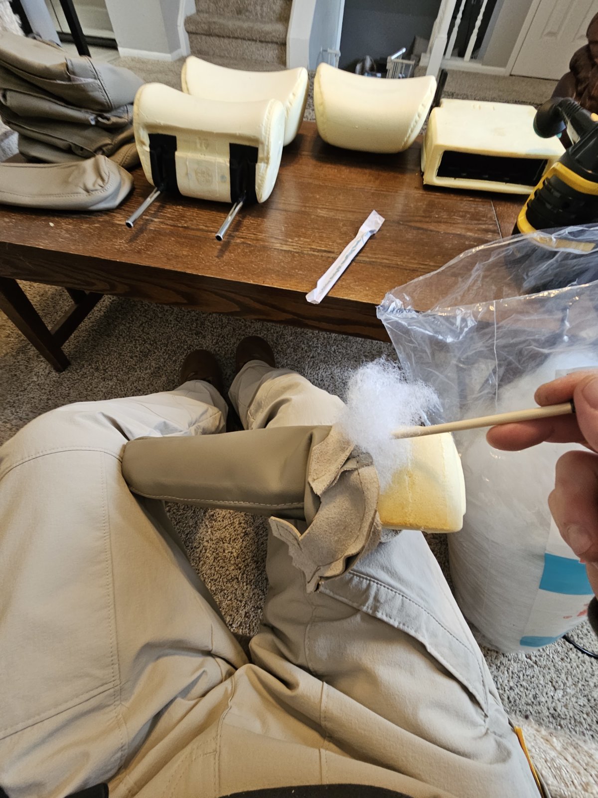

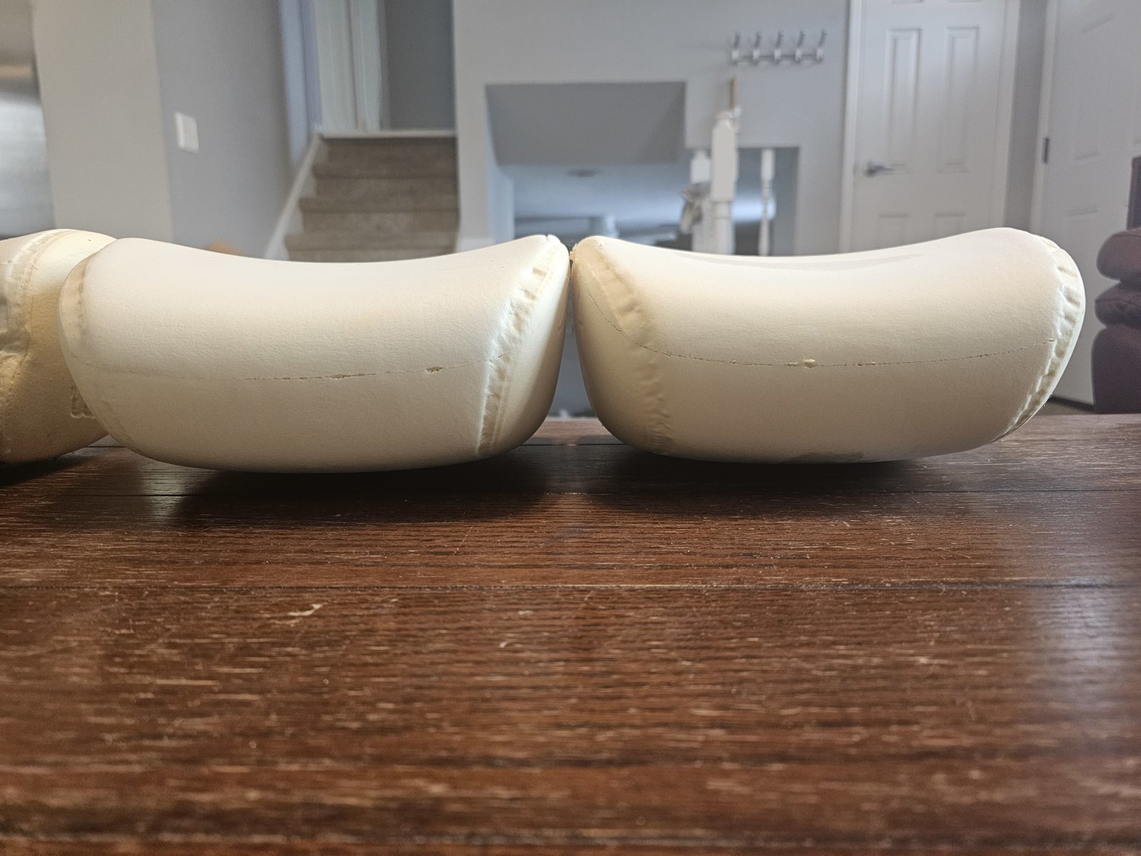

    Ok, so on my JK project a while back, I bought a bag of Polyfil to throw in the speaker enclosures. I didn't realize how big a 32oz bag was lol. And forgot I had it stored in the garage.
    So I'm using it to push up the arm rests! They're pillow topped now! Feels so good. Kinda taking the seats to the next level. I'll see if I can't do the same for the headrests and seats, where applicable

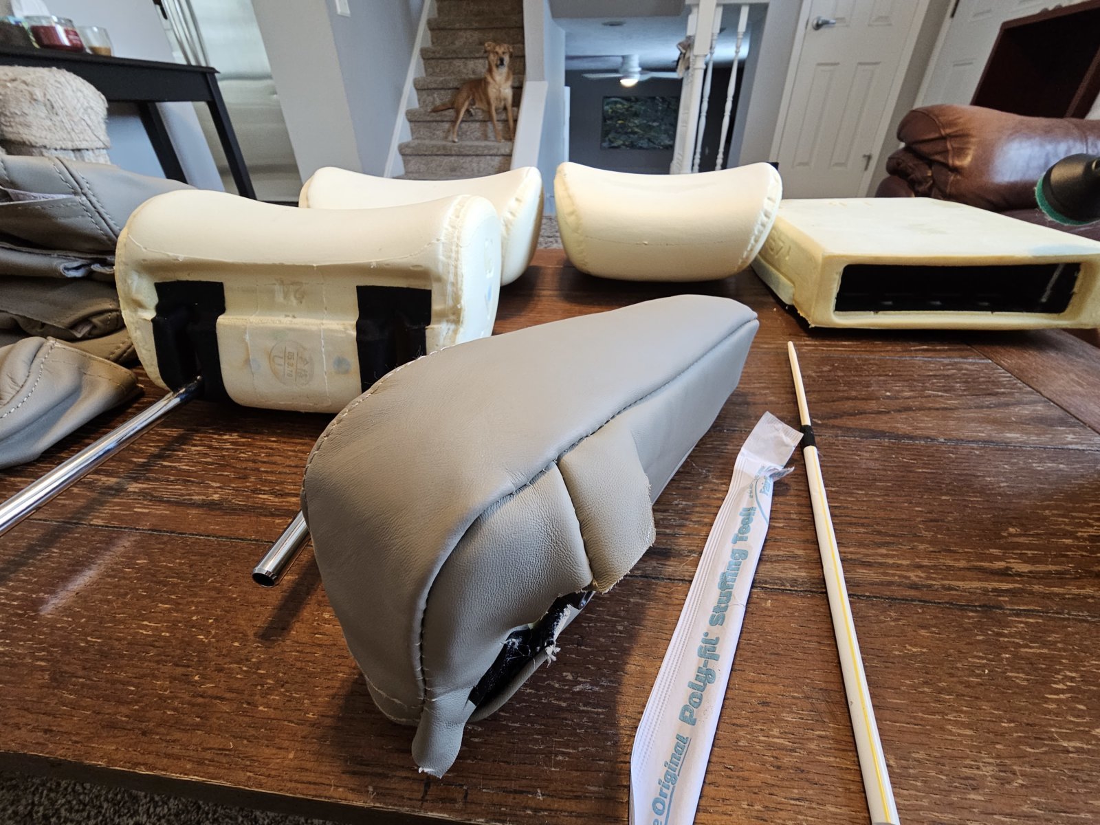

    I taped a straw to the provided stuffing tool to reach the end of the armrest. The straw side actually worked a lot better at pushing the stuffing too

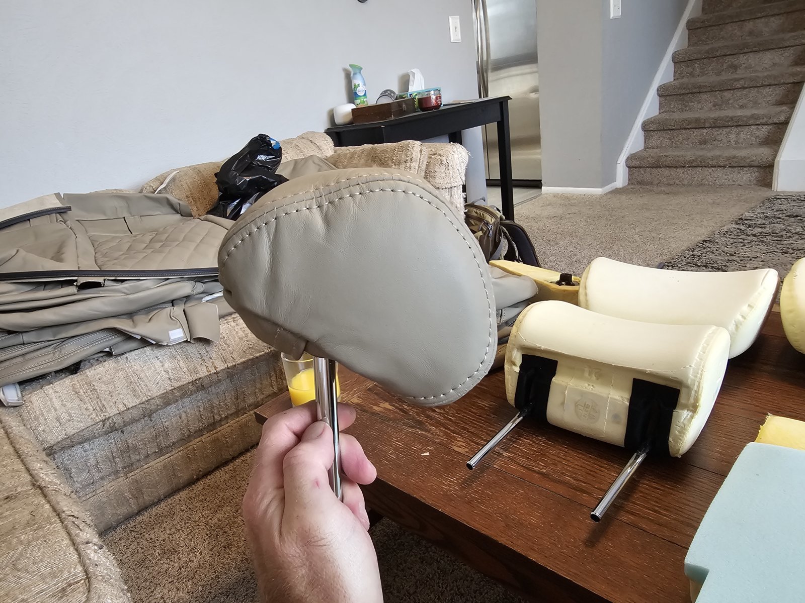

    Headrest plushed

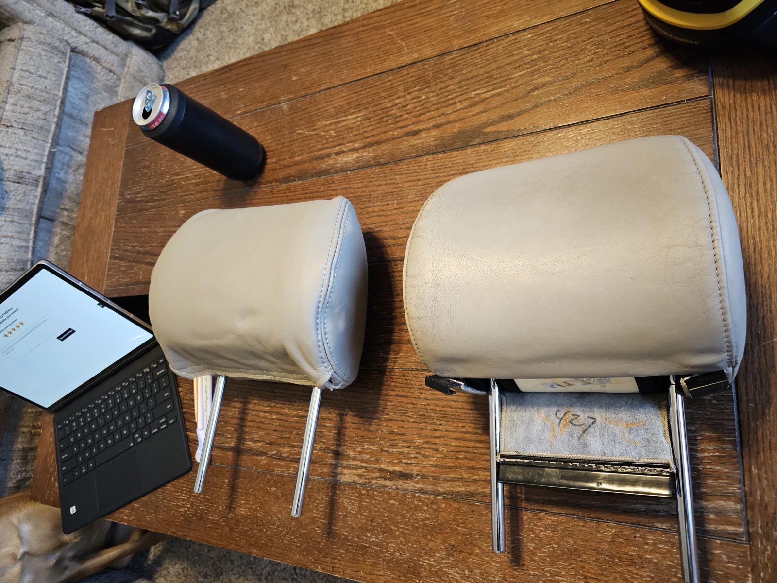

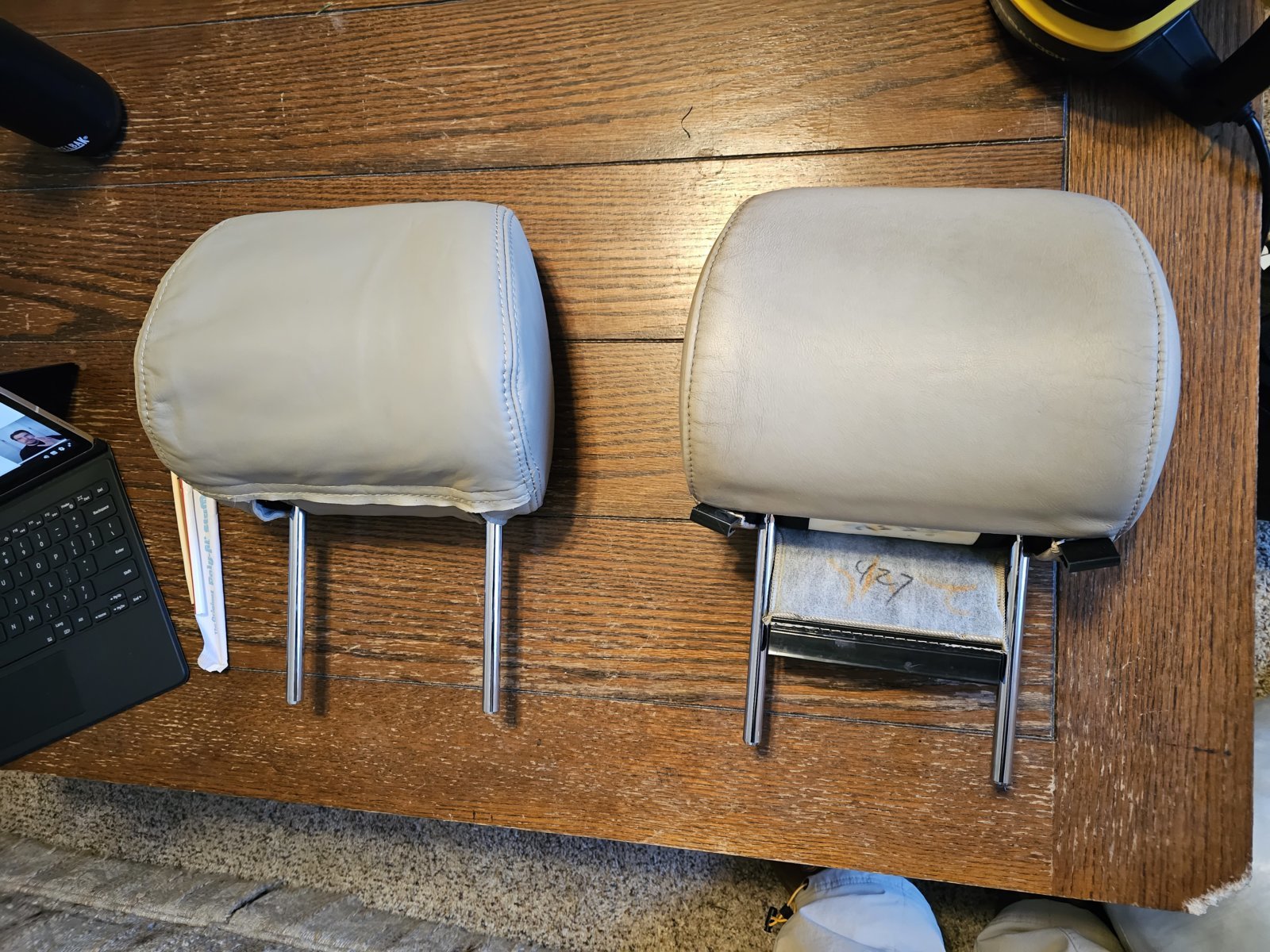

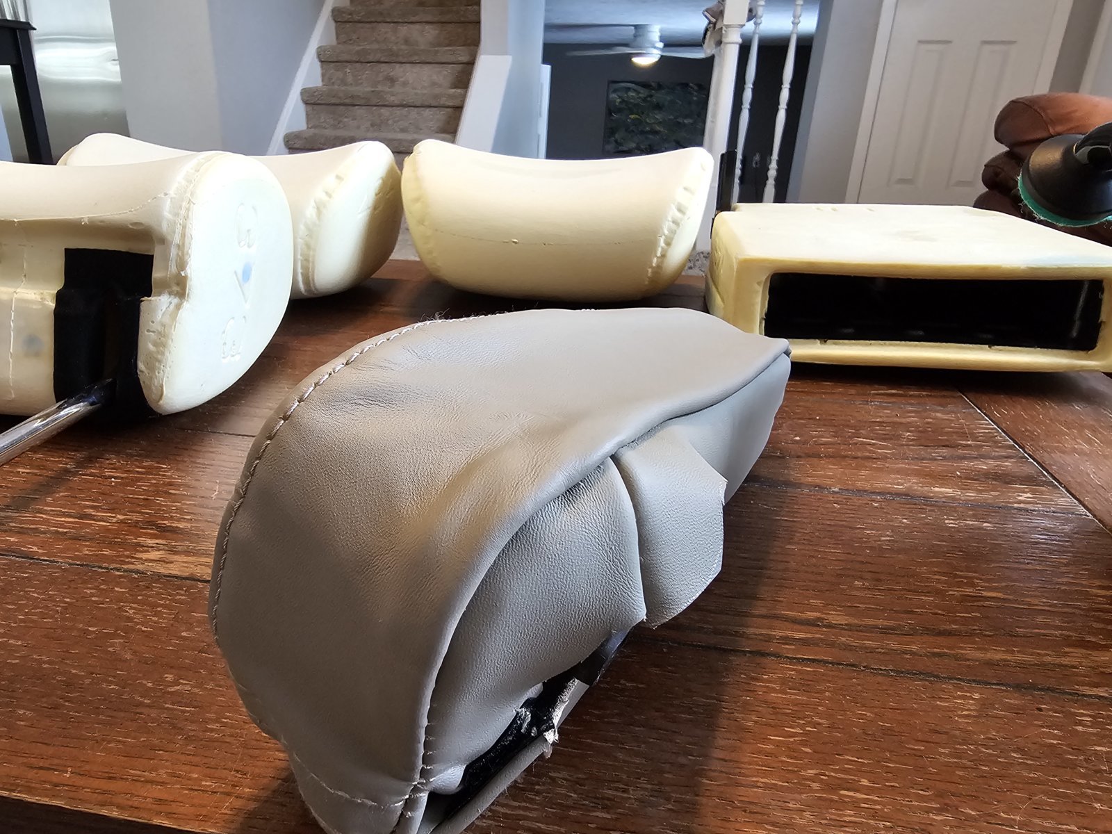

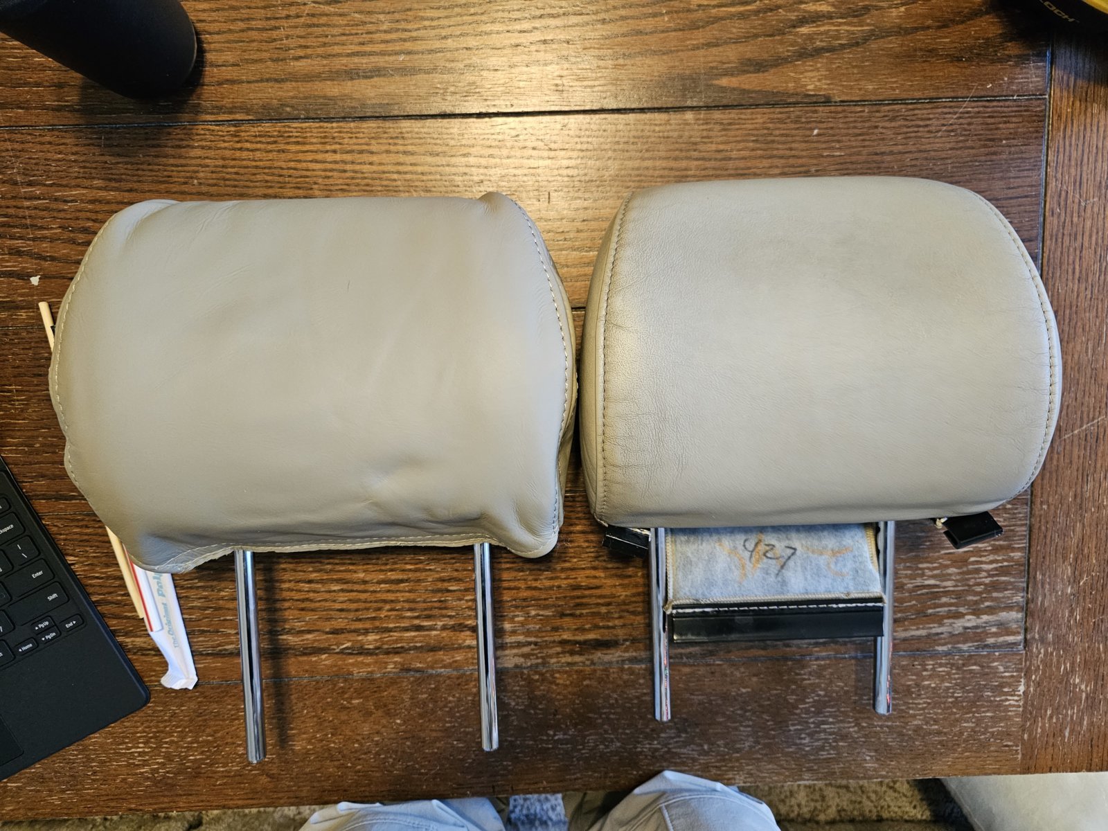

    New (passenger) vs Old (driver) front headrest. The new ones feel a lot better, but some covers are better fitting than others. Creases should come out over time. I'll go back and add more polyfil as needed. Everything was packed and folded tight into a square box. Honestly not the best packing but did arrive undamaged.
    Also the new covers use velcro where OEM covers use a plastic latching system.

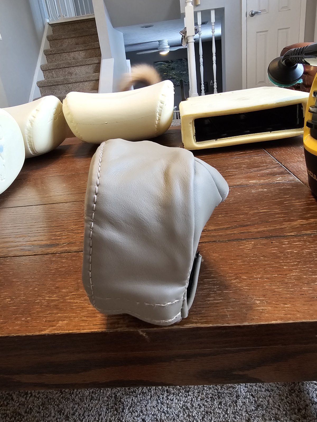

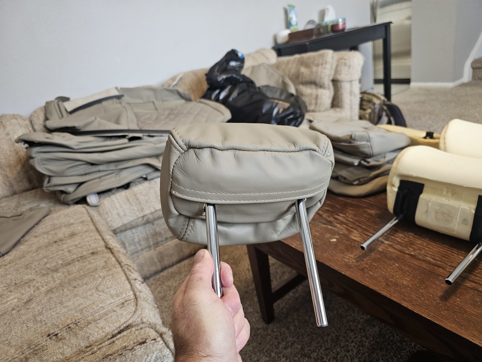

    Actually I just realized I had the wrong headrest covers on lol. Have to swap rear for front headrest covers. They're very slightly different shapes

    Take two. Much better

    ^^^ mucho better!!! HA!:)

    Yup, that one was on backwards also lol. Removed and reinstalled it. Magically didn't need the polyfil anymore...I've triple checked the armrest and it is on correctly. I need still need to do the drivers side armrest that's still attached to the seat.

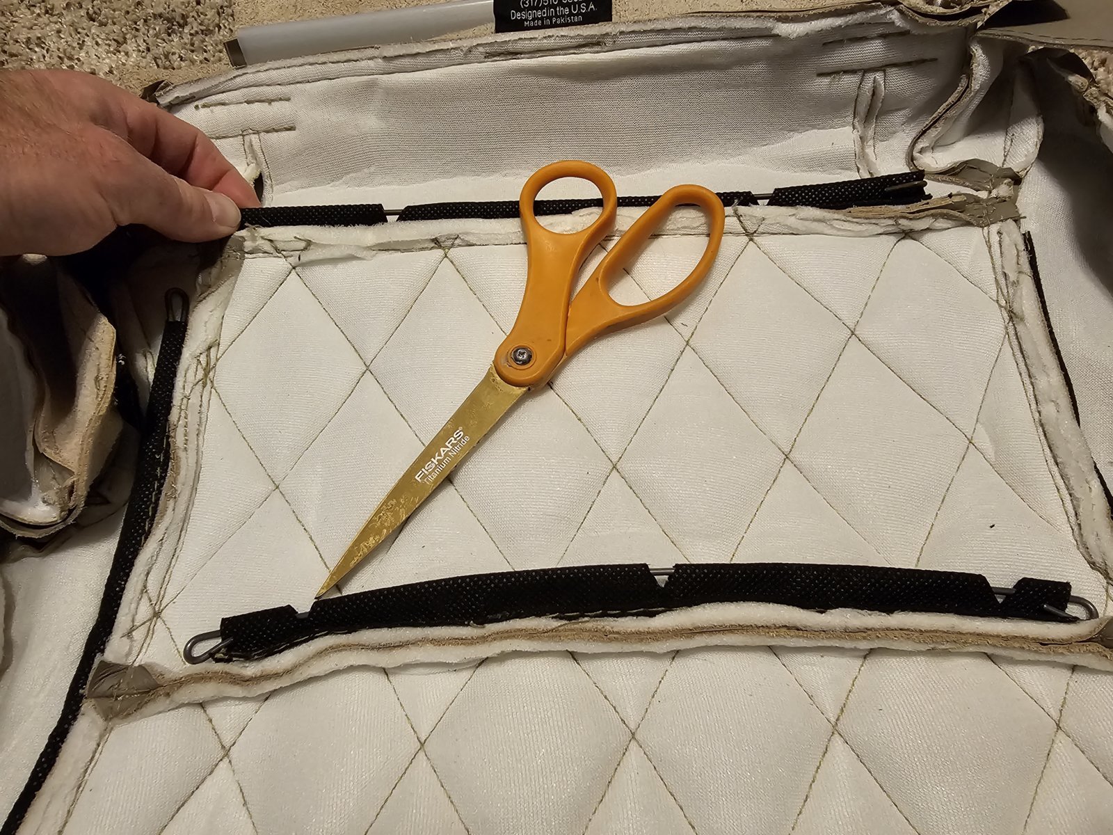

    Waiting for the hog rings and plier set to arrive from Amazon. I have tomorrow off, so I'm going to try and get all the seats done and reinstalled. Will free up some more space in the garage too.

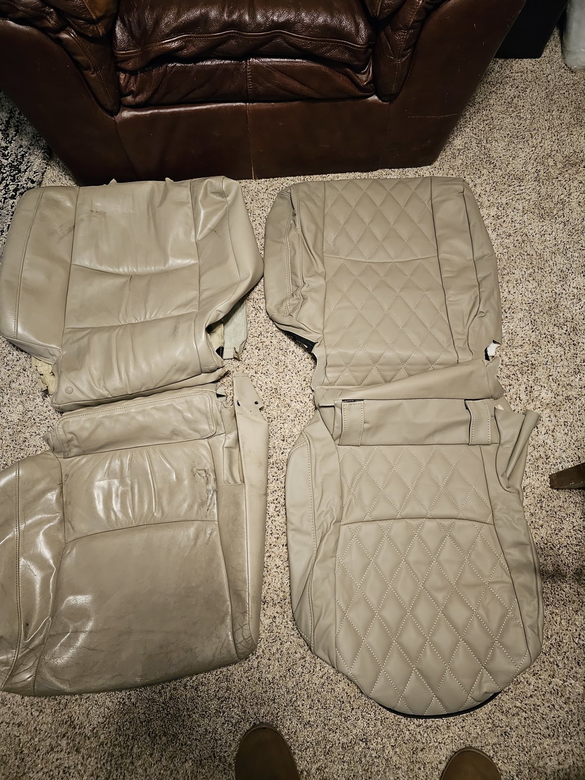

  23. Dec 10, 2023 at 2:24 PM
    #293
    M3Tundra-JK
    M3Tundra-JK [OP] New Member
    May 3, 2022
    #77930
    2,761
    Scott
    2005 GX470
    Old vs New rear double seat leather covers
    A bonus with the new panels, maybe, is that it has one less horizontal row to put hog rigs on.
    Black@Blue19 likes this.

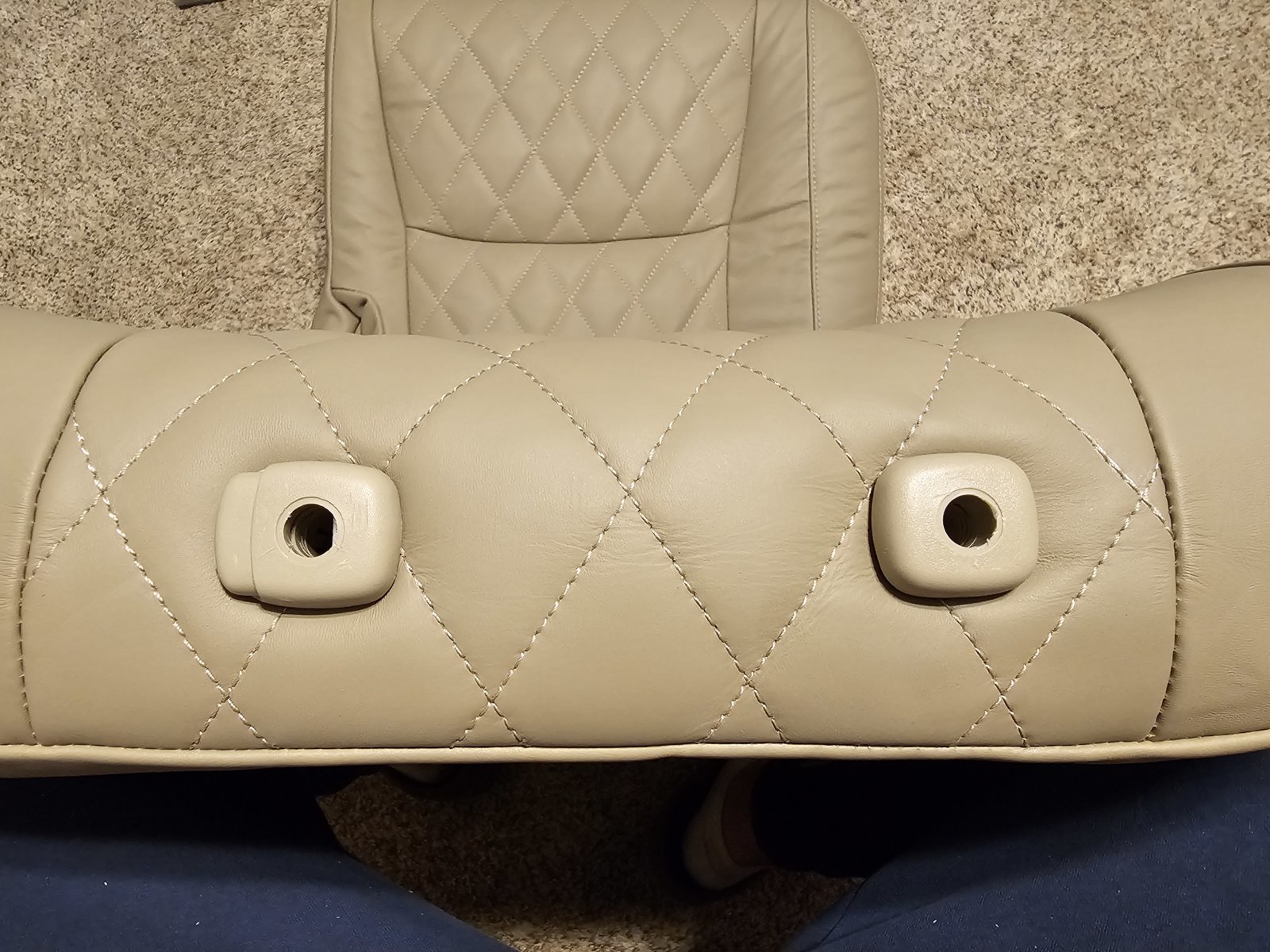

    Just have to make a few relief cuts for the headrest and the first seat is done

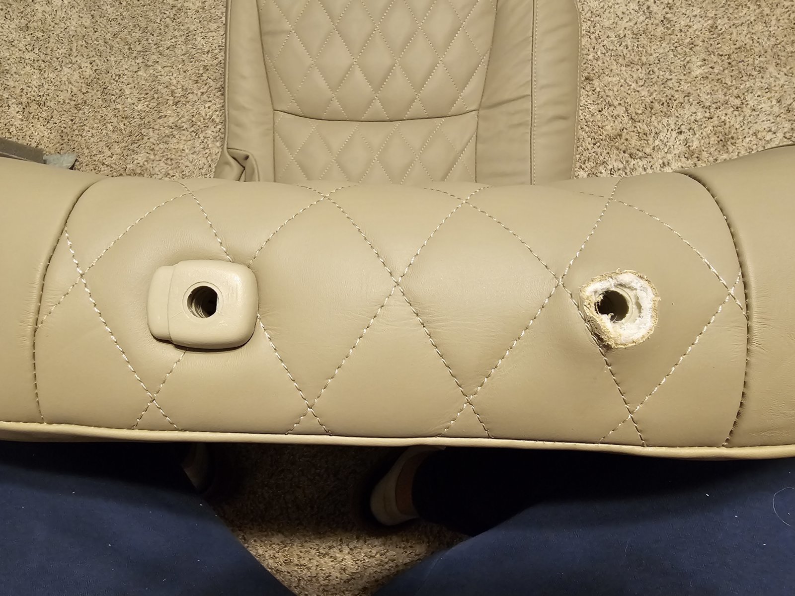

    The only issue I had was one of the two side zippers. It popped off. So I gotta figure out how to get it back on.

    Thank you for learning from our mistakes and getting the hog ring pliers. Always use the right tool for the job if you can.

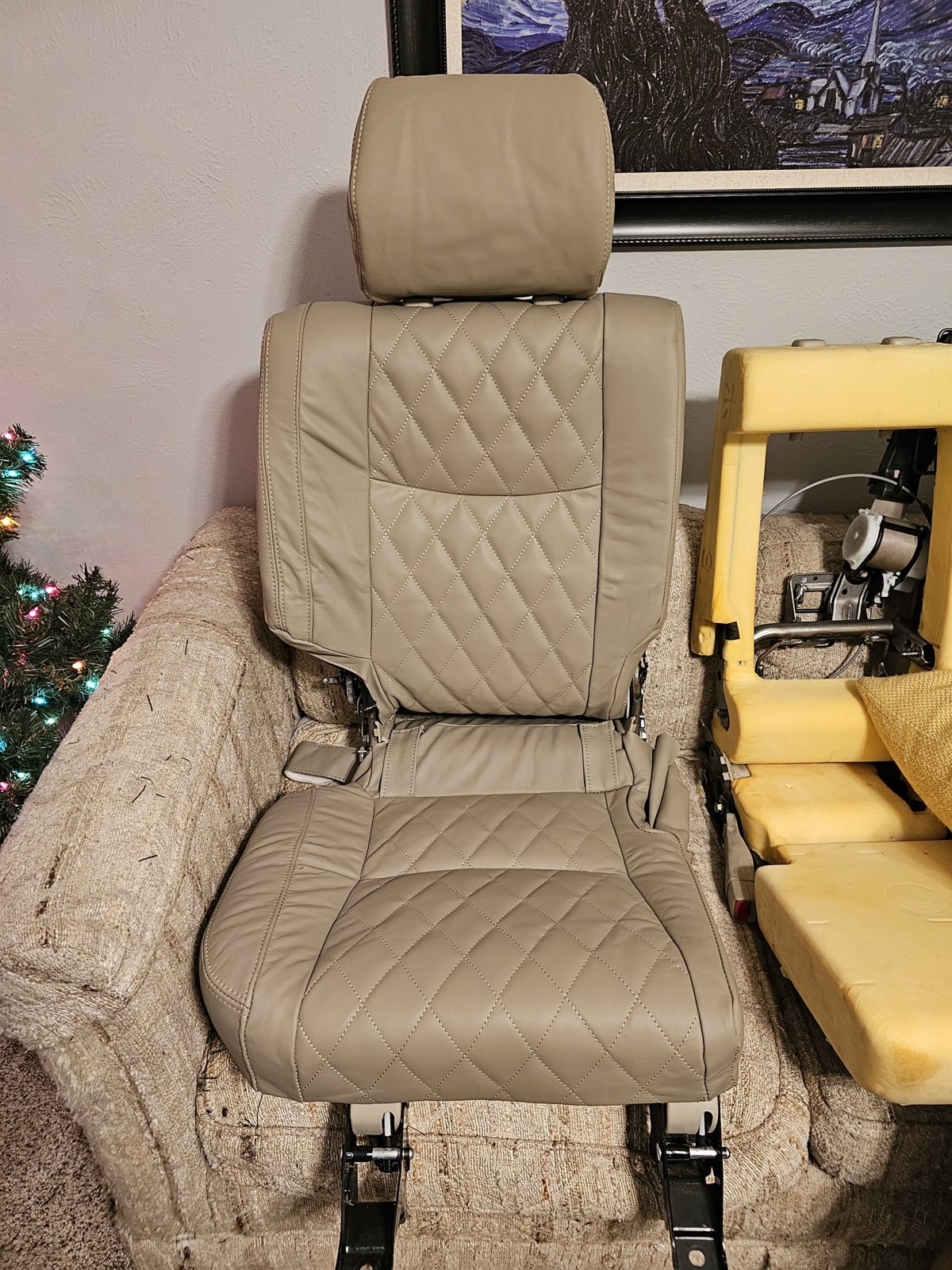

    One seat back in. Messed with the cheap zipper but couldn't get it back on. Will have to go back later and deal with that. Probably have a better one sewn on by a pro
    Mdl, e30cabrio, ZappBrannigan and 4 others like this.
  30. Dec 11, 2023 at 5:55 PM
    #300
    M3Tundra-JK
    May 3, 2022
    #77930
    2,761
    Scott
    2005 GX470

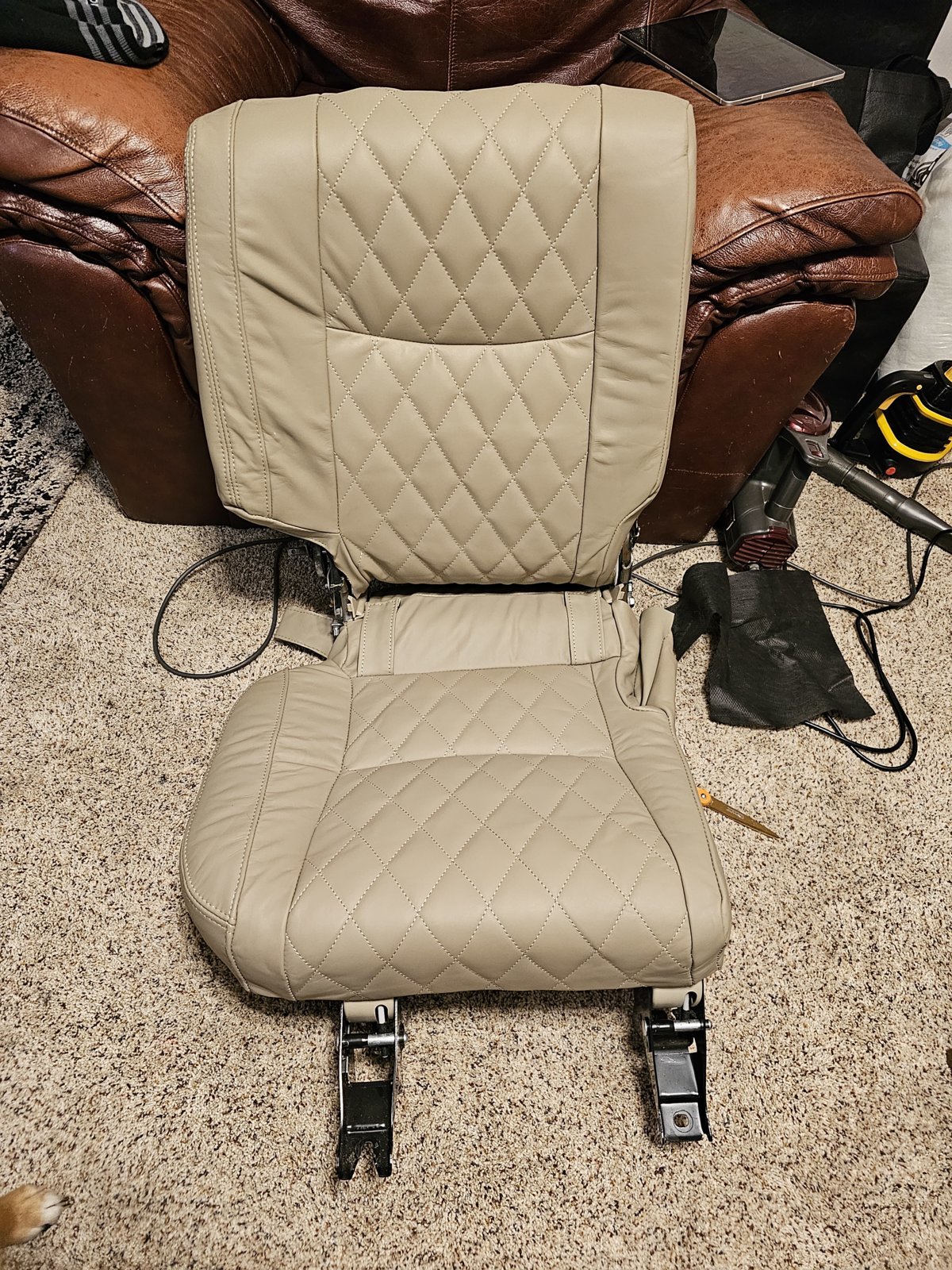

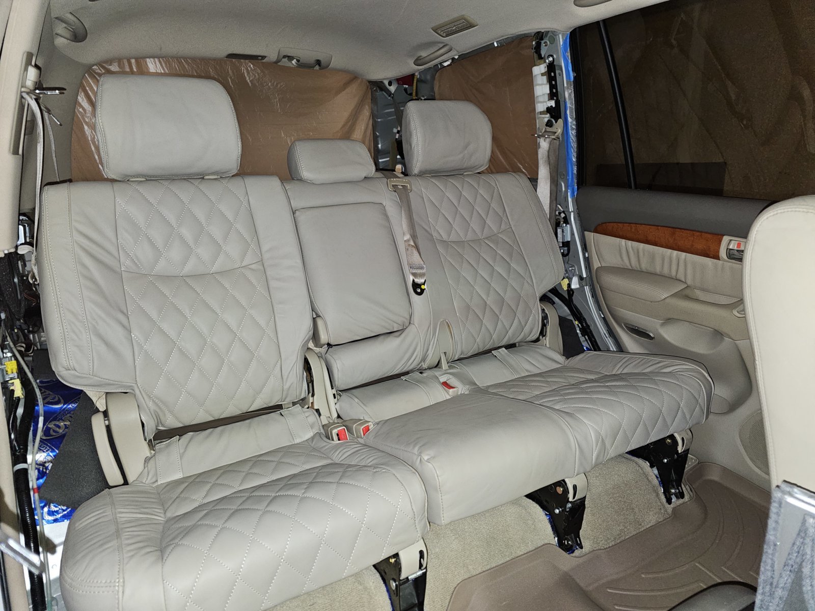

    The rear double seat sucked! A lot more screws and bolts and parts to remove in order to get the leather off and back on. And of course I had to undo and redo it a few times. The seat belt in the middle won't extend much and probably needs to.be replaced, but that will happen later down the line
    Fobroader, Mdl, Black@Blue19 and 7 others like this.
