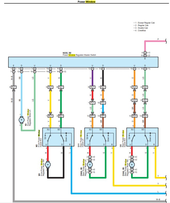

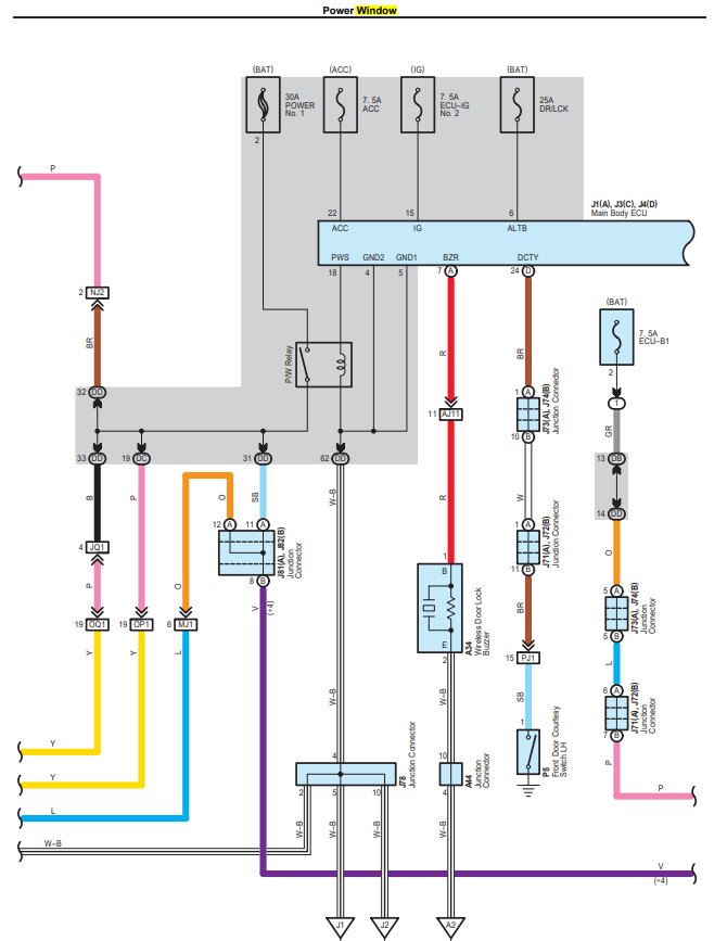

    Thought I'd give an update with good news!
    The wiring diagrams were very useful along with the other input as well.
    I gained access to the wires passing thru the four doors, as in removed the 4 panels(& necessary trim) for access then, disconnected wire harnesses, carefully removed the 4 flexible rubber conduits used to shield and route the wires from the doors to the interior of the truck. I did find I had damaged the cover of two different wires, but as I predicted fixing those didn't fix the problem, as they were in separate doors and neither was grounding in the conduit. What did fix my issue, which again was blowing the 30amp fuse in left side kick panel, was the actual window switch in the right rear door. It was causing a short any time from the master switch or the rear. Minus the time it was a cheap fix got one off Amazon for $12 delivered and everythings working mint!
