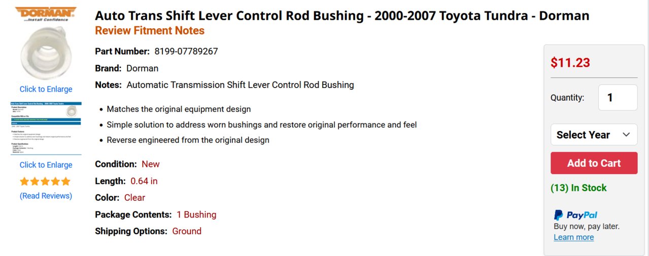

    You guys are genius. It was a wheel bearing and it was a painful job if u don’t have a press which I don’t. I have another problem to pick at now. My shifter is loose and I remember tightening it as tight as I can and the shifter doesn’t seem to “lock in gear” unless I push the shifter forward and then it locks. The shifter seemed better after I tightened it but it may be cracked or broken around the steering wheel where the shifter connects to if that makes sense…..Any ideas guys???

    Try this before you go too far down the rat hole...
    bmf4069 and DJenerated like this.
