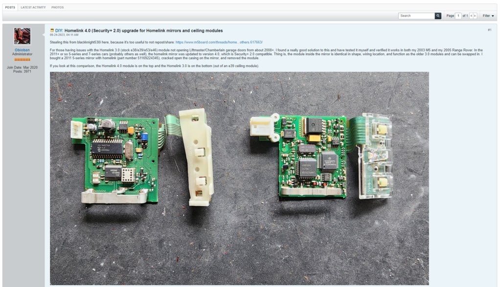

    It's worth adding a specific point here: Most auto-dim mirrors also accept an input for reverse detection, similar to a backup camera. If it doesn't make sense why, think about that. Say you're backing up at night, and there's a light on behind the truck. Do you really want autodim to engage while you're attempting to backup?
    That also speaks to the importance of propertly wiring up a mirror like this. For an auto-dimming mirror, you don't want to supply constant power and ground, or accessory power and ground, or all three. You really should be tapping into a reverse trigger wire also.
    Also worth noting, the Gentex 187 caps out at Homelink V4 (as do most mirrors post-2011/2012) which supports Security+ 2.0 so it will work with almost all modern openers, whereas V3 won't work with most garage doors manufactured in the last 15-20 years using Security+ 2.0. I think most companies fully switched to V4 starting in 2015 so think about that when looking for a donor vehicle. Opting for 2017 and newer donor should get you to Homelink V5. If in doubt, the part number embossed on the donor mirror should tell you the Homelink version (look for the letters "HL" at the end of the model number, whatever number that follows is the Homelink version, typically, i.e. part ending HL3 would be Homelink V3, and ending HL5 would be Homelink V5). Homelink V5 has other visual cues, like the presence of a pair of triangle LEDs which tell you the up/down position of the door, a two way comm unique to V5.
    Hopefully I didn't already put that info in another part of this thread, I know I already typed it elsewhere on the forum but too lazy to look and type faster than I search.
    Last tidbit, I bookmarked this recently to stick somewhere, but I found this interesting post on a BMW forum a while ago, and stumbled across it while backing up stuff off my old work laptop so I could wipe and offload it. Original link here, showing how you can update older V3 integrated openers to HL4, which could be interesting. I always wanted some visor-mount or overhead mount solution, and this got me to thinking about ways to do that, or even retrofit mirror guts from a mangled newer mirror onto an older one: https://nam3forum.com/forums/forum/...rade-for-homelink-mirrors-and-ceiling-modules
