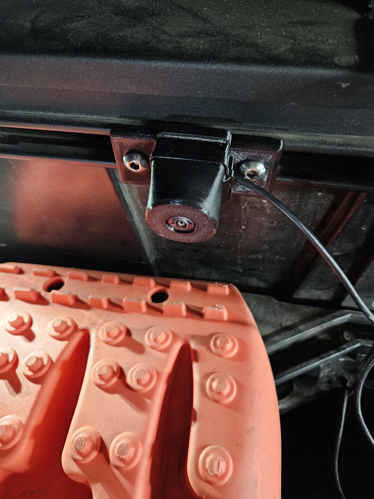

    Thought i would update this thread I made, I officailly have the external mounts for sale on the website. I am in desparate need of pics for this installed on a bed rack for the website.
    @Kap1 youve been following patiently since the beginning, do you want a free kit finally? Dm me your address.
    For anyone else who see this and wants to test it, heres a 20% off code: "EXTMNT"

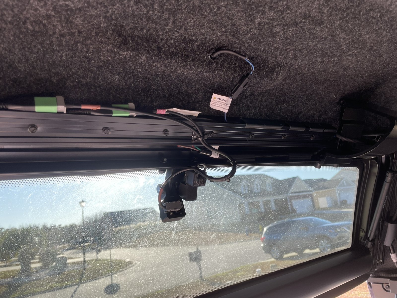

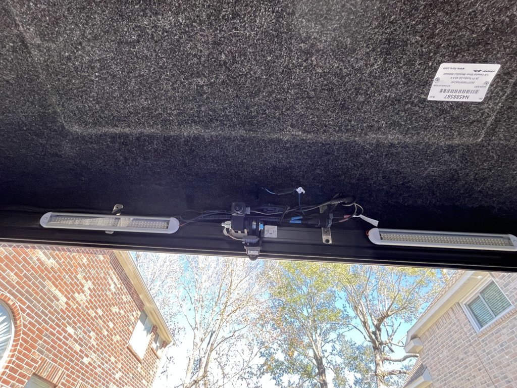

    Bed topper, Bed and Digital Rear View Mirror cameras relocated. 3rd Brake light and bed illumination.
    I added an ARE V series topper to my 2025 Tundra 1794 edition. I used the www.ggoffroad.com Digital Rearview Camera Relocation Kit to move the cameras to the topper. I modified the included bracket with some spacers and a longer bolt to get the DRV camera at the correct angle. The 3rd Gen Tundra Brake Light Wiring Tap Cable was used to extend the brake light and add additional bed illumination to the topper. The kits worked very well. Great job ggoffroad.
