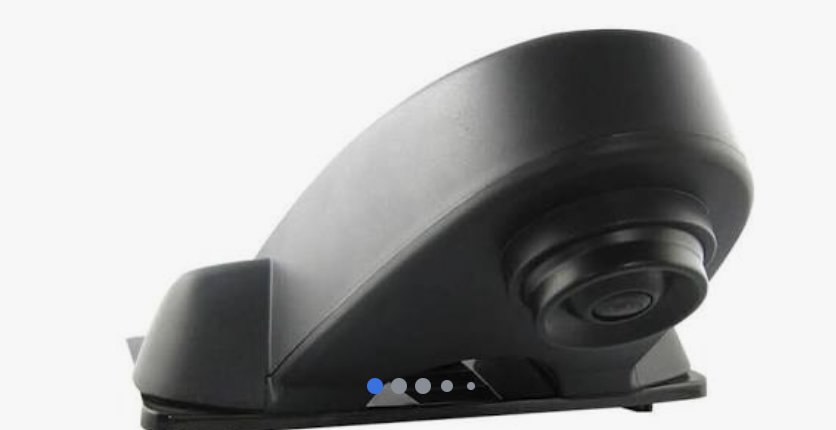

    OK, if you are still entertaining requests for mounting options I've got one for ya...
    While I liked the clean look of your mounted inside with a small hole drilled through, the Super Pacific X1 has the 3rd brake light where it would best work. That combined with the fact that I often have bikes on a vertical rack got me thinking I should go higher!
    Sprinters often have roof mounted cameras like this one:
    Since the X1 and most RTT's have a t-slot on the top trailing edge it would be easy to mount something like this however the angle would probably need to be adjustable to accommodate varying heights.
    I'd still need to work out cable routing but I also have solar up there that I'll probably need to install some loom to accommodate.
    Let me know if you're able to put something together otherwise I'll track down someone local to print something up when I tear out the cameras in a few days...

    www.ggoffroad.com
    Good timing! I actually just designed a waterproof enclosure for the cameras just for this application! It will be on the website in about a week after I do some more iterations and testing. I'll give an update when its live

  27. Sep 7, 2023 at 9:22 AM
    #87
    GG.Offroad
    GG.Offroad [OP] New Member
    Nov 7, 2022
    #86297
    134
    Austin
    Westminster, CO
    2023 Tundra Limited Hybrid Lunar Rock
    www.ggoffroad.com
    My bad! Right now it looks something like this: upload_2023-9-7_10-22-39.png
    I am very open to suggestion in this stage of the design though! any ideas to make it better/ more practical for your situation, I'm all ears! Also what is the fastener spacing on most of these bed racks? Its it 1" on center like 80/20 rail?
    Kap1[QUOTED] likes this.
