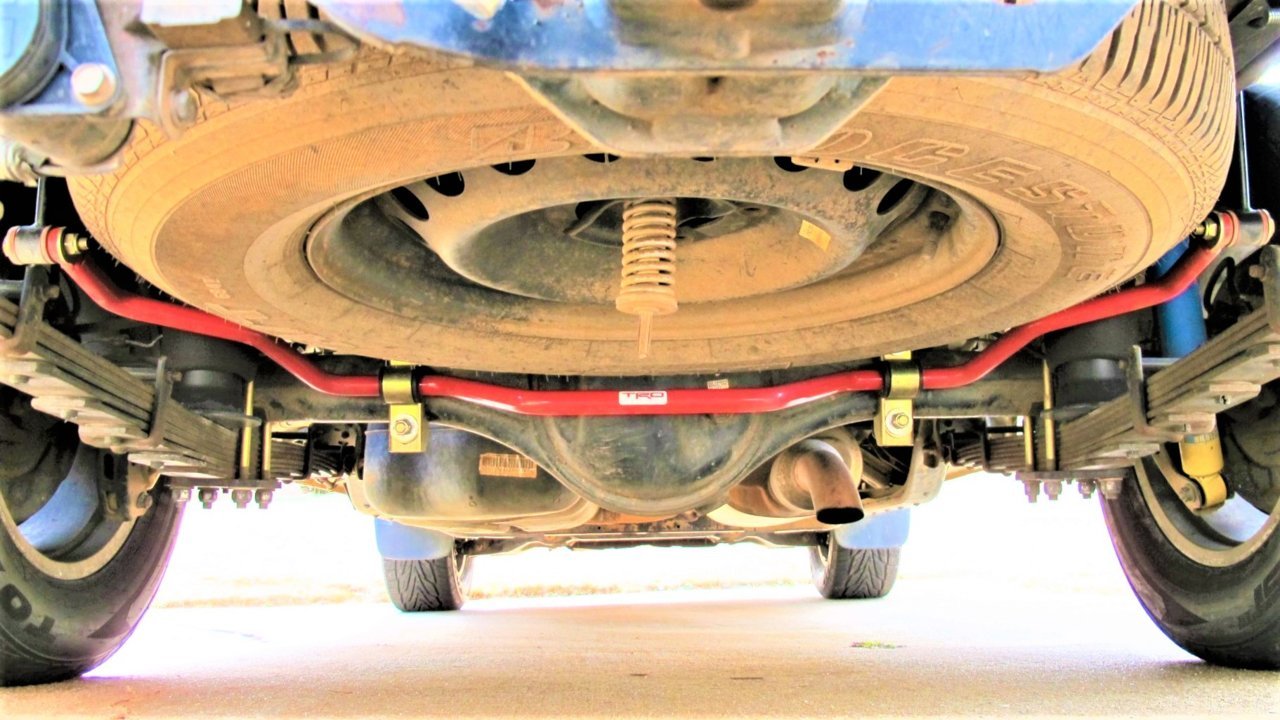

    When possible, I add a rear sway bar to any vehicle that doesn't have one. A rear bar will firm up the rear suspension, and enable you to navigate corners quicker without leaning so much. My 2002 Tundra has a Hellwig, and my '07 has a TRD bar... I did several things to firm up the rear end of my '07, lowered 3.25", bagged and a rear sway bar.
