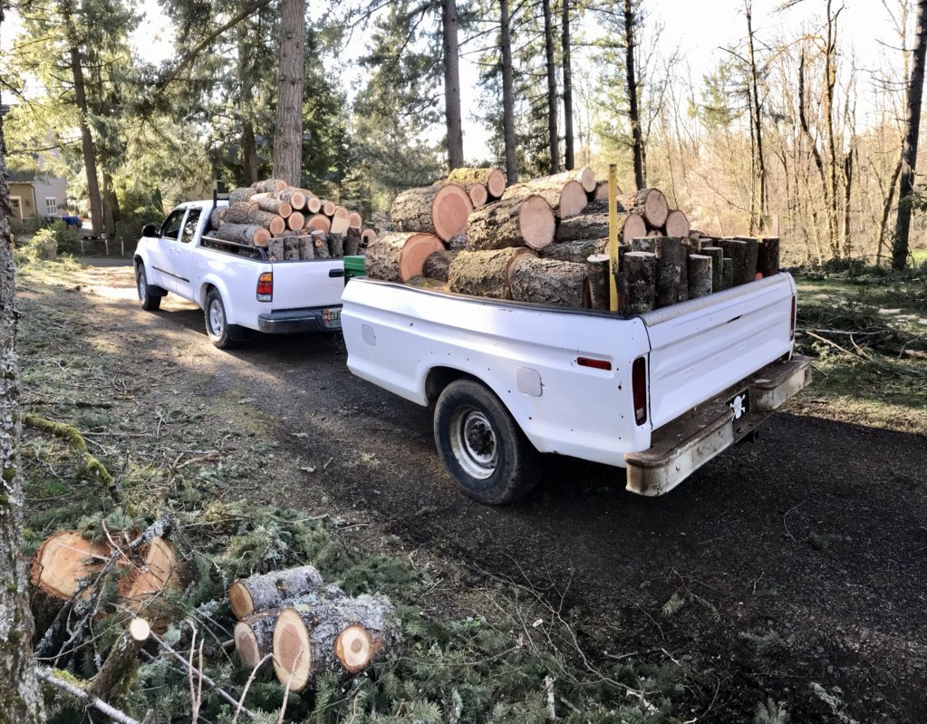

    3000 to 5000 lbs a cord (depending upon the species and how wet it is) might be pushing it a smidge bit for a 1/2 ton truck.
    You’ll definitely want a firestone airbag kit. The bags themselves will handle the weight, but the design and location of where the airbags brackets are mounted will cause them to bend and deform with that heavy weight. You’re probably going to be better off fabricating your own mounting brackets that locate the airbags directly above the axle tube.
    I recently modified my headache rack my welding in rear window protection. If you want tall steel sides, it might be easiest (and cheapest) to buy a tundra specific rack and modify it from there. Of course if you could find a tundra specific landscaping rack (with expanded steel on the from and sides), that would be best. Make sure to reinforce both the floor, bulkhead, and tailgate. If not they get crumpled in pretty darn easily.
    With all that weight, you already know that you’ll need to address the brakes, lower the ring and pinions, mount up E load tires, ect.
    Maybe this link will give you some ideas on building a headache rack?
    https://www.tundras.com/threads/tacoed-tundra-project.130491/page-10#post-3715216

    I have no build thread for airbags. I have had to reinforce the bag brackets on my old 71 Ford flatbed highboy since they started to collapse when i kept overloading the truck with too much weight though. I don’t have airbags on my tundra yet either. I already had the the bags in my shop, so i simply just ordered all the brackets separately…except that was 9 months ago. I dunno if Firestone will ever ship them. I keep calling them about every 3 months and they keep telling me that they’re slated to be manufactured very soon. Last week they told me i might see them in a couple weeks. We shall see. I doubt i’ll modify my brackets right off the bat. I don’t plan on hauling over 2000lbs (famous last words), so hopefully the brackets will survive. If not, then i’ll address that problem when it arises.
