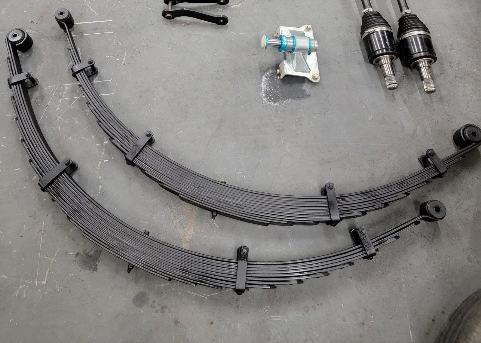

    I don’t think that’s accurate here’s my i96 LT leafs

    I haven't seen them side by side, but what makes a "long travel leaf spring" a long travel leaf spring?
    wouldn't it be just longer springs with more arch? I'm really just guessing here lol

    Dec 20, 2021
    #72040
    7,399
    Rey
    North Plains,Oregon
    2017 Tundra Platnium
    Too many mods to come
    Yea, different rates also. But definitely dont think the u748 has the same leaf load ratio etc. where deaver would just swap a few things.
