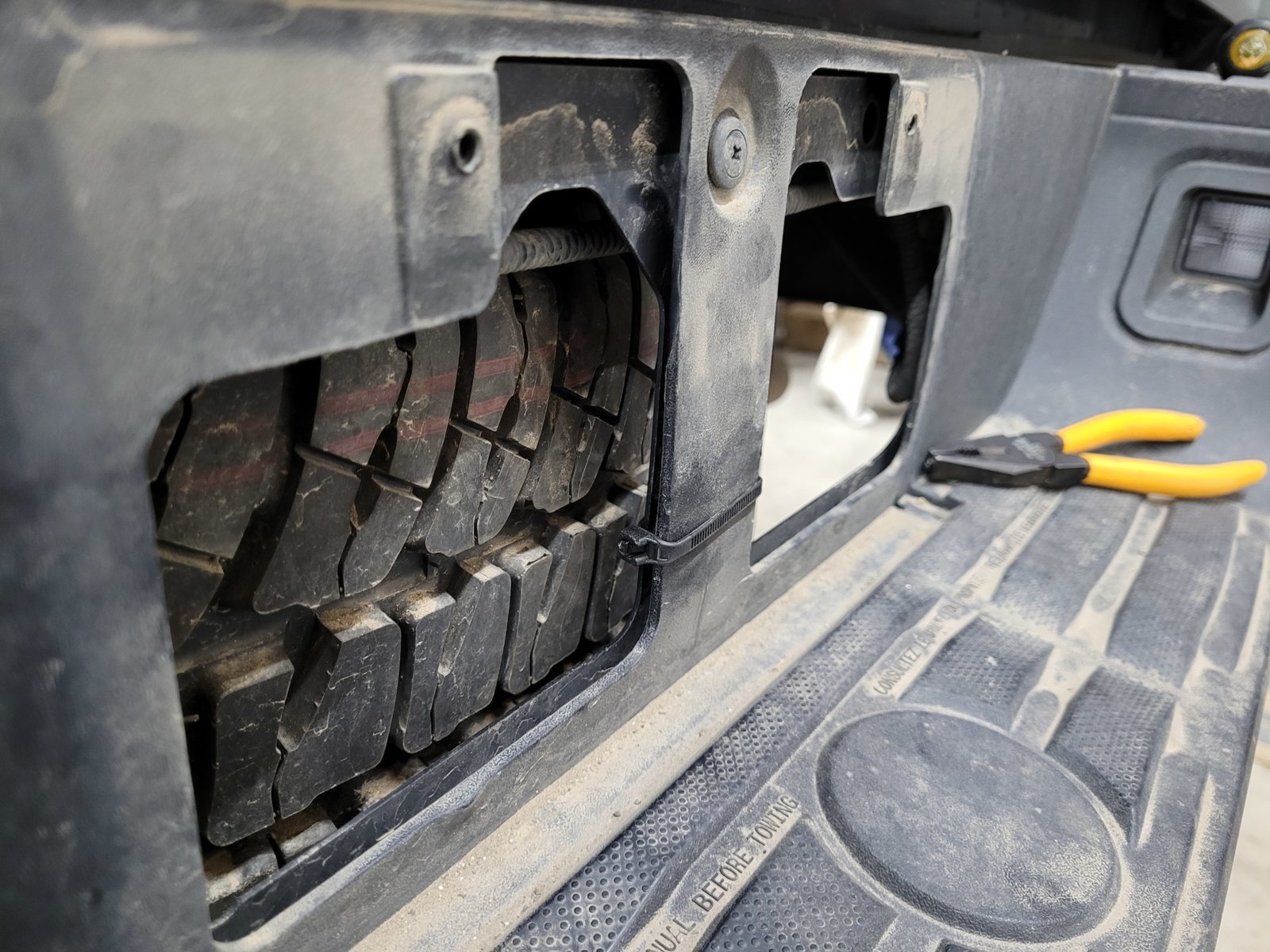

    20231218_205806.jpg I had the same problem. Center bar behind license is bowed out. Pulled it in flush using a tie wrap.

    Looks to me like the passenger side top screw there is a dent just above it and that is making it bend out. Take the plate off, turn it downside up and lightly straighten because they tend to bend really easy once compromised. Just an observation

    Run a length of weather stripping behind the upper side of the plate to push it out a bit to match the lower.
