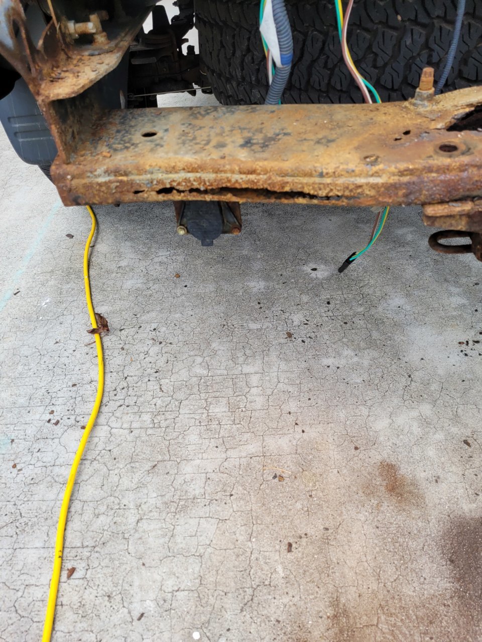

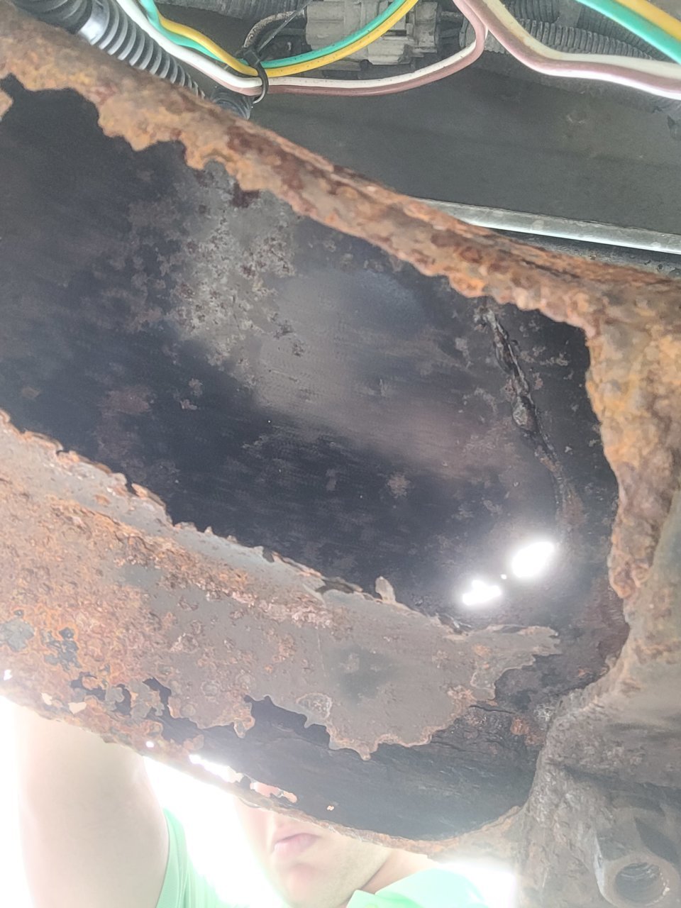

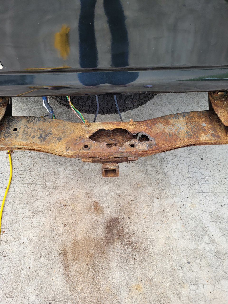

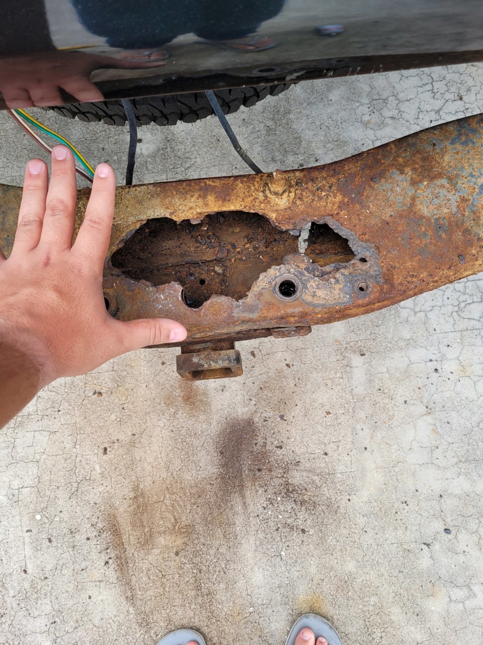

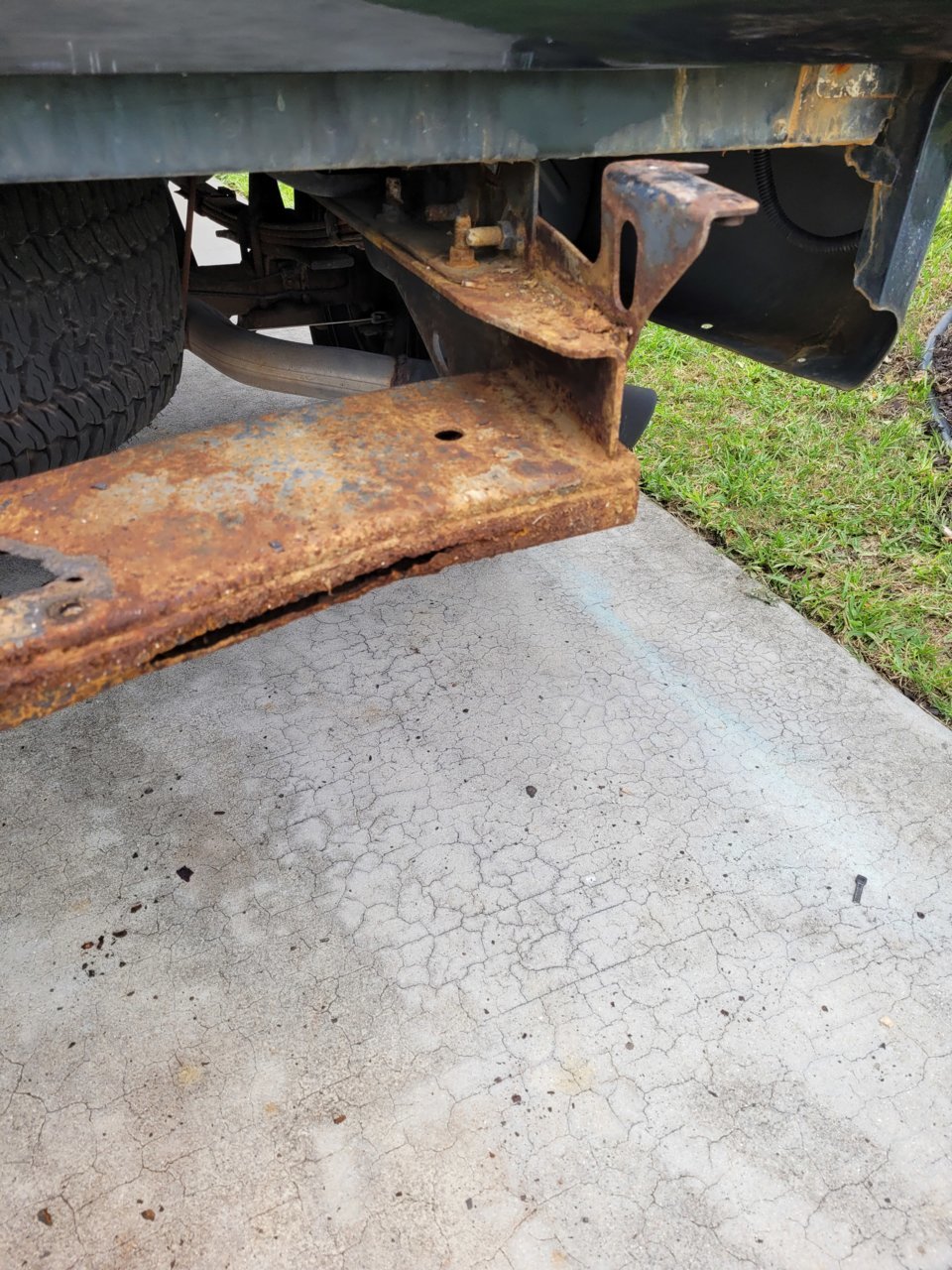

    Hey all, I was replacing my rear bumper cover (it was dinged up and i personally cant stand chrome) and when I got it off finally realized where the piles of rust in my driveway have been coming from. Amazingly (it tows fairly regularly) this florida truck with a perfect frame has a bumper/hitch receiver that looks like this! Anyone know a good after market replacement without spending 1100 $ from toyota that will still allow me to have a bumper cap. I have a friend who can weld and knows a few people but he keeps his welder in a kinda pain in the ass to get to spot and i doubt we could weld something thatll fit my bumper cover too...... anyone else had this problem?

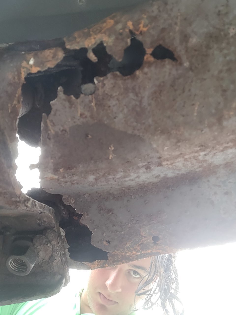

    Ignore my weirdo faces lmao i took these rigbt beforw heading to work in work clothes attempting not to get dirty lmfao

    $1,100? Don't you just buy a new Curt or DrawTite hitch for $250, bolt it in, and go back to having fun.
    As to why its rotted and the frame is not. My inner sherlock holmes says a Florida truck backing down some steep boat ramps submerged the hitch, it filled with salt water and rotted out from the inside. The frame did not suffer as much because the C-channel frame would get washed off in the next rainstorm. But salt water would sit/dry inside the hitch since its pretty much a box.
