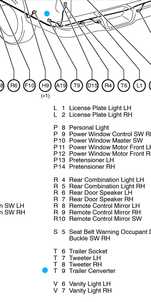

    Getting ready to put the bed on. Not sure what this plug is for. The wiring diagram says Trailer cenverter.... Not sure what plugs into it.Screenshot_20210625-123427.jpg PXL_20210625_161612321.jpg

    It's for an adapter to run your 4 flat or 7 pin trailer wire harness.

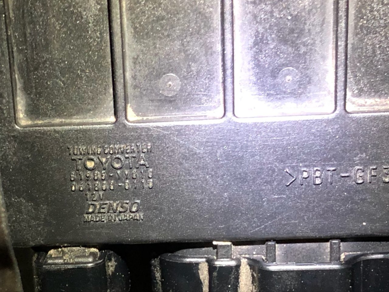

    Check my Build Page for other cool factoids. Here is what it probably should connect to which is the Towing Convertor located inside and behind the driver side tail light assy opening.

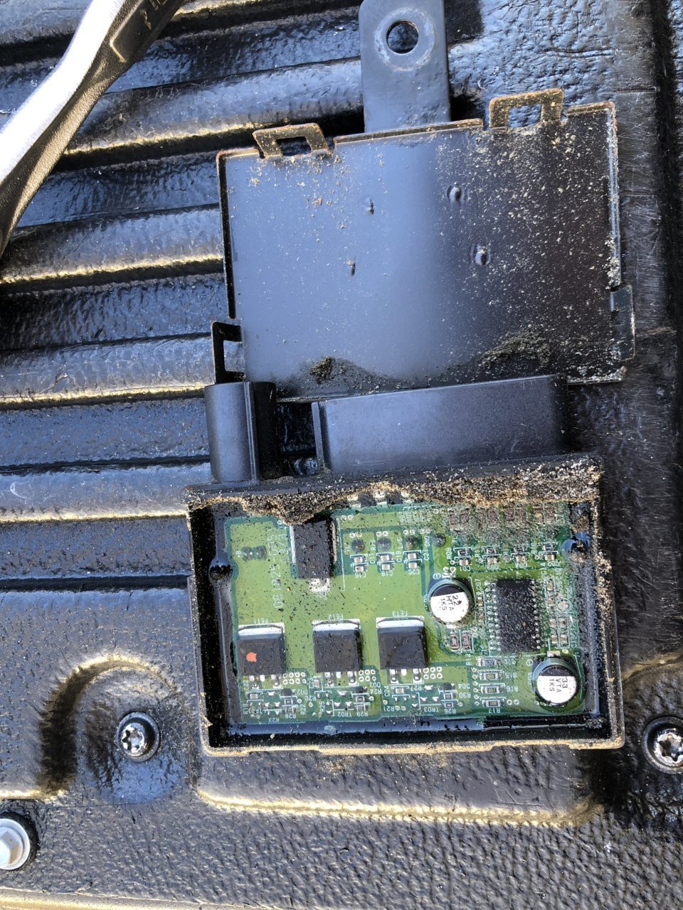

  8. Jun 25, 2021 at 1:57 PM
    mbreed2
    mbreed2 [OP] Is not right
    Jun 21, 2021
    #64594
    181
    Allentown PA
    2001 Tundra 4x4
    I think that may be it. There is a module like that sitting on the passenger floor. I'll check tomorrow morning. Thanks!
