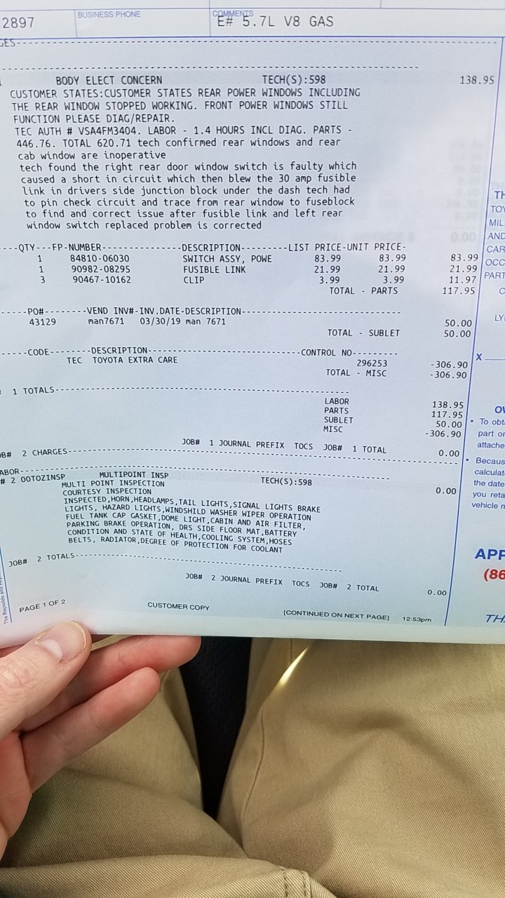

    I called and explained that I have to work sat,sun,mon 9am-930pm so I will not be able to pick it up for a while and will need to keep the rental. They didn't like that idea and said they would call me back. So i just got a call back and spoke with the service manager. they ordered new switches which should be there in the morning. Hopefully that fixes the problem. If it does I'll get it back tomorrow, unfortunately I work 9am to 930pm so idk how I'll get it back and the rental back to them. We shall see. They said maybe they can meet me at work to exchange cars. I wish they also bought the BCM in case the switches don't work, seems too logical though.

    Fixed under warranty. Kinda what I figured. The original switch that went back short circuited the front switch and blew a fuse I guess. Just happy to have it back and not having to have spent a fortune
