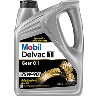

    [​IMG] thats what i used front and back.ALWAYS remove the FILL plug FIRST
