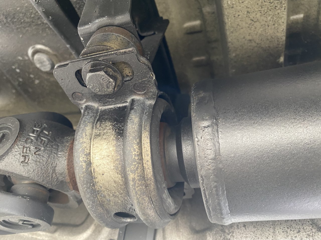

    Oh ok thanks for all the suggestions guys. I feel relieved now. You guys saved me tons of money and headache for now. I will do regear stuff in future tho. I also checked underneath truck I think I also have carrier bearing drop kit installed.

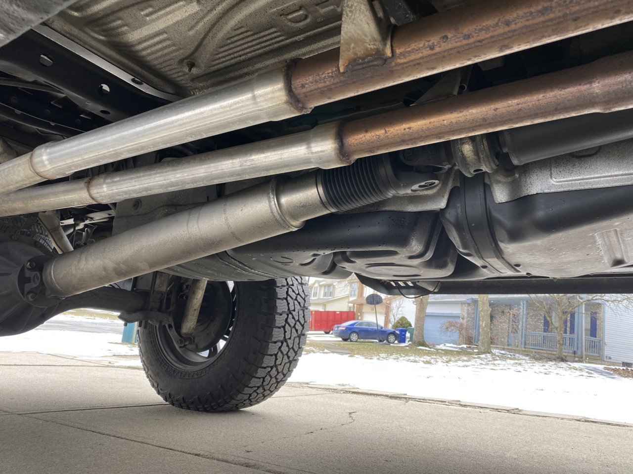

    Bilstein 6112/5160, 3 CB front shims, SPC UCA's, CB +3 rear Shackles, total 3/2 lift, Dif drop, CB Carrier bearing drop, Fortin Evo One remote start from Tech12volts PnP, AMP research Powersteps PnP, Vent shades, Tinted windows, Black/Red lined cupholder inserts, Proclip USA dash phone mount with Scosche Magic Mount wireless magnetic phone charger, Stock wheels/tires for now.
    That dealer is bad ju ju stay far far away from them.
    Your difs look fine from what you showed us.
    You should find out if you already have 5.29 or some other gears in there, as it sounds like you bought this truck already modified.
    (37s on stock gears is like bogging the engine down)
    You don't need lockers or LSD unless you offroad heavily.
    Our trucks have electronic rear LSD as already stated and it works fine for many many people.
    Regearing is to prevent drivetrain strain/damage, return torque figures closer to normal, and economy and over all responsiveness/performance.
    Supercharger installed is around $8-9k+ where I live, this is for more HP and fun.
    If you think it feels like you have a supercharger now, with stock gears on 37's, you probably have never driven stock tires on beast mode, let alone stock tires supercharged.
    Personally, I would not drive on 37's with stock gears more than very briefly, not worth the risk to tranny, drivetrain etc, imho.
    That is 5inches larger diameter tires, huge ratio changes there.
    YMMV

    I believe that looks like a carrier bearing drop, but I did mine over a year ago and have not seen it since so I could be wrong.
    Drive axle does look fairly straight.
    Maybe whoever modded this truck for you did the gears also......
    You should find out, and that would explain you feeling like it has plenty of power, with stock gears it should feel very sluggish imho.

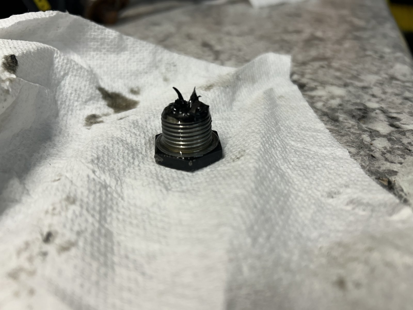

  15. Oct 19, 2023 at 5:39 AM
    #45
    Tundra694
    Tundra694 New Member
    Dec 25, 2020
    #56640
    362
    AJ
    2021 Tundra Crew Max Trd Off Road
    This is from my 2021 at 29k. First diff oil change since I’ve owned it from new in 1/21. Since it’s from new Im assuming the metal is mostly from the break in. No issues or problems.
