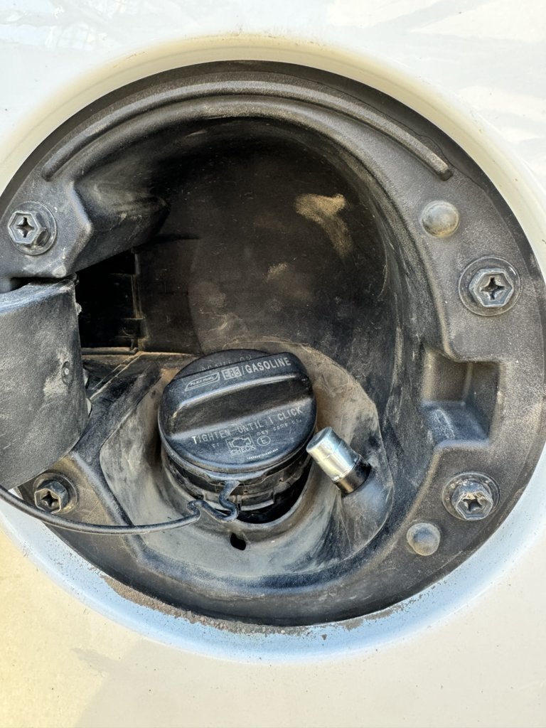

    Like others have said, relocate it while you have the opportunity. I bought a kit from Toytec, and relocated mine in the gas door. I'm anal about it and just check to see if it's free every time I fill up.

    I can independently confirm that this ^^^ way works juuuuuuuuuuuust fine.
    Use your savings to buy the kid (or grandkid) a nice pair of Hey Dudes. Spring and then summer is just around the corner.

    How I did it as well after taking a big ol gulp while launching a boat. No problems since and my truck has gone swimming waist deep a couple times.

    Nice. Where do you have it routed to?

    Zip tied to the top mount for the tailgate assist behind the drivers side tail light.

    Looks like plastic for the hose material. Easy to puncture and/or kink then break open.
