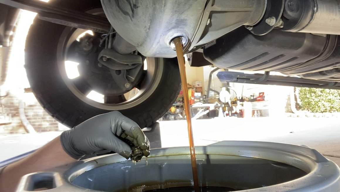

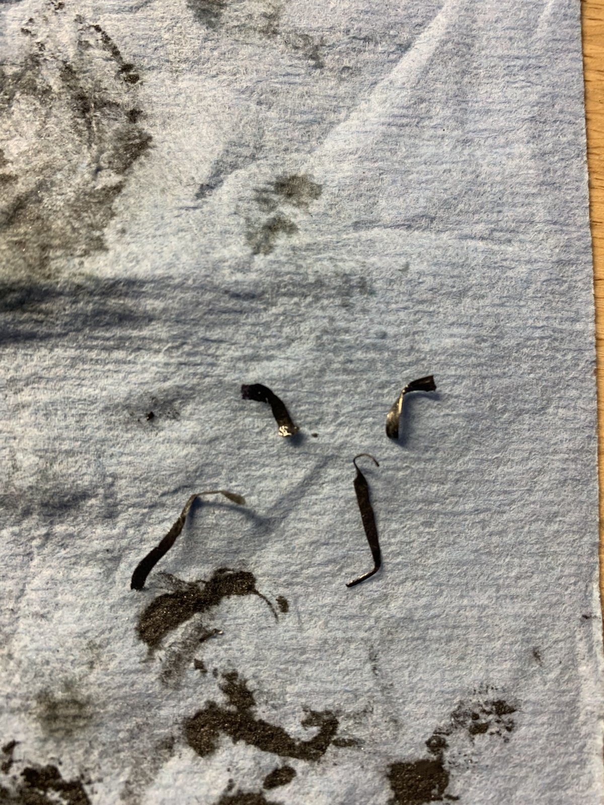

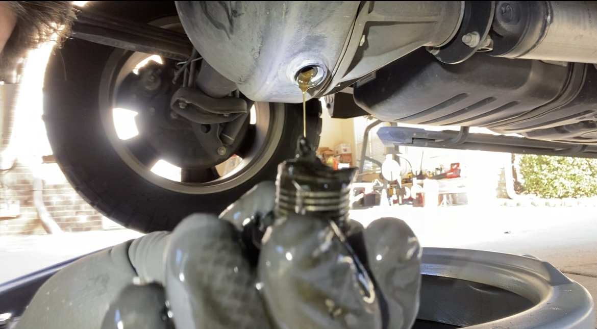

    Just pulled the rear diff plug and found 4 very thin shavings on the drain plug. Can easily bend them, not a stiff piece of metal. Anyone seen this on their drain plug before. Has zero noises and no driving issues at time of change. Truck has 42k miles.

    It’s been seen on here a few times. Machining debris and the magnet doing its job. Fill it and run it.
